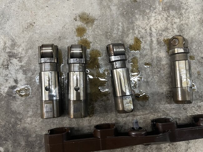

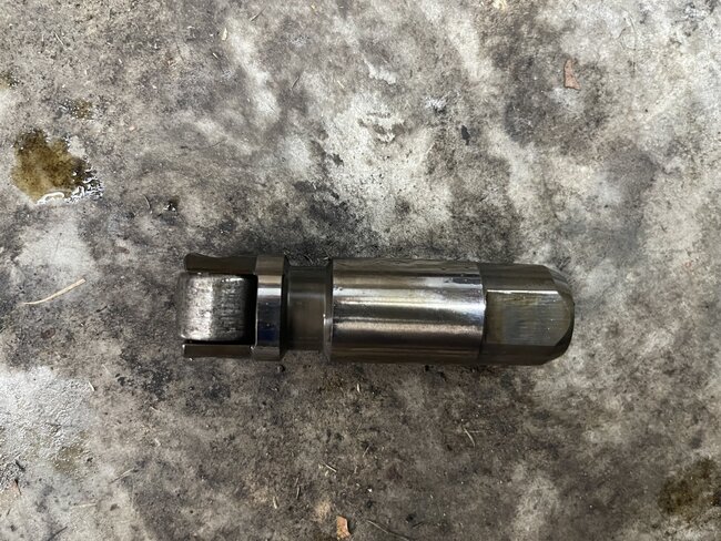

Removed driver side. Found one collapsed. Can you help me with the part number?
It's on the front mds section.
It's the 3rd one in the picture in order from front to back.
I assume other than the difference between the two types for being mds with a hole and non mds, nothing else is different and the rear ones are same as front?

Good find It looks like the camshaft will be bad as well, here is the part number for the lifters.
Front
14 - With Valve Lifters
5038785AD
$264.00
14 - Without Valve Lifters
53021727AC
$5.95
Rear
5038786AD
$264.00
53021729AC
$12.70
Let me know how it goes.

I am just going to change the one lifter and see, don't want to fool with cam.
Thursday, November 10th, 2022 AT 9:41 AM
KEN L
  • MASTER CERTIFIED MECHANIC
  • 48,363 POSTS
It will work for a little while.
