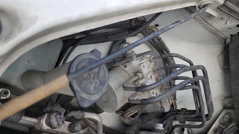

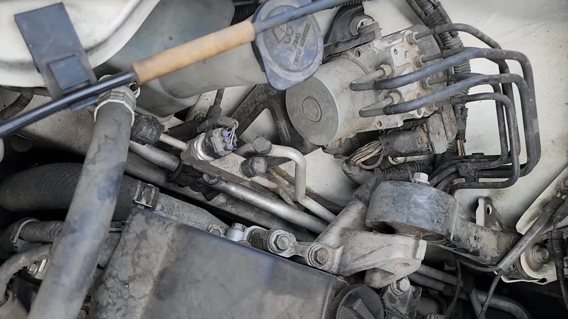

Here is a video at idle and during acceleration.

Wow, I certainly hear it. Can you tell where it seems loudest? For example, is it louder at the front of the engine or the rear? Is it louder from the top or bottom of the engine?
Has anything ever been done with the timing chain and tensioners?
Also, try removing the serpentine belt and see if the sound goes away. It may be a belt-driven accessory.

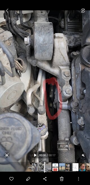

Seems to be coming from here.

Try that and see if the sound goes away. Also, I'm struggling to see what you circled. Am I looking at the belt area?
Another thought came to mind that can cause a ticking and that's a leaking exhaust manifold or oxygen sensor. See if it seems to come from that area.
