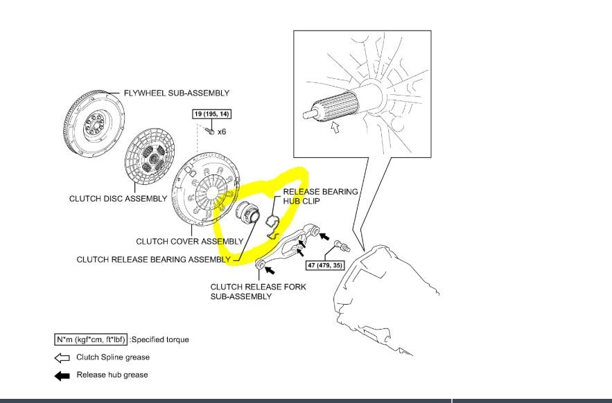

How difficult is this to do for the DIY? when at idle, I hear a clicking bell-like sound. it goes away when I press the clutch in.
Apr 14, 2019 at 2:44 AM
Good afternoon,
This will be tough to do at home.
With four wheel drive, you will need a transmission jack to support it and pull it out.
You will need to get it high enough for you to drop it out so you can access the clutch.
I do not know your ability but it is tough to do without a lift.

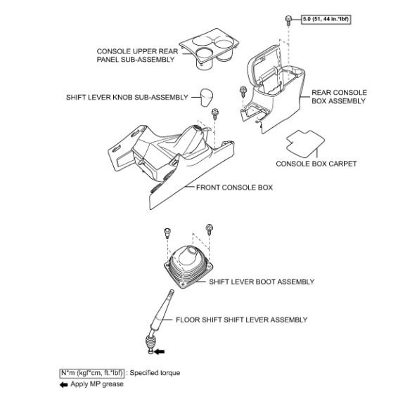

Removal
1. Disconnect cable from negative battery terminal
2. Remove console upper rear panel sub-assembly
3. Remove rear console box assembly
4. Remove shift lever knob sub-assembly
5. Remove front console box
6. REMOVE SHIFT LEVER BOOT ASSEMBLY
a. Remove the 2 screws and 2 clips, then remove the shift lever boot.

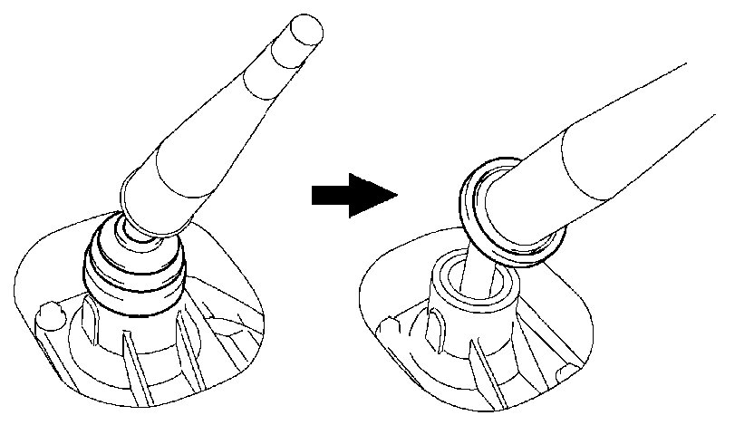

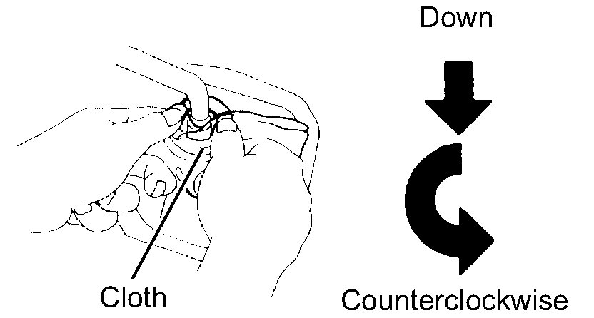

7. REMOVE FLOOR SHIFT SHIFT LEVER ASSEMBLY
a. Separate the shift lever cap boot from the manual transmission.
b. Cover the shift lever cap with a cloth.
c. Pressing down on the shift lever cap, turn it counterclockwise to remove the shift lever.
d. Pull out the shift lever.

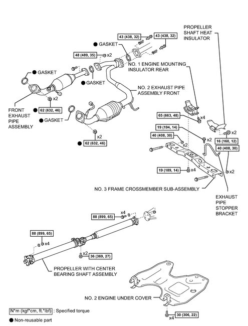

10. REMOVE EXHAUST PIPE ASSEMBLY
11. REMOVE FRONT PROPELLER SHAFT ASSEMBLY
12. REMOVE PROPELLER WITH CENTER BEARING SHAFT ASSEMBLY

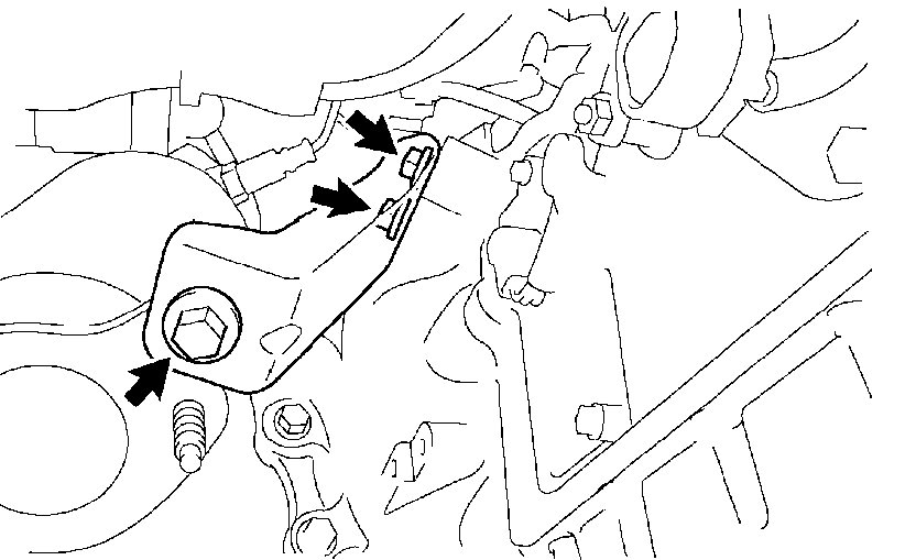

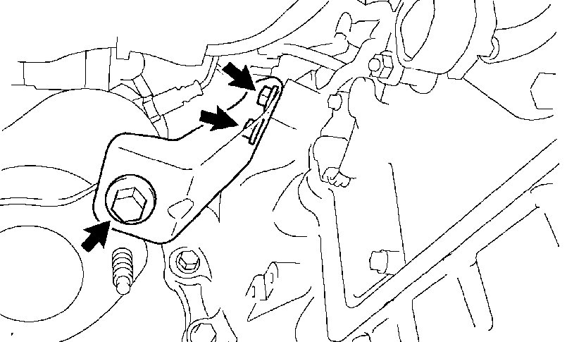

13. REMOVE NO. 2 MANIFOLD STAY
a. Remove the 3 bolts and manifold stay No. 2.

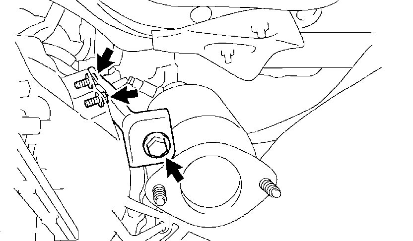

14. REMOVE MANIFOLD STAY

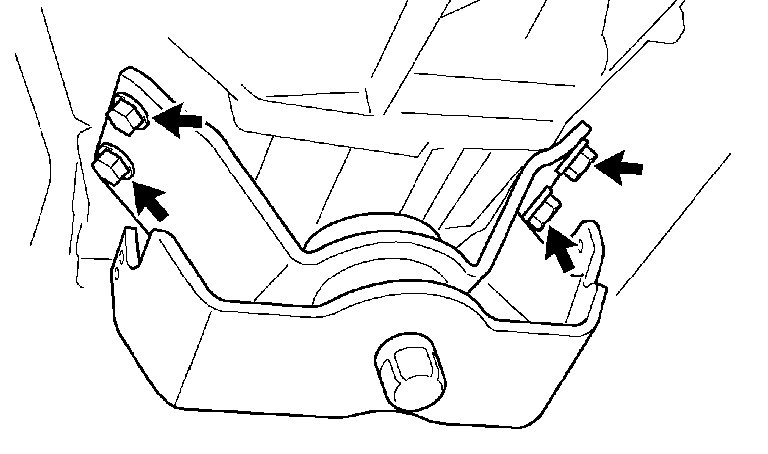

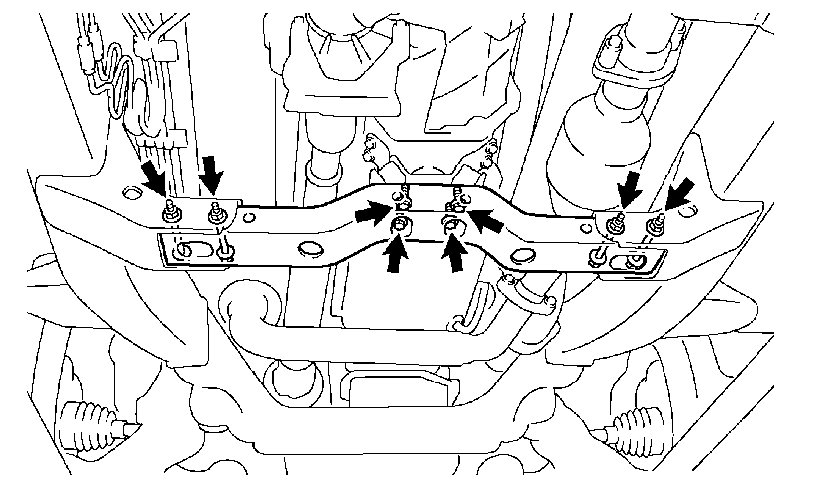

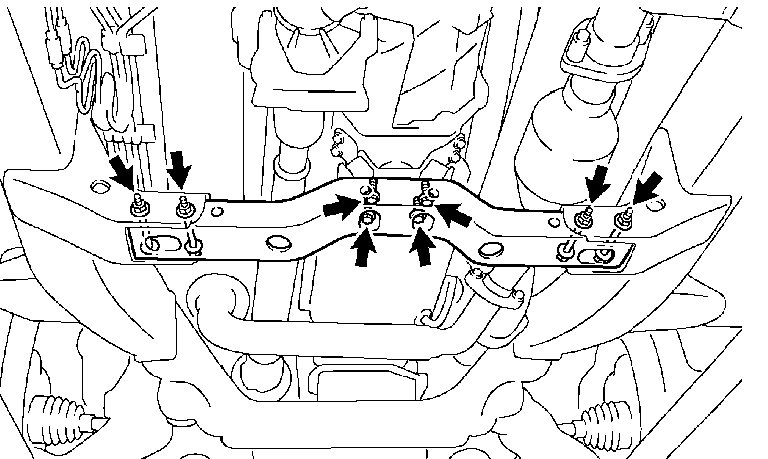

20. REMOVE NO. 3 FRAME CROSSMEMBER SUB-ASSEMBLY
a. Remove the 4 bolts on the frame crossmember subassembly No. 3.
b. Remove the 4 nuts, 4 bolts and frame crossmember sub-assembly No. 3.

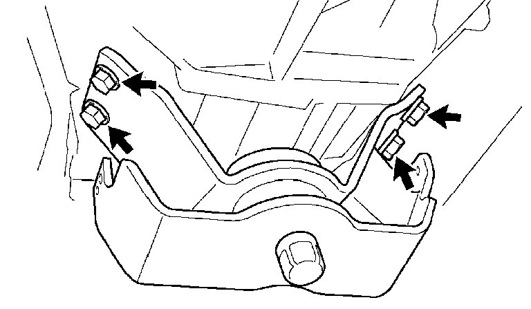

21. REMOVE NO. 1 ENGINE MOUNTING INSULATOR REAR
a. Remove the 4 bolts and engine mounting insulator rear from the manual transmission.

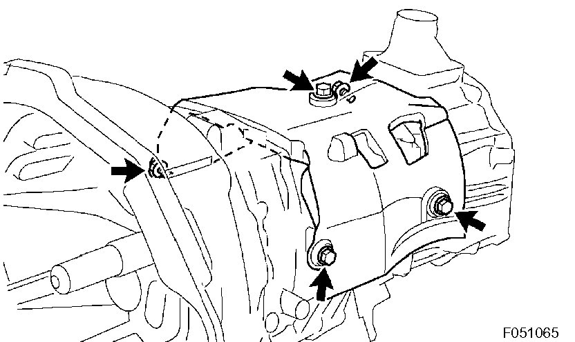

25. Remove manual transmission case cover sub-assembly
a. Remove the 5 bolts and manual transmission case cover.

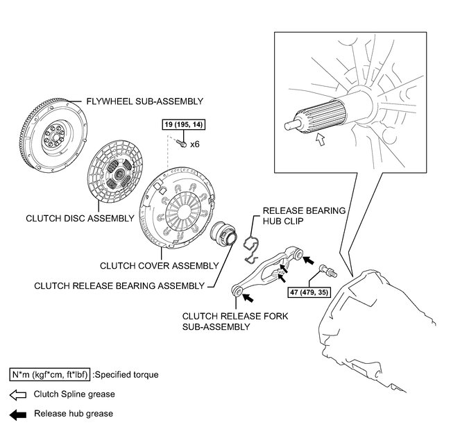

CLUTCH UNIT
Components
picture 1

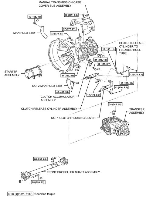

REMOVAL

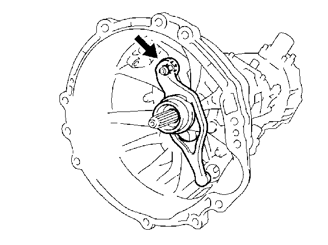

1. REMOVE MANUAL TRANSMISSION UNIT ASSEMBLY
pic 2

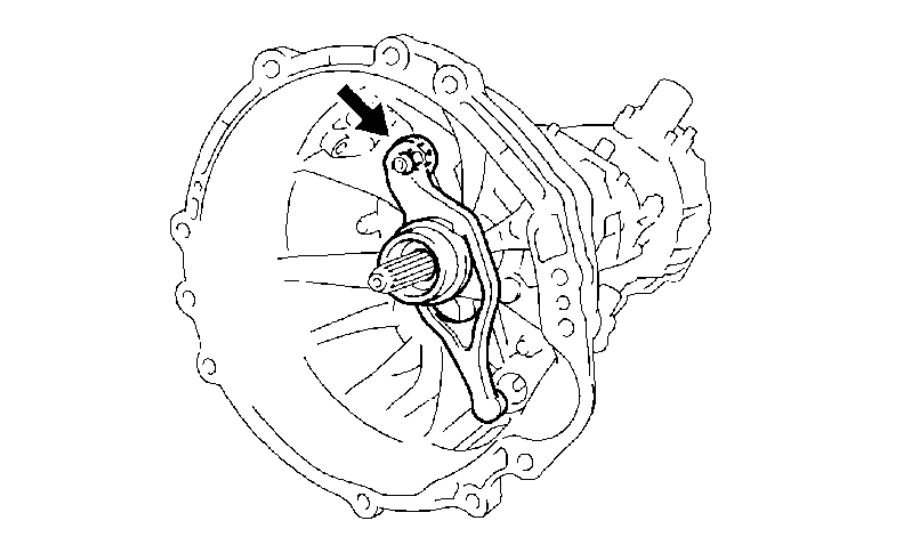

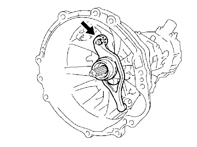

2. REMOVE CLUTCH RELEASE FORK SUB-ASSEMBLY
a. Remove the clutch release fork together with the clutch release bearing from the transmission assembly.
3. REMOVE CLUTCH RELEASE BEARING ASSEMBLY
a. Remove the clutch release bearing assembly from the clutch release fork.
4. REMOVE RELEASE FORK SUPPORT
a. Remove the release fork support from the transaxle assembly.

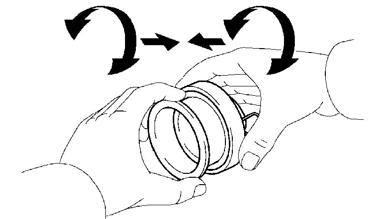

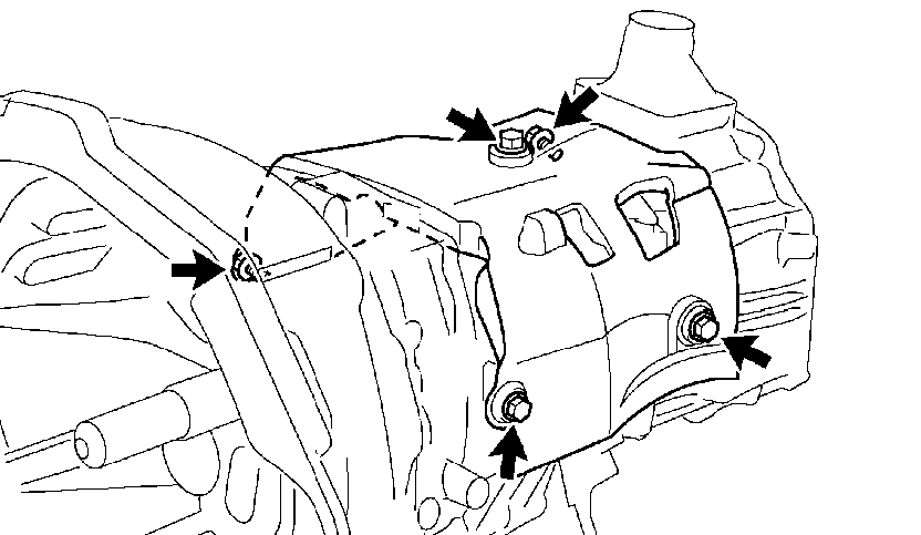

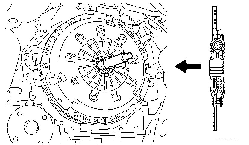

5. REMOVE RELEASE BEARING HUB CLIP
pic 3

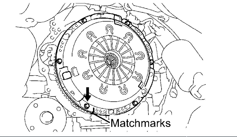

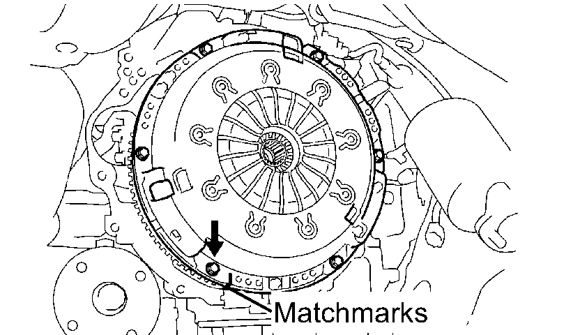

6. REMOVE CLUTCH COVER ASSEMBLY
a. Align the matchmark on the clutch cover assembly with the one on the flywheel sub-assembly
b. Loosen each set bolt one turn at a time until the spring tension is released.
c. Remove the 6 bolts and clutch cover assembly
NOTICE: Do not drop the clutch disc assembly.
7. REMOVE CLUTCH DISC ASSEMBLY
NOTICE: Keep the lining part of the clutch disc assembly, pressure plate and surface of the flywheel sub-assembly free from oil and foreign matter.

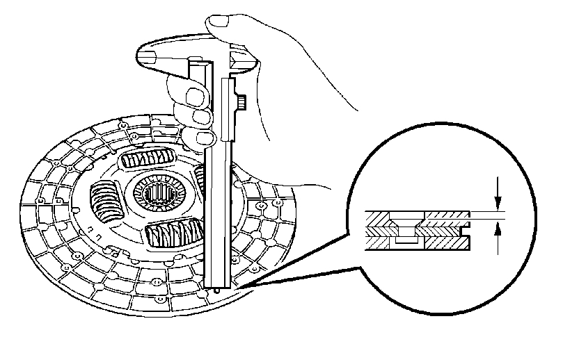

INSPECTION
pic 4
1. INSPECT CLUTCH DISC ASSEMBLY
a. Using vernier calipers, measure the rivet head depth.
Maximum rivet depth: 0.3 mm (0.012 inch)
If necessary, replace the clutch disc assembly

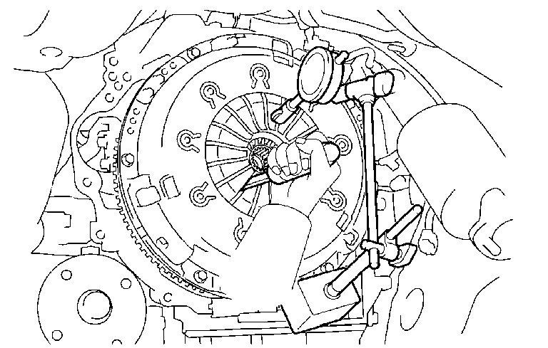

pic 5

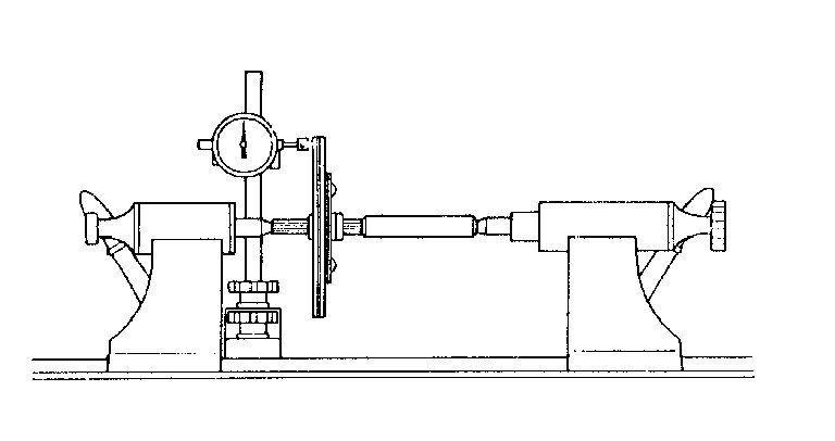

c. Using a dial indicator, check the clutch disc assembly runout.
Minimum runout: 1.0 mm (0.039 inch)

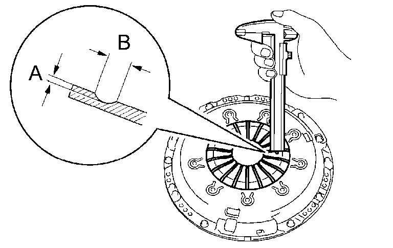

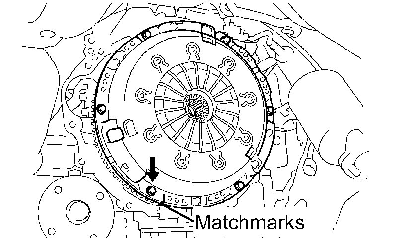

2. INSPECT CLUTCH COVER ASSEMBLY
a. Using vernier calipers, inspect the depth and width of wear of the diaphragm spring.
Minimum:
A (Depth): 0.5 mm (0.020 inch)
B (Width): 6.0 mm (0.236 inch)
If necessary, replace the clutch cover assembly.

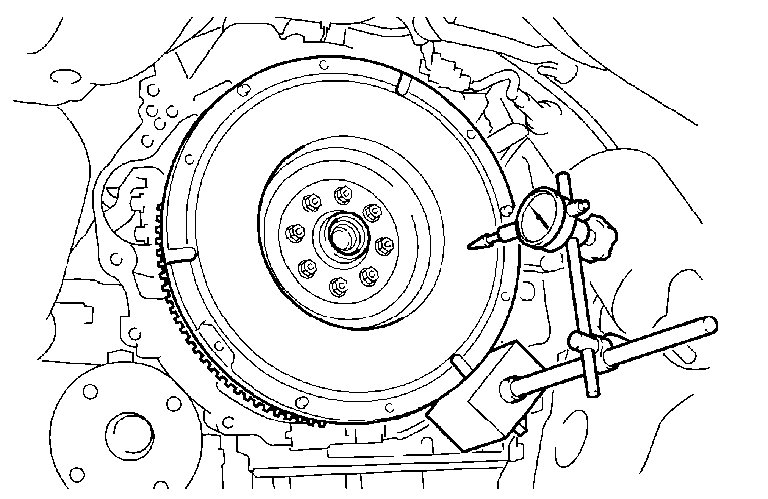

3. INSPECT FLYWHEEL SUB-ASSEMBLY
a. Using a dial indicator, inspect the flywheel sub assembly runout.
Maximum runout: 0.1 mm (0.004 inch)
If necessary, replace the flywheel sub-assembly.

INSTALLATION
pic 9
1. INSTALL CLUTCH DISC ASSEMBLY
a. Insert SST into the clutch disc assembly, then insert them into the flywheel sub-assembly
SST 09301-00220
NOTICE: Take care not to insert the clutch disc assembly in the wrong orientation.
pic 10

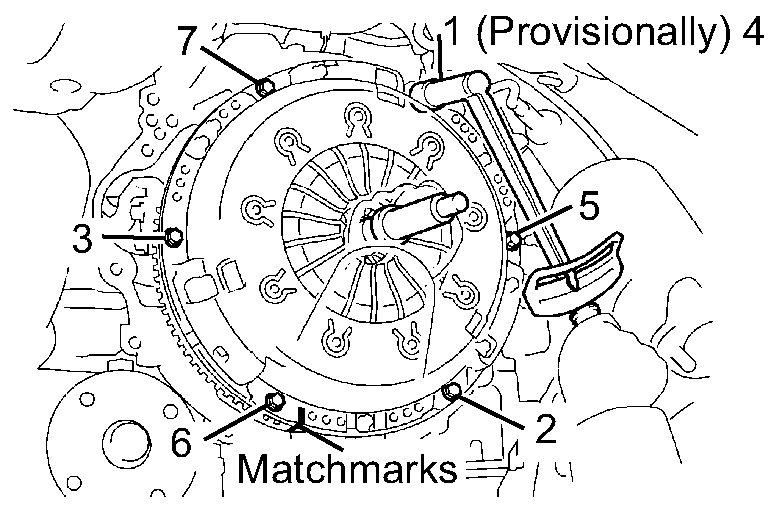

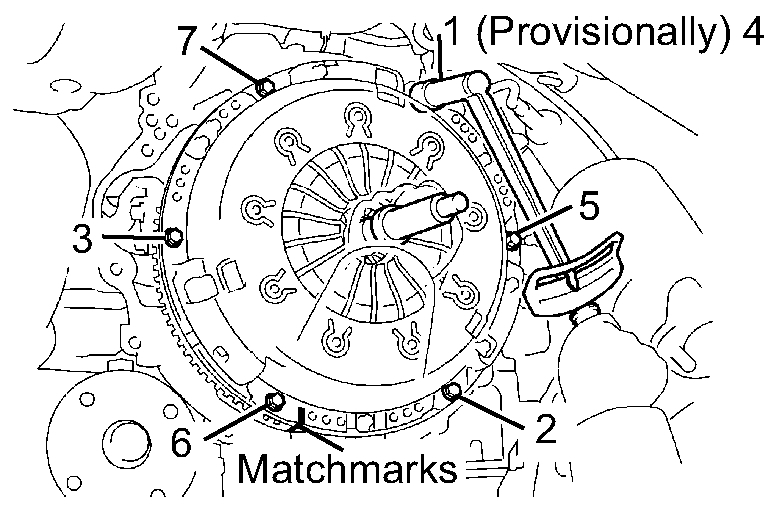

2. INSTALL CLUTCH COVER ASSEMBLY
a. Align the matchmarks on the clutch cover assembly and flywheel sub-assembly.
b. Following the procedures shown in the illustration, tighten the 6 bolts, in the order starting with the bolt located near the knock pin on the top.
Torque: 19 Nm (195 kgf-cm, 14 ft. lbs.)
HINT: Following the order in the illustration, uniformly tighten the bolts.
c. Move SST up and down, right and left lightly, after checking that the disc is in the center, and tighten the bolts.
pic 11
3. INSPECT AND ADJUST CLUTCH COVER ASSEMBLY
a. Using a dial indicator with roller instrument, check the diaphragm spring tip alignment.
Maximum non-alignment: 0.5 mm (0.020 inch)
If the alignment is not as specified, adjust the diaphragm spring tip alignment using SST.
SST 09333-00013
4. INSTALL RELEASE FORK SUPPORT
a. Install the release fork support onto the transaxle assembly.
Torque: 47 Nm (479 kgf-cm, 35 ft. lbs.)
5. INSTALL RELEASE BEARING HUB CLIP
pic 12

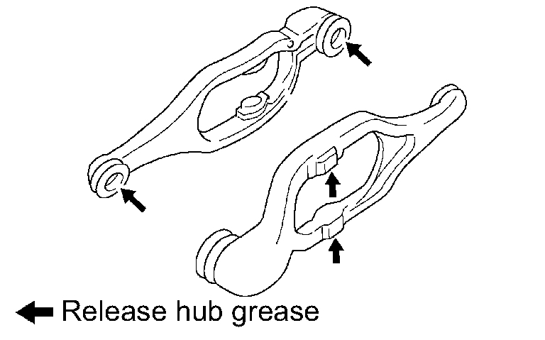

6. INSTALL CLUTCH RELEASE FORK SUB-ASSEMBLY
a. Apply release hub grease to the release fork and release the bearing assembly contact surfaces, release fork and push rod contact surface and release fork pivot point.
Sealant: Part No. 08887-01806, RELEASE HUB GREASE or equivalent
b. Install the release fork onto the release bearing assembly.
7. INSTALL CLUTCH RELEASE BEARING ASSEMBLY
a. Apply clutch spline grease to the input shaft spline.
Sealant: Part No. 08887-01706, CLUTCH SPLINE GREASE or equivalent
b. Install the bearing onto the release fork, and then install them onto the transaxle assembly.
NOTICE: After installation, move the fork forward and backward to check that the release bearing slides smoothly.

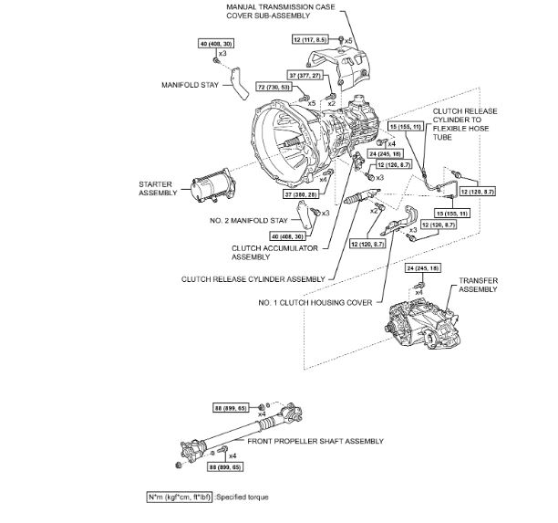

TRANSMISSION REMOVAL
MANUAL TRANSMISSION ASSEMBLY
Components
pic 13
Components
pic 14
Components
pic 15
REMOVAL

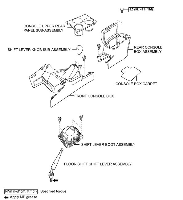

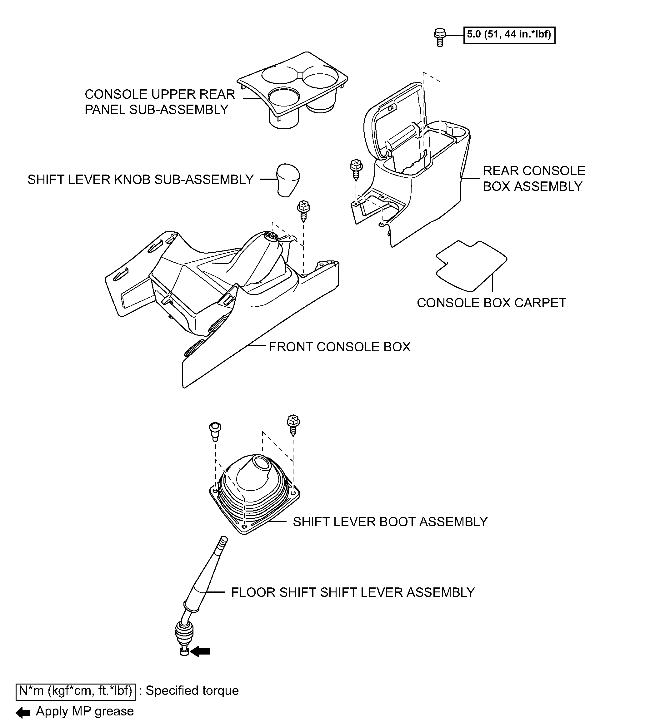

1. DISCONNECT CABLE FROM NEGATIVE BATTERY TERMINAL
2. REMOVE CONSOLE UPPER REAR PANEL SUB-ASSEMBLY
3. REMOVE REAR CONSOLE BOX ASSEMBLY
4. REMOVE SHIFT LEVER KNOB SUB-ASSEMBLY
5. REMOVE FRONT CONSOLE BOX
pic 16

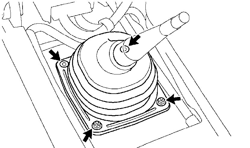

pic 17

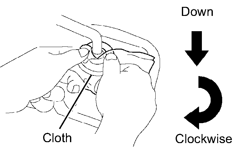

pic 18

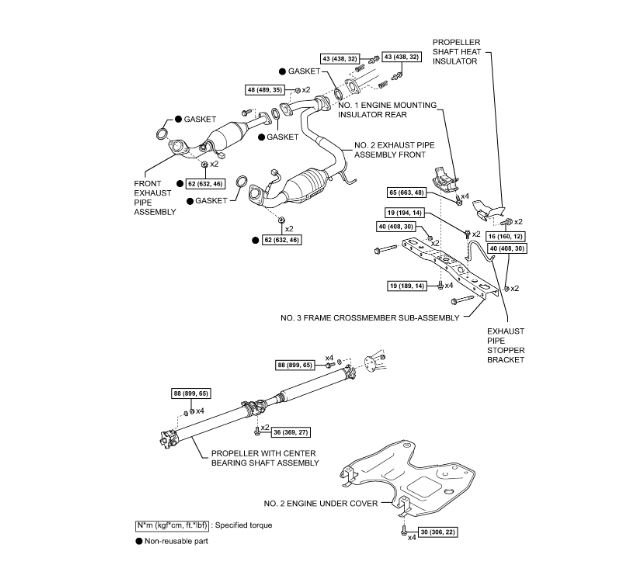

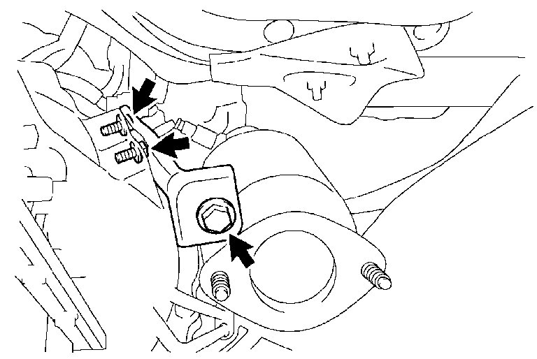

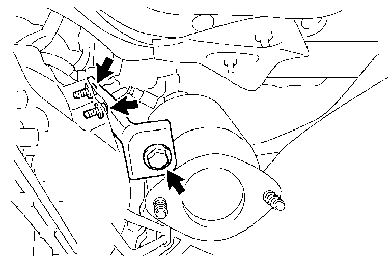

pic 20

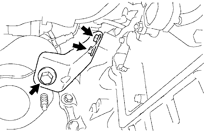

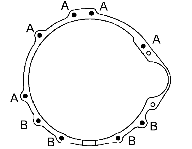

1. INSTALL TRANSFER ASSEMBLY
pic 25
2. INSTALL MANUAL TRANSMISSION CASE COVER SUB-ASSEMBLY
a. Install the manual transmission case cover with the 5 bolts.
Torque: 12 Nm (117 kgf-cm, 8.5 ft. lbs.)
pic 26

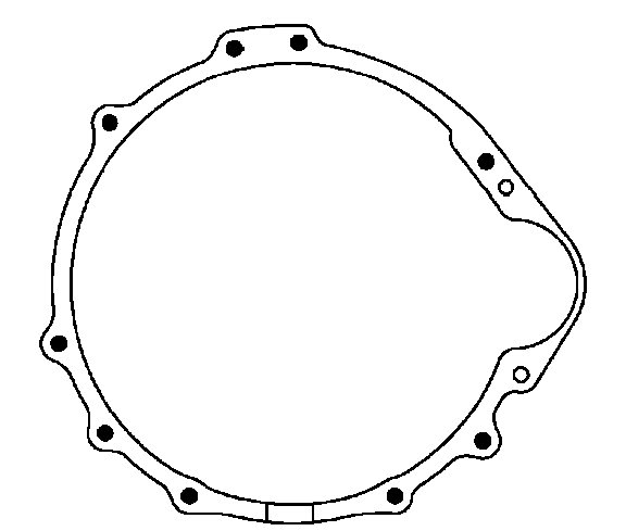

3. INSTALL MANUAL TRANSMISSION WITH TRANSFER
a. Install the manual transmission with transfer with the 9 bolts.

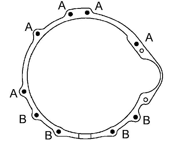

Torque:
72 Nm (730 kgf-cm, 53 ft. lbs.) for bolt A
37 Nm (380 kgf-cm, 28 ft. lbs.) for bolt B

Torque: 40 Nm (408 kgf-cm, 30 ft. lbs.)
b. Install the frame crossmember sub-assembly No. 3 with the 4 bolts.
Torque: 19 Nm (189 kgf-cm, 14 ft. lbs.)
7. INSTALL CLUTCH ACCUMULATOR ASSEMBLY
8. INSTALL CLUTCH RELEASE CYLINDER ASSEMBLY
9. INSTALL NO. 1 CLUTCH HOUSING COVER
10. INSTALL STARTER ASSEMBLY
pic 29
11. INSTALL MANIFOLD STAY
a. Install the manifold stay with the 3 bolts.
pic 30
12. INSTALL NO. 2 MANIFOLD STAY
a. Install the manifold stay No. 2 with the 3 bolts.
13. INSTALL PROPELLER WITH CENTER BEARING SHAFT ASSEMBLY
14. INSTALL FRONT PROPELLER SHAFT ASSEMBLY
15. INSTALL EXHAUST PIPE ASSEMBLY
16. ADD MANUAL TRANSMISSION OIL
17. ADJUST MANUAL TRANSMISSION OIL
18. INSTALL NO. 2 ENGINE UNDER COVER
pic 31

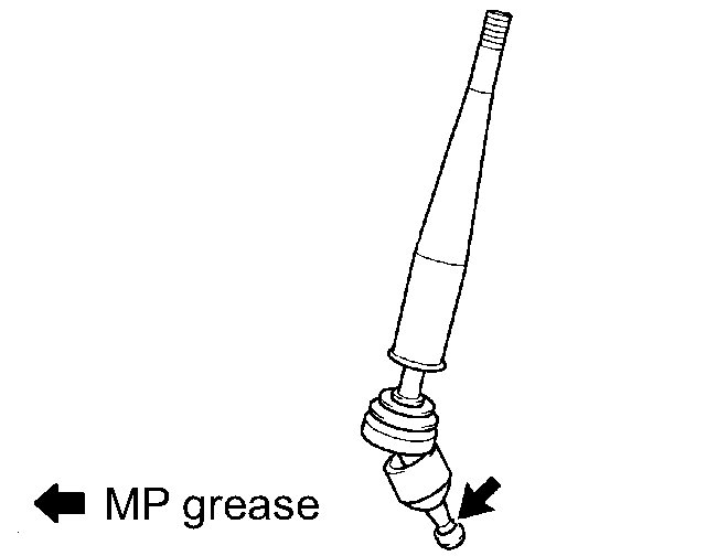

19. INSTALL FLOOR SHIFT SHIFT LEVER ASSEMBLY
a. Apply MP grease to the tip of the shift lever.

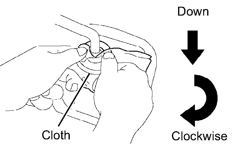

pic 32
c. Pressing down on the shift lever cap, turn it clockwise to install the shift lever.
20. INSTALL SHIFT LEVER BOOT ASSEMBLY
a. Install the shift lever boot with the 2 screws and 2 clips.
21. INSTALL FRONT CONSOLE BOX
22. INSTALL SHIFT LEVER KNOB SUB-ASSEMBLY
23. INSTALL REAR CONSOLE BOX ASSEMBLY
24. INSTALL CONSOLE UPPER REAR PANEL SUB-ASSEMBLY
25. CONNECT CABLE TO NEGATIVE BATTERY TERMINAL
Torque: 3.9 Nm (40 kgf-cm, 35 inch lbs.)
