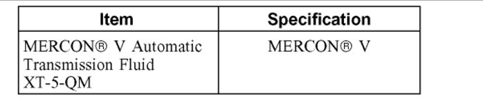

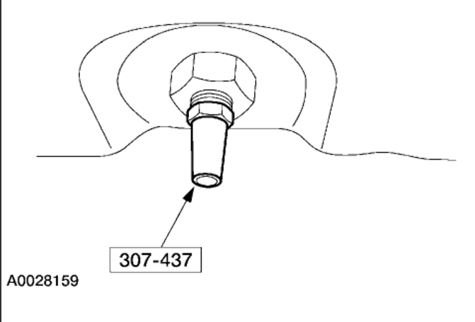

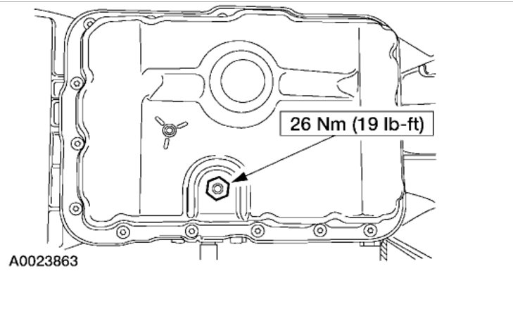

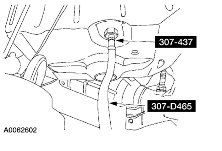

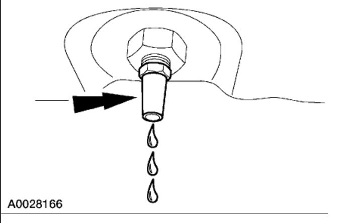

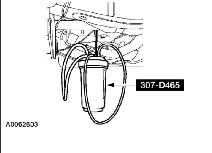

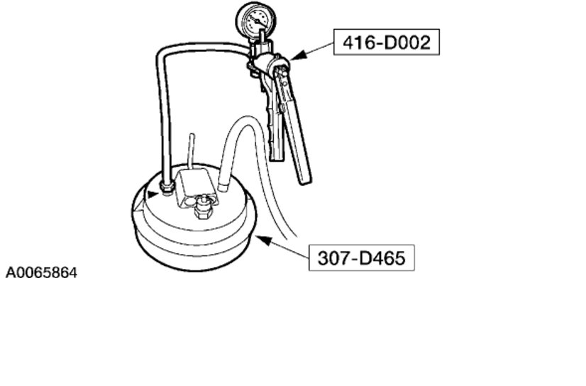

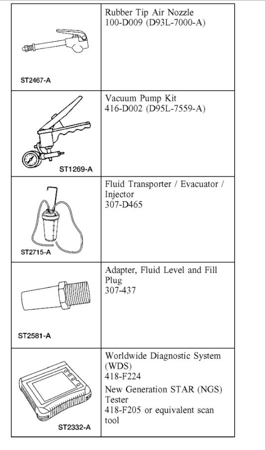

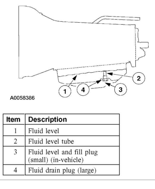

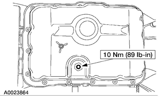

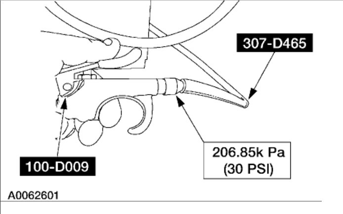

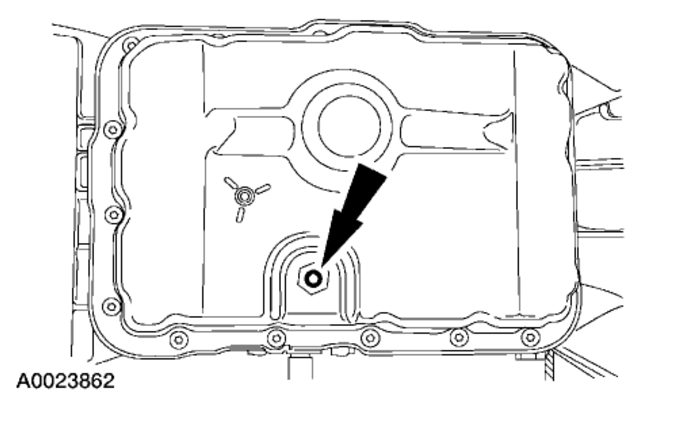

It could, but so can low fluid. Here are diagrams on how to check the transmission fluid level. Check out the diagrams (below). Please let us know what you find.
