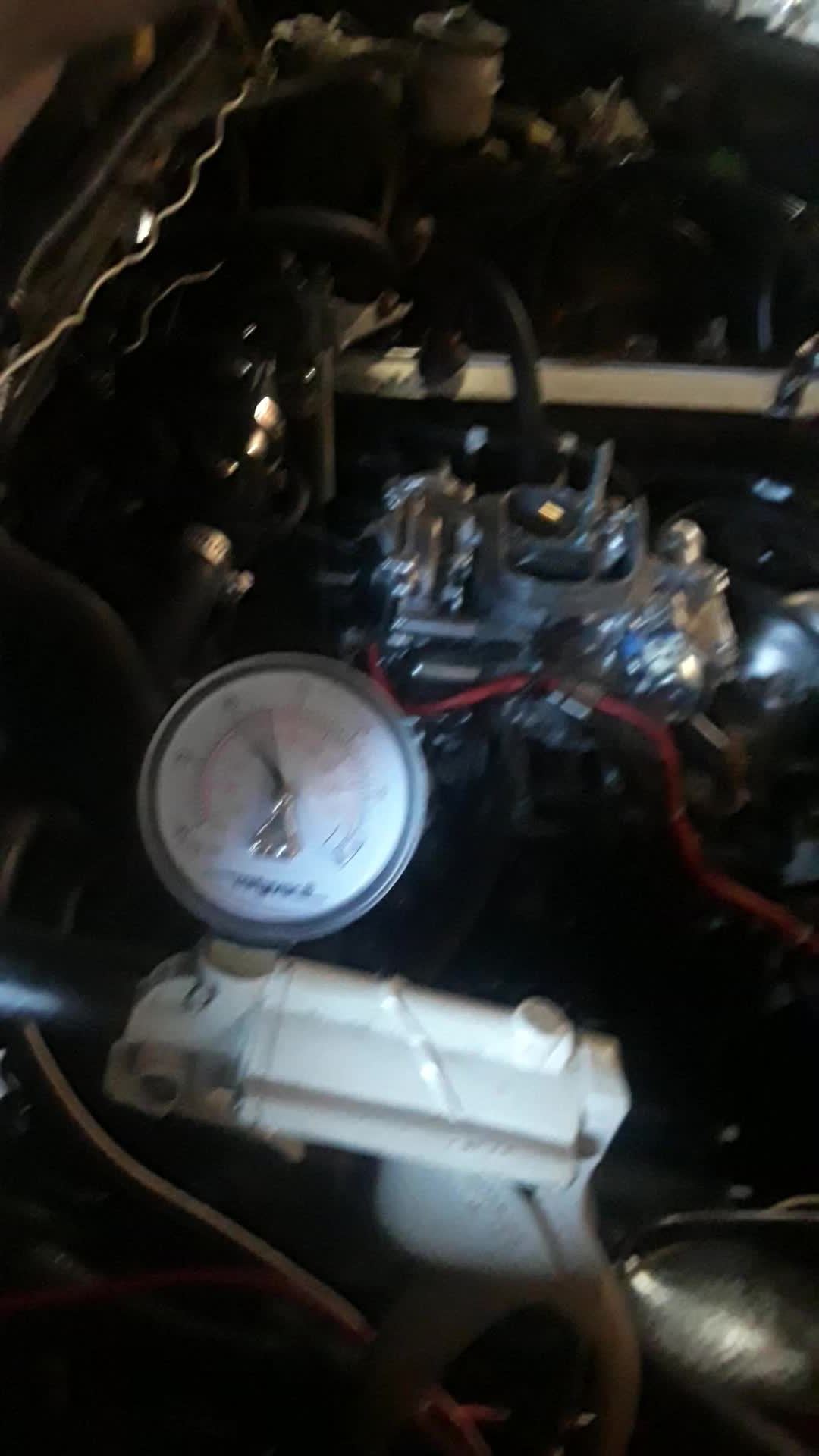

I just finished rebuild a 22R for a friend of mine, everything is new except for the block, rods, and crank.
(bored 20 over, crank was turned, correct bearings, all oil clearances were well in spec)
After getting it all put together and in the truck I got it running, set timing to 1 BTC (that's where it performs the best) it's got 72 psi oil pressure cold, 35 warm, all cylinders have exactly 182 psi of compression, its pulling 21 inches of vacuum, no vacuum leaks of any kind, and the choke functions properly.
When warm the idle rpm is about 900, if I get it any lower the engine surges and misses, I've tried adjusting the idle mixture screw with barely any change. The carburetor sight glass is showing fuel almost all the way up. Upon quick bursts of acceleration it has a bit of lag, then runs like a dream. When the throttle is released it will attempt to die for a few seconds, backfire once, and then bring itself back up. And no adjustment of the idle screw, mixture screw, or timing seems to make any significant improvements.
Any ideas as to what it could be?

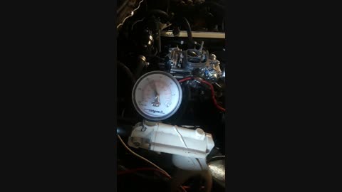

Well I set the timing to 12, it's got better response but it's still got a miss at idle and surges. Any idle below 900 is horrible. I put the idle fuel mixture back to factory settings.

Oh boy. The misfire and surging based on all that definitely sounds like a vacuum leak. However, let's just start at the basics and hook up a vacuum gauge and see what the needle is doing. It should be very steady and not bouncing at all. If it is moving around, get a video of it and send it over so I can see what it is doing and we can go from there.
If it is steady then we can move on from a vacuum leak and look at the EGR operation and canister. If you still have that hooked up, do you have a purge valve or did you eliminate it?

Vacuum has stayed very steady between 17-21 (depending on idle) goes down and back up smoothly on acceleration, spikes cleanly when letting off, so I know there's no leaks.
There's no purge valve anywhere, EGR has one port, EGR filter has two ports, canister has two ports, distributor has two, and carburetor has twelve if I'm not mistaken.

I was wrong, vacuum gauge was lying to me. I noticed the tube I was using had collapsed in on itself under vacuum and wasn't reading properly. now the needle is vibrating rapidly between about 17 and 22.
Jun 26, 2019 at 2:06 PM
Oh yeah. So that needs to be perfectly steady before we can do anything else. That is why you are not able to adjust the mixture screws and make any change. Plus, that is affecting your idle issue as well.
Obvious statement is we need to plug all vacuum leaks and then go back through the setting timing and adjusting carburetor.

Also I've noticed when I plug and play different vacuum connections on the carburetor to different vacuum tubes the needle either gets a little steadier or much worse.
Jul 8, 2019 at 12:42 AM
Okay. You want to take your reading from manifold vacuum after the carburetor. Can you hook into one of those vacuum lines and resend the video? If that gauge is acting differently then that explains why your guides appear to be okay.

It is connected to direct intake vacuum, I think it may be changing with the fluctuation of rpm.
Jul 8, 2019 at 1:46 PM
Okay. Yes if RPM is ranging then vacuum will as well. However, I just re-watched that video of the vacuum and that is swinging wildly and the RPM sounds steady.
Can you send me a new video with your timing set around 8 BTDC and at idle and lets see what it is doing?

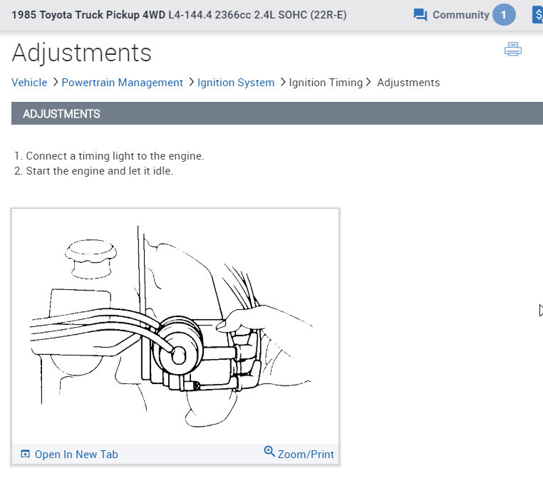

Okay. I have to back track a little because I just realized I have been looking up specs for a 1980 2.4L but you said you have a 1985 engine, correct?

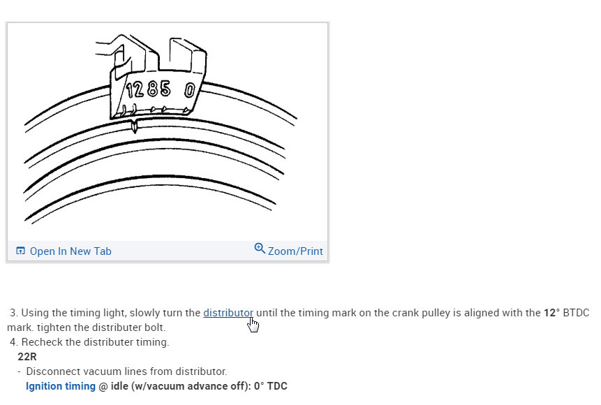

So for a 1985 2.4L 144.4 22R-E engine the base timing spec is 5 BTDC and for a 2.4L 22R engine it is 0 BTDC.
Do you know which you have? If not, I would set it at the more advanced number because you said it seemed to run better with more advance.
You always set base timing with the advanced unhooked.

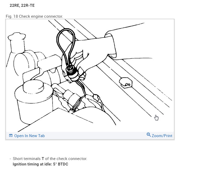

So I attached the chart for timing on the 22R engine which says it should be 0 BTDC at 600 RPM.
For the 22R-E engine it says 5 BTDC at idle and idle spec is 750 RPM.

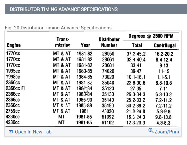

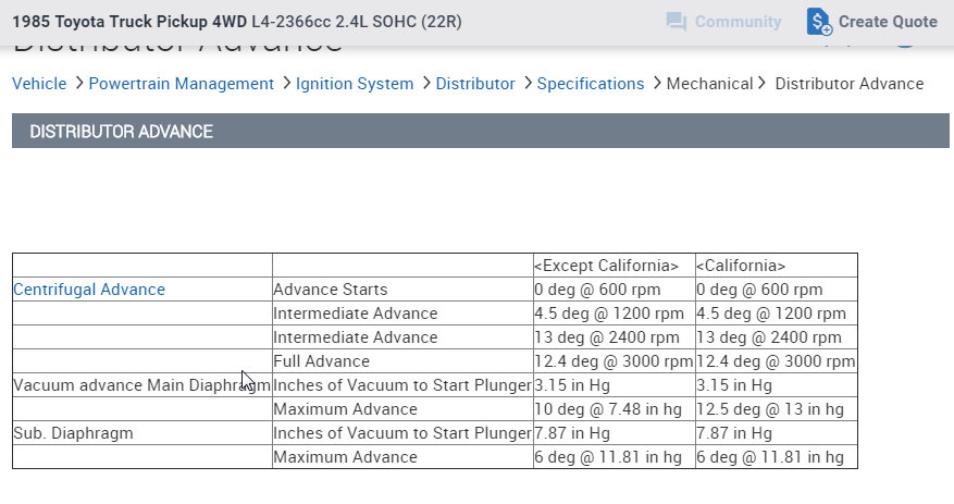

The next document is the timing advance specs. You should not need to adjust this but you can check your advance is accurate. So set your base timing and then run the engine at 2500 RPM and you should see the timing with the range of the last column.
This also has your distributor number on it which should help identify which engine you have. Clearly it is going to be a 2366cc engine but I don't know which one to tell you to look at so you will need to look for the ID number on the distributor.
This is all to get your timing set properly. Once it is set, send me a video of the vacuum gauge and we can go from there. I hope setting this timing properly will resolve most of this issue but we have to try and "back door" this to figure out which engine you have. Let me know and we can go from there.
Sorry for the confusion.
Jul 9, 2019 at 4:14 PM
Sorry for the multiple posts but I just found the actual procedure for a 1985.
Give this a read and let me know what happens.
Jul 9, 2019 at 4:19 PM

Welp, ended up getting rid of the OEM carburetor in exchange for a Weber 32/36, set the timing to about 2 deg, that's where it seems to like the best. And now its running beautifully, it still has the shaking vacuum needle, but at this point he doesn't want to sink the money into redoing the whole top end, especially with how much he's already had to put into the build, the needle did steady out a little bit and is now only shaking back and forth between about 4 in hg
Jul 23, 2019 at 10:50 PM
Ok. Great job. That makes sense. It was a vacuum/air leak but just not in the area we were looking. I am sure there is something else leaking but as you state, if it is running well then i wouldn't worry about it.
