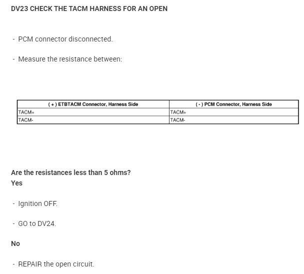

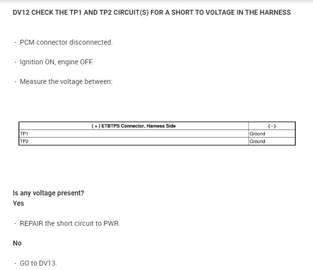

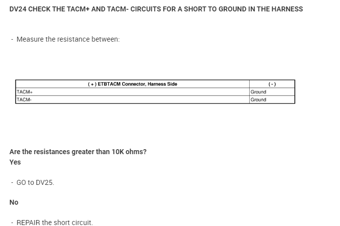

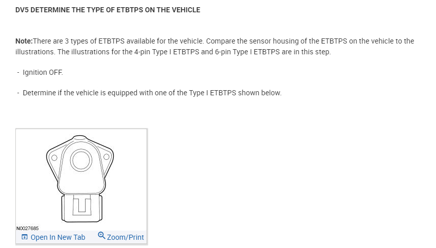

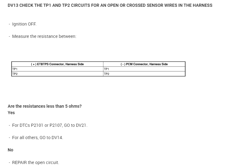

Did new plugs, new coils, removed throttle body and cleaned grim off it it. Opened it by hand to clean inside. Put everything back together. The engine goes into fail safe mode now. Have codes:
P102 ff
P113 ff
P122 ff
P222 ff
P223 ff
P2100 ff
P2106 ff
P2110 ff
P113
Aug 12, 2023 at 5:38 AM
  • 110,241 POSTS

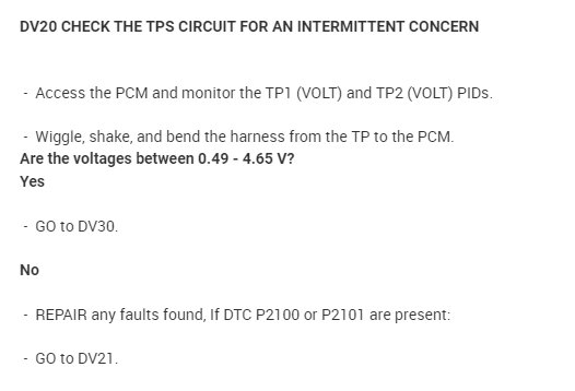

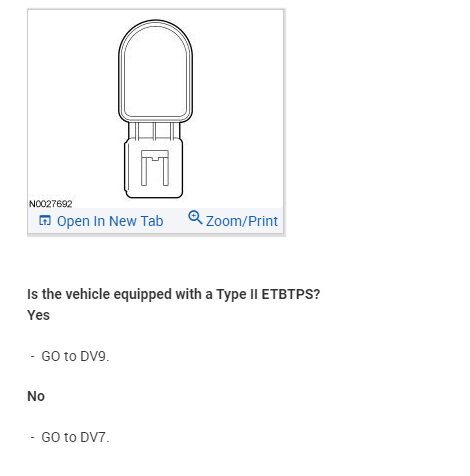

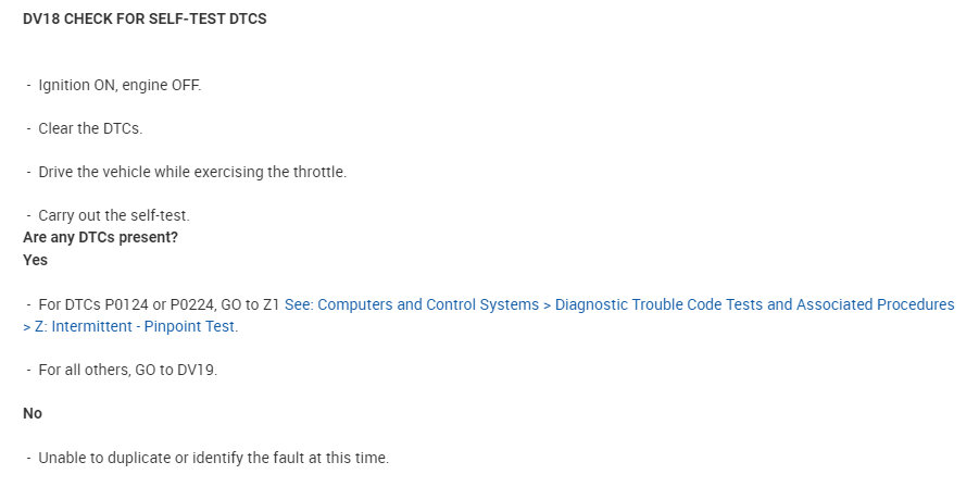

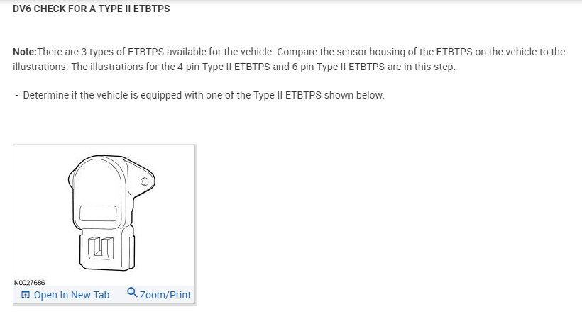

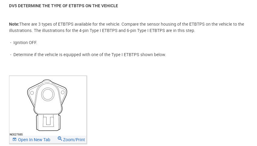

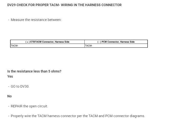

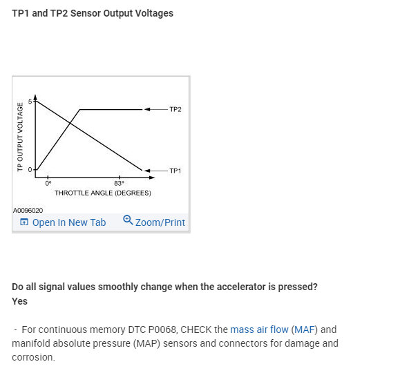

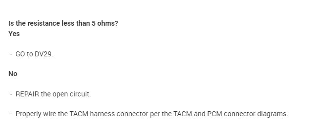

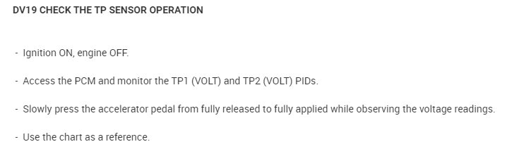

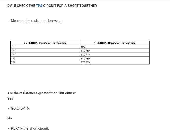

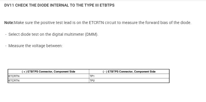

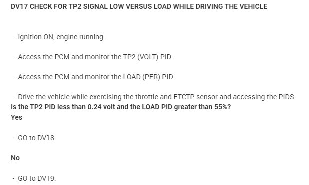

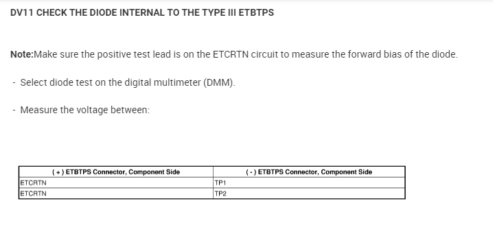

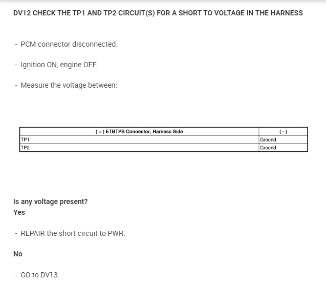

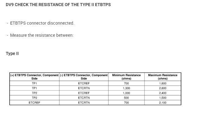

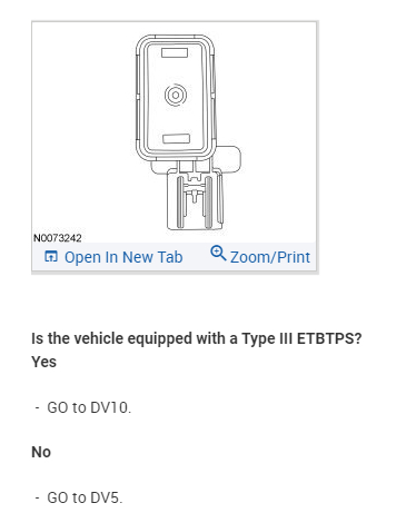

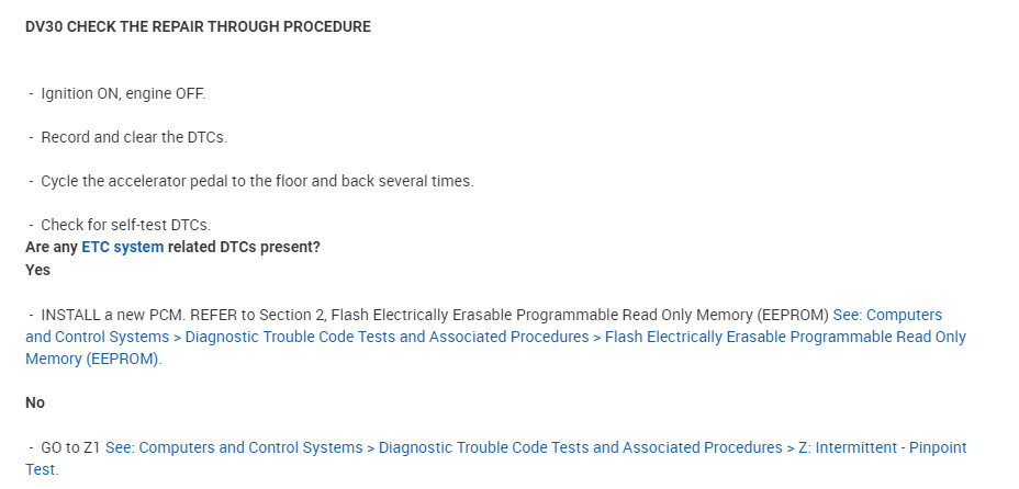

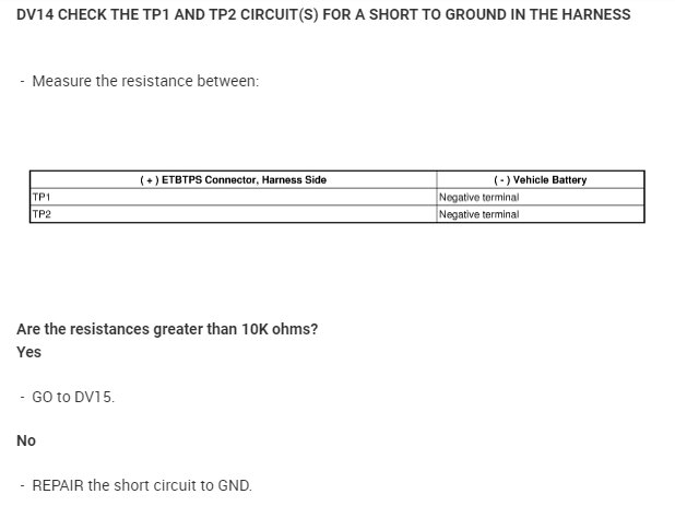

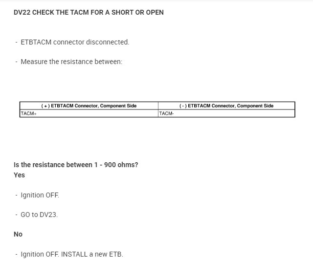

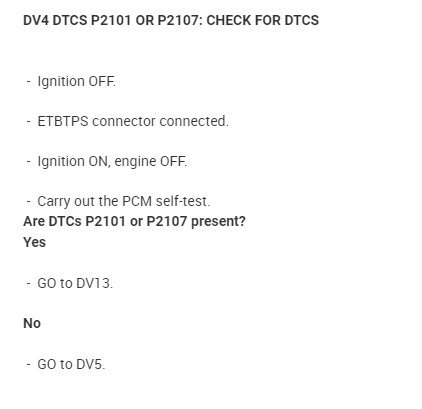

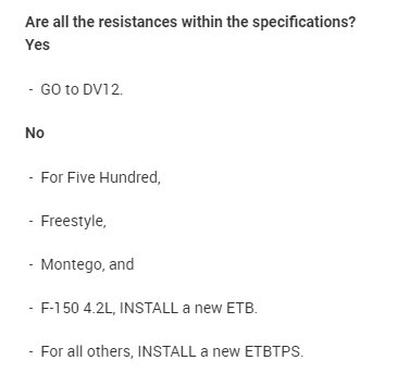

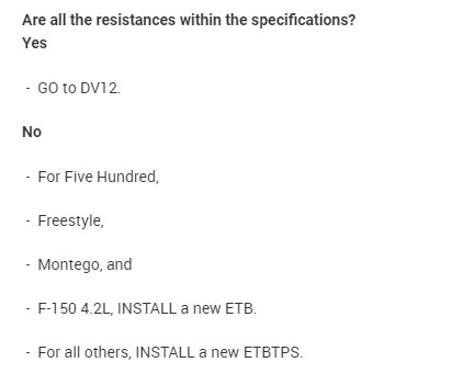

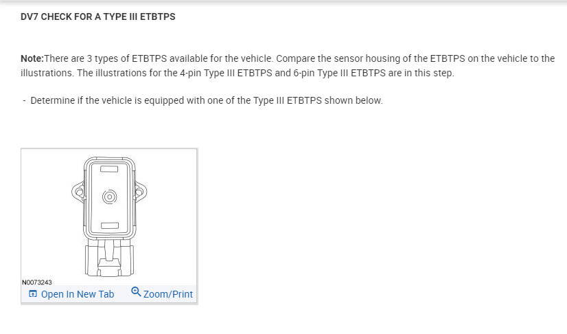

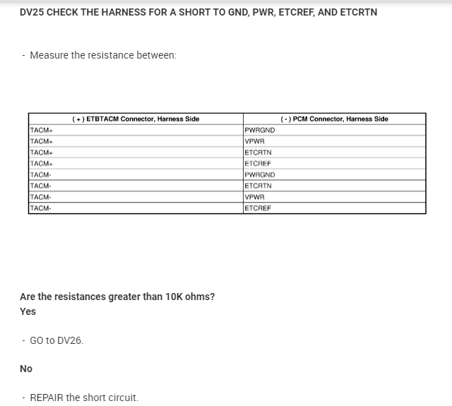

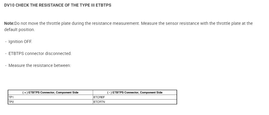

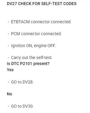

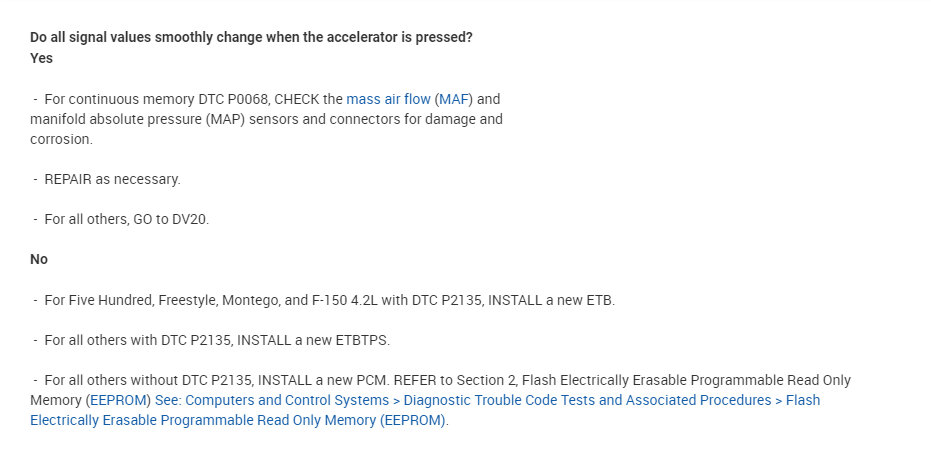

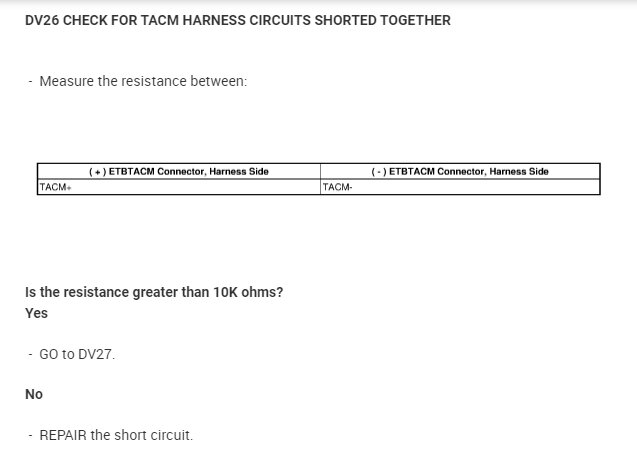

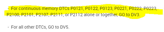

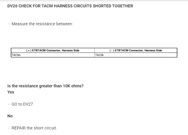

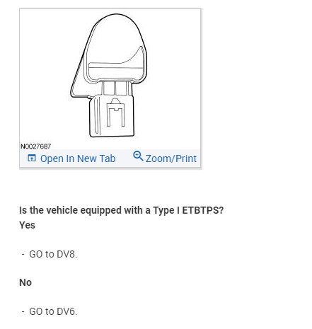

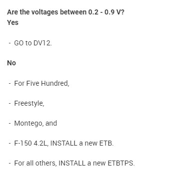

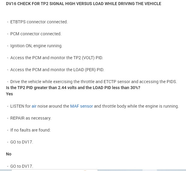

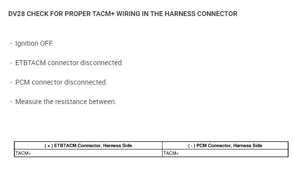

If I had to guess, we have a wiring issue, but the only way to know is by testing. When looking through the codes you have, some of them are nothing more than informational codes. In other words, it sets to indicate a general problem in a specific circuit. In this case, it is the throttle actuator control circuit.
Based on what I read, I am providing diagnostics that are relevant to several of the codes you have. They are extensive, but that doesn't mean you will need to complete all of them. You may find an issue within the first few tests, so please don't be overwhelmed.
Take a look through them and let me know if you are comfortable performing them.
