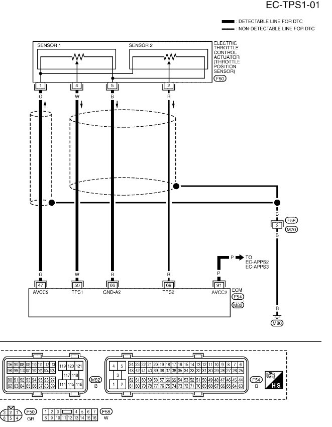

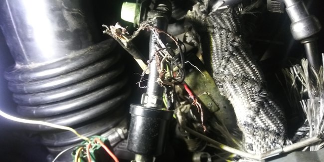

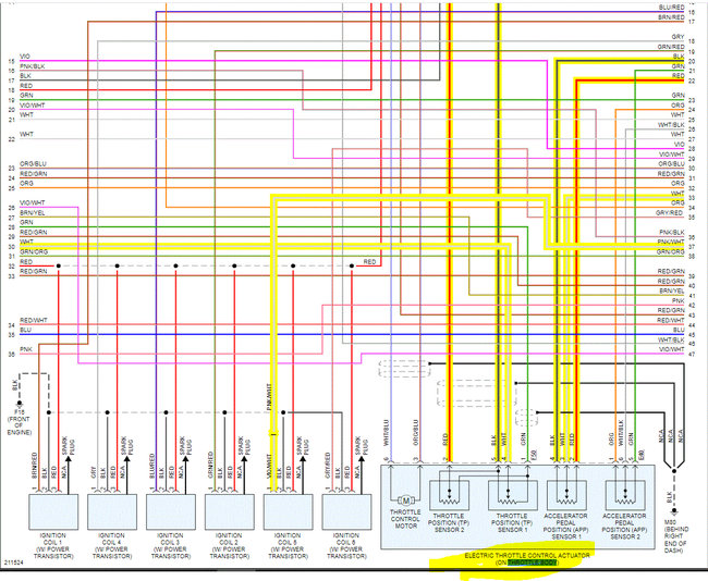

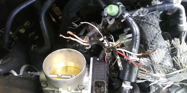

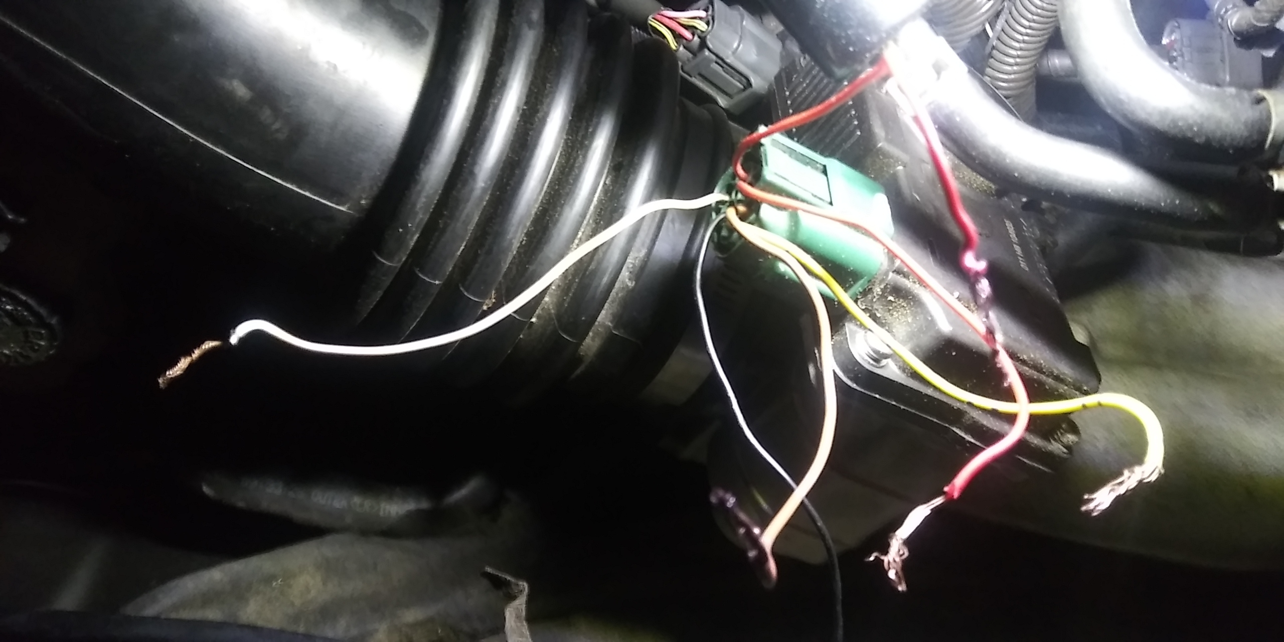

I bought it from a friend who didn't have money to put into it. When i got it to the house and popped the hood and to my surprise the wires going to the throttle body had been cut and the plug was missing. So i went to the junk yard and cut one off of it. Now i have no idea what pin needs what wire to get it to operate correctly. Any help would be really appreciated. The color of the wires i have there's a white/blue- orange/blue and a ground then in another shield there is a white and a ground- then there is a black- red-white and a ground in the third shield.
Aug 11, 2021 at 1:02 PM
SQM
  • 6,383 POSTS
So you are looking for the wiring on the throttle position sensor, right?
I have attached the wiring diagram for your reference.
On the diagram is show the red, white, blue and ground.
Is the wire color different on the harness of the junk yard one and the harness on the vehicle?
Please let me know if you have any other questions.

On the plug side i have 2 red and a brown they are pins 1-3 and on pins 4-6 are white black and yellow.. the wires on my harness are black, red and white with a bare ground then there is another white wire with a bare ground then you have a white with blue stripe and a orange with a blue stripe and a bare ground as well and that's all of them.
Aug 11, 2021 at 4:33 PM
SEEUEVERY WHEREUGO
  • 7 POSTS
I tried to do my best but that is the harness side.
Aug 11, 2021 at 4:47 PM
SEEUEVERY WHEREUGO
  • 7 POSTS
And the plug side.
Aug 11, 2021 at 4:48 PM
SEEUEVERY WHEREUGO
  • 7 POSTS
Now i plugged my scanner up and it's giving me a u1000 code. how would i check that out? Because as soon as i put the key in the on position the cooling fans come on.

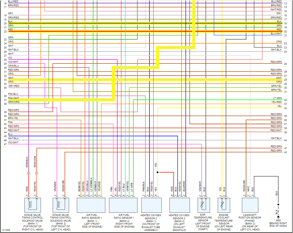

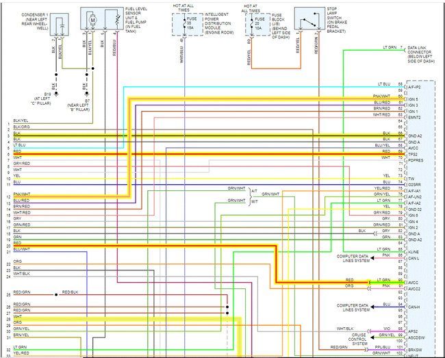

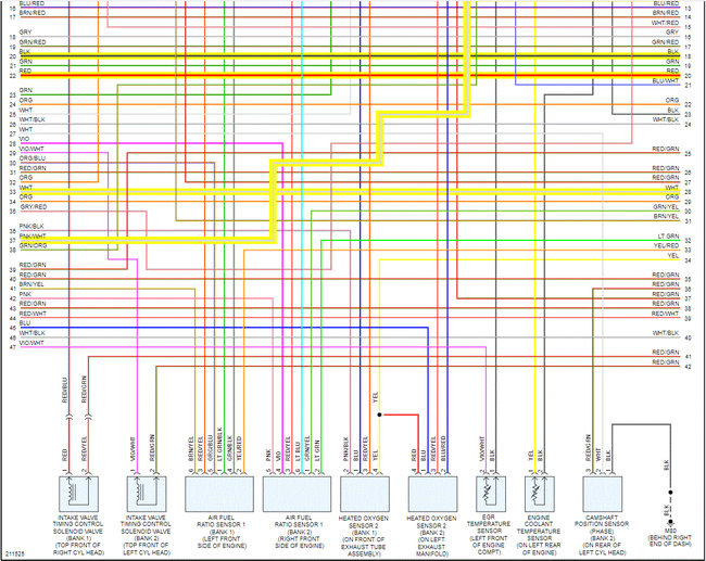

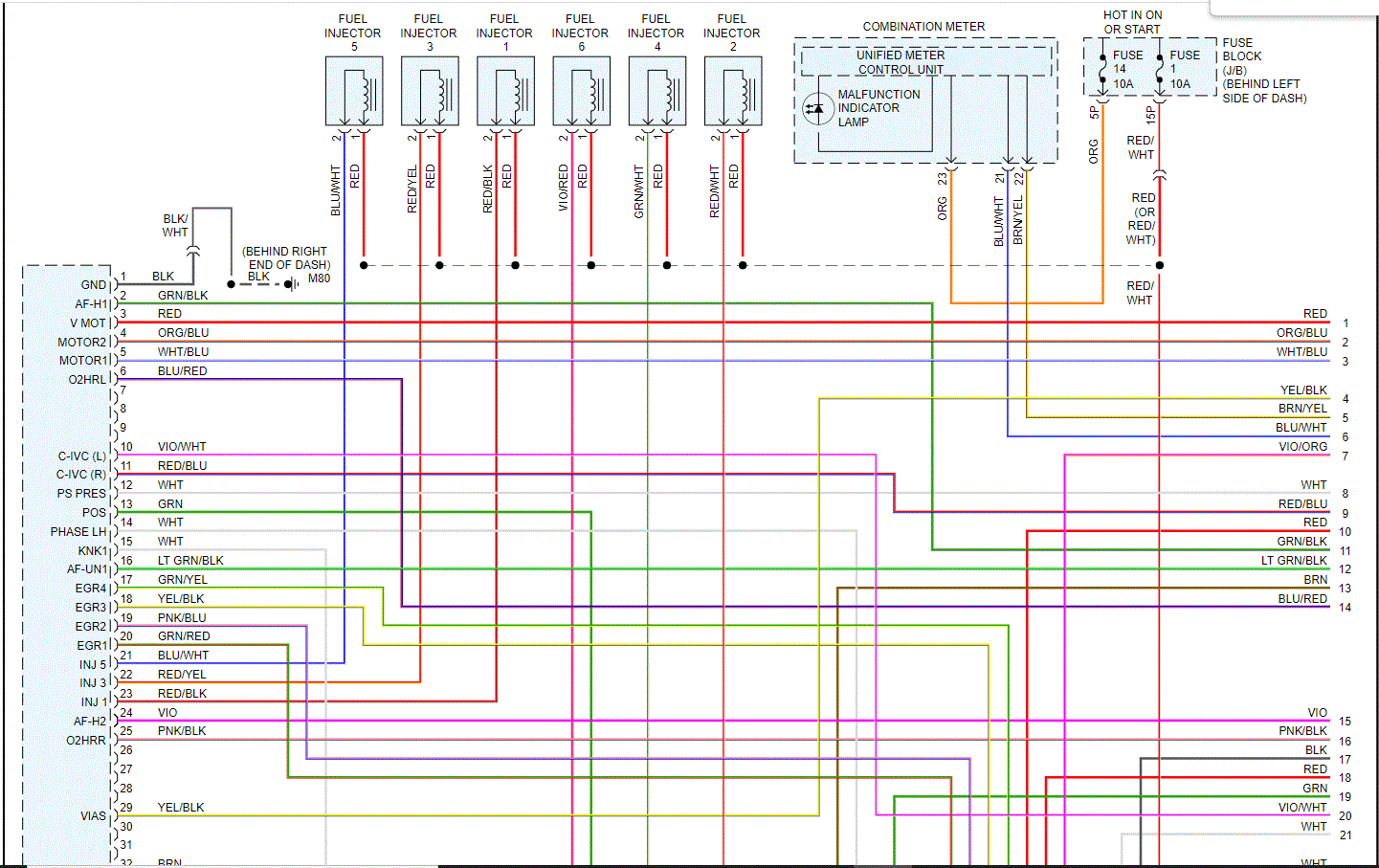

I just need to know what color wires go to which pin location car side harness i have a red, black , and a white wire with a bare ground. I also have an orange/blue and a white/green wire with a bare ground. I also have a white wire and a bare ground as well. On the plug side i have 2 red wires and a brown wire they are in one row of the plug. On the other row its white, black ,and yellow so my wires have to hook up to which of the wires on the plug.
Aug 12, 2021 at 2:51 PM

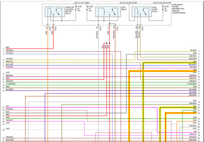

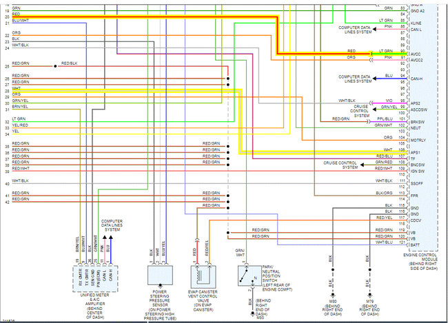

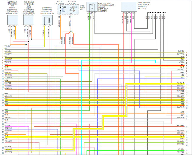

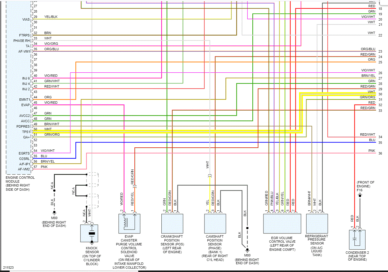

  • 110,244 POSTS
I don't know if you have made any progress, but noticed it's been a couple of days since we contacted you.
As far as the wiring, I attached the entire wiring schematic for the powertrain management below. Let me know if that is what you needed. I highlighted several of the wires you listed so you can find them easier.
There are 4 pages of wiring schematics for this. I had to cut each one in half to make them readable for you. I did overlap them so you can follow from one to the next.
Aug 14, 2021 at 3:15 PM
