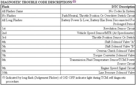

2000 Nissan Maxima Starter replacement - engine response pr
KEVIN E ANDERSON
Engine Mechanical problem
2000 Nissan Maxima 6 cyl Front Wheel Drive Automatic
Maxima has 85K - just had starter replaced by quality repair shop. Car starts and runs at low speed OK. When accelerating, engine revs up slowly, transmission slips and won't shift down, may finally shift but very hard. Had trouble getting to 45 mph.
Any idea what could have been diconnected or damaged while changing starter?
Jan 27, 2009 at 3:56 AM
ZACKMAN
  • 4,202 POSTS

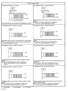

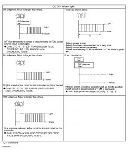

The only thing in close vicinity is the speed sensor. BUt before we rule the VSS, let's do this diagnostic to see if you have any codes in the TCM. TCM SELF-DIAGNOSTIC PROCEDURE NOTE: Flash codes are also referred to by manufacturer as Judgement Flickers. Preparation (I30 & Maxima) 1. Turn ignition switch to OFF position. Connect vacuum pump to throttle opener and apply 7.48 in. Hg vacuum. 2. Disconnect throttle position switch harness connector. Turn ignition switch to ON position. Check continuity of closed throttle position switch. Continuity should exist. See Fig. 15 . If continuity exists, see DIAGNOSTIC/JUDGMENT PROCEDURE . If continuity does not exist, check throttle opener and closed throttle position switch. Then increase vacuum until closed throttle position switch shows continuity. Diagnostic Procedure 1. Ensure selector lever is in "P" position. Warm engine to normal operating temperature. Turn ignition switch to OFF position and wait 5 seconds. Turn ignition switch to ON position, engine off. O/D OFF indicator light should illuminate for about 2 seconds. If O/D OFF indicator light does not illuminate, go to O/D OFF INDICATOR LIGHT under COMPONENT TESTS. Repair as necessary. Go to next step. 2. Turn ignition switch to OFF position, then to ACC position. Move selector lever from "P" to "D" position. Turn ignition switch to ON position, engine off. Depress and hold O/D switch in OFF position (O/D OFF indicator light on). Turn ignition switch to OFF position, then return ignition switch to ON position. Release O/D switch (O/D OFF indicator light off). Wait 2 seconds, then go to next step. 3. Move selector lever to "2" position. Depress and release O/D switch (O/D OFF indicator light on). Depress and hold O/D switch (O/D OFF indicator light off) until directed to release. Go to next step. 4. Move selector lever to "1" position, then release O/D switch. Depress and release O/D switch (O/D OFF indicator light on). Depress and release O/D switch (O/D OFF indicator light off). Depress and hold O/D switch (O/D OFF indicator light on) until directed to release. Go to next step. 5. Depress accelerator pedal fully (WOT) and release. Release O/D switch (O/D OFF indicator light to flash on and off). Record O/D OFF indicator light flashes. Where LONG light flash appears in flash sequence (1st, 2nd, 3rd etc.) indicates code. See Fig. 3 and Fig. 4 . Figure 3
https://images.2carpros.com/forum/automotive_pictures/55316_00maximajudgment_1.jpg
Figure 4
https://images.2carpros.com/forum/automotive_pictures/55316_00maximajudgment2_1.jpg
https://images.2carpros.com/forum/automotive_pictures/55316_00maximatcndtc_1.jpg

KEVIN E ANDERSON
Thanks for the reply, I have printed and will give to the mechanics. However, the Fig. 3 & 4 could not be read, even if enlarged to full page. Is it possible to have then resubitted.
Kevin

Zackman - FYI problem was Air Flow Meter, would not give a fault code, only failed on hard throttle, tech had to ride with driver to see fault happen. Dealer doesn't know why it would not put off a code. Car runs great.
Thanks - Kevin
