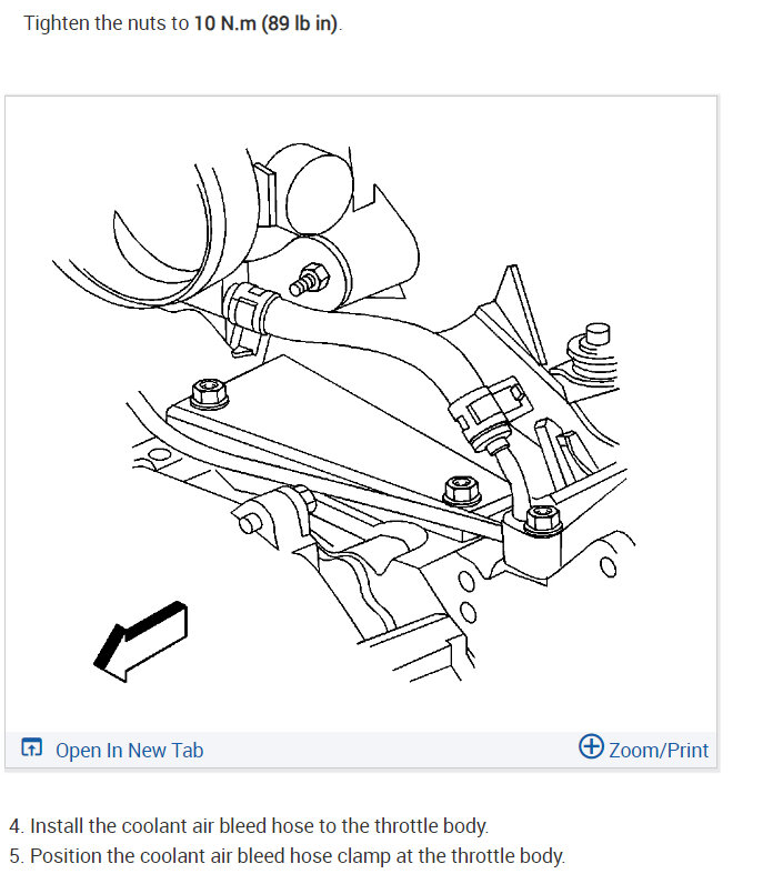

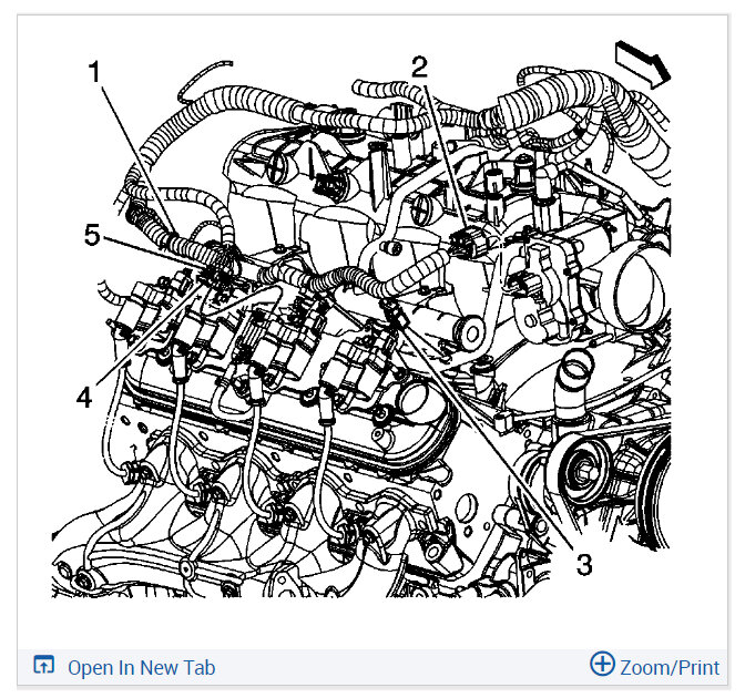

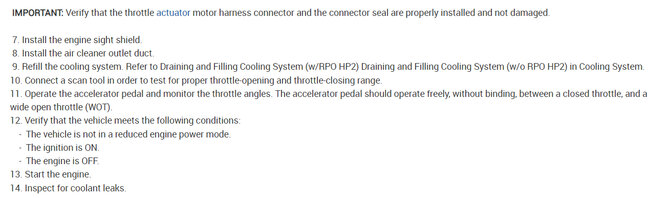

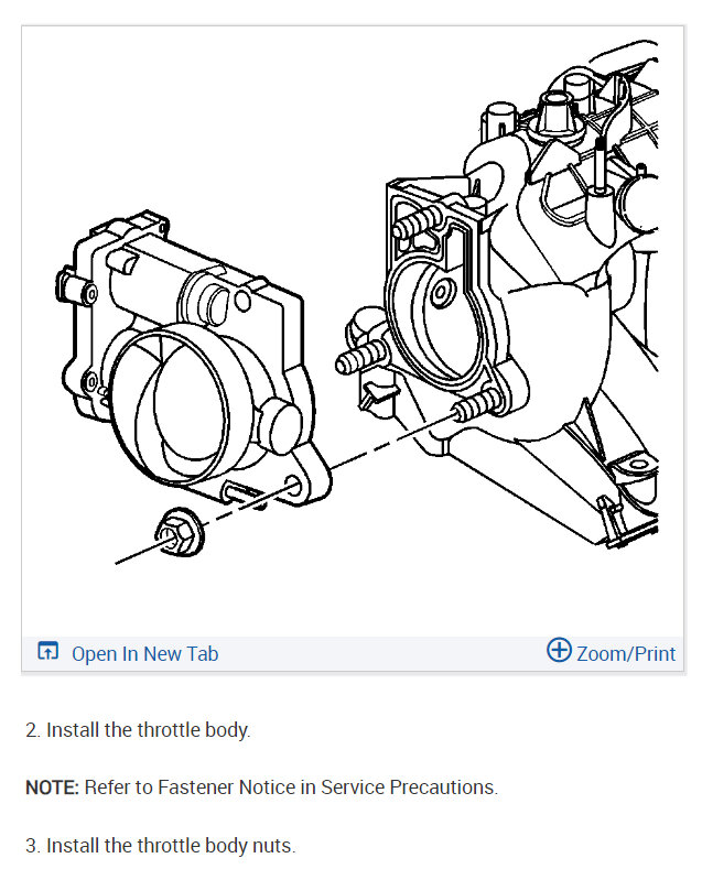

Can I ask which brand throttle body are you using?
P1516: This code is related to the Throttle Actuator Control (TAC) system.
P2135: This code points to a problem with the Throttle Position Sensor (TPS).
P0220: This code is also associated with the Throttle Position Sensor (TPS).
P0120: Similar to P0220, this code relates to the Throttle Position Sensor/Switch A Circuit.

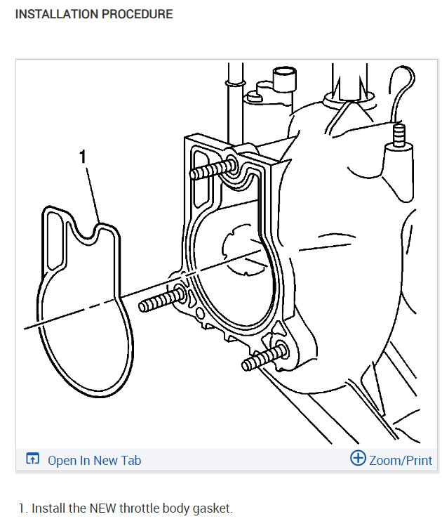

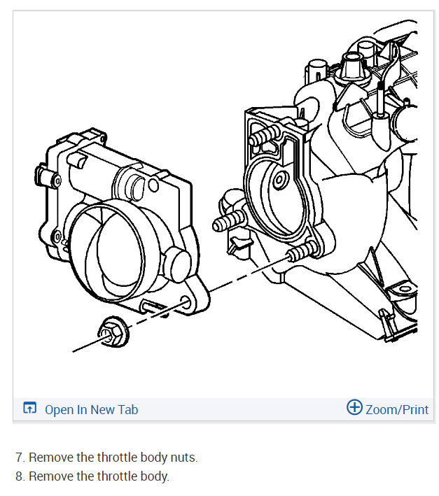

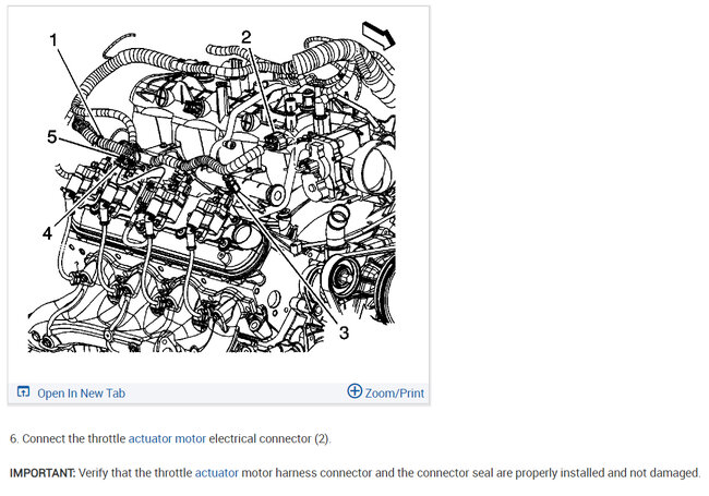

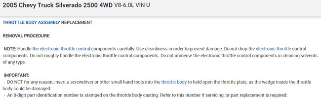

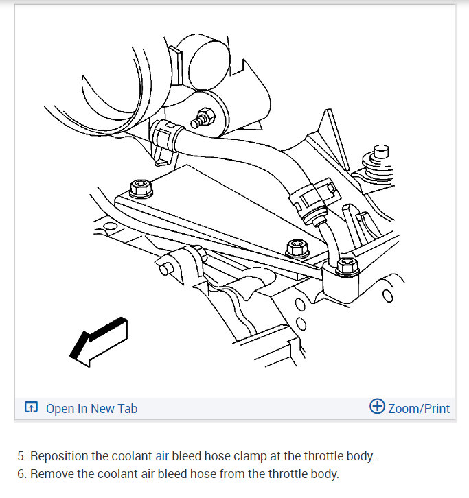

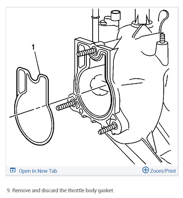

These codes are all pointing toward the throttle body. Which could mean the throttle body is bad or the PCM. Here is the correct way to change out the throttle body in case you need it.
Check out the images (below). Let us know how it goes.
