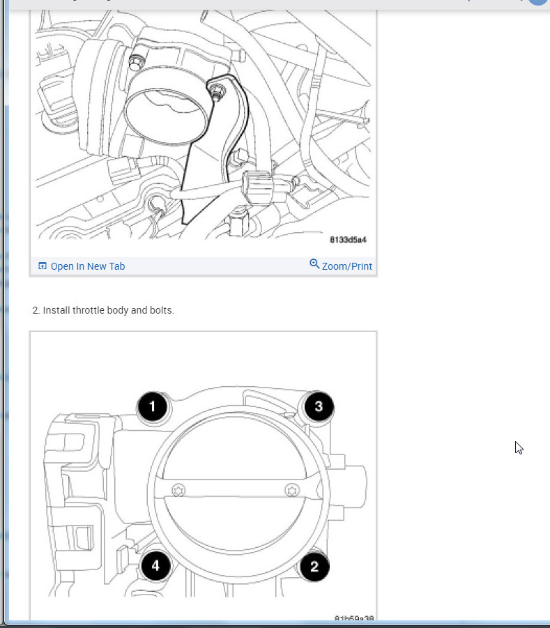

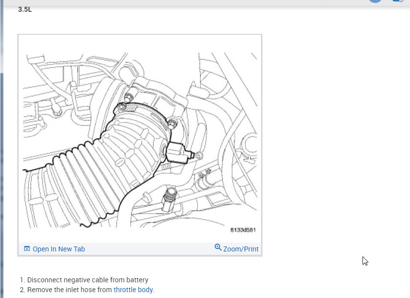

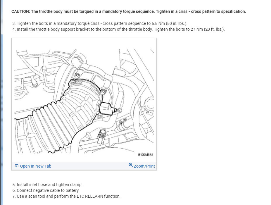

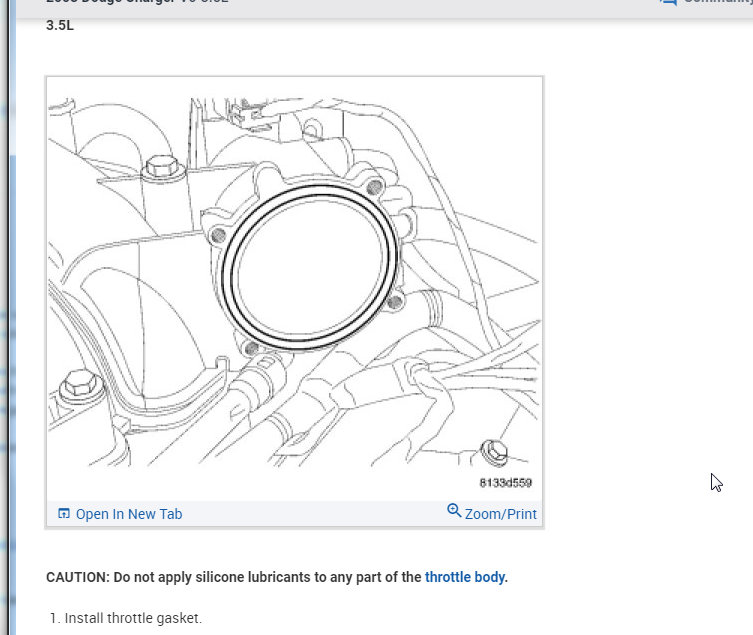

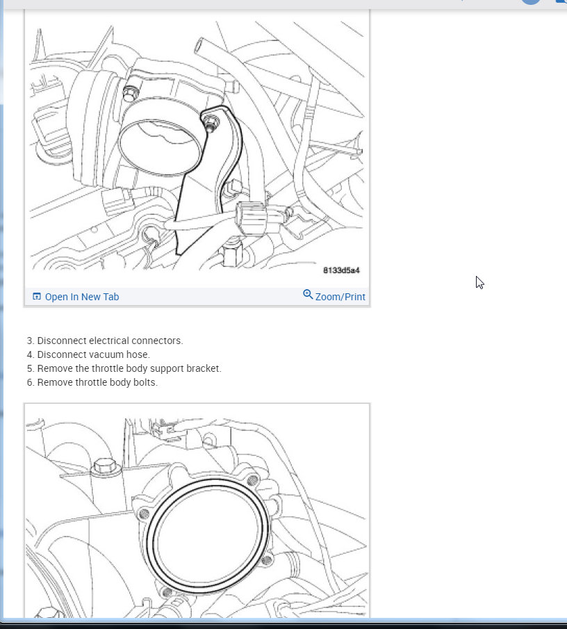

My throttle body needs to be replaced is this a bad thing?
Sep 30, 2020 at 7:57 AM
This is not an issue. There are a number of things that could cause this to fail and if it is the issue it is a pretty easy repair. I attached the process for your review.
Let us know if you have other questions. Thanks
