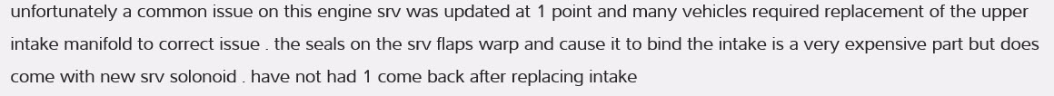

I got a 1004 code on my charger when I turn the key on 3 times. I found out it has to do with my short runner control valve. Is this correct. I have also noticed that I have some oil in my cold air intake which is a AEM brute force (after market). Is this related to that problem. I tried locating the pcv valve but I am not sure where it is at. I have read different post about where it is located and that the 3.5L doesn't have one. I have to smog it to register it. How do I fix this?

unfortunately this code will continue to come back until you do what is in pic and that means intake gasket replacement. pic explains the problem.
