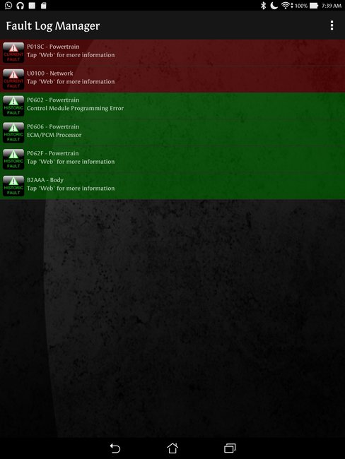

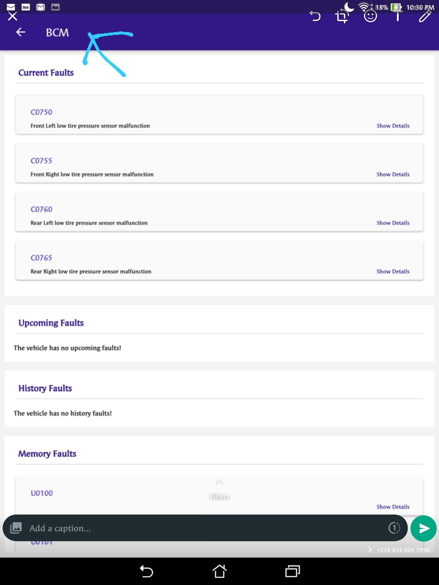

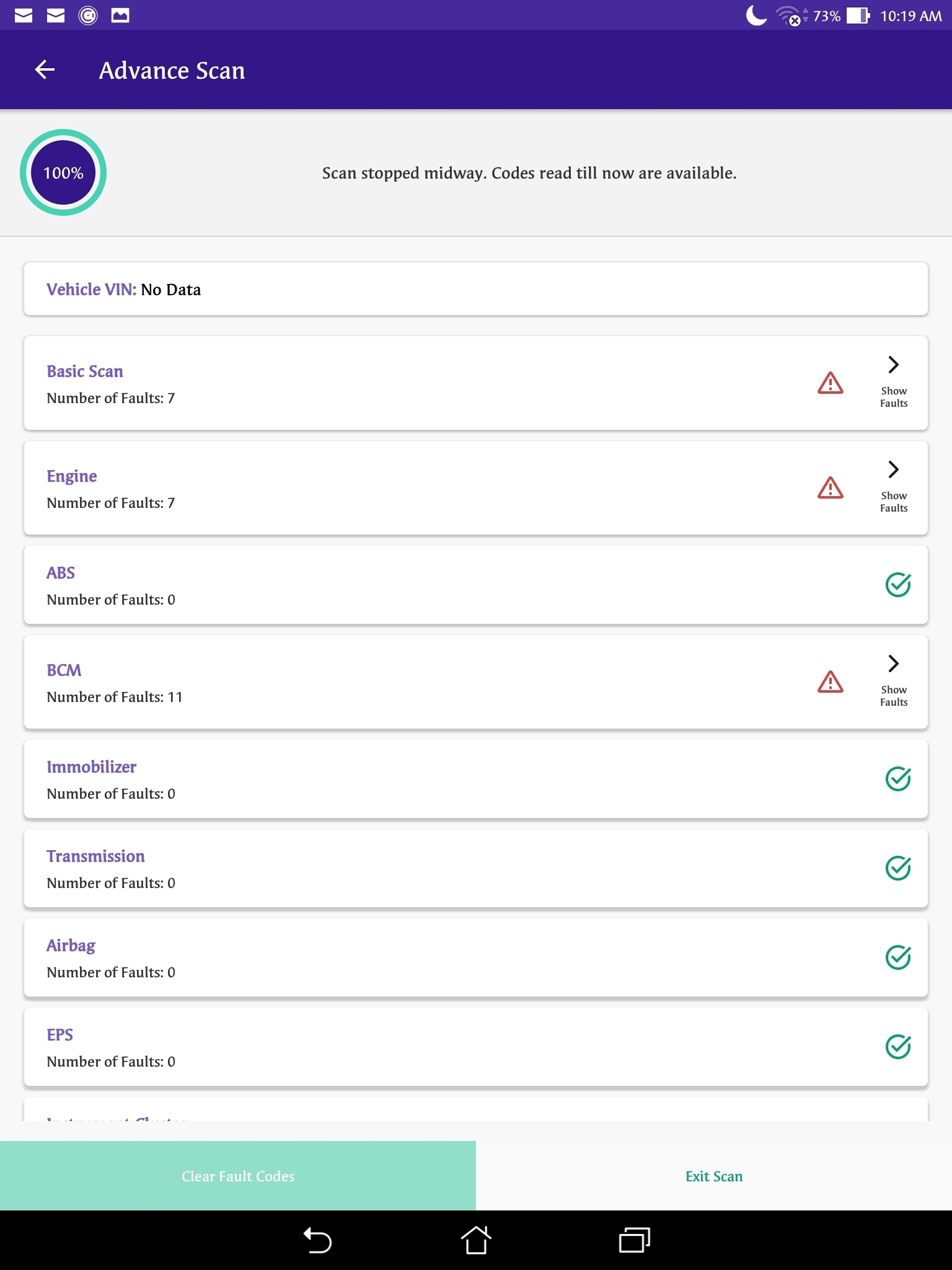

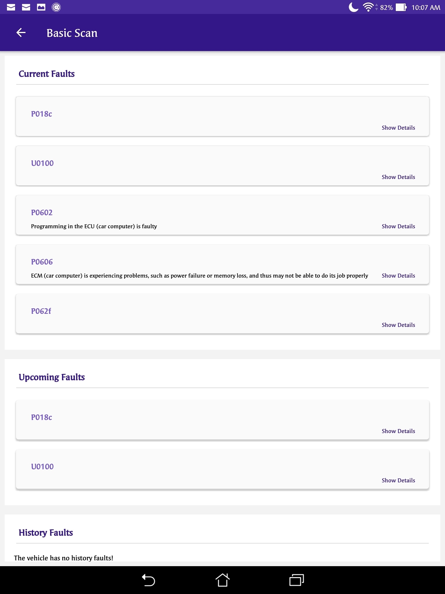

When I turn the Ignition on, the dashboard will come On but when I crank the whole light will go off and accessory relay will be clicking as you attempt to crank, I have check power to terminal 87 and there is B+ voltage and check ground terminal 85 and there was ground. Checked the control side of the relay by connecting test lamp to terminal 86 and 85 and turn ignition on and the light illuminates. What could be the problem is it the ECM?
Attached the picture of scan report.
Oct 1, 2021 at 4:43 PM

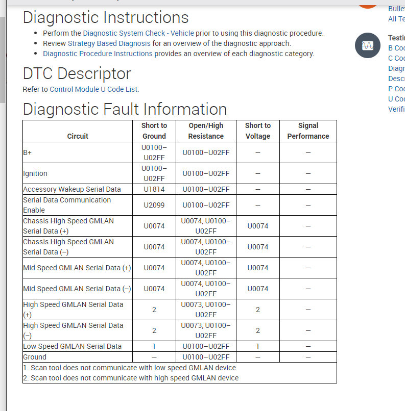

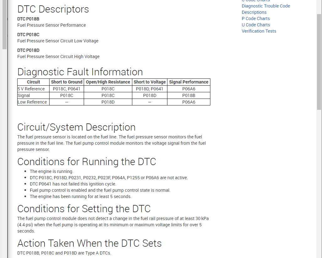

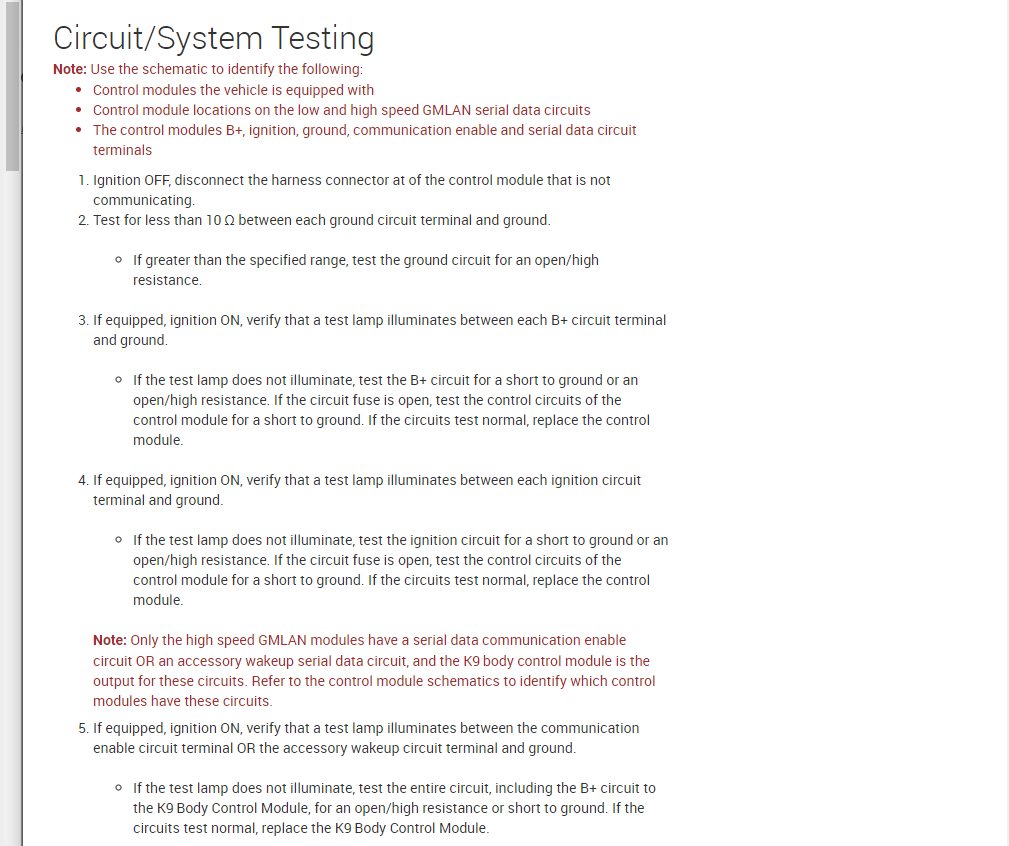

Yes. This can be the control module but before we get too far, we should run through the testing for these codes.

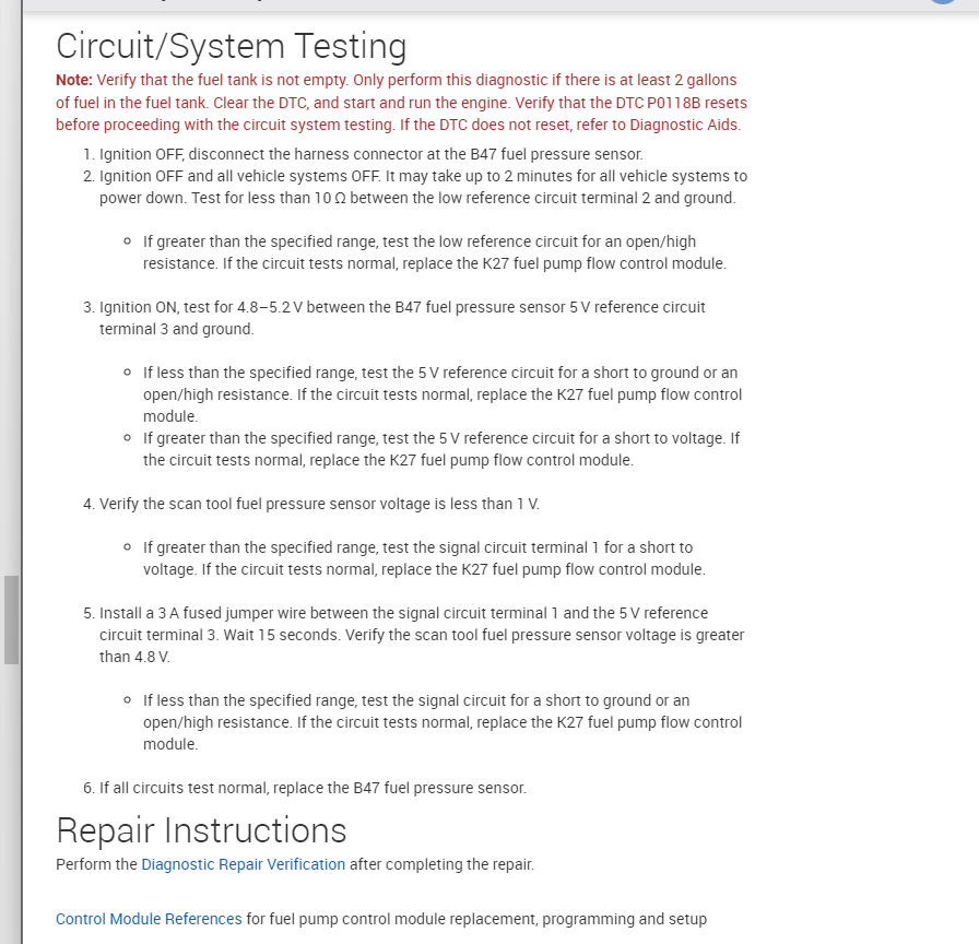

Here are a couple guides that will take us through the basics on this testing:

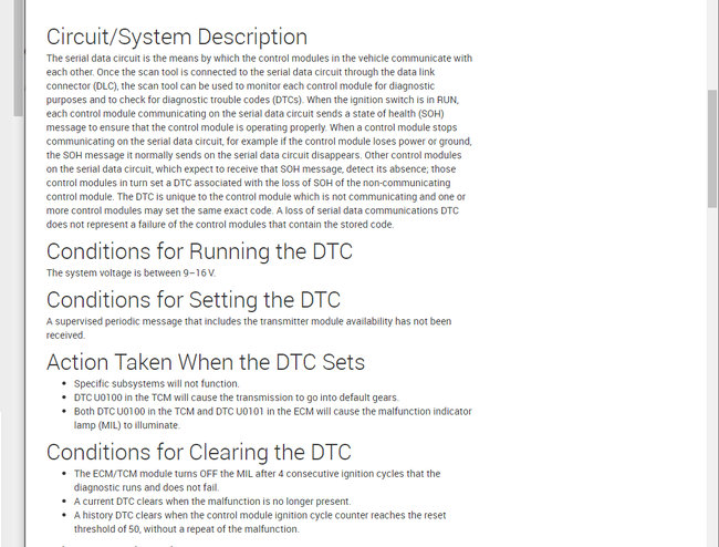

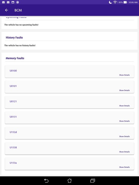

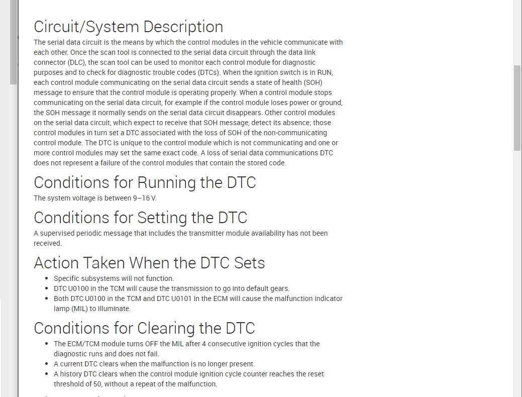

The U0100 is telling us that we have a communication issue which could be causing the fuel pump issue as well.
However, the only way we are going to know for sure is to turn through this testing and find out where we get.
I suspect you will have an ECM issue, but I would not replace that until this testing points there as well because that is costly to base that only on the info we have so far.
Please let me know what questions you have, and we can go from there. Thanks

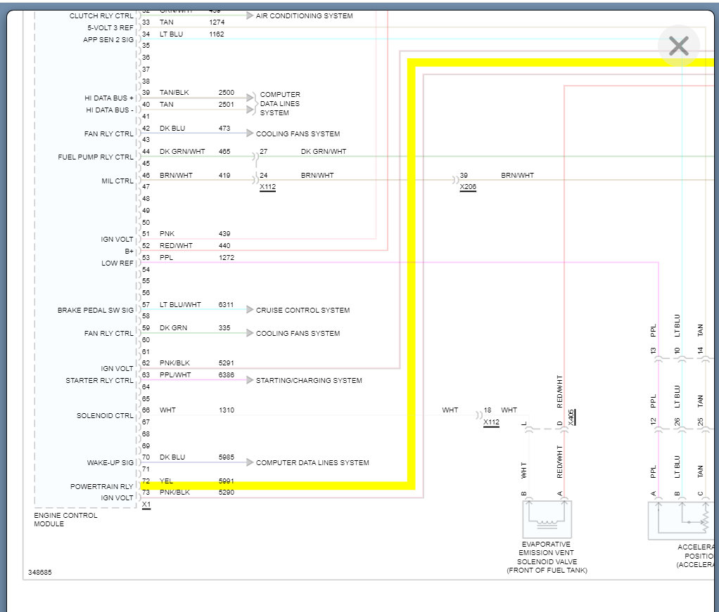

When I turn the Ignition on, the dashboard will come On but when I hold the at key start position, the whole light will go off and accessory relay will be clicking, this is where I am concerned, I want the vehicle to be turning over first before going to fuel pressure sensor diagnosis.
Oct 2, 2021 at 7:22 PM

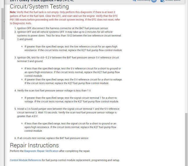

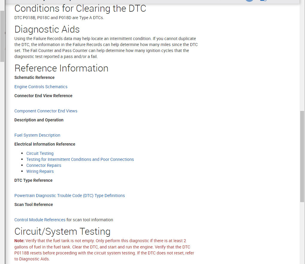

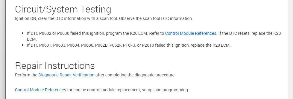

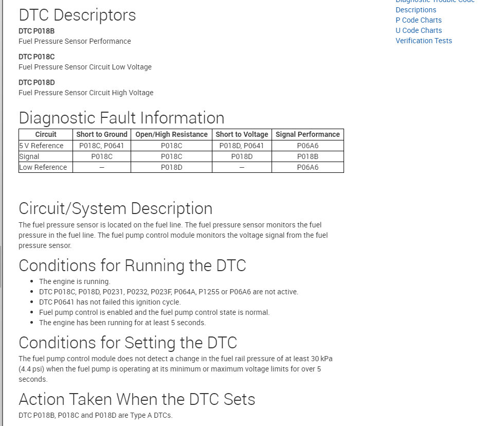

I understand. I suspect you have an ECM issue. So, the fact that you have these codes, I would run through that testing to see if it leads you to an ECM issue.
So, if this code takes you to a replacing the ECM, then you know you have to replace it for this code and that will most likely fix the issue you are wanting to start with.
However, you also have the U0100. Take a look at the first page of that diagnosis. This is telling you that you have an issue with the ignition and B+ circuit. This fits what you are seeing as well.
So, if you look at the circuit testing this code is having you verify that you are getting power and ground at the module that is setting this code. This code is telling you that this module is not communicating.
When you add that to what you are seeing, I suspect the ECM has failed.

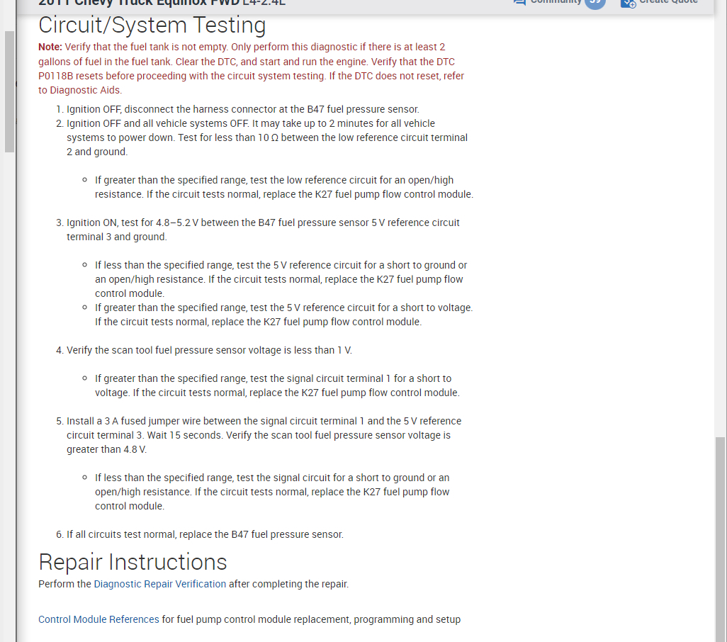

So basically, the best thing to do is chase the problems that you have codes for and not ignore them because it is telling you that this is an issue.

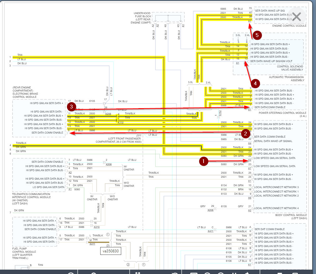

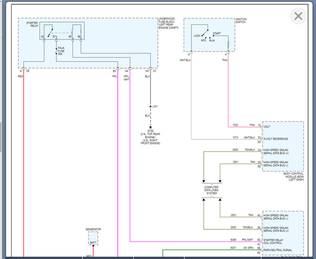

You can go through this and verify that the ECM is the issue for just the starting issue, but you are going to have to monitor the communication network with a specific scan tool.

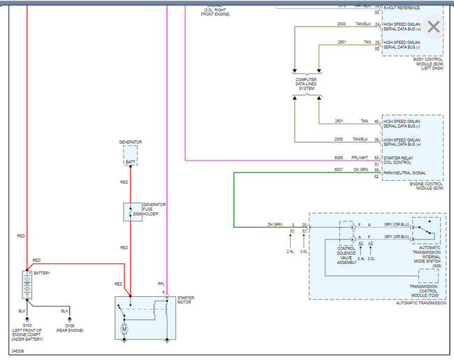

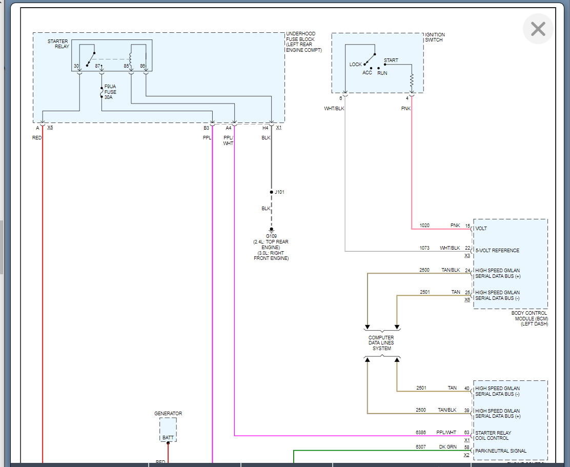

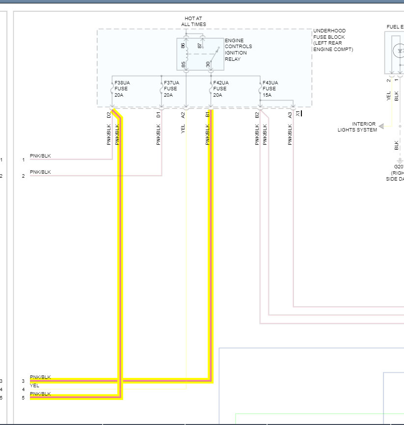

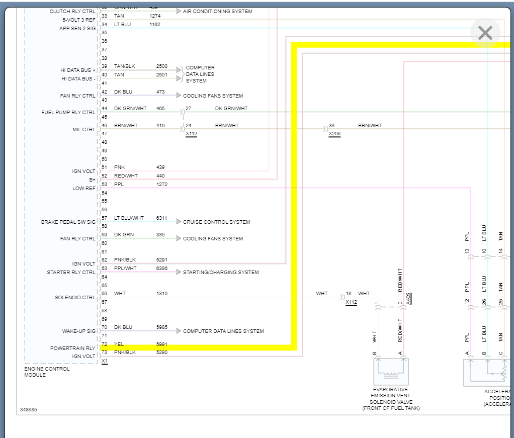

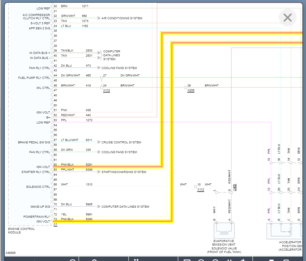

If you look at the wiring diagram below, you will see that when you turn the key to start, it sends that voltage to the ECM, then the ECM communicates with the BCM which would keep the dash on and that the engine is starting. This is the point you are getting all these issues.
This points directly to the ECM; however, I would want a little more info, so I don't replace the ECM for no reason. Which brings me back to the other codes. If the other codes, have you replace the ECM as well, then you know it is not a waste if it doesn't fix this starting issue as well.
If it doesn't then we have a bus communication issue and those are not the easiest to diagnosis without a scan tool that can monitor bus inputs.
This is just the approach that I would take but I understand if you want to go after the starting issue so let me know what questions you have about either direction. Thanks

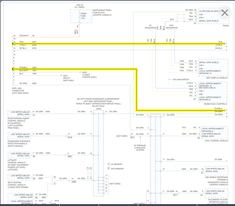

I have just finished the resistance test now and the results are as follows:
1. On the communication circuit: I set my multimeter on resistance mode, I put the positive lead on connector x6 terminal: 24 of body control module and x1 terminal:39 wire color-tan of ECM connector; there was no resistance. Again, i put on the connector x6 terminal 25 of body control module and x1 terminal:40 of ECM, there was no resistance showing that this is the reason why the code: u0100 is coming up.

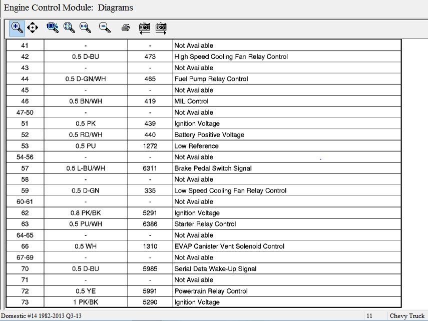

2. I removed the starter relay and positive lead on connector x1 terminal:63 of ECM and terminal:85 of starter relay...there was resistance. Then I put on the terminal:86 of starter relay and to negative battery cable testing for ground, there was resistance, I put on terminal: 87 still holding on the negative cable, the multimeter still beeping, i said no there's a problem, i change from negative to positive battery cable and still check terminals: 86,87 and 30 starter relay and all are beeping on the multimeter showing that there's short to voltage on the under-hood fuse box. what do you think?

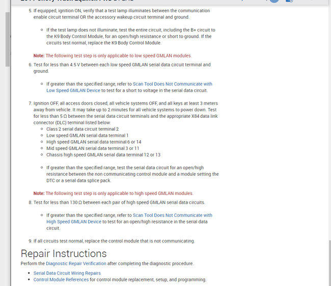

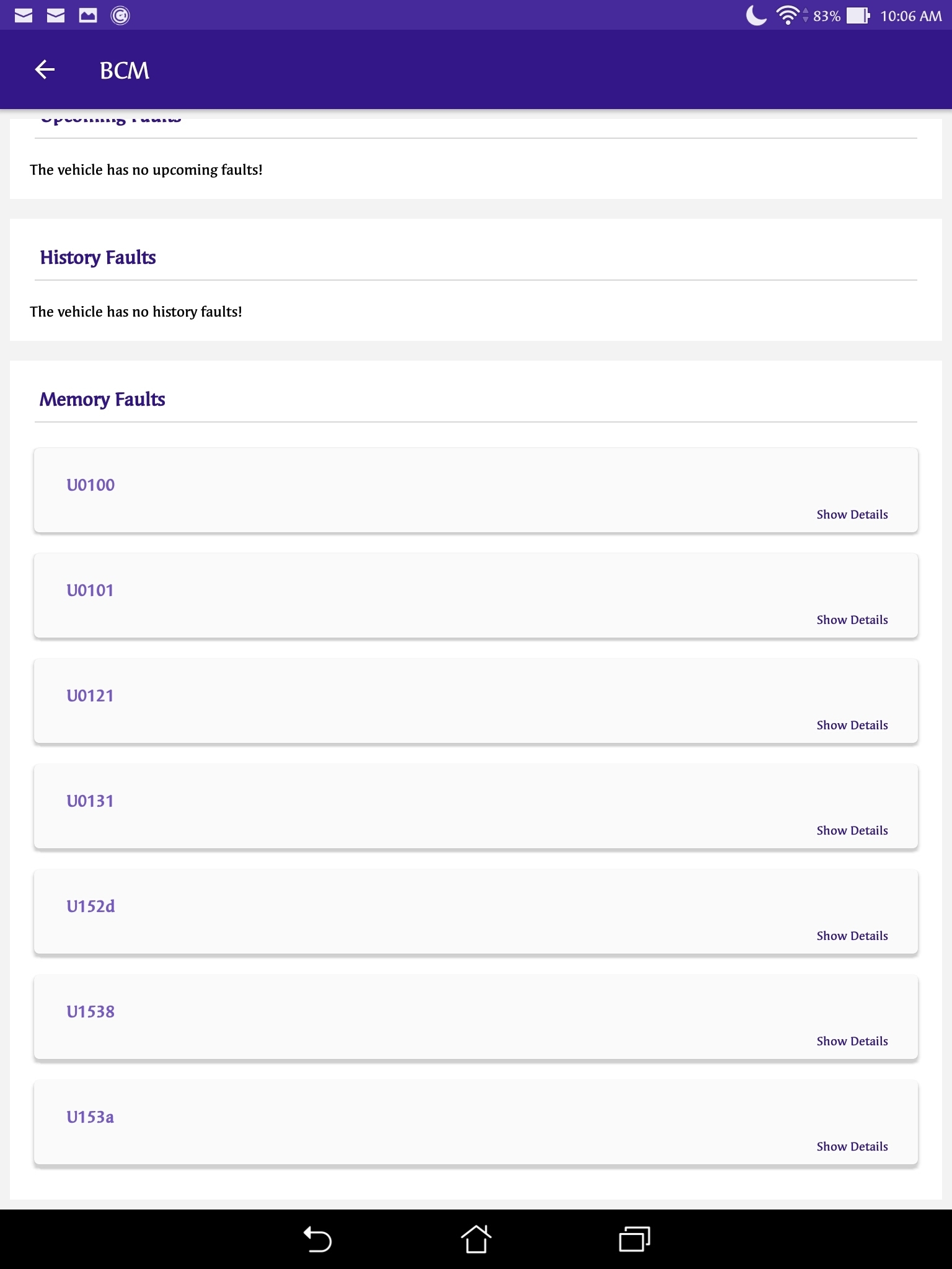

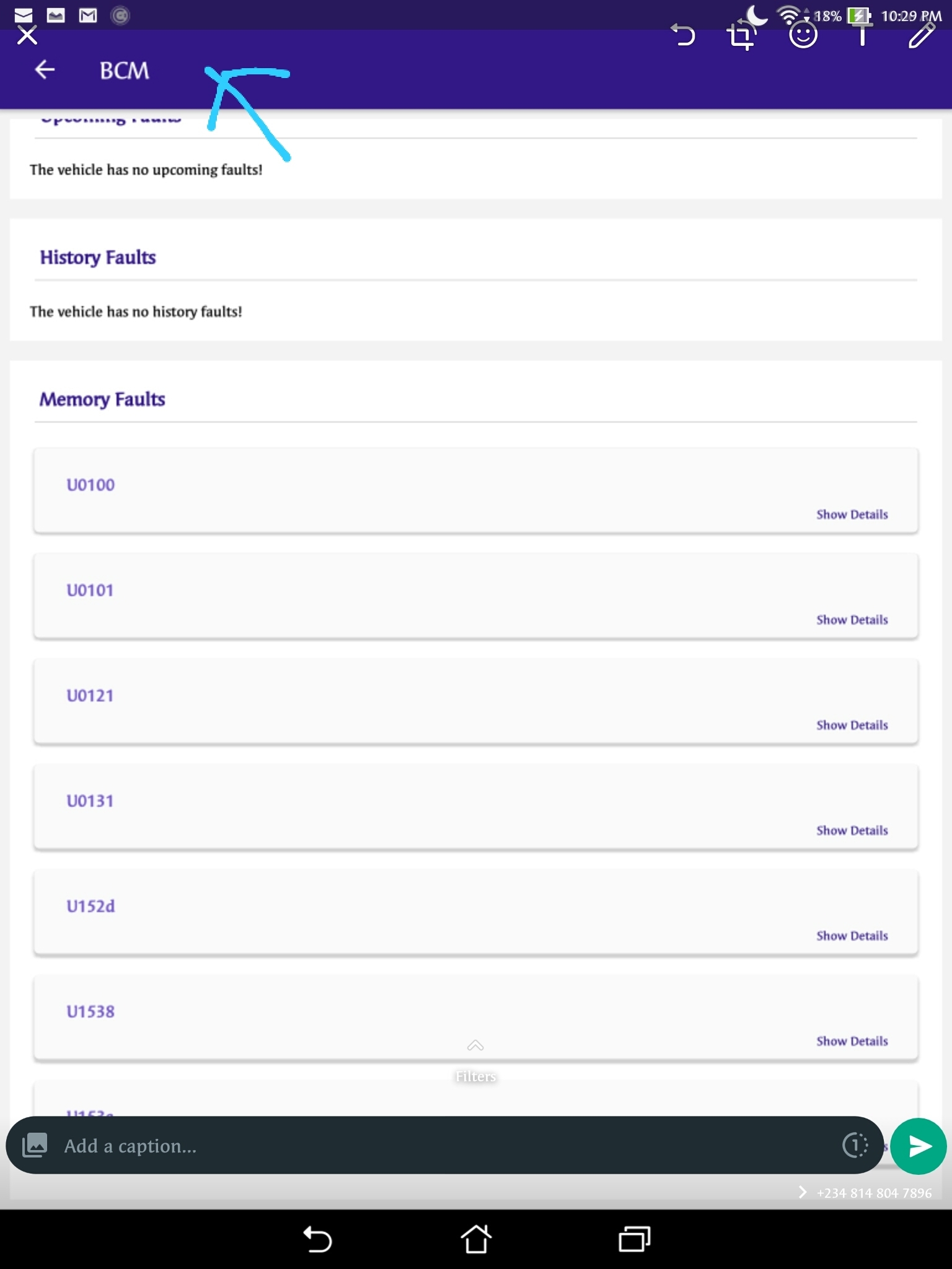

Couple questions on the U0100. Did you unhook the connectors from the ECM and BCM and check the resistance from end to end? If so, was the resistance 0 or was it infinite resistance (OL)?
0 ohms is different then no resistance or infinite resistance.
Also, these two modules are not directly connected through these wires. They are connected through the EBCM and TCM. So, if you have an open circuit then that would be due to the modules not communicating. It is very possible that you have an open circuit on one of the circuit boards, but this would require more investigation.
If you have continuity from battery positive to pin 86 and 87 then you do have a short. If the key was off, then 87 should not have continuity to battery positive as this is the path to ground for the switch side of the relay.
So, it sounds like you are onto the issue with the fuse block.

Yeah, I check it and it was OL.
I even check from DLC to ECM and there was no continuity but from DLC to BCM, there was continuity showing BCM is the main module that handles communication instead of ECM.
Also, these two modules are not directly connected through these wires, since the wires are not directly connected together, how do I know if the BCM sends start command to ECM? Because this is where the problem lies?

The reason you had no connection from the DLC to the ECM is because the DLC is connected to the BCM and then the BCM facilitates communication with all the other modules.
Unfortunately, the way we are going to have to check this system effectively is to scan the communication network and find out what modules are not communicating.
Here is a video that shows how to do this:
https://www.youtube.com/watch?v=InIlnsjOVFA
Doing the continuity check on this network will only work if you are checking the wiring from module to module. Basically, just the wiring between modules is good for this.
There is one other check that we can do without the scan tool and that is checking termination resistance. This is done by disconnecting the battery and then check the resistance at the DLC on pin 6 to 14. This network requires two modules to be what are called terminating modules and that creates the ability to communicate on this network.
If this resistance is not correct, then you will have communication issues. Let us know what this is, and we can go from there. Thanks

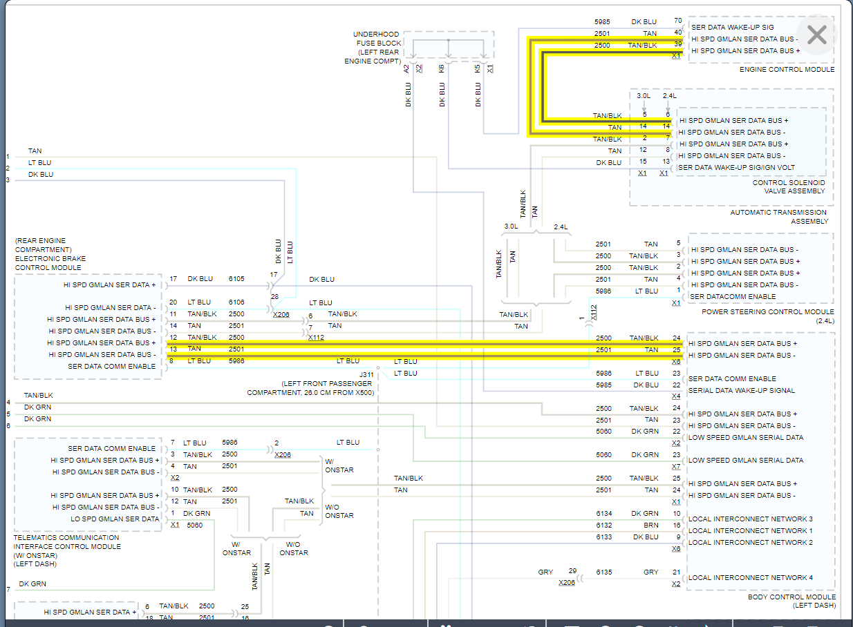

Looks like we still have a network issue. When you checked the resistance of wires from the BCM to the ECM and had no resistance means we have an open circuit between these two connectors.
So, you need to go to the BCM X6 pin 25 and the brake module pin 13. We need to make sure we have about a half ohm of resistance. Then we need to do the same from the brake module to the power steering. Then power steering to the TCM. Finally, from the TCM to the ECM.
These modules are what are called daisy chained. Meaning if one has an issue then all others behind it will not communicate. So, if the ECM/TCM is the issue we need to make sure the wiring from the power steering to the TCM is in intact unless you are not able to communicate with the other modules as well.

Correct. You need to use a multimeter set to ohms.
Then you disconnect the connectors at both modules and connect the meter leads at both ends of the circuit. This guide talks about how to do this:
Basically, you are just testing the single wire and if you have less than a half ohm of resistance then the wire is intact. If it is OL or high resistance, then that means you have an issue with that wire between these two points.

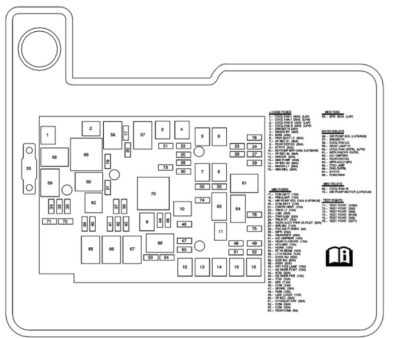

1.Again what value can mean a half ohm?

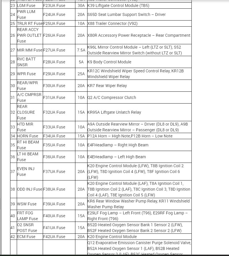

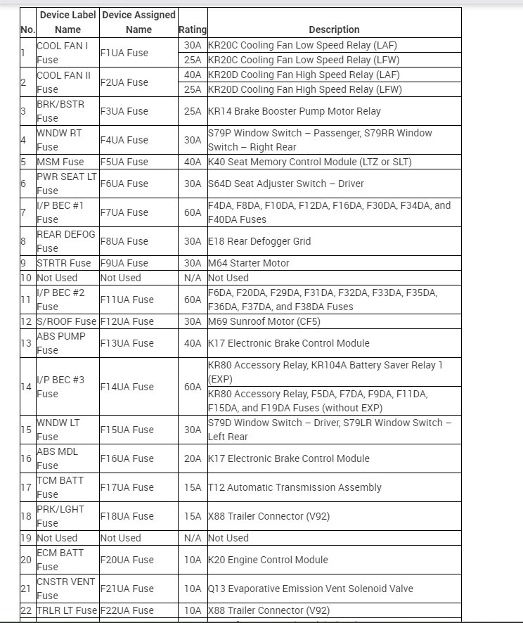

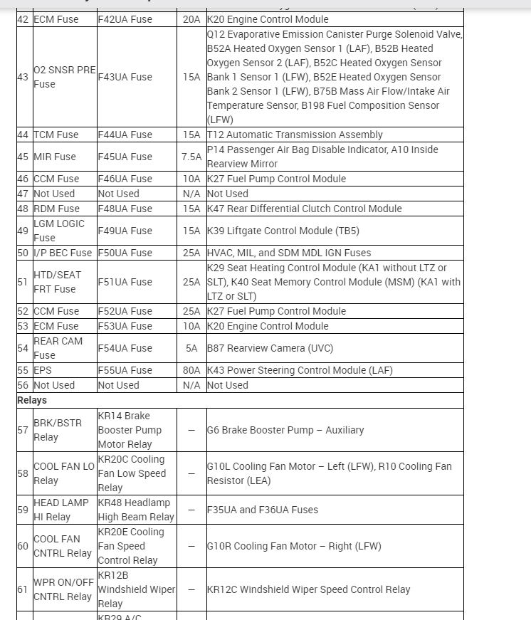

2. I want to check the ECM fuses 20,42,53 and how the circuit move from fuse box I cannot communicate with radio or nav via scanner to read any codes to ECM I cannot communicate with radio or nav via scanner to read any codes, In case there is open circuit within the fuse box?
Nov 18, 2021 at 7:12 AM
I don't understand what you mean when you are looking for a value of a half ohm. The meter will show 0.5 ohms or less, if that is what you mean?
Good idea about the fuses. However, the best way to tell if they are okay is just go to that circuit on the ECM connector and check for power.
If you have power at the ECM then the fuse and fuse panel are fine.

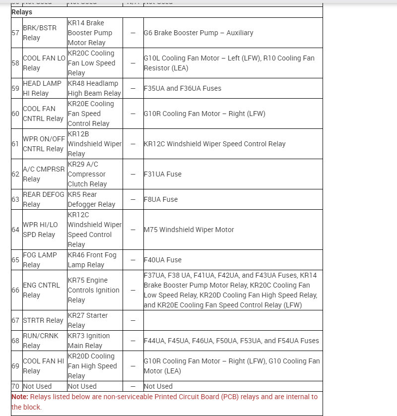

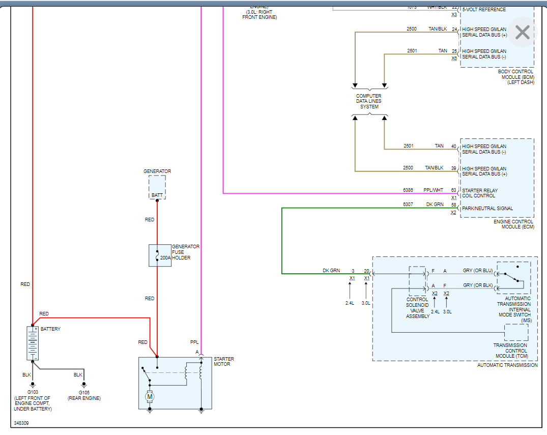

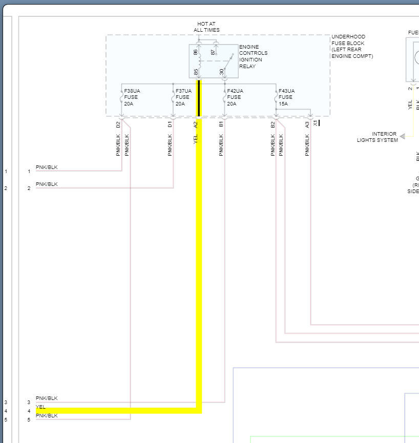

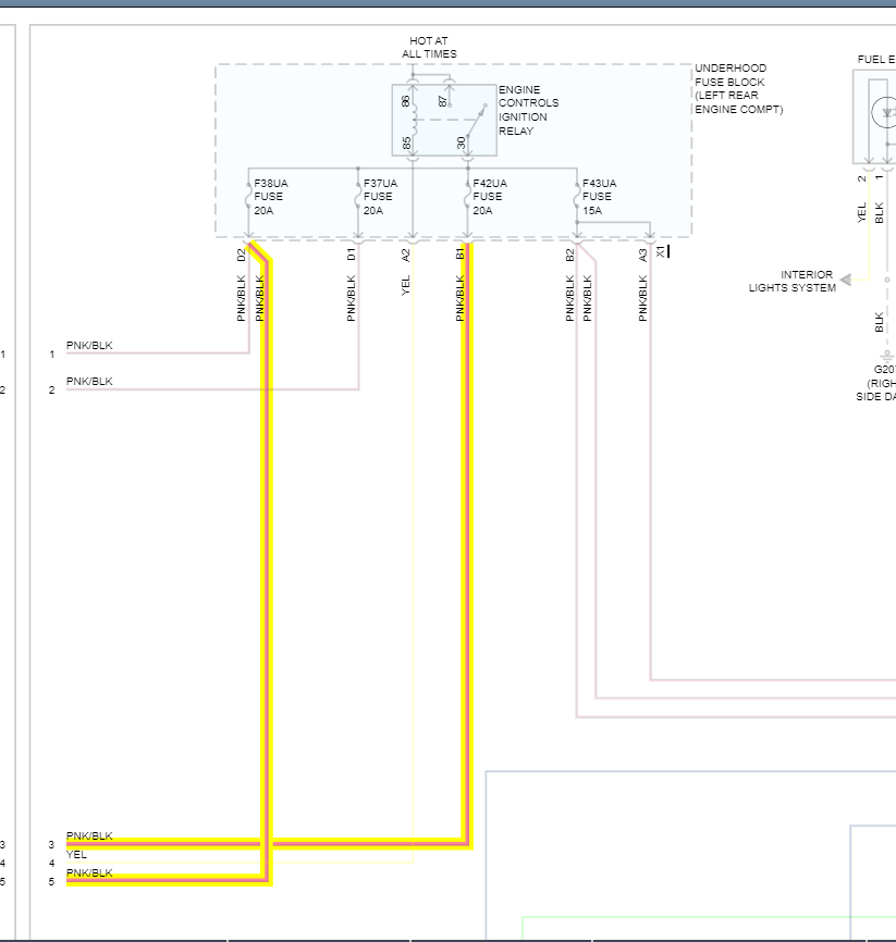

Good evening, friend!
Thank you so far, but please I want you to help me and analyze this.

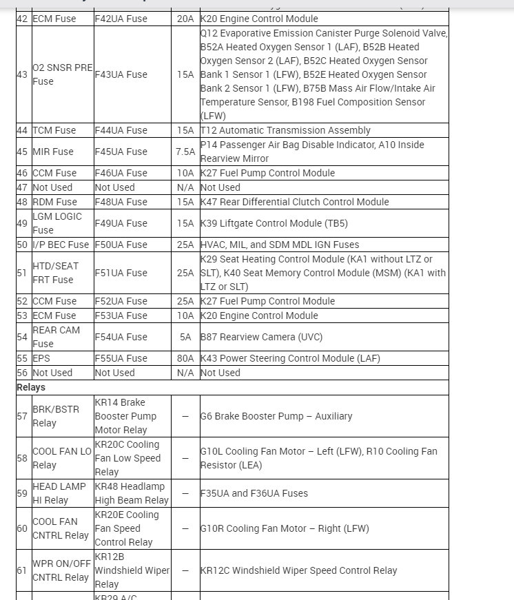

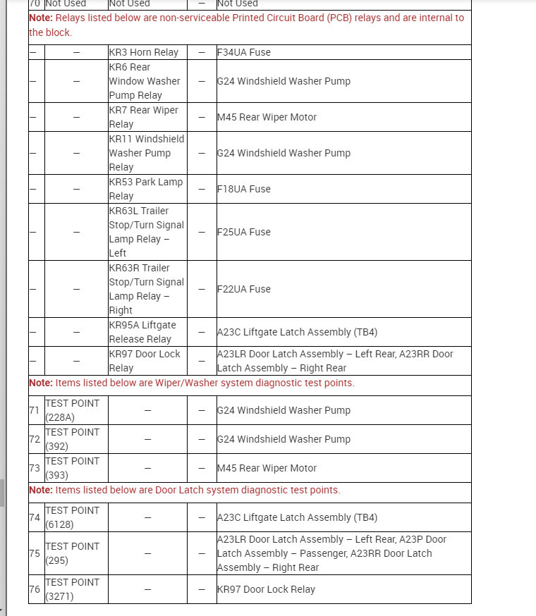

From the picture below, I check ignition voltage on ECM Connector X1(LAF )51 using test lamp and it illuminated brightly. I also check battery voltage to ECM on XI(52) and it illuminate brightly. Then I further check X1(62) for ignition voltage using test lamp it didn't illuminate, I also checked X1(73)for ignition voltage, but no way it didn't, what could cause?
Nov 24, 2021 at 6:24 AM
Both of these circuits are powered through separate fuses and then a single relay that is controlled by the ECM.
So, the way this works is when the ECM wants to power these ignition circuits, it grounds the relay from X1 pin 72. It provides ground on this circuit, so you need to check that by putting your test light on battery positive and then this terminal and if the light comes on then the ECM is grounding that relay.
If that is the case, then either both fuses are blown, or the relay is not closing.
Let me know if this does not make sense because it is important to test it properly or you will get false results.
Nov 24, 2021 at 11:33 PM

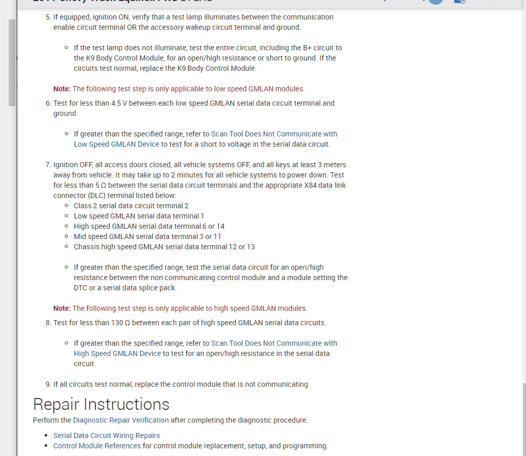

Okay. That is great however, if you replaced both the steering assembly and ECM we don't know what is causing that issue.
When we are doing something like this, you always want to only replace one part at a time so that we know what was causing the issue.
However, at this point, I would suggest just going through the testing as the vehicle sits and then repair what you find with that testing.
I attached it below.
Nov 27, 2021 at 4:25 AM

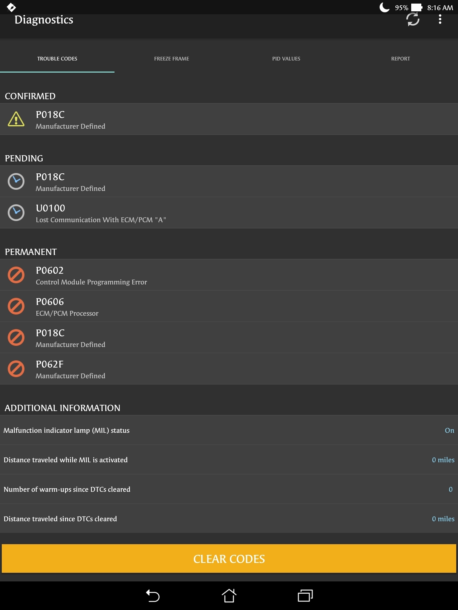

Hello!
Thank you once again.

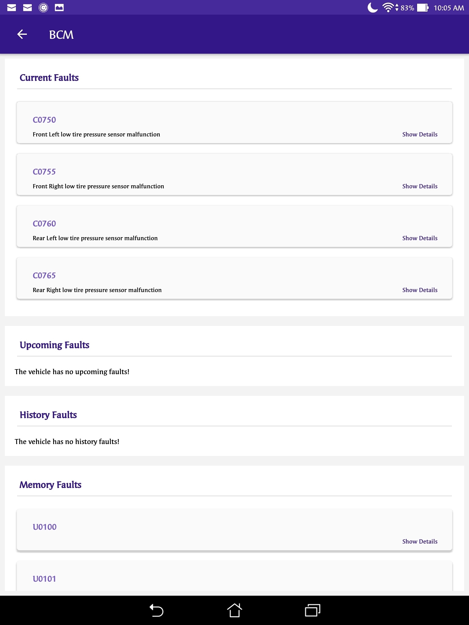

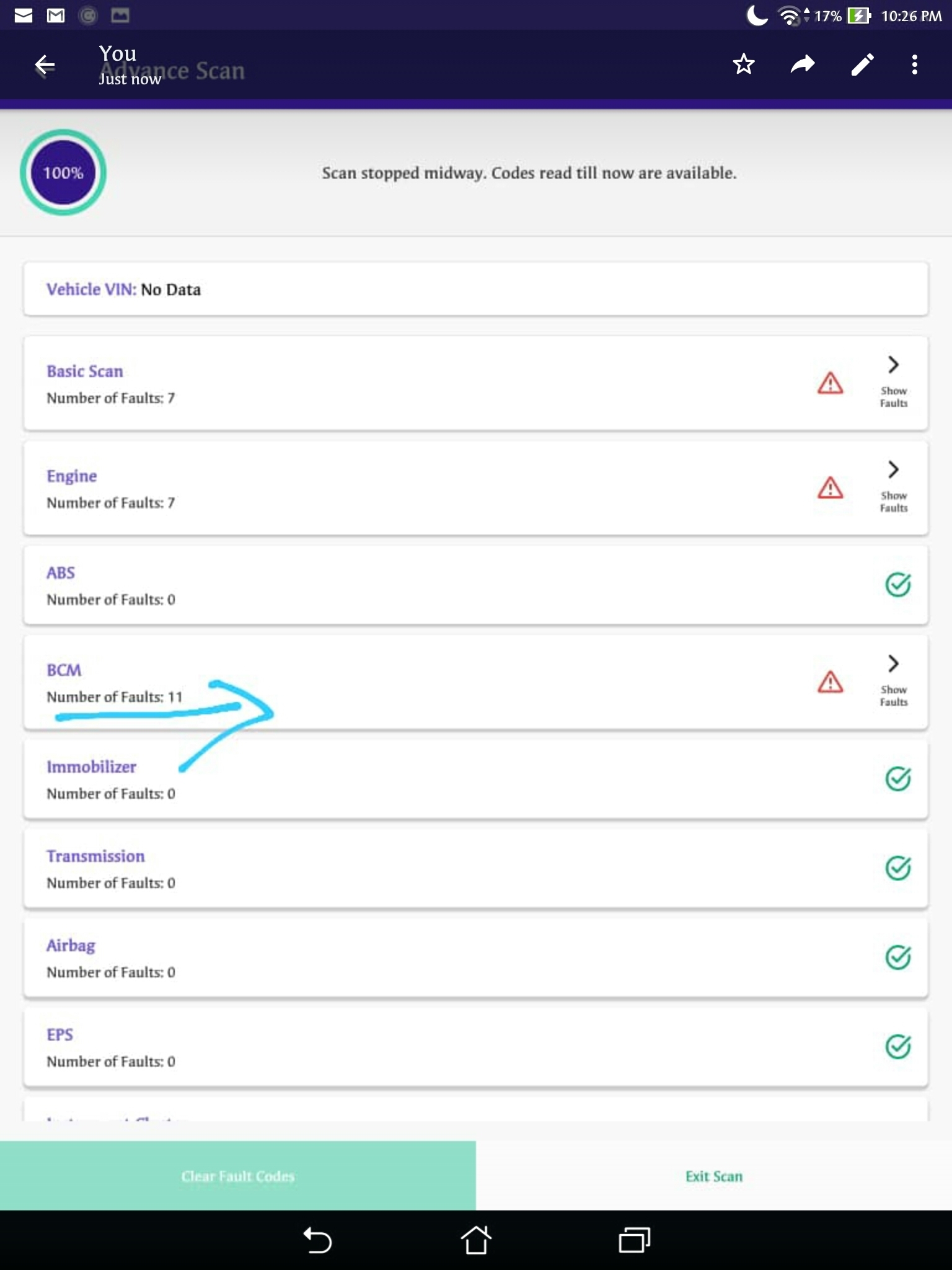

Yesterday I did a lot of testing starting from putting the old ECM and power steering module, and I diagnosed the vehicle, and it stated as follows:
1. Stored fault -p018c
2. Pending fault- p018c and u0100
Permanent fault- p0602, p0606, p018c and p062f.
Then I disconnected the old ECM and put the New ECM and diagnosed it, it displays the same code and added B3055 (No transponder modulation).
At this point I said let me disconnect the ECM and try to connect without ECM and to see if it can communicate, as I disconnect the ECM, the Check Light went off and I connect, it connected, and I scanned it still display all those codes. At this point I was confused and said this is not the problem of ECM or power steering but BCM. then I used another scanner to scan, and it display as follows, look at the pictures below, the first picture was when I changed the 2 ECM and scanned. The second, third, fourth and fifth was when I disconnected the ECM entirely and scanned only the BCM with another scanner.
Nov 27, 2021 at 4:49 PM

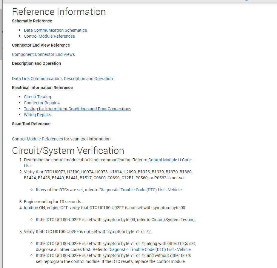

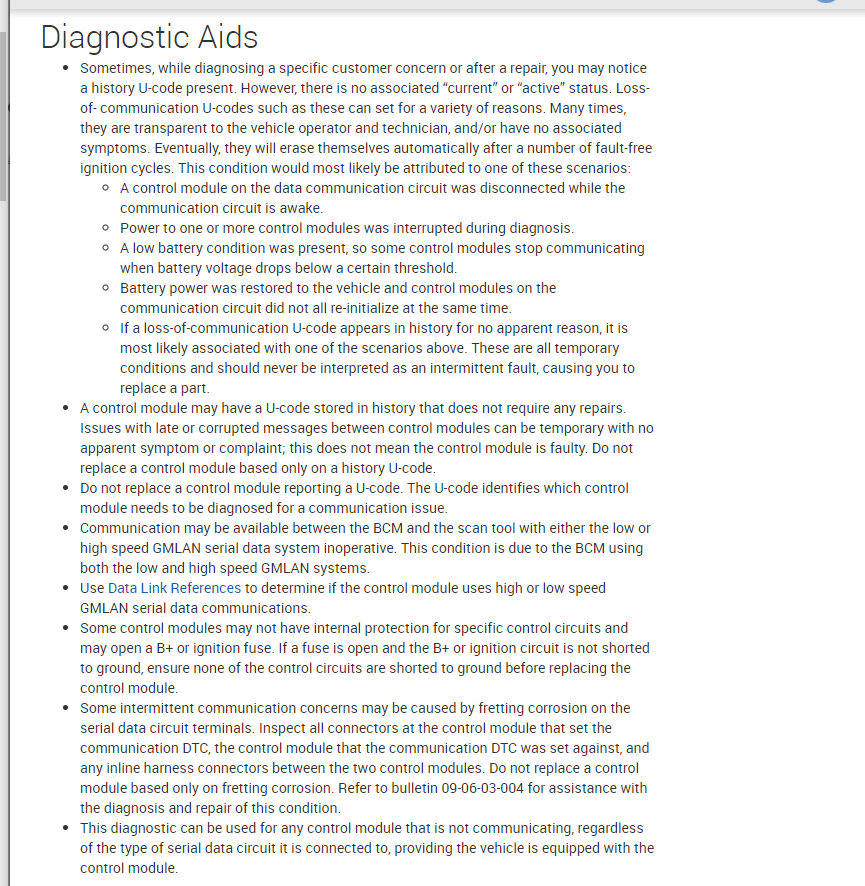

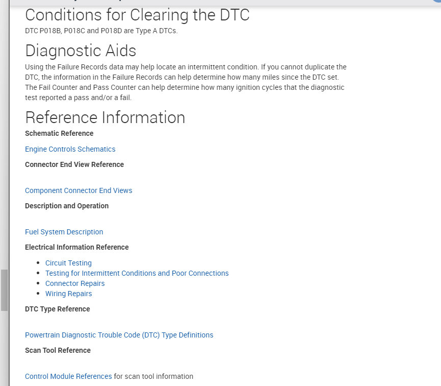

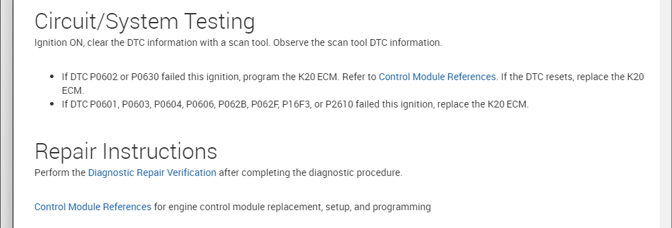

Okay. I think we need to step back and make sure we are following the testing on the info that the vehicle is giving us.
Disconnecting the ECM and checking for codes is going to give all sorts or different codes so we can't trust any of these codes at this point.
The only good info that provides is if you can not able to communicate with any modules using your scan tool and then you disconnect the ECM, and it restores communication to all other modules. If that is what is happening, then your ECMs are faulty.
However, if you hooked the first ECM back up and have the same codes plus the failed ECM codes then that ECM is faulty.
Then if the second ECM has these codes (P0606, P062F, etc.) then that ECM is faulty as well.
Take a look at the info below on these codes. There is no testing required, basically if you have these codes, you replace the module.
At this point, I don't know if we have a module issue and a scan tool issue that can't communicate with this vehicle, but one thing is clear that if you have these codes then your ECM is no good.

Yes, I do. Yes, I am starting the communication process again.
Note: It is very dangerous to leave your scanner plugged-in while unplugging and plugging the battery head because it can easily flash or bricked the scanner.
Again, from the design of this vehicle, that code you are referring to ECM might not be the ECM actually, it might be the BCM that's why the communication failure codes are stored there.
Nov 28, 2021 at 4:43 AM
Maybe I missed that information because I didn't see it noted on any of the info that these codes were stored in the BCM.
In short, you are exactly correct.
ECM doesn't always mean Engine Control Module unless this issue is related to the Engine/Powertrain Control module. Otherwise, this code is talking about any ECU that this code is set in.
So, if you have this code set in the BCM then you need to replace the BCM as you are suspecting.
Nov 28, 2021 at 5:07 AM
MALLYBOY
  • 329 POSTS
Otherwise, this code is talking about any ECU that this code is set in. Yes, look at the pictures below.
Those codes P0602, P0606, P018C, and P062F are permanently stored in the BCM memory. Even if you disconnect PCM and scan, you will still have them back, if you still plug the PCM, you will still have them. So, the best thing is to find another BCM and plug it in, if those codes disappear, then the BCM was flash or bricked.
Nov 28, 2021 at 5:32 AM
Yep. I missed that. I apologize. If those are in the BCM then it has failed. So, if I mislead you based on the fact that I thought these were setting in the ECM.
Nov 28, 2021 at 5:39 AM
MALLYBOY
  • 329 POSTS
Thank you so far for your support and assistance.
I have come to tell you that i have solved the problem of the vehicle and it started yesterday morning.
Procedures are as follow:
1. The vehicle does not read vin number.
2. My Bluedriver scanner which i entrusted so much was unable to communicate with it but my obdlink and obdii does.
3. I disconnect the new steering and plug the old one and the same problem of not starting still remain.
4. I trace all the communication lines, and all are correct and still display ECM, power steering and TCM not equipped
5. Finally, i leave the battery head plugged-in and disconnected BCM sockets. I try to connect scanner when i turn ignition on, unfortunately there was no power to the dashboard and scanner could not connect.
6. I open the BCM box to visually inspect for any damage on the board but i could not see any, i couple it back and when i was about to connect the BCM sockets, which was when i removed the battery head and immediately after connecting those sockets, i put it in battery head and the central lock shoot. I still used test lamp to probe BCM terminal that carries ignition power to ignition switch and i turn the ignition on and then off, the ignition remains on, i did it for three times before i removed the test lamp i used to probe the BCM terminals. Ignition went off and i turn it on and connect scanner it connected and read vin number, i cranked and it started. I recheck communication using Bluedriver as it was not connecting before, and it connected and read few codes on ABS and engine. So that's how i technically reset the BCM and solve the vehicle problem.
