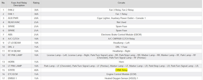

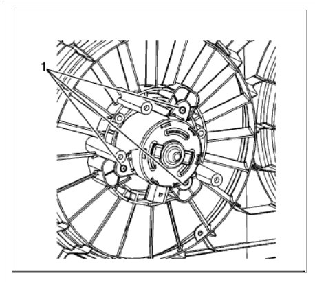

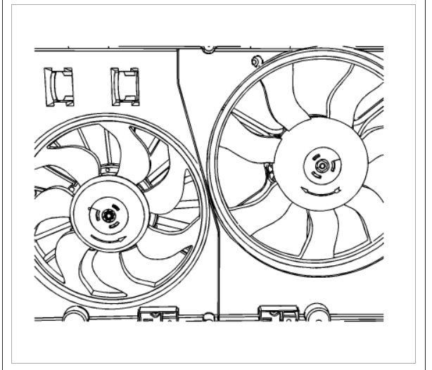

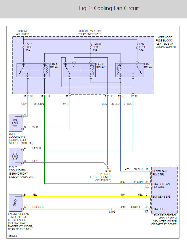

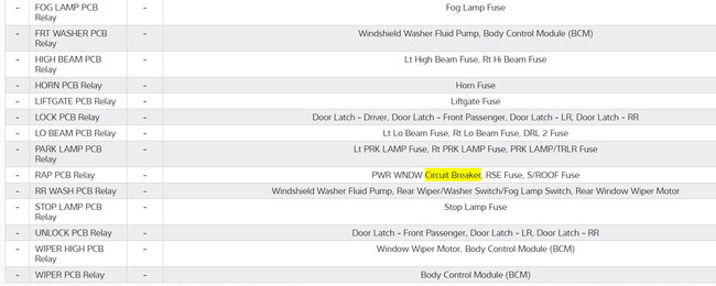

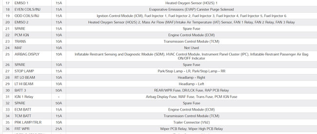

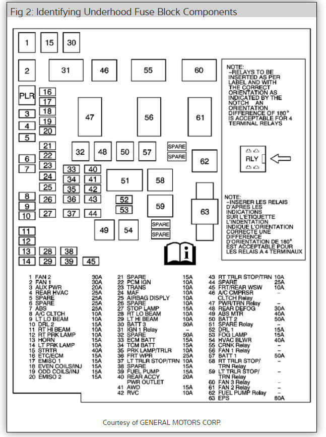

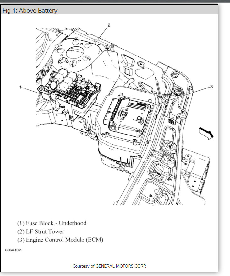

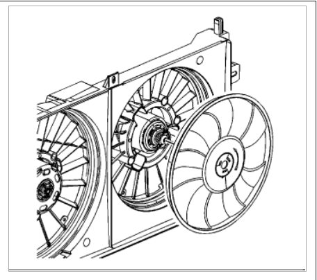

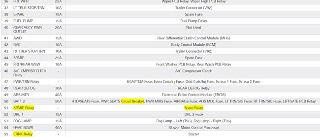

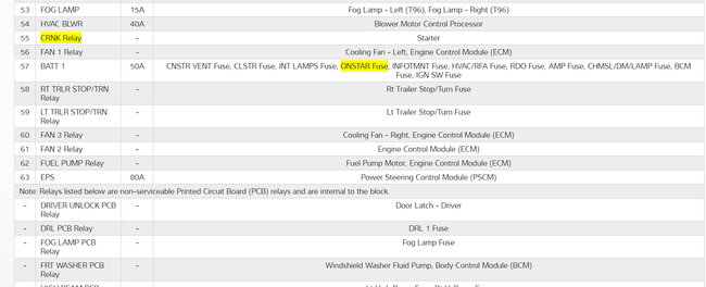

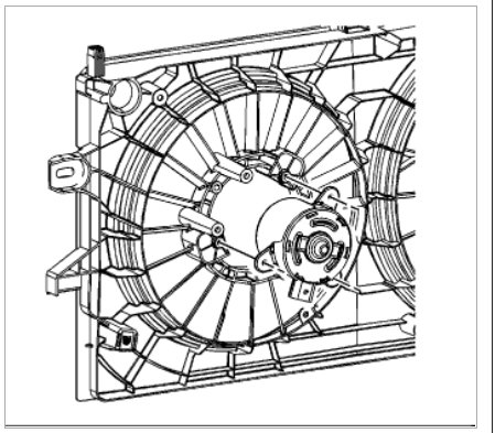

It sounds like both or one radiator cooling fan motor is not working. Here is a guide to help walk you though the steps to replace it.
https://www.2carpros.com/articles/replace-electric-fan-motor
Start by checking the fuses and relays.
and
Here are the cooling fan wiring and fuse with replay locations
Cheers

Thank you so much I had one cooling fan burned out it didn't even turn. So I replaced both fan motors and the car works great again. I love this site I cant believe it is free.

That is a very common symptom and can be caused by an inoperative electric radiator fan motor. You need plenty of air flow through the radiator to cool it. That air flow takes place naturally when the vehicle is moving. The fan is not needed when natural air flow is enough to cool the radiator. You don't usually have natural air flow when the vehicle is standing still, unless it's a windy day. That's when the electric fan gets switched on when the coolant temperature gets too hot.
There are other things that can cause an engine to only overheat at highway speeds, and there are things that can cause overheating at any time or speed. For what you described, the fan is the logical place to start looking.

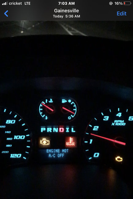

Hello, I’m having problems with my 2009 Chevrolet Equinox running hot. I had the radiator put on it still running hot. I had thermostat put on it still ran hot. I took it to Tires Plus they ran every test. they replaced the hose vacuumed air out of the thermostat they said and flushed it. a day later it ran hot again. needle all the way up. it said idle engine turn engine off now. they are saying they did every test it could be the thermostat again.

When does this happen? If the temperature remains normal while you're on the highway, that is evidence the radiator fan isn't running. It is only needed at low speeds or when stopped in traffic, otherwise normal air flow is enough to cool the radiator.
