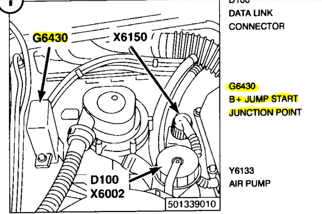

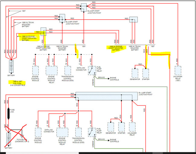

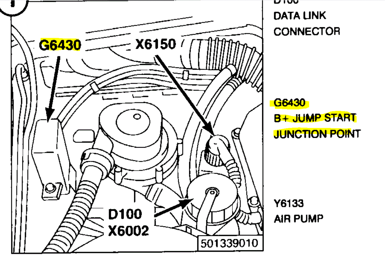

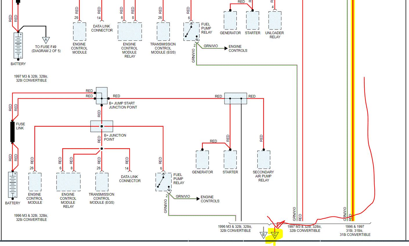

Does your vehicle have the battery in the trunk? If so, check if there is power at the jump start terminal under the hood (see pic 1). Also, make sure the ground from the battery has a good ground.
Let me know if anything electrical is working.

Thanks for your reply.In answer to your query no the battery in fitted in front engine compartment passenger side next to the fuse box/ Battery as it's a right hand drive saloon BMW.
I've studied the image you sent me "B+Jump starter Junction Box" but so far i am unable to find it? Am not sure if there is one. I've checked the Black ground wire and it looks okay? I took the battery out so i don't know if anything electrical is working.So you think it's a grounding problem?

If the battery is under the hood, there won't be a B+ jump location. That is provided if the battery is in the trunk. As far as a ground issue, if it is not ground, nothing will work. That's why I asked.

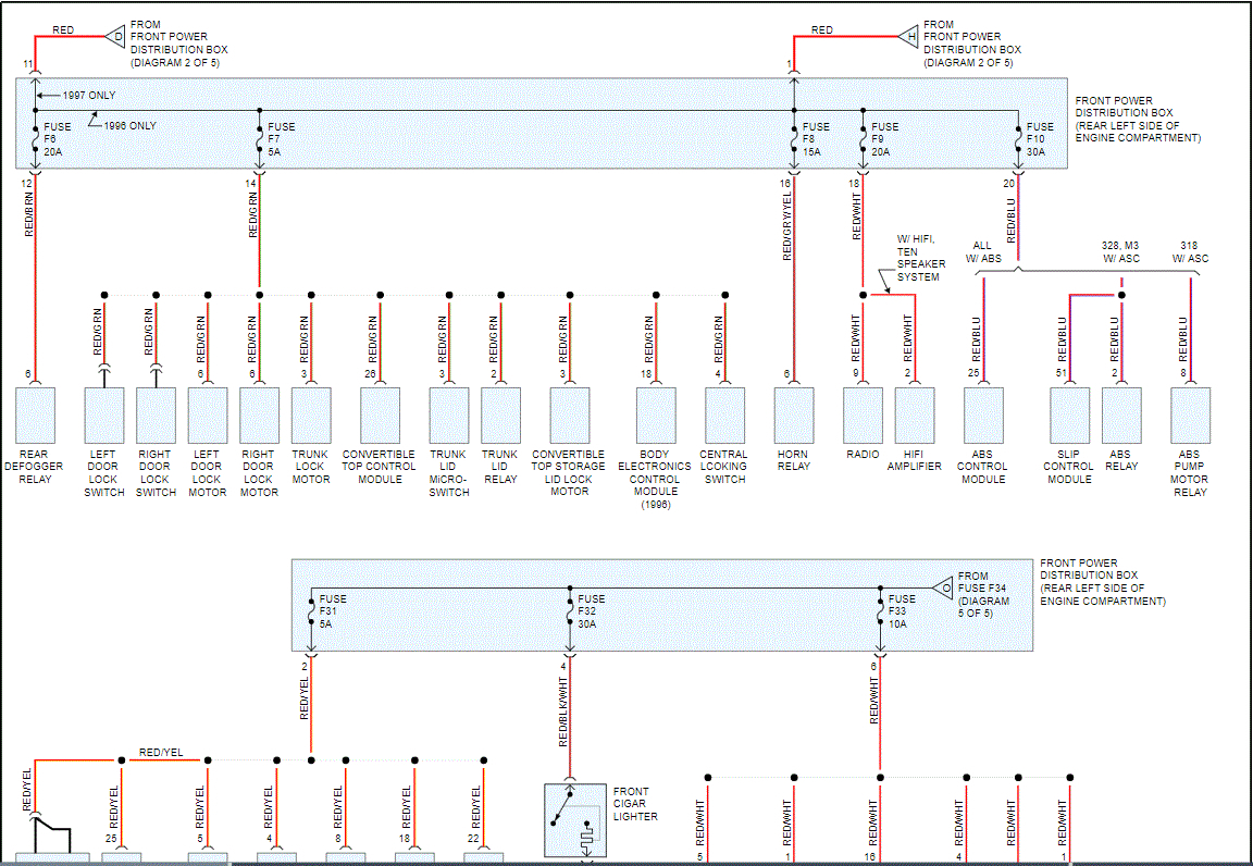

I need to know if anything electrical is functional. If you look at the pics below, it shows the power distribution schematics for this vehicle. In the first, pic, I highlighted the battery under the hood. You'll see why I was confused. LOL. Also, let me know if it is a convertible. Also, the X in pic 1 indicates a different vehicle.

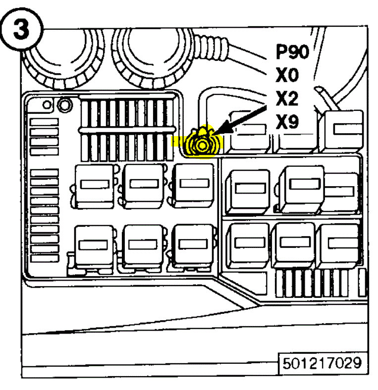

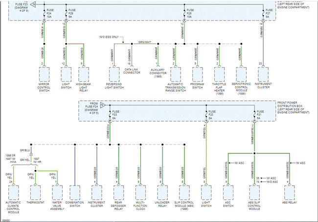

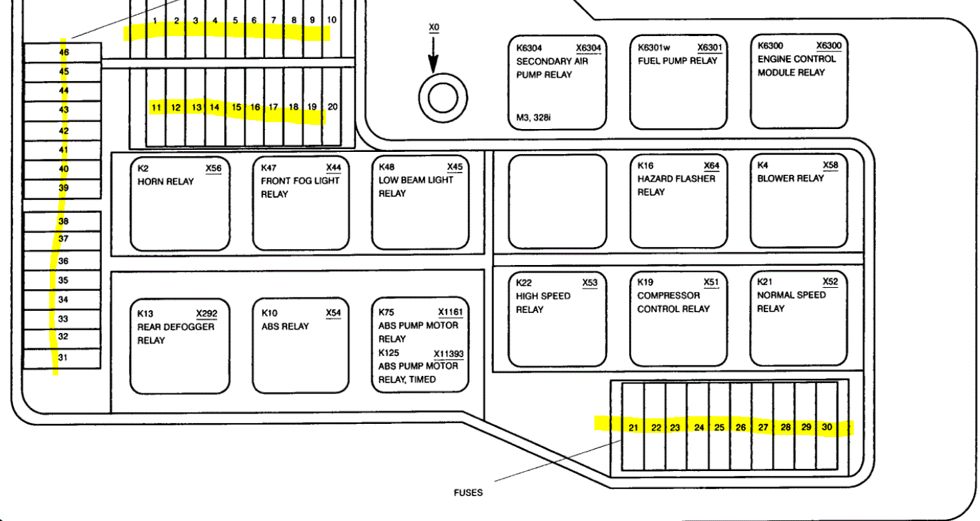

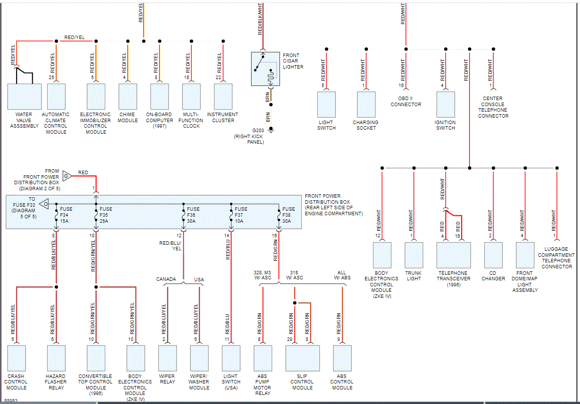

If nothing is working, there has to be an open between the battery and the power distribution box (fuse box). Do me a favor. Check a couple of the fuses under the hood to see if there is power there. Basically, remove a fuse and use a test light to see if there is power.
I attached a pic of the fuse box below.
Here is a link that explains how to do it:
See pic.
Jun 15, 2021 at 2:03 PM

I see from your attached picture that you have highlighted fuses 1 - 20 and 21 - 30!. Is there any particular fuses i should be looking at? If i get your drift correctly to do a power test i would need to have connected the battery up and then test them with the test light? For the moment I'll do a visual inspection and let you know if i find any blown fuse.

*Fuses 11,12,13,15,16,17,18 Tested Dead
*Fuses 20,14,19, Tested OK
*Fuses 21,22,23,24,25,26,27,28,29,30 Tested Dead
*Fuses 31,32,33,34,35,36,37,38,39 tested OK
*Fuses 42,43,44,45,46 Tested Dead
All the dead fuses where not blown fuses!I hope this helps.
Jun 20, 2021 at 8:36 PM
  • 110,244 POSTS

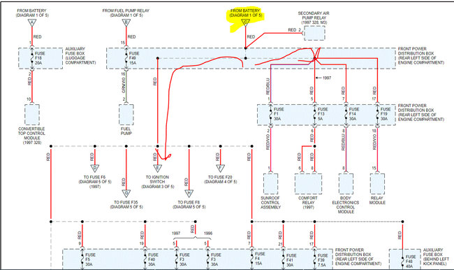

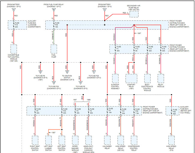

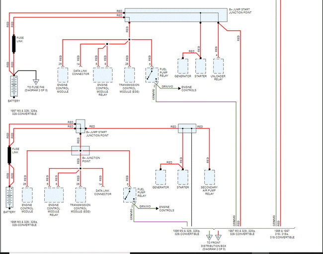

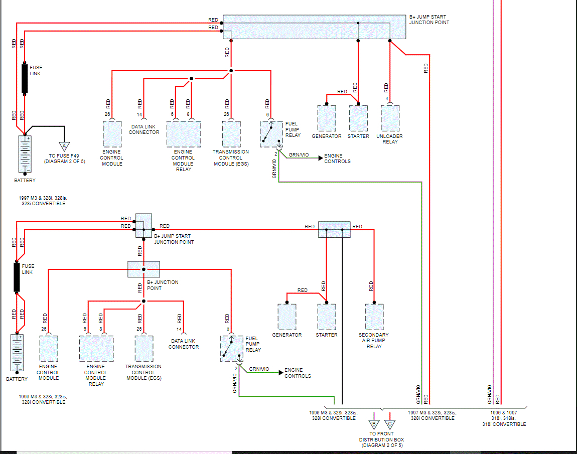

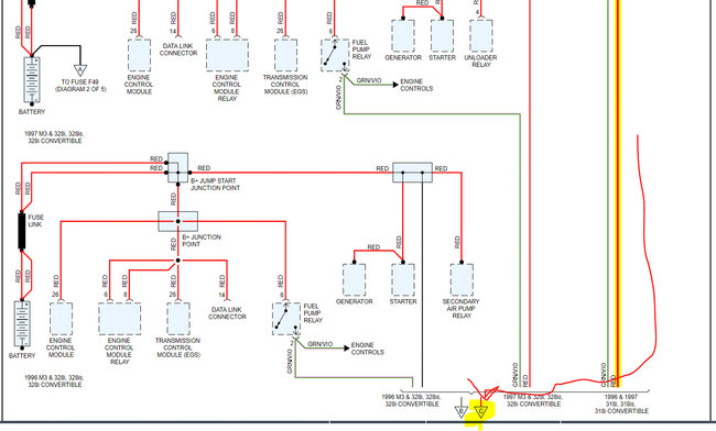

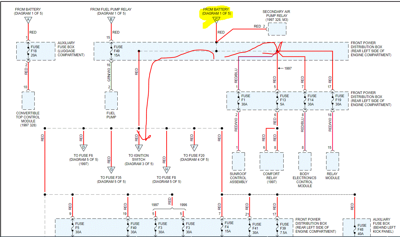

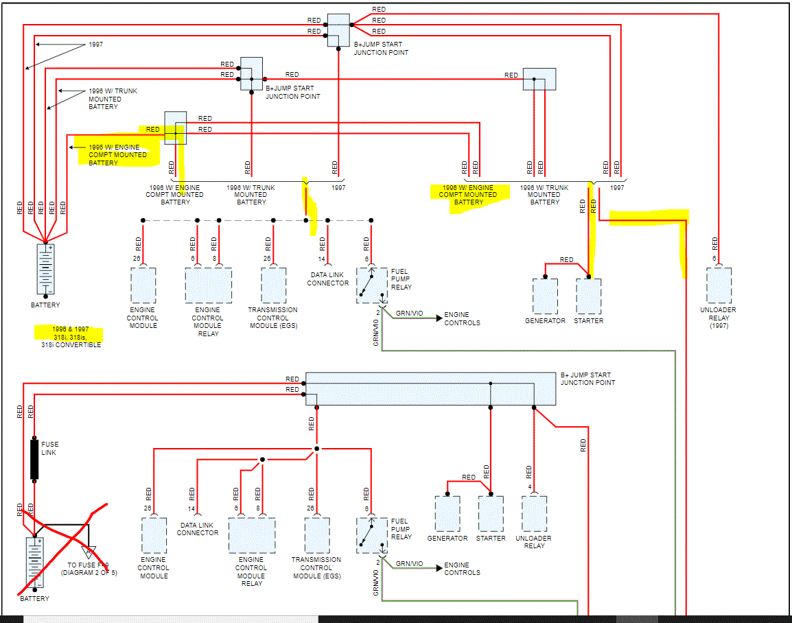

Since you have power to some of the fuses and not others, I have a feeling something got into the connections under the fuse box. That is a theory at this time, but in my mind, that's the direction we need to check.
If you look below, I attached two pics. The red wire from the battery runs to the front power distribution box under the hood. I have arrows showing where it goes to location C on page 1, and then where location C connects into the box. Note the fuses that are powered from that point. Also, the ignition switch is also powered from it. There is an open in that red wire at some point.
Disconnect the battery, remove the fuse box and inspect the underside where that red wire connects.
Let me know what you find.

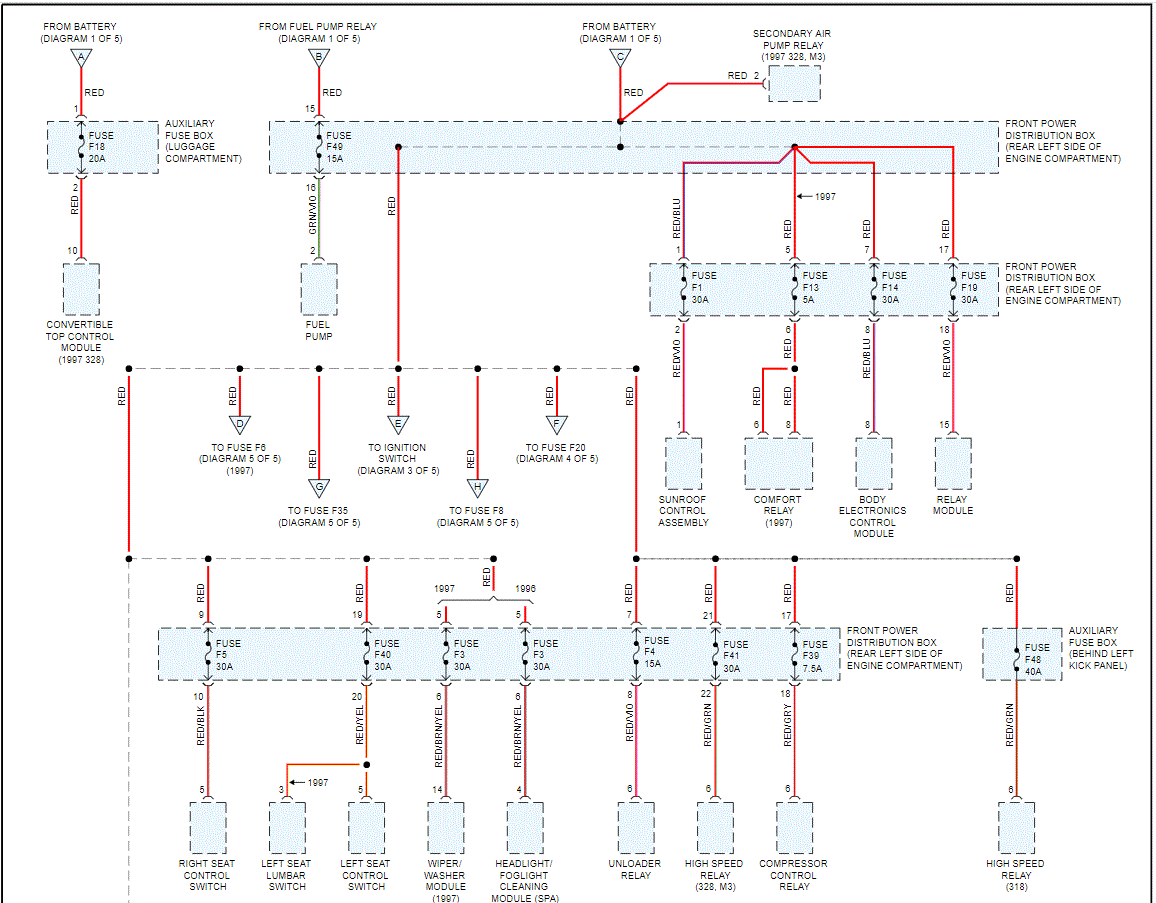

That is my theory. Also, an open circuit means there is something not closing it. You mentioned a break in the wire. Yes, that would be an open in the circuit.

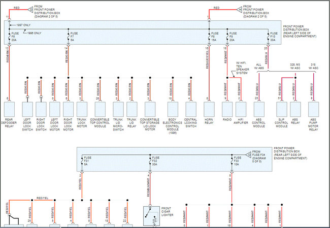

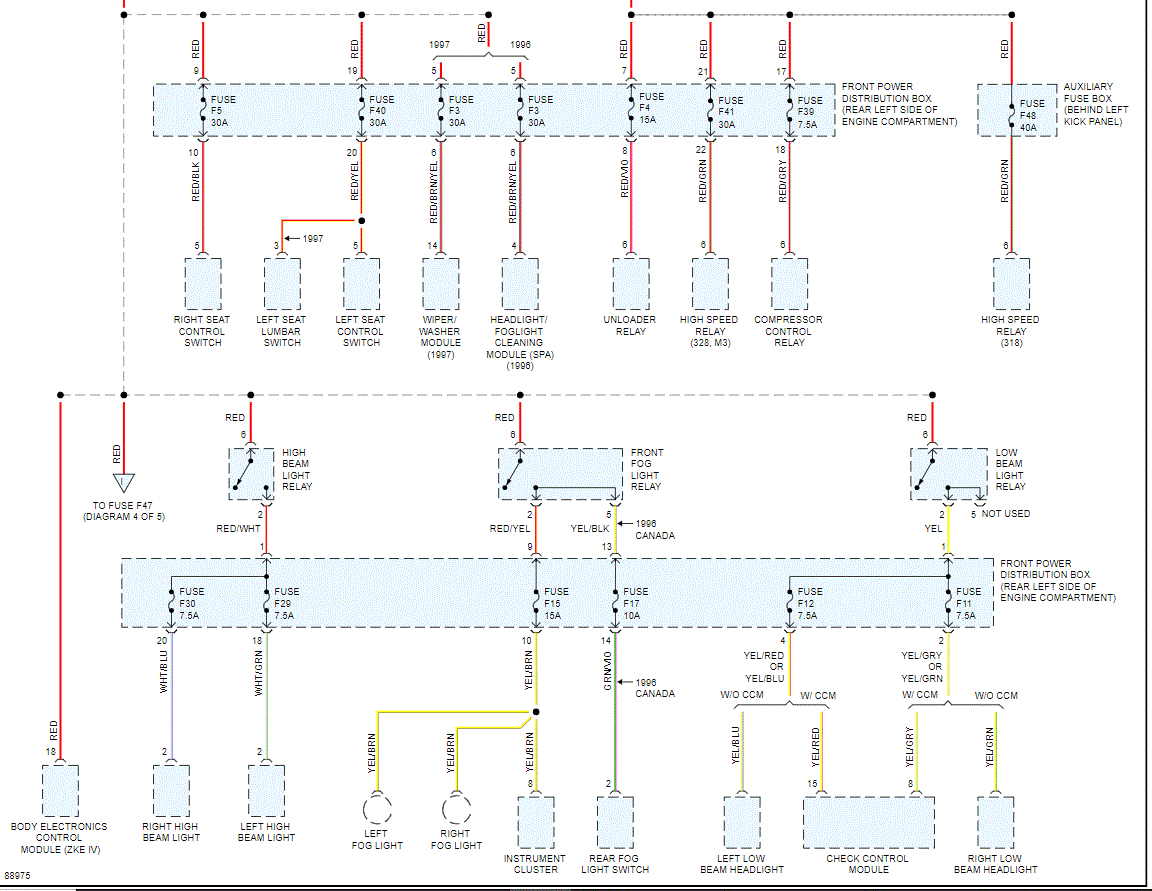

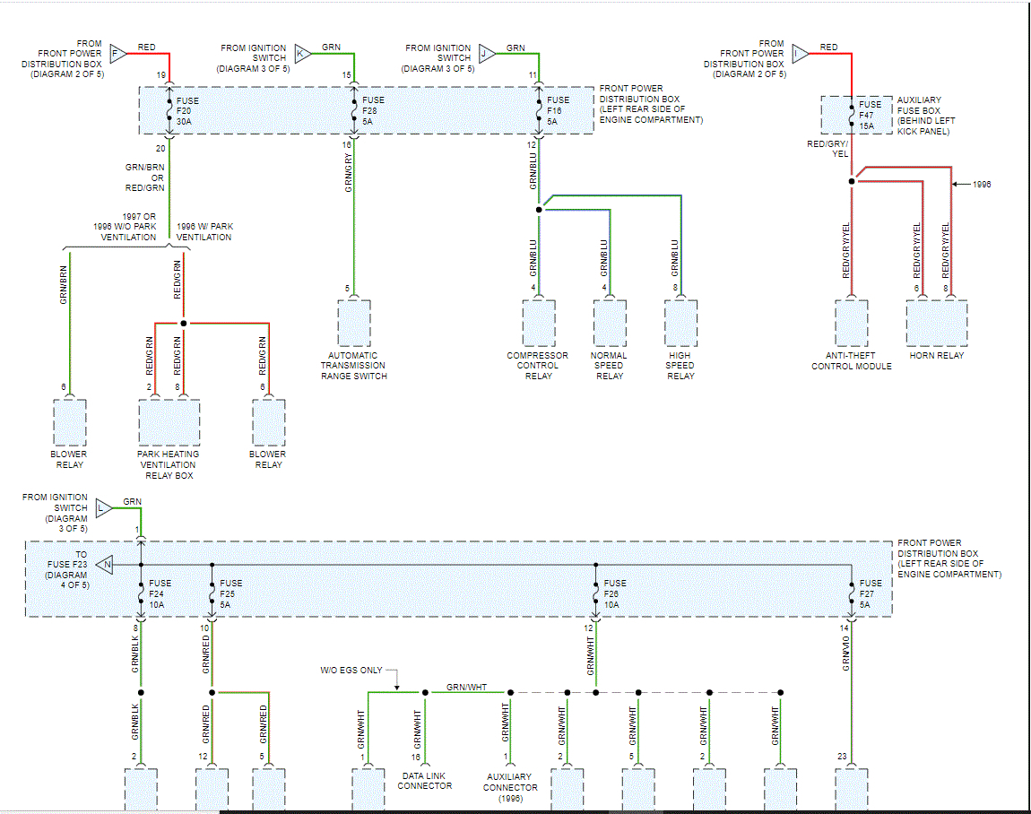

As far as it being okay, just make sure the battery is disconnected first. However, I want you to check for power in the box at a different point. See pic below. Confirm that has 12v. Please understand, not being there makes it hard for me to guarantee anything.
See pic below.

Thanks for your answer to my reply/query "disconnect the battery,remove the fuse box and inspect the underside where the positive red wire connects to it ",So you want me to check for power in the box at a different point. See pic below. Confirm that has 12v. I've looked at your picture(3) with the arrow pointing at the Red input wire which feeds power into the fuse box,yes there is such a red wire on my fuse box next to the relays!. So do you want me to check this wire with my battery tester to confirm that it has 12v.going to it?. So i can reconnect the battery to do this test?
Yes, i understand, not being face to face makes it hard for you to guarantee anything. Thanks for your patience
I'm not an expert on car electrics,although i can do basic stuff like changing light bulbs,fuses,repairing wires,oil change,service the car etc.
Thanks
Jun 23, 2021 at 11:18 PM
  • 110,244 POSTS
Yes, I was interested in knowing if power is making it to that point.
