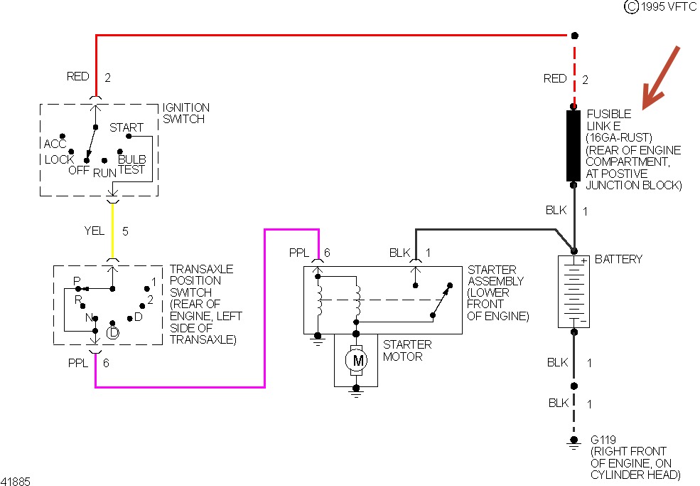

Think my neutral saftey switch is bad, want to bypass it dont know whereit is located
1986 OLDSMOBILE DELTA 88
110,000 MILES
DOTE
I went to start car wouldn't turn over, tried to jump it still nothing, not even a clicking starter I am disabled and cant do a lot but hope this is something I can bypass until I can afford to get a new one

check your battery for condition including load test
Oct 21, 2013 at 5:18 AM
DOTE
Its a new battery
Oct 21, 2013 at 5:27 AM
HMAC300
  • 48,601 POSTS
check the item I've poited out in pic it shodl have battery voltage both sides auto parts stock these.
