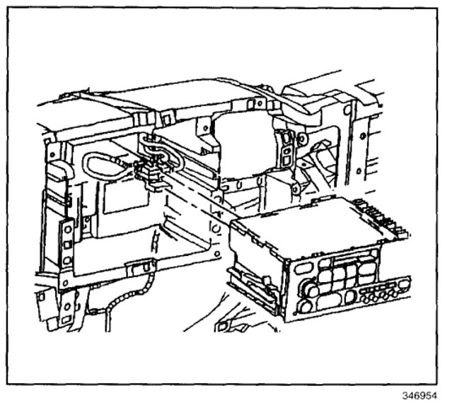

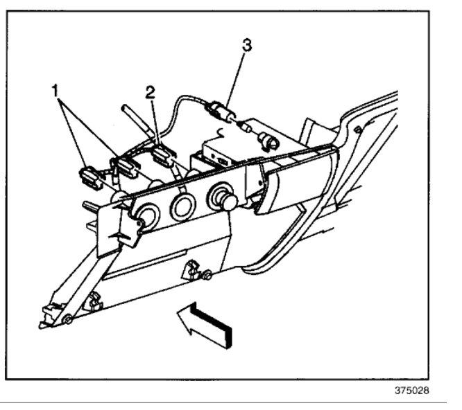

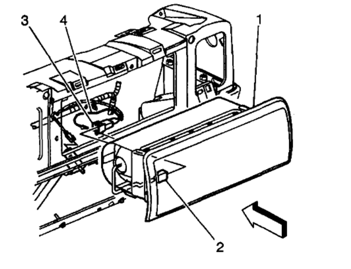

REMOVAL PROCEDURE
https://www.2carpros.com/forum/automotive_pictures/248015_1_110.jpg
Drain the engine coolant. Refer to Draining and Filling Cooling System in Engine Cooling.
Disconnect the heater hoses.
Disconnect the temperature control cable from the heater/ventilation module.
Disconnect the mode control cable from the heater/ventilation module.
Remove the instrument panel (IP) carrier (2).
Disconnect the electrical harnesses and the ground connections as necessary.

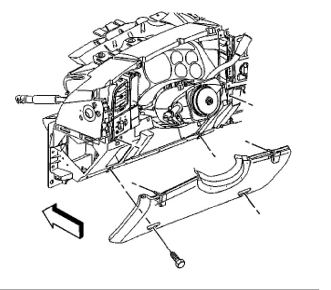

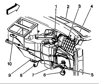

https://www.2carpros.com/forum/automotive_pictures/248015_2_59.gif
Remove the heater/ventilation module mounting nuts and the screws.
Remove the heater/ventilation module assembly. Set the module assembly on a bench.

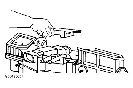

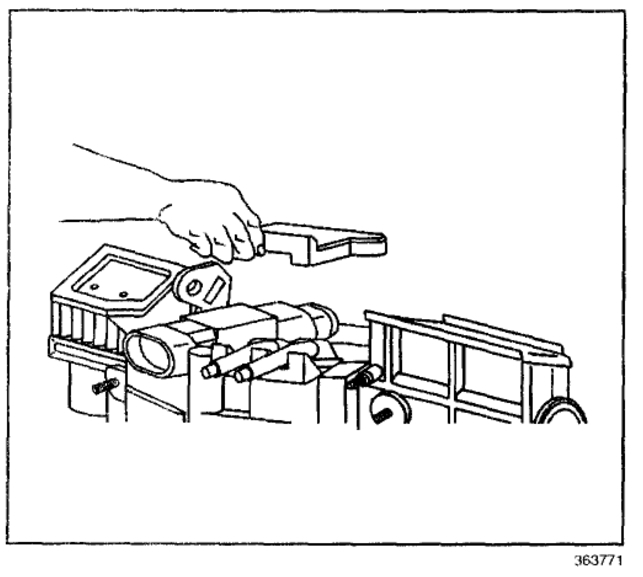

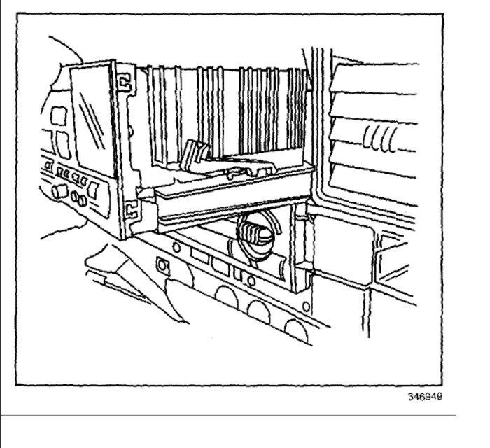

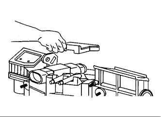

Remove the heater core cover screws.
https://www.2carpros.com/forum/automotive_pictures/248015_3_39.gif
Remove the heater core cover.

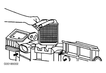

https://www.2carpros.com/forum/automotive_pictures/248015_4_30.gif

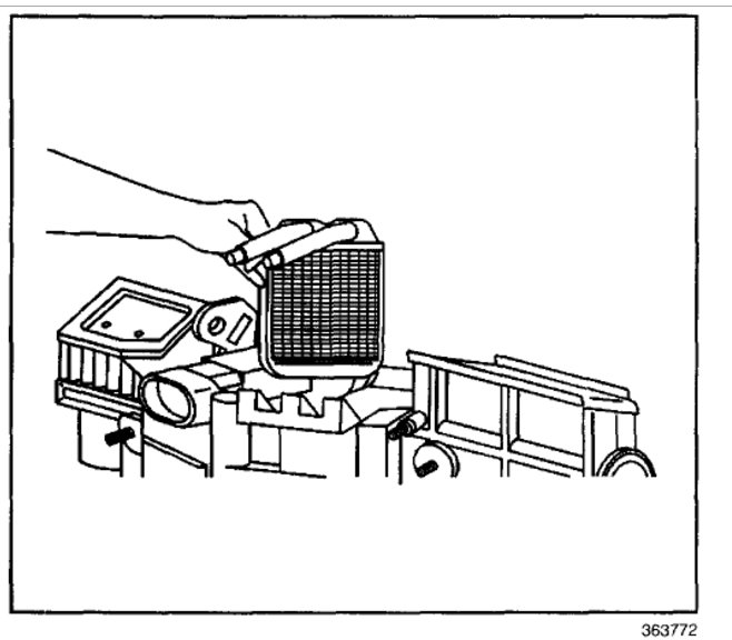

Remove the heater core.

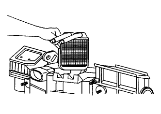

INSTALLATION PROCEDURE
https://www.2carpros.com/forum/automotive_pictures/248015_5_22.gif
Install the heater core.
https://www.2carpros.com/forum/automotive_pictures/248015_6_18.gif
Install the heater core cover. NOTE: Refer to Fastener Notice in Service Precautions.
Install heater core cover screws. Tighten Tighten the screws to 1.6 N.m (14 lb in) .

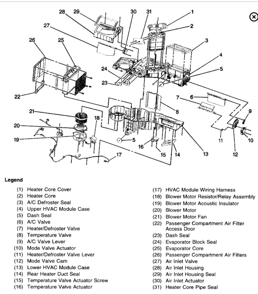

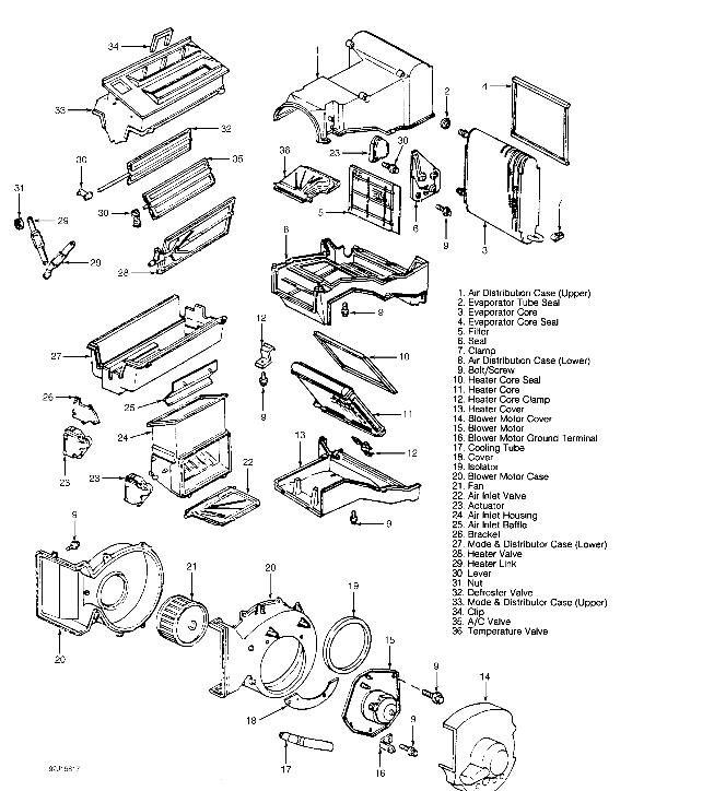

My fluid is the orange type. Once done I will let you know the results.
I do have a couple of additional questions on the data you sent me.
1) Is there more information as to what the numbers mean on the schematic? I see the drawing is showing these but nothing to reference them to.
2) If I am understanding this correctly it appears that I need to take the entire heater/A/C module out. If so, this information is very vauge and if possible is there a manual I can get that gives much more details? Is there a manual with pictures of the objects being removed? If so where may I purchase it at? I guess I am looking for a specific book on my truck and not a range of years that show general information.
Thanks again,
Allen
-1
Tuesday, May 25th, 2021 AT 11:38 AM (Merged)
IMPALASS
  • 3,112 POSTS
Allen
We see tons of problems with the orange, Dex-cool..plugs radiators also
The data .the numbers must be from another pic that the manual uses the only number the pic uses it #2
I have attached that for you. . .. . .the module removal / installation
More detailed well. there is a link I attach below and here Find a car repair manual for your car repair questions. That you can purchase a manual
You might see if that is what you want
If not detailed enough what you may be wanting is the actual service manual I have a 1995 Impala SS and purchased the entire service manuals for this price.but I have detail.

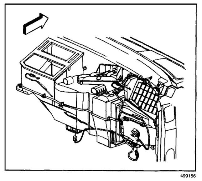

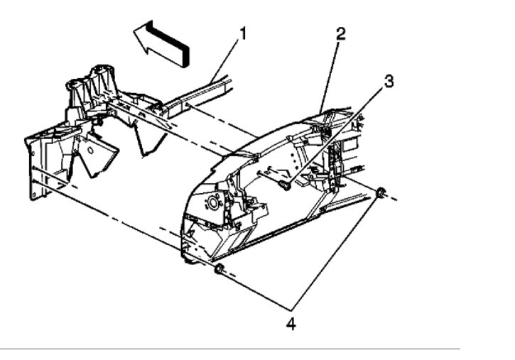

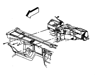

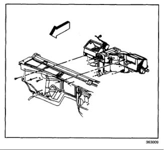

HEATER/VENT MODULE REPLACEMENT
REMOVAL PROCEDURE
https://www.2carpros.com/forum/automotive_pictures/248015_21_1.jpg
Drain the engine coolant. Refer to Draining and Filling Cooling System in Cooling System.
If equipped remove the auxiliary battery.
Remove the accumulator.
Remove the instrument panel carrier.
Remove the HVAC module drain hose.
Disconnect the electrical harnesses and the ground connections as needed.
https://www.2carpros.com/forum/automotive_pictures/248015_22_1.jpg
Remove the mounting nuts and the screws from the HVAC module.
Remove the HVAC module assembly from the vehicle.
https://www.2carpros.com/forum/automotive_pictures/248015_23_1.jpg
If you are replacing the HVAC module, transfer the components from the old HVAC module as necessary.
Install the HVAC module assembly to the vehicle. NOTE: Refer to Fastener Notice in Service Precautions.
Install the mounting nuts and the screws to the HVAC module.
Tighten
Tighten the mounting screws to 4 N.m (35 lb in) .
Tighten the mounting nuts to 9 N.m (80 lb in)
https://www.2carpros.com/forum/automotive_pictures/248015_24_2.jpg
Connect the electrical harnesses and the ground connections.
Install the HVAC module drain hose.
Install the instrument panel carrier.
Install the accumulator.
Connect the heater hoses.
Install the auxiliary battery.
Fill the cooling system. Refer to Draining and Filling Cooling System.

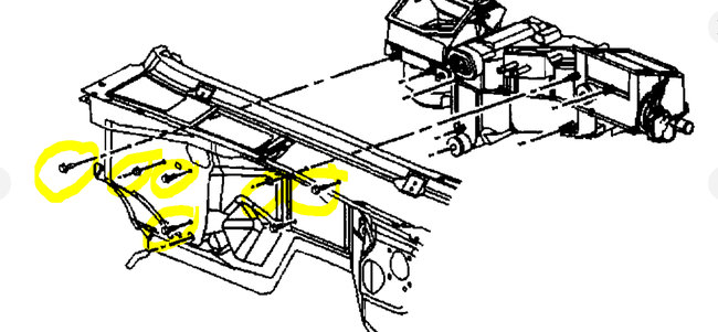

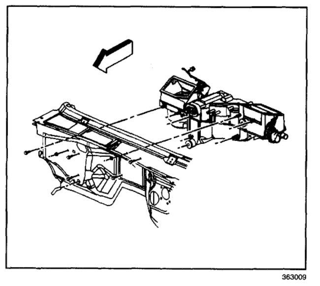

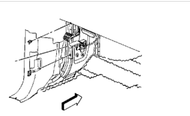

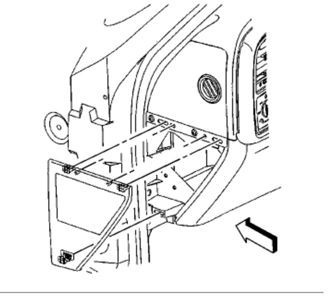

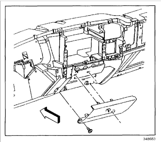

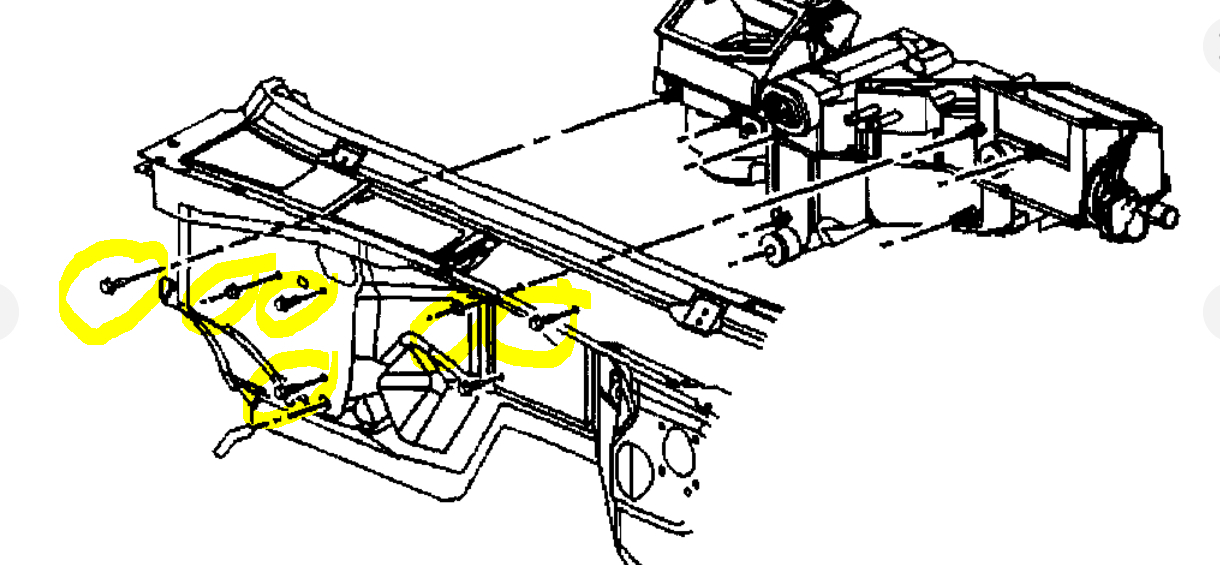

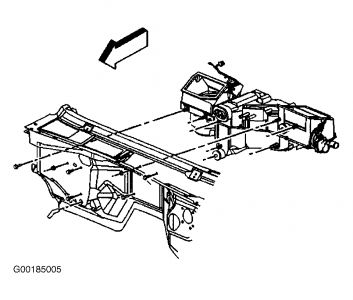

Which bolts remove the HVAC box from the firewall of the 1999(.5) truck listed above 2500?
Tuesday, May 25th, 2021 AT 11:39 AM (Merged)
  • 52,797 POSTS

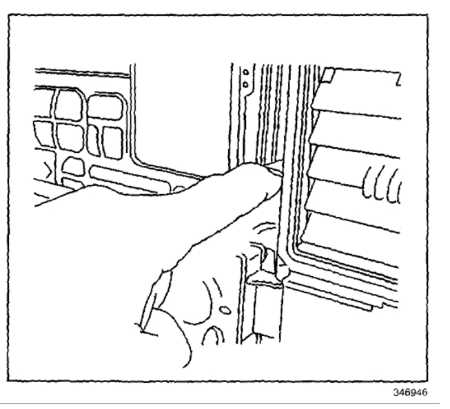

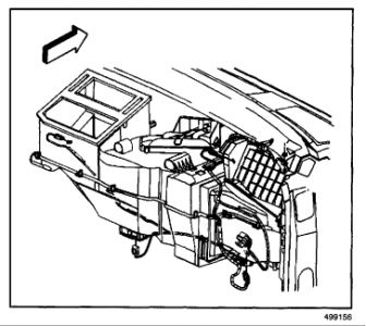

Good afternoon,
There are 6 bolts securing the case to the firewall. Check out the diagrams (Below). Please let us know if you need anything else to get the problem fixed.

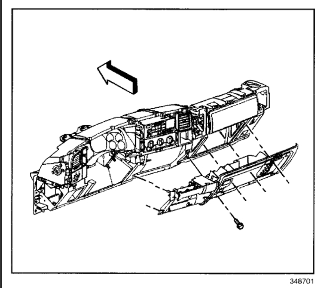

Remove the instrument panel storage compartment.
Disconnect the electrical connectors, as necessary, that may be in the way.
Remove the center floor air distribution duct.
Remove the hinge pillar trim kick panels.
Remove the blower motor cover screws and the cover.
Remove the blower motor screws and the blower motor.
Remove the steering wheel and the steering column (standard & tilt).
Remove the instrument panel fasteners and pull the instrument panel back far enough to gain access to the heater assembly.

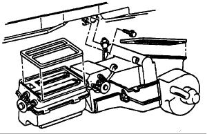

While holding the heater assembly against the firewall, remove the screw located on the interior side near the evaporator pipe, if equipped.
In the engine compartment, remove the 4 heater assembly-to-chassis screws and the 2 heater assembly-to-chassis nuts.

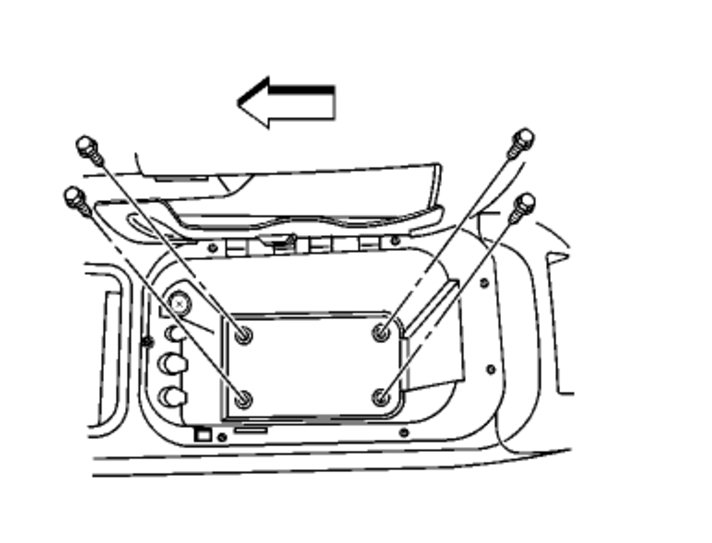

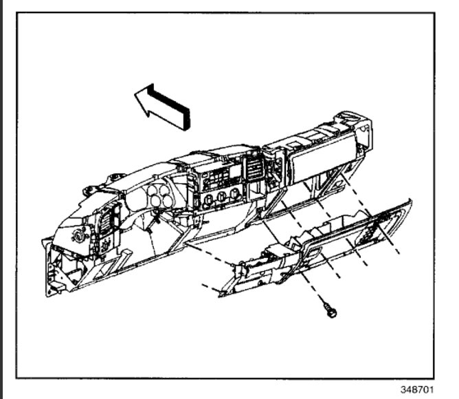

Screw on interior side of cowl, near the evaporator pipe (if equipped) while holding heater case to the cowl.
Four screws on the engine side of the cowl holding the heater case to the cowl.
Two nuts on the engine side of the cowl holding the heater case to the cowl.
Heater case.
It may be necessary to have an assistant when removing heater case.
Heater cover.
Remove seven screws that hold cover to the heater case.
Heater core from retainer.

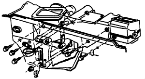

Removal & Installation
1.Disconnect negative battery cable. Drain cooling system. Remove coolant recovery tank. Disconnect heater hoses at core. Disconnect cable from antenna mast. Remove glove box.
2.Disconnect wiring harness from ECM. Remove ECM and bracket. Remove right kick pad. Remove right lower dash panel bolt and nut.
3.Remove heater case mounting bolts. Remove heater case from vehicle, raising instrument panel for additional room. Remove heater core from heater case. To install, reverse removal procedure. See Fig. 2 .
Fig. 2:
Heater System Components
https://www.2carpros.com/forum/automotive_pictures/62217_heat_1.jpg
Tuesday, May 25th, 2021 AT 11:40 AM (Merged)
