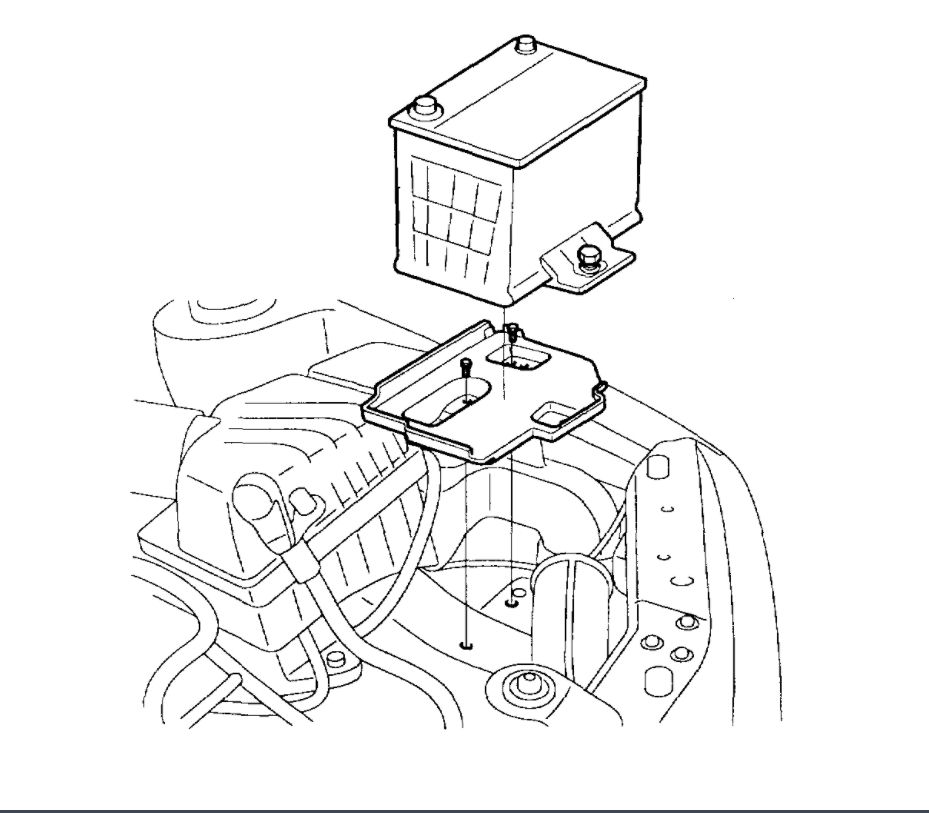

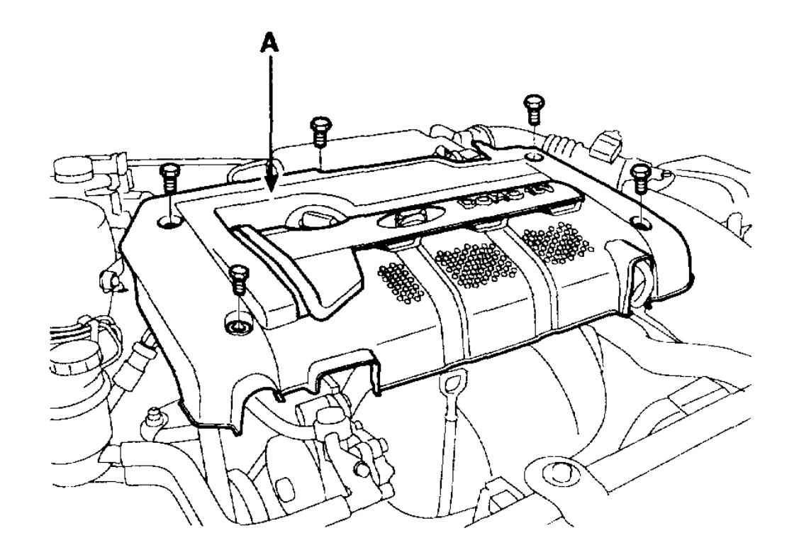

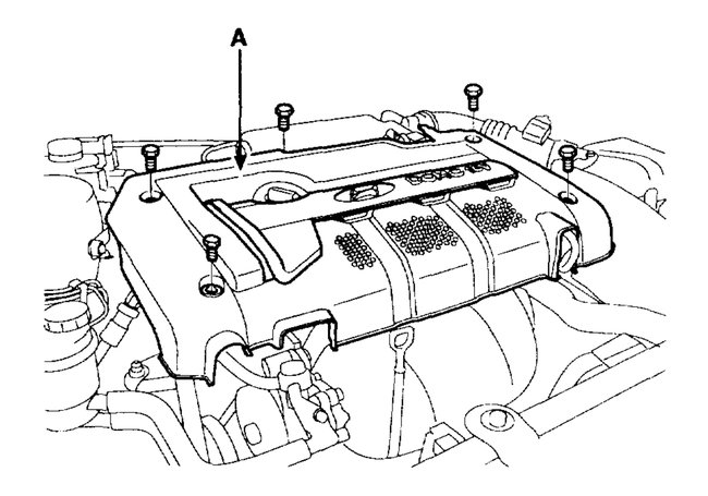

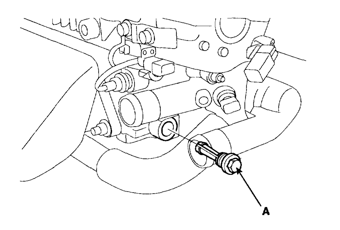

Attached is the procedure for you for the repair.
1. Remove the heat shield (A).

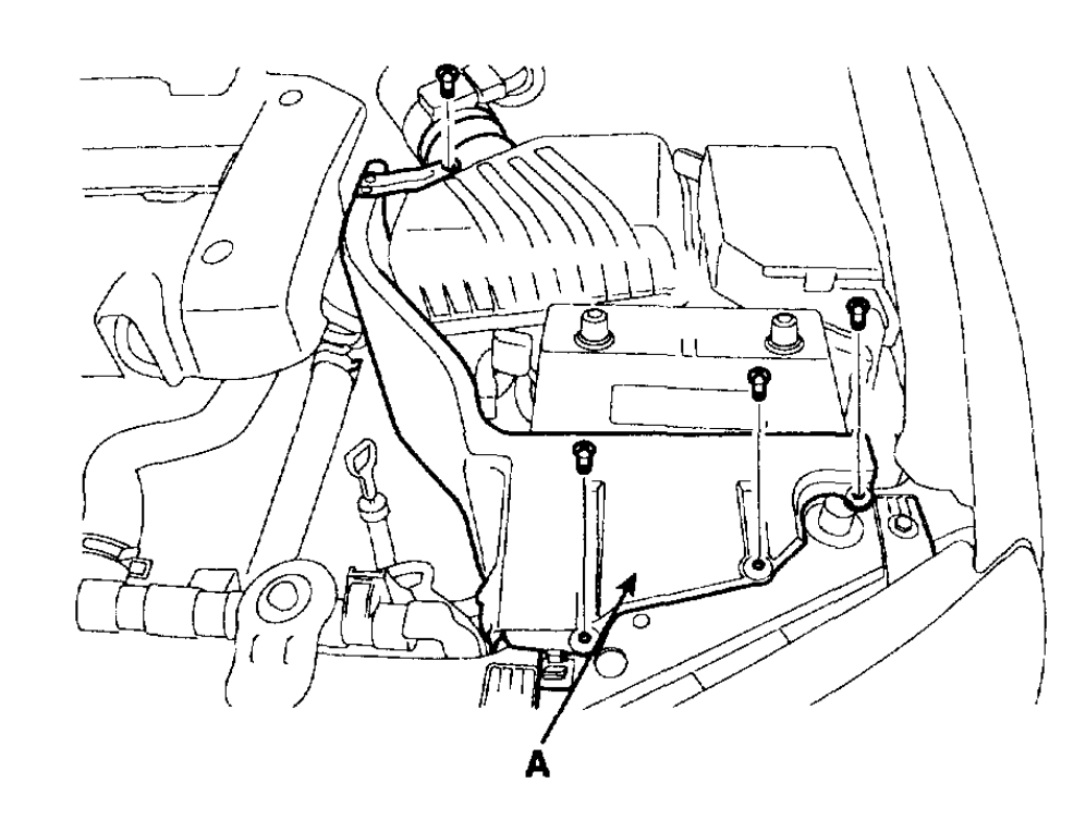

4. Remove the intake air hose and air cleaner assembly

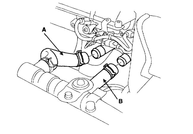

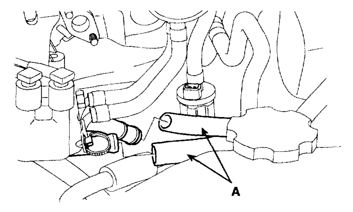

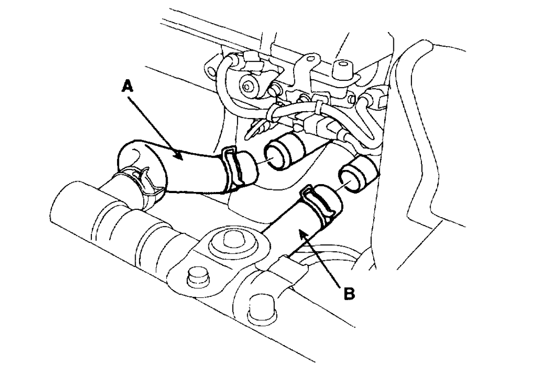

5. Remove the upper radiator hose (A) and lower radiator hose (B).
6. Remove the heater hoses (A).

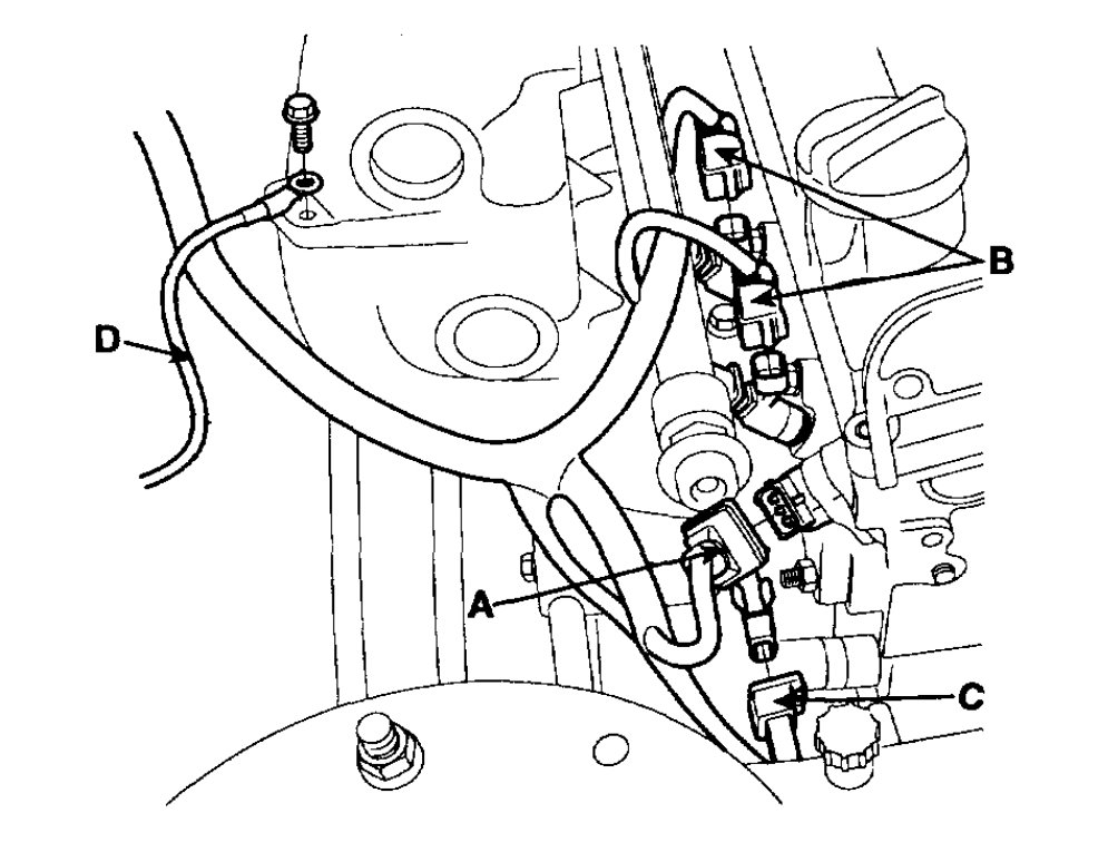

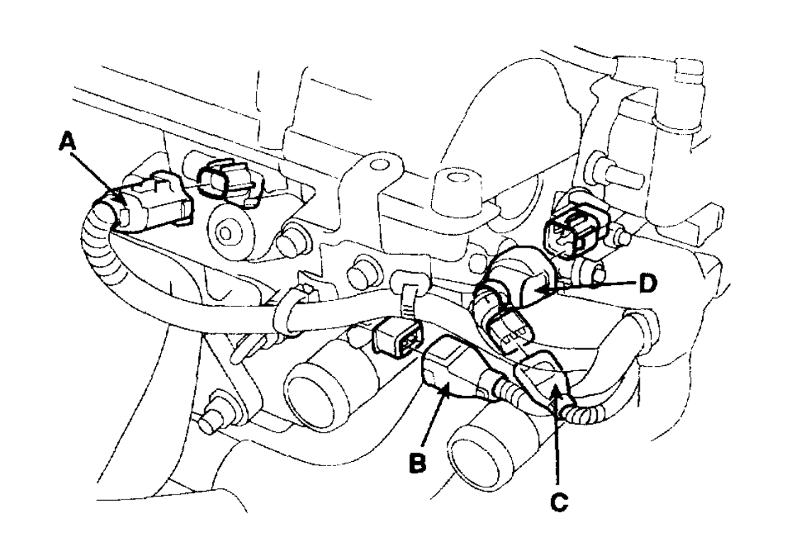

7. Remove the engine wire harness connectors and wire harness clamps from the cylinder head and the intake manifold.
1. Oil control Valve (OCV) connector (A).
2. Oil temperature sensor connector (B).
3. Engine Coolant Temperature (ECT) sensor connector (C).
4. Ignition coil connector (D).

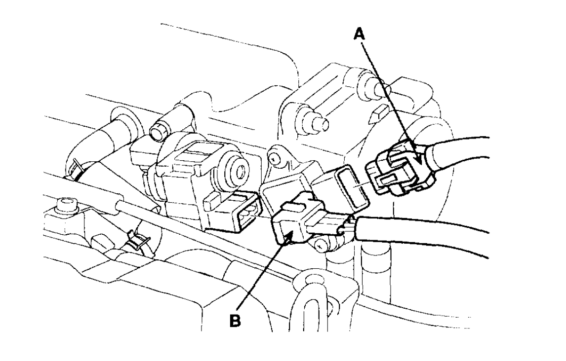

5. Throttle Position Sensor (TPS) connector (A).
6. Idle Speed Actuator (ISA) connector (B).
7. Camshaft Position Sensor (CMP) connector (A).
8. Four fuel injector connectors (B).
9. Knock sensor connector (C).
10. Disconnect ground cable (D) from the intake manifold.

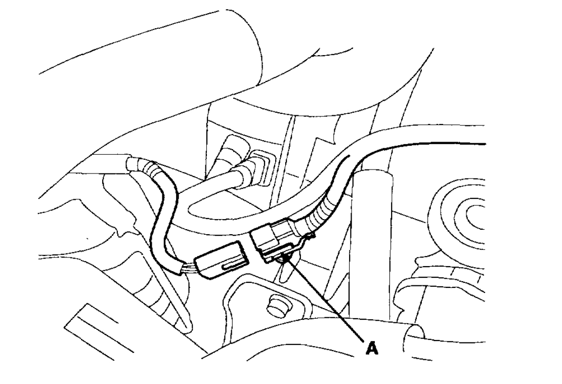

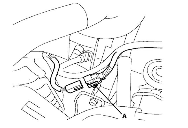

11. Front heated oxygen sensor connector (A).

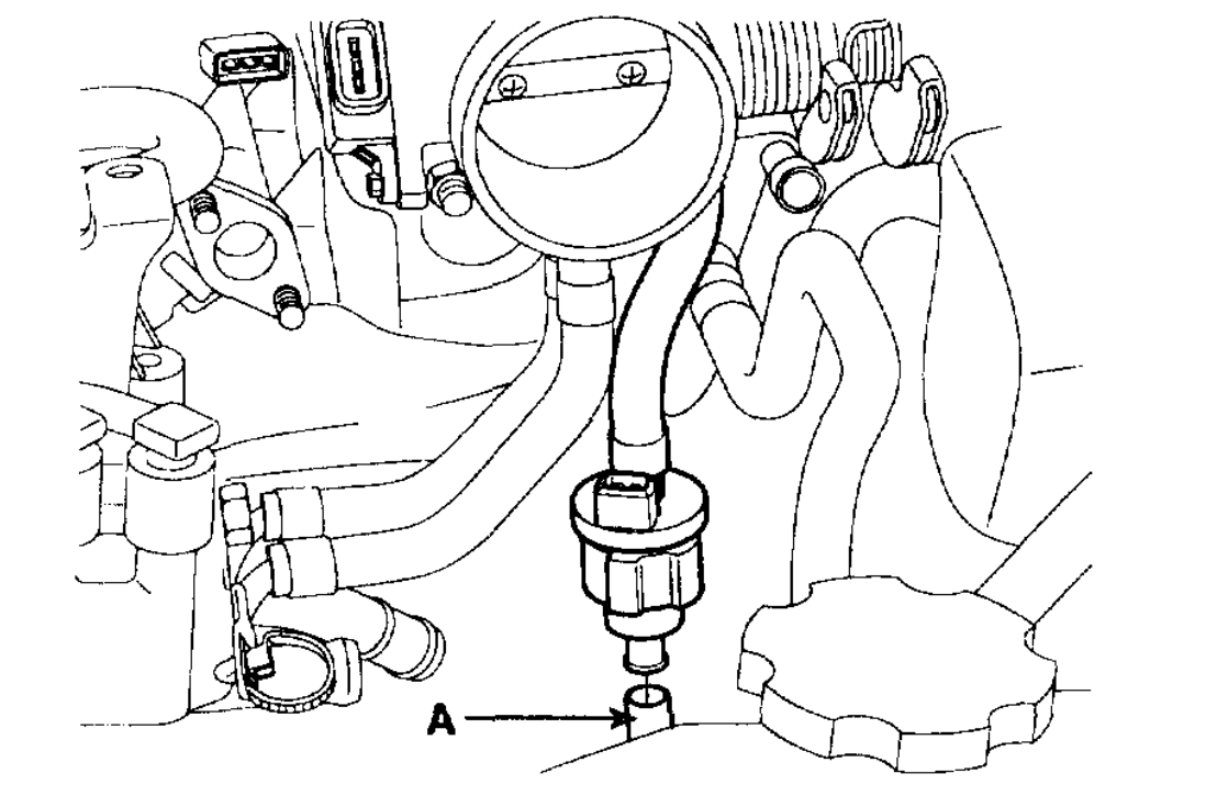

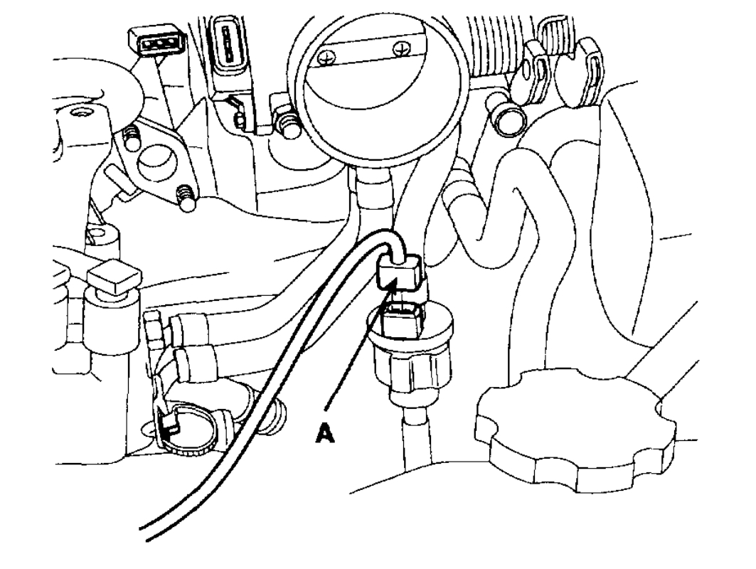

12. Purge Control Solenoid Valve (PCSV) connector (A).
8. Remove the fuel inlet hose (A) from delivery pipe.

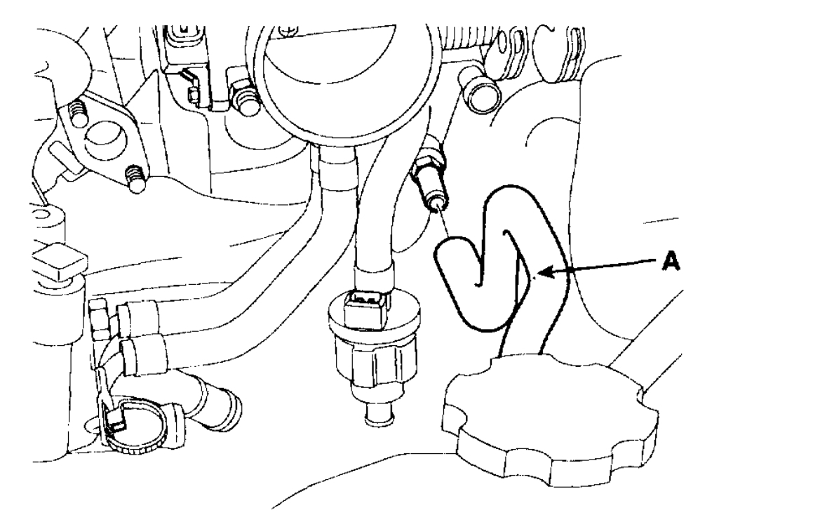

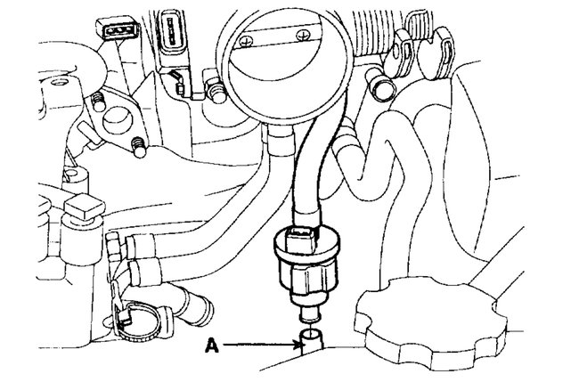

9. Remove the PCSV hose (A).

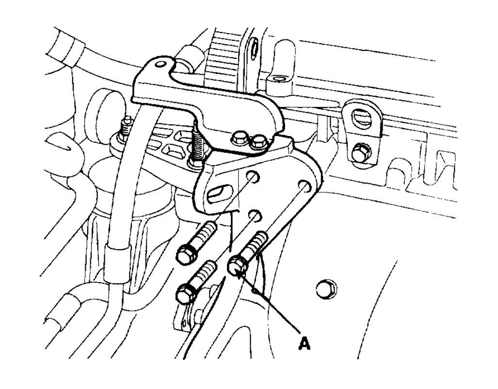

12. Remove the power steering pump.
13. Remove the power steering pump bracket bolts (A).

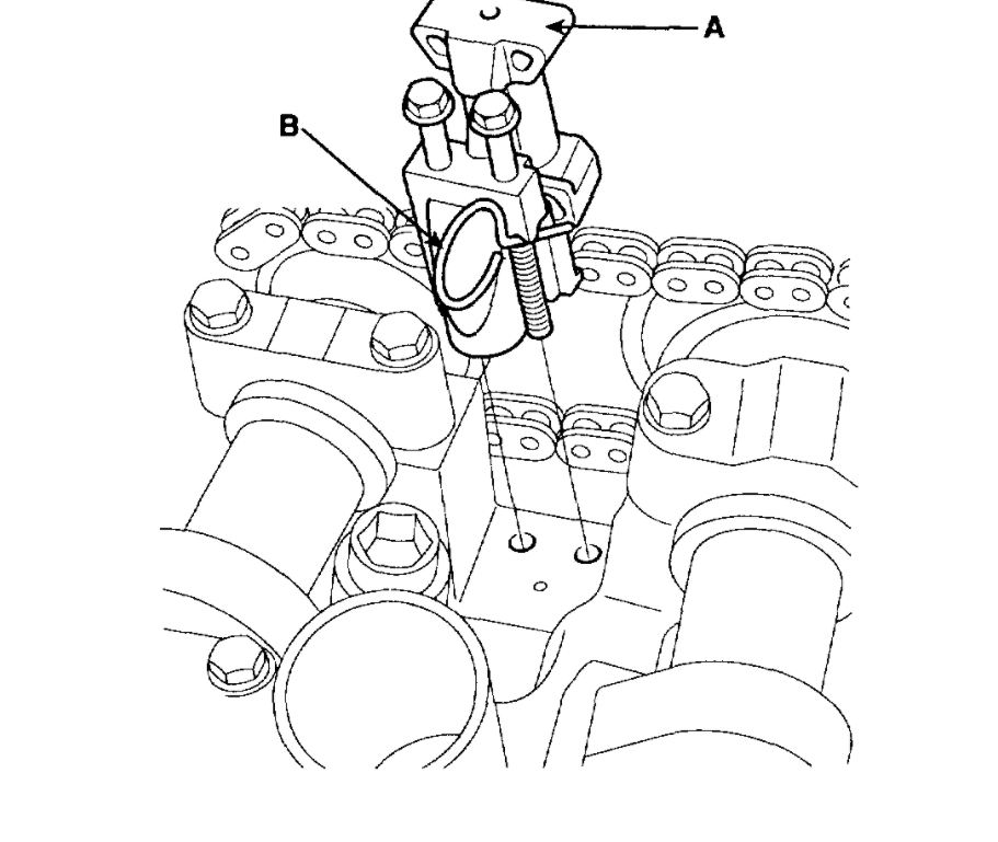

21. Remove the timing chain auto tensioner (A).

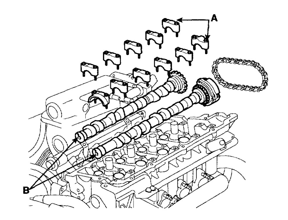

22. Remove the camshaft bearing caps (A) and camshafts (B).

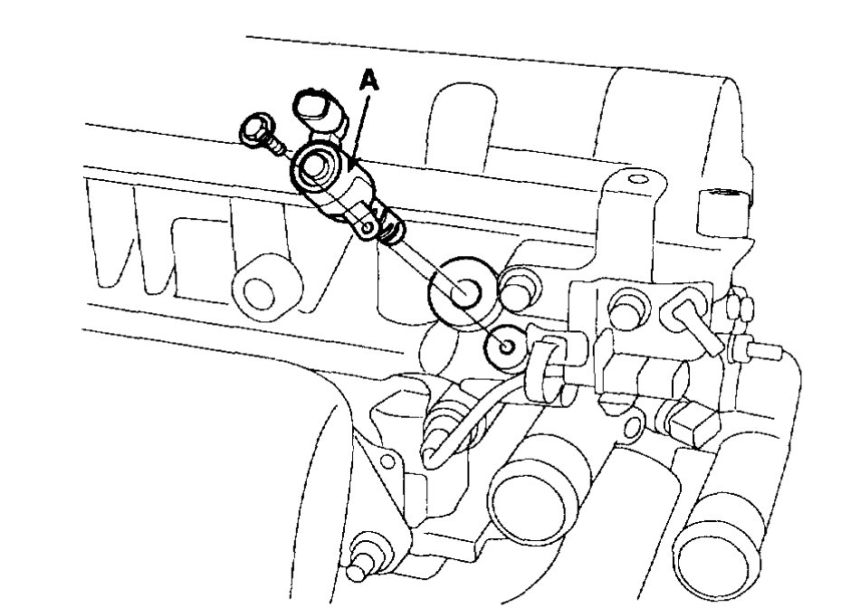

23. Remove the OCV (oil control valve) (A).

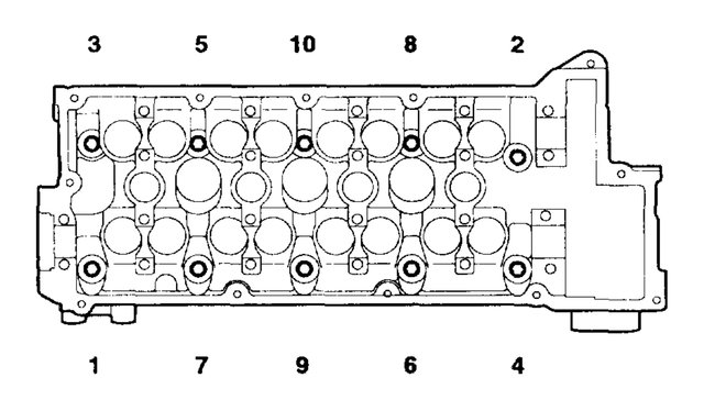

25. Remove the cylinder head bolts, then remove the cylinder head.
1. Using 8 mm and 10 mm hexagon wrench, uniformly loosen and remove the 10 cylinder head bolts, in several passes, in the sequence shown. Remove the 10 cylinder head bolts and plate washers.
CAUTION: Head warpage or cracking could result from removing bolts in an incorrect order.
