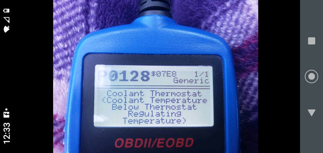

Thermostat issue Code P0128
2016 DODGE CARAVAN
80,000 MILES • 3.6L • 6 CYL • 2WD • AUTOMATIC
PETE CUNNINGHAM
Here is the info I have. Wondering what I need to do to fix this.

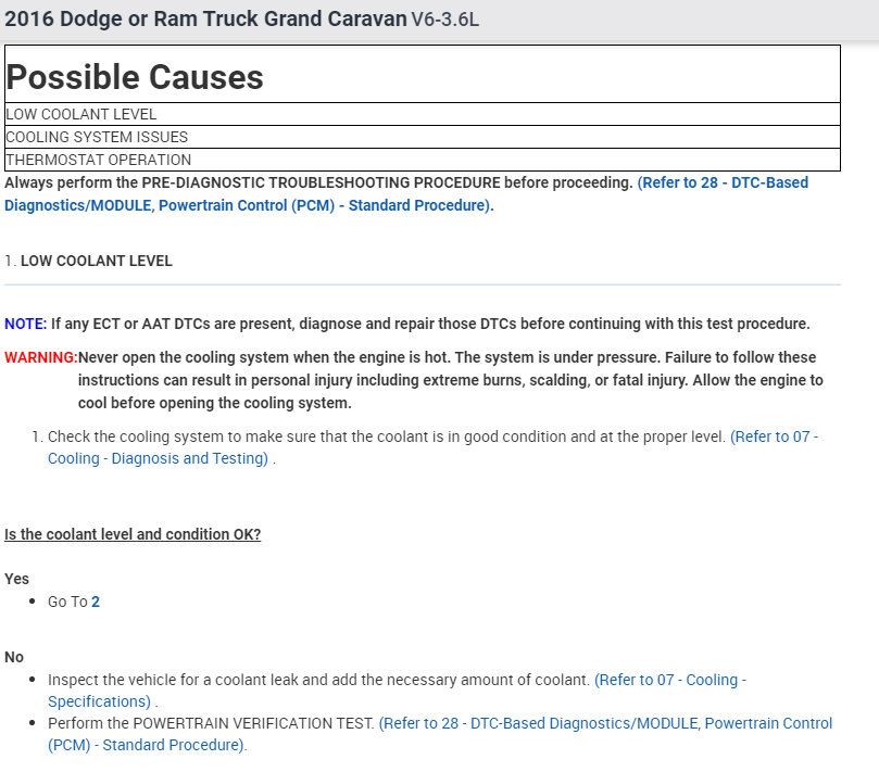

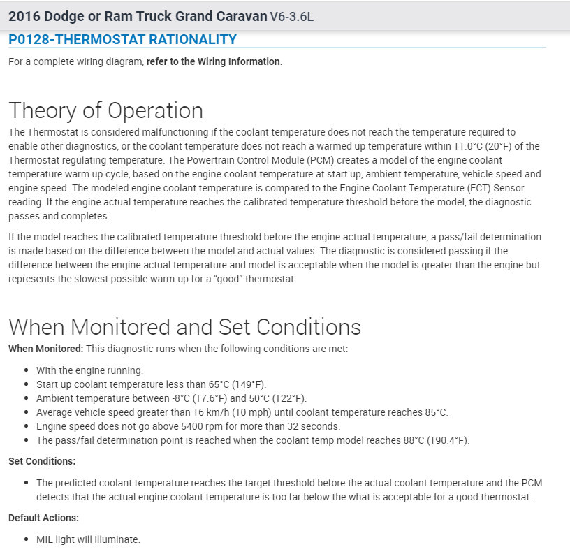

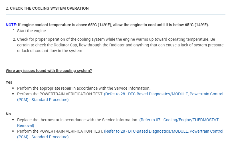

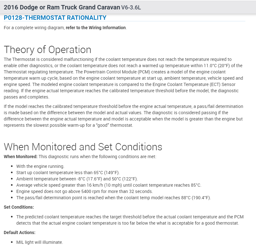

The code P0128 can be triggered by a faulty thermostat, low coolant level or other coolant system issues.
What drivability issues are you experiencing? Is it running cooler than it should?

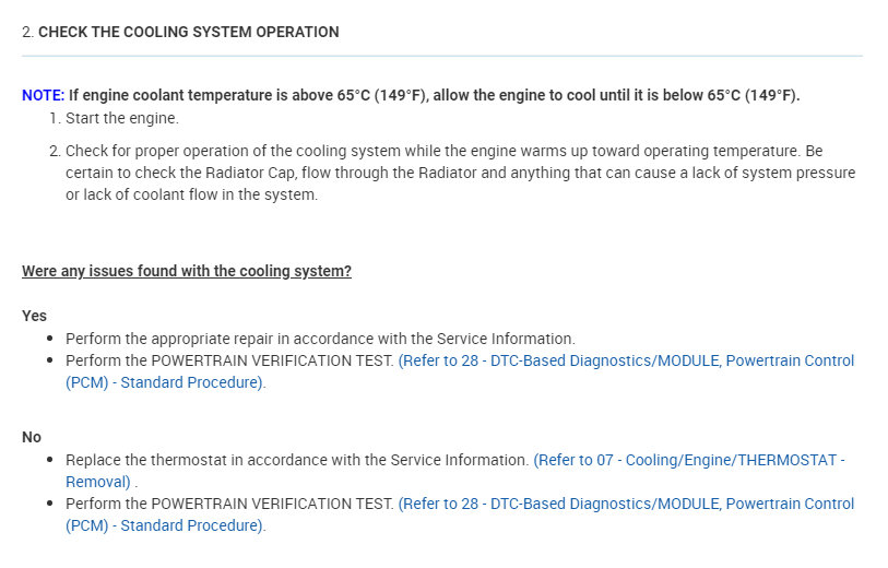

I have attached the troubleshooting steps for code P0128 below. Go through those steps and it can help to figure out the issue.
Dec 13, 2021 at 11:14 AM
PETE CUNNINGHAM
Yes, it's running cool.
Dec 13, 2021 at 11:33 AM
SQM
  • 6,383 POSTS
It could be do to the thermostat opening too soon or just stuck open.
Go through the troubleshooting guide above. Let me know what you find.

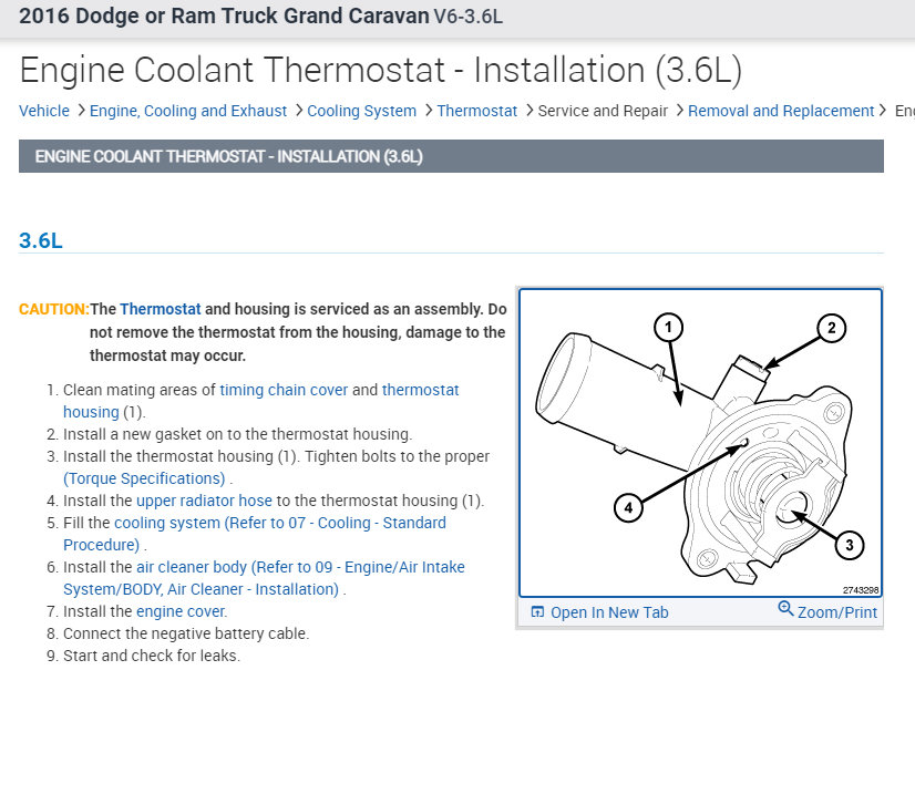

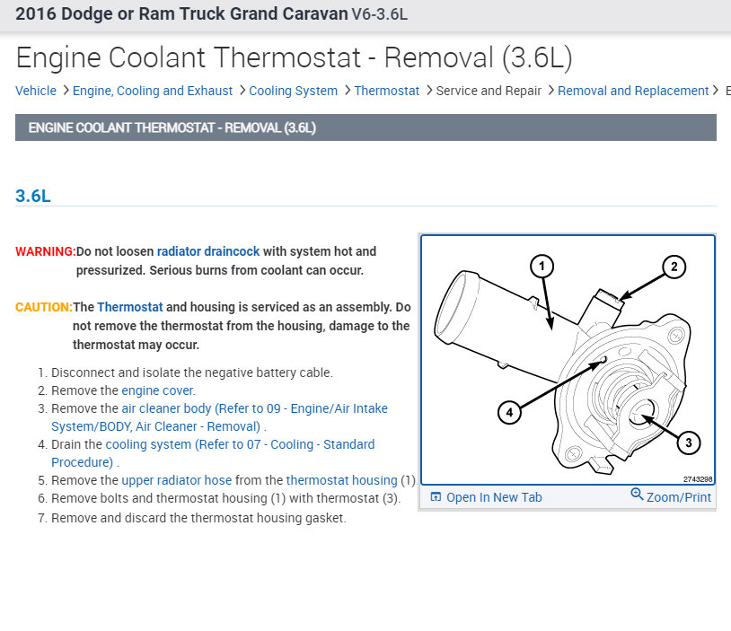

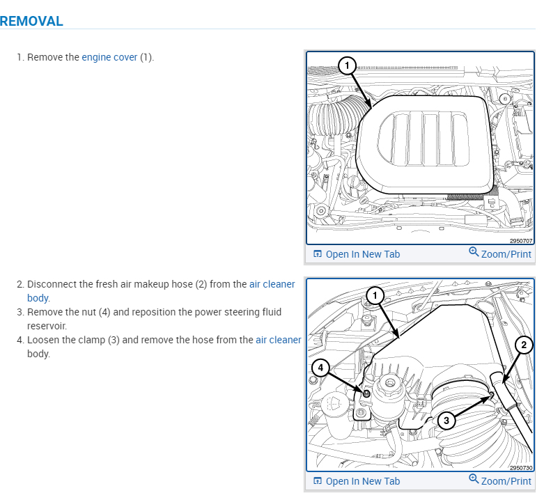

I have attached the thermostat replacement procedure below.
Let me know of any questions.
Dec 13, 2021 at 7:48 PM
PETE CUNNINGHAM
I replaced the thermostat and problem solved..thank you !!
