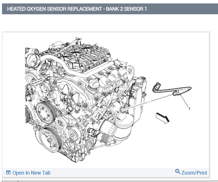

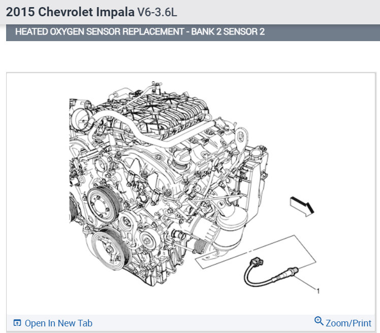

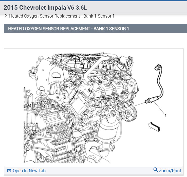

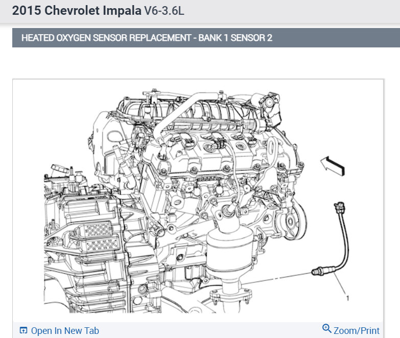

Now I want to know the locations of the oxygen sensors of,
Bank 1 Sensor 1
Bank 1 sensor 2
Thank you

P0132: Oxygen Sensor Circuit High Voltage (Bank 1, Sensor 1)
Bank 1 refers to the side of the engine where the Number 1 cylinder is located.
Sensor 1 refers to the O2 sensor that is located before the catalytic converter, typically responsible for monitoring the air-fuel mixture.
Here is a generic guide to help you step by step with instructions in the diagrams below to show you how on your car:
https://www.2carpros.com/articles/how-to-replace-an-oxygen-sensor
Here are the locations for all four oxygens sensor to avoid confusion. Check out the images (below). Please let us know what happens.
