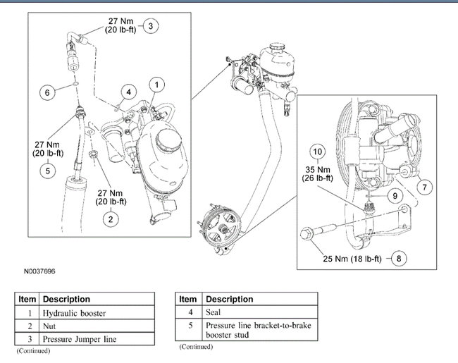

The truck has a hydroboost and I have recently replaced it and the power steering pump as well. Also the master cylinder
2006 FORD F-250
320,000 MILES • 0.6L • V8 • TURBO
BILLNAUERTCOM
Brakes lock up when the engine is started.
Jan 28, 2021 at 8:38 AM
  • 110,244 POSTS
It sounds like the spool valve issue, but everything is new. If you are getting brake pressure with the pedal released, something isn't allowing the pressure from the pump to be eliminated. Check to make sure there is nothing kinked or blocked in the hoses.
Let me know what you find. Also, if there is no blockage, open the master cylinder (engine off) and have a helper pump the brakes. You should see some movement in the fluid. If there is none, the hydroboost is bad.
