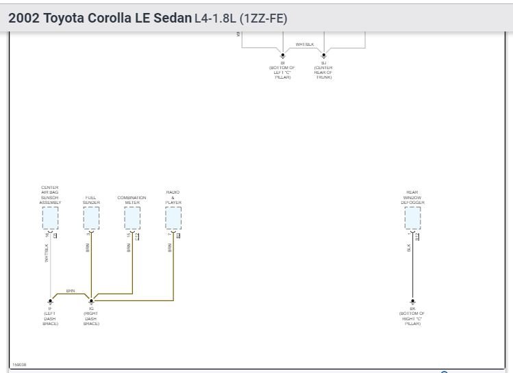

When I start driving the needles work well after a certain time when I start changing the speed then accelerate all needles get back on zero point then immediately display wrong result.

Absolutely When I turn the engine in neutral the needles works well, there are times that I drive without problem. I found that when the needles start deviating the battery also indicates a bad contact in the dashboard. This morning I checked the load of the alternator and the battery it were okay. I found 12.66 without engine , 14.03 after switching on the engine, 13.01 when i switched on all devices. Would there be another diagnosis to be made other than that? Thanks

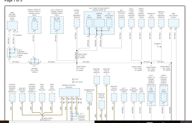

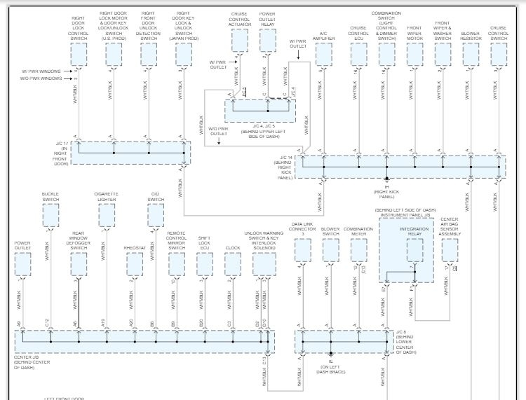

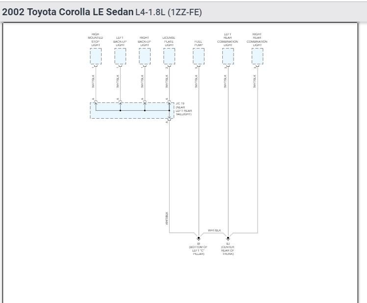

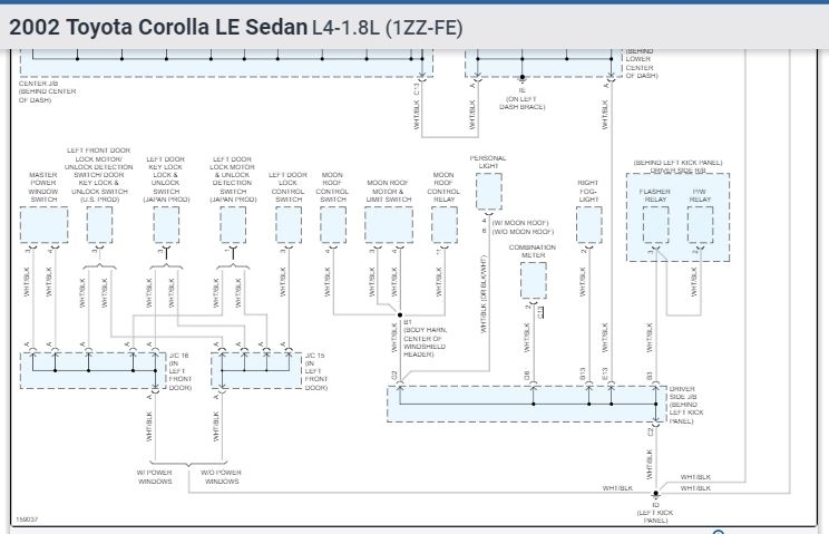

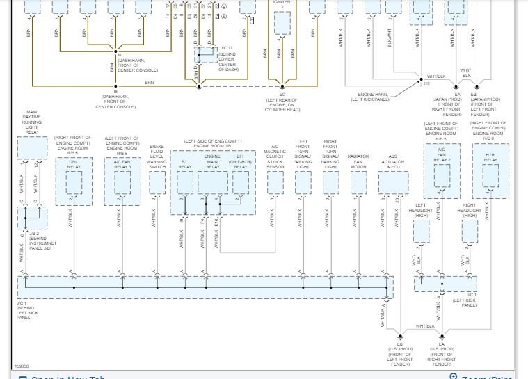

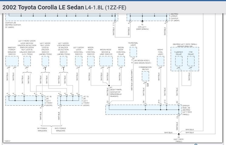

It's been my experience that a high percentage of electrical problems turn out to be an issue with a ground. Especially when the problem isn't consistent. I have attached diagrams of the ground points for your car. I have also included a link to our tutorial on using a voltmeter to assist you, it will be the ohm testing you'll need. Using the guide you'll want to test resistance between the battery ground and the ground points in the diagrams I have attached. I hope this helps you track down your issue and thank you for using 2CarPros. https://www.2carpros.com/articles/how-to-use-a-voltmeter
