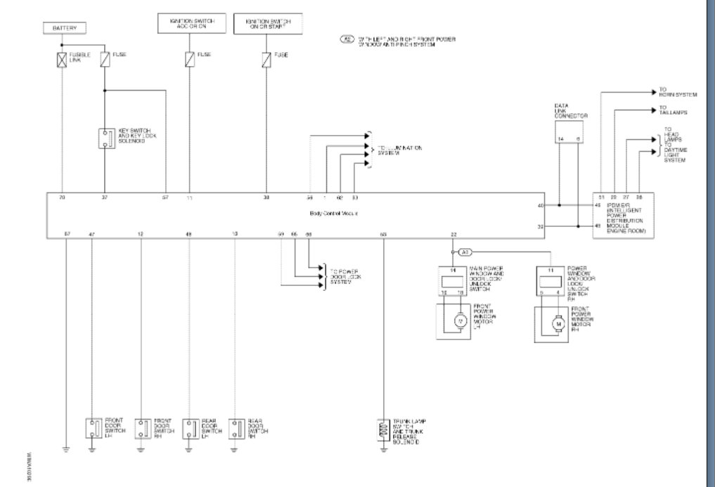

This car has keyless entry and its remote does not open or lock the car, even if the car key is inside the car. it does not get the signal unless you put it in the keyhole. I have changed the key fob battery, but it persists. Please, what should I do next? I have even programed the car key severally.
May 22, 2022 at 12:28 AM

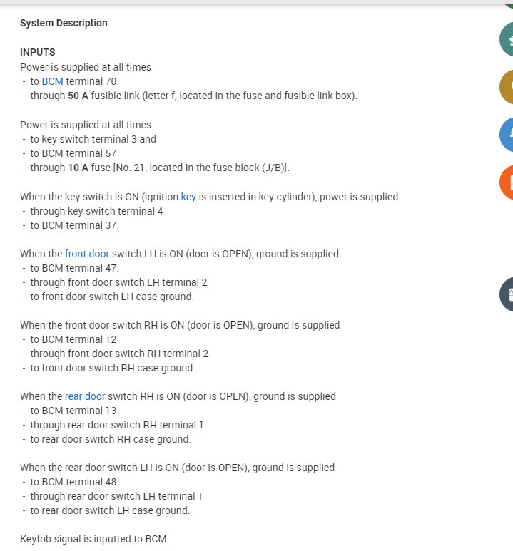

Just to be sure the only way you can unlock the door is with the key in the door and turning it or the key has to be in the door as the only way the remote door will unlock? Meaning are you putting the key in and then pressing the unlock button on the key to get it to unlock or are you just using the key manually to unlock the door?
Either way the place to start is to check for codes because I suspect we have a body control module issue.
So, I suspect we have some open circuit codes that would cause this.
Basically, what happens is the BCM is not getting or ignoring the command from the key to open the door.
So, I am attaching the info below but let's start with the codes and we can go from there, but I suspect we are going to have to check the power at the PCM from these circuits.
