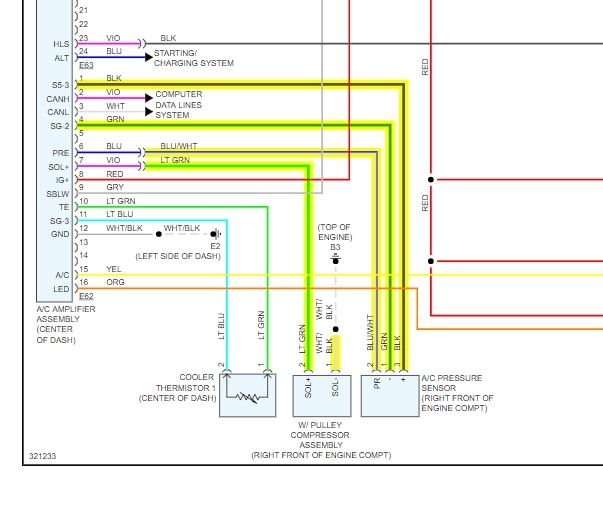

The A/C stopped blowing cold air while sitting in traffic
2010 TOYOTA COROLLA
162,000 MILES • 1.8L • 4 CYL • 2WD • MANUAL
OPFPILOT
Blows hot air only. Thought it might be a compressor clutch relay. But, I can't find it. Any ideas?
Apr 30, 2019 at 3:56 PM
Good evening,
The first thing that needs to be checked is the pressures in the system. Without the proper pressure, the AC system will not come on.
Do you have a set of gauges to check the high and low side pressures?

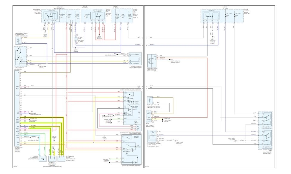

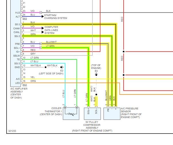

I attached a wiring diagram for you. There is nor relay. The control head sends power to the compressor when it gets the correct signal from the pressure switch.
