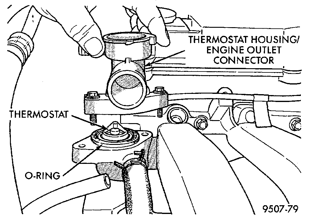

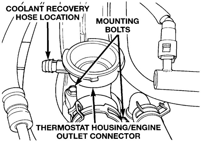

The temperature gauge reads normal most the time, but sometimes goes up to the H mark. Then it quickly goes back down to it's normal range.
Sep 11, 2019 at 2:56 PM
SCOTTDQ001
  • 15 POSTS
Also, I forgot to add that the car isn't losing coolant.

Have you checked the thermostat? It could be sticking.

That is my first suspect. However, if you choose to replace it, I also recommend flushing the system when it is out of the engine to eliminate that as an issue.
https://www.2carpros.com/articles/coolant-flush-and-refill-all-cars
Here are the directions specific to your vehicle. I don't know if you have the SOHC or DOHC engine, so I will provide directions for both. The attached pics correlate with the directions.

1998 Dodge Neon L4-122 2.0L DOHC VIN Y SFI
Procedures
Vehicle Engine, Cooling and Exhaust Cooling System Thermostat Service and Repair Procedures
PROCEDURES
REMOVAL
1. Drain cooling system to the thermostat level or below.
Thermostat/Engine Outlet Connector-DOHC
Pic 1
2. Remove Coolant Recovery System (CRS) hose and thermostat/engine outlet connector bolts.
3. Remove thermostat an O-ring assembly, and clean sealing surfaces.
INSTALLATION
1. Place the new thermostat assembly into the thermostat housing/outlet connector. Align vent with notch in cylinder head.
2. Install thermostat housing/outlet connector onto cylinder head and tighten bolts to 12.5 Nm (110 inch lbs.). Connect the Coolant Recovery System (CRS) hose.
3. Refill cooling system (see Refilling System).
1998 Dodge Neon L4-2.0L VIN C
Procedures
PROCEDURES
Removal
Thermostat/Engine Outlet Connector - 2.0L Engine
Pic 2
Thermostat And Engine Outlet Connector - 2.4L Engine
Pic 3
2. Remove Coolant Recovery System (CRS) hose and thermostat engine outlet connector bolts.
3. Remove thermostat assembly, and clean sealing surfaces.
Installation
1. Place the new thermostat assembly into the engine outlet connector. Align air bleed with notch on the cylinder head.
2. Install engine outlet connector onto cylinder head and tighten bolts to 12.5 Nm (110 inch lbs.). Connect the coolant recovery system (CRS) hose.
3. Fill cooling system.

Let me know if this helps.

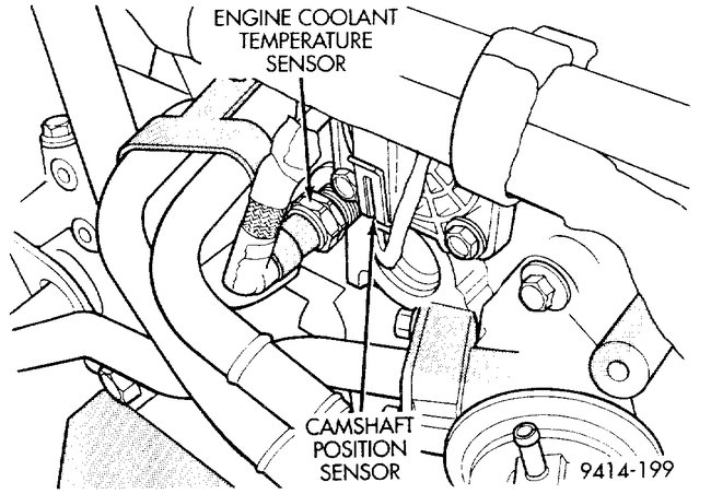

My guess was the thermostat or the coolant sender switch.

It could be either. However, more commonly it would be a thermostat. There isn't any evidence of a head gasket problem, correct?
As far as the sensor, you can remove it and inspect it's operation by checking the ohms of resistance based on temperature. If you want to just replace it, here are the directions and the attached pic correlates with the directions.

1998 Plymouth Neon L4-2.0L VIN C
Coolant Temperature Sensor Removal and Installation
COOLANT TEMPERATURE SENSOR REMOVAL AND INSTALLATION
Fig. 107 Engine Coolant Temperature Sensor-SOHC
Pic 1
NOTE: The engine coolant temperature sensor threads into the rear of the cylinder head (Fig. 107).
REMOVAL
1. With the engine cold, drain coolant until level drops below sensor.
2. Disconnect coolant sensor electrical connector.
3. Remove coolant sensor.
INSTALLATION
1. Install coolant sensor.
- Tighten to 18 Nm (165 in lb) torque.
2. Attach electrical connector to sensor.
______________________________________
Let me know if any of this helps or if you have other questions.

Okay, thanks. There doesn't seem to be any evidence of a head gasket problem.
Sep 13, 2019 at 1:30 AM
SCOTTDQ001
  • 15 POSTS
What makes me think that it's the sending unit, is the problem is intermittent. It doesn't happen too often.
Sep 13, 2019 at 2:05 AM
  • 110,194 POSTS
Welcome back:
That makes sense. Before you replace it, make sure the connector is tight and free of corrosion. Also, make sure the wire to it isn't damaged.
