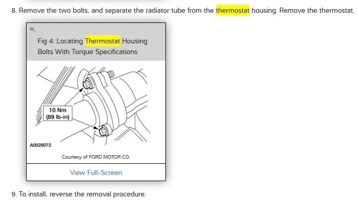

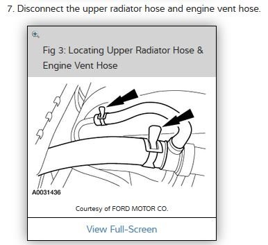

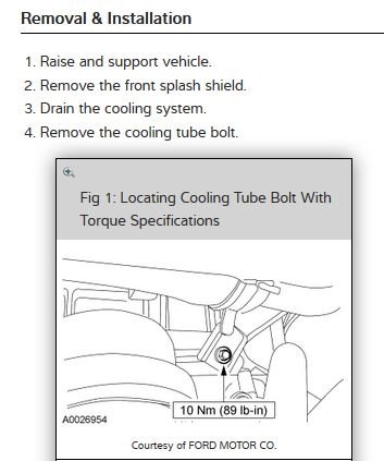

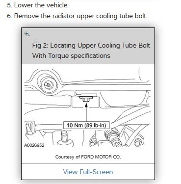

There are potentially two things that can cause this to happen. The first is that the thermostat, which regulates coolant flow and keeps it from flowing until the engine has warmed up, is stuck in the open position. This would mean that the coolant is constantly flowing at full speed, and keeping the engine from ever getting warmed up. Since your heat is directly derived from the temperature of the coolant, the heat will not get warm either.
The way that your heat works is that coolant flows through a miniature radiator (called a heater core) and the blower blows air through the core, thus warming the air up before it comes out through the vents.
The other possibility, less likely, is that your car is really low on coolant and is just getting enough to keep the engine cool enough. The coolant isn't really reaching the coolant temperature sensor though, so it produces a "cold" signal. Not enough coolant in the system would also affect your heat. Again, this is unlikely because your engine should be overheating, unless you're only running it for a few minutes.
Check your coolant level. It only takes a few seconds. Then, if it's full or even just not horribly low, replace the thermostat. Simply open the hood and take the radiator cap off when the engine is cold (and hasn't run for a couple of hours). If you can see the coolant level in there, then you should be good. If not, add some until it is full, and recheck it after driving a while.
I'm including instructions on replacing the thermostat in the images below and in a general guide.
How a thermostat works: https://www.2carpros.com/articles/how-an-engine-thermostat-works
How to replace a thermostat: https://www.2carpros.com/articles/replace-thermostat
Let me know what you find and we'll go from there.
- Harry

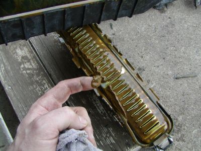

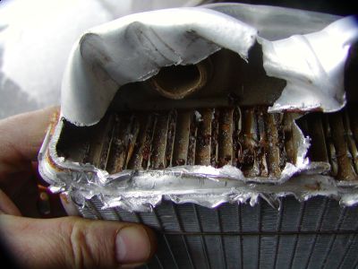

I want you to bring the engine to operating temperature. Feel both the inlet and outlet hose for the heater core. They both should be hot. Then hold the rpm 1500-2000. Do you get better heat? Higher rpm means higher flow rate and may heat the portion of the core that is not plugged. There are two common problems with these cars. First the heater cores are apt to plug up. Having clean water come out when backflushing is a surprise, but flow may still not be what it should be. That is a larger volume of coolant is not going through as it should.
https://images.2carpros.com/forum/automotive_pictures/30961_P2220004_1.jpg
This was a shot of a plugged core after it dried.
https://images.2carpros.com/forum/automotive_pictures/30961_P4250002_1.jpg
Sludge build up in a radiator. One option to try is to warm up engine then disconnect heater hoses,turned them up and filled core with radiator flush (or muriatic acid-about a 10% solution), left sit a couple hours and then flush again, pull bypass hose and blocked off with a couple rubber caps or however you choose. If both hoses were hot as mentioned in the beginning, then I would expect the heater core should be in an acceptable condition to provide heat. The second common problem is worn impellers on the waterpump. They erode enough that the coolant circulate not quite well enough to provide heat.

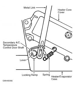

BMRFIXIT
  • 19,053 POSTS
This is your problem
https://images.2carpros.com/forum/automotive_pictures/99387_Graphic1_595.jpg
sorry i had no idea it a manual system and not the auto if you see that the actuator is moving when heat selected and return when cold selected remove blend door actuator and check make sure that the door is moving this is how to do it Removal & Installation Disconnect negative battery cable. Remove right lower console trim panel from instrument panel. If equipped with center console, remove right, front side panel from console. Disconnect A/C electronic blend door actuator connector from actuator. Remove 4 screws retaining A/C electronic blend door actuator to heater/evaporator housing. Remove A/C electronic blend door actuator. To install, reverse removal procedure.

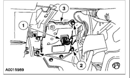

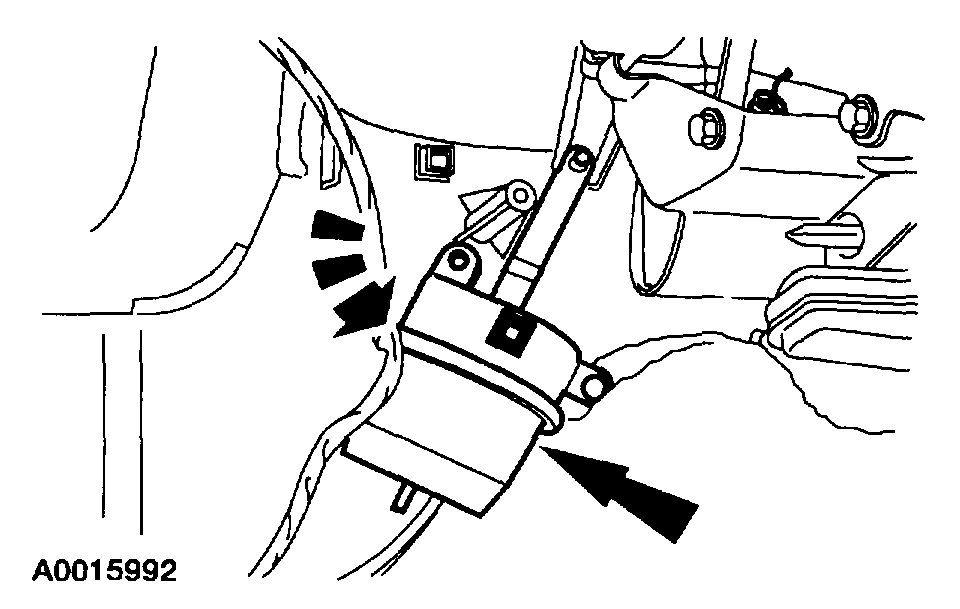

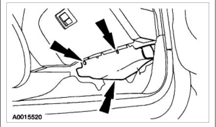

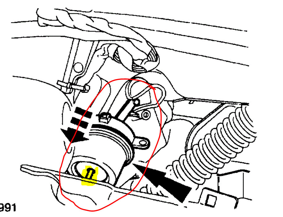

When I start my car, occasionally the heater and defrost will not work. No noise or air from the vents. It will eventually turn on once I’m driving for about 30-40 minutes. It doesn’t happen all the time.
Jun 22, 2021 at 4:30 AM (Merged)
  • 110,248 POSTS
The vehicle has an engine vacuum controlled mode door actuator. That is the actuator that directs airflow. Now the interesting thing is there is one for defrost and a different one for panel and floor airflow. That leads me to believe there is a vacuum leak.
With the engine running, listen closely for any hissing sounds coming from under the dash. That could indicate a leak.

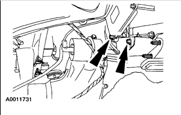

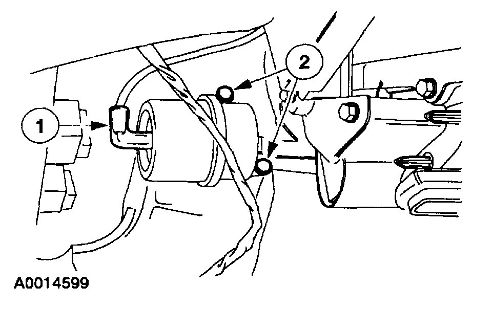

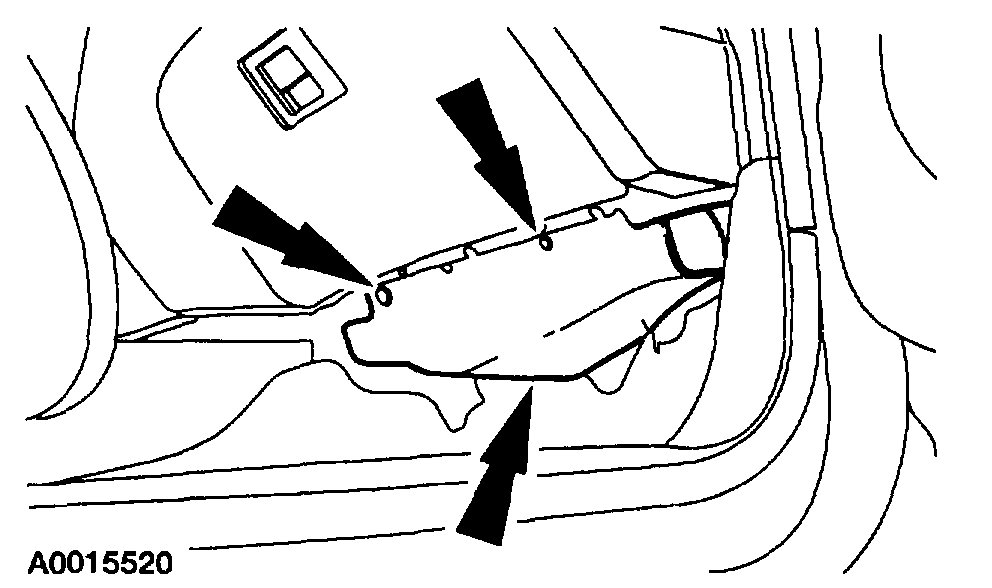

Next, I attached a pic below showing the defroster vacuum motor. Check the hose going to it to see if it is dry rotted, damaged, or loose.
Also, I'm including directions to replace the panel/floor actuator. This is to help you locate it.
_____________________________________
2000 Ford Taurus V6-3.0L VIN U
Panel, Floor Console Door Actuator
Vehicle Heating and Air Conditioning Air Door Actuator / Motor Service and Repair Procedures Air Door Actuator / Motor, HVAC Panel, Floor Console Door Actuator
PANEL, FLOOR CONSOLE DOOR ACTUATOR
REMOVAL
1. Remove the floor console. Refer to Console.
pic 2
2. Remove the right-side instrument panel insulator.
pic 3
3. Working the passenger footwell, remove the floor console register duct vacuum control motor.
1. Disconnect the vacuum hose.
2. Remove the screws.
pic 4
4. Rotate and remove the vacuum control motor from the floor console register duct door.
CAUTION: Do not attempt to bend any part of the floor console register duct door lever.
INSTALLATION
1. To install, reverse the removal procedure.
As I mentioned. Since you have two actuators having trouble, it sounds like a leak and not one of the actuators. If you check the two things I suggested, start the engine and move the hoses around to see if you can hear a leak.

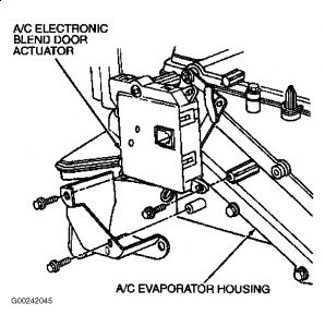

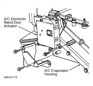

DONNIE JOHNSON

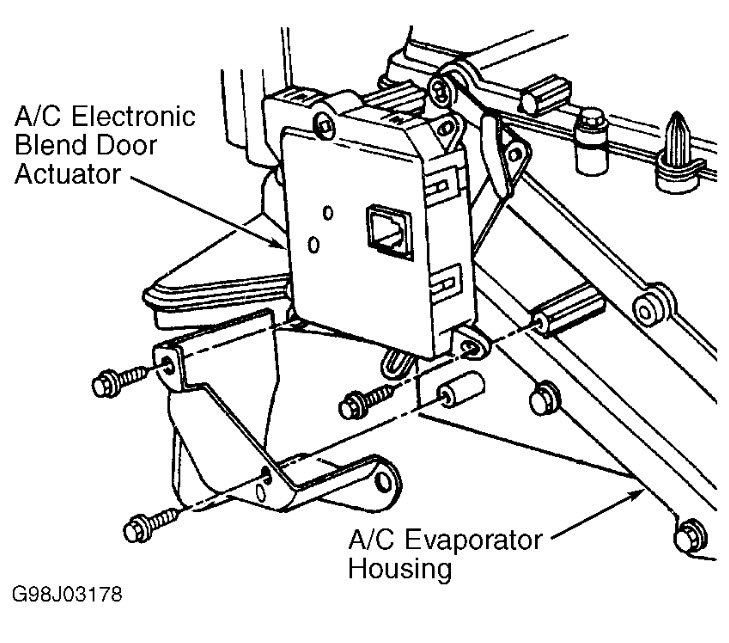

i have a 1997 ford taurus and the heater dose not work i have check the hoses hot on both sides of the heater core checked the vac lines and switches doors seem to be changing but no heat the air cond. is going through its cycle weather it is on air or heat.
BMRFIXIT
  • 19,053 POSTS
https://images.2carpros.com/forum/automotive_pictures/99387_Graphic1_558.jpg
https://images.2carpros.com/forum/automotive_pictures/99387_Graphic2_268.jpg
DONNIE JOHNSON
I removed the blend door actuator and got a new one fixed!
