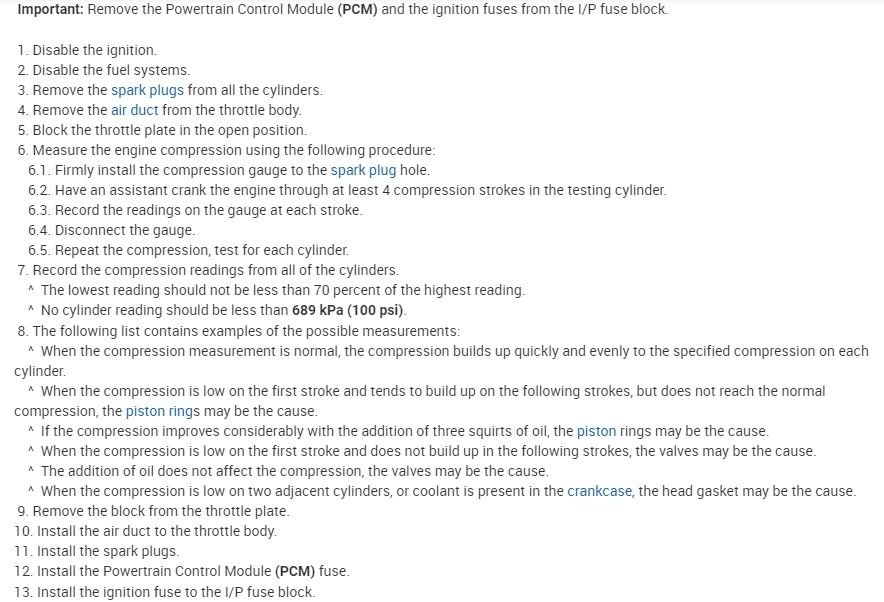

Good morning,
The pressure build-up and the bubbles are the clue.
Sounds like you have a failed head gasket from the overheating allowing compression gases into the cooling system.
A leak down test will confirm. You need to remove the spark plugs and insert an air fitting into each cylinder one at a time. Then use shop air to pressure up the cylinder and watch for coolant movement in the radiator. That will confirm if a head gasket has failed.

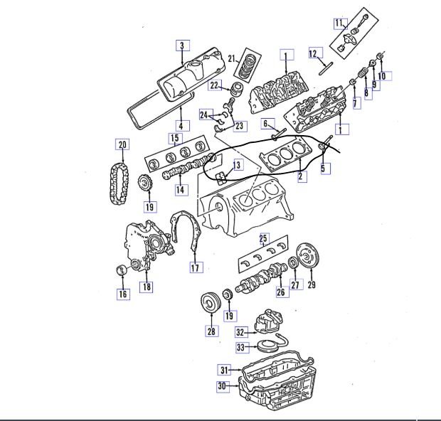

well, it is the gasket.
Jan 11, 2020 at 11:10 PM
Just what I figured.
Make sure you do both gaskets, not just one.
Make sure the heads are checked for cracks and for being warped as well.

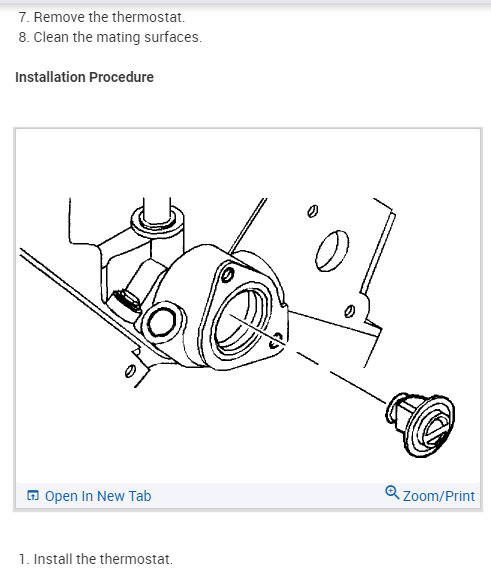

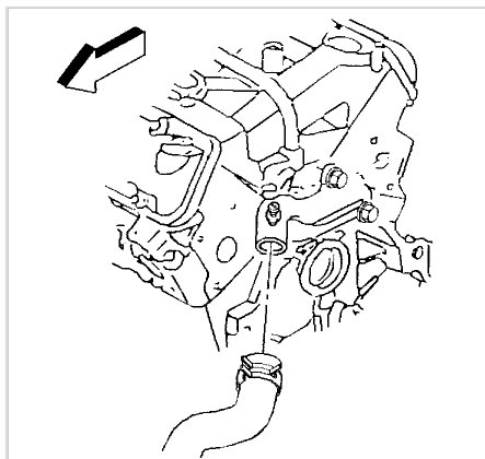

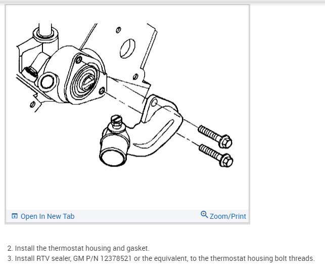

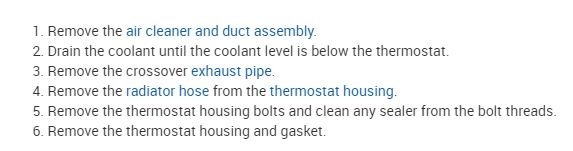

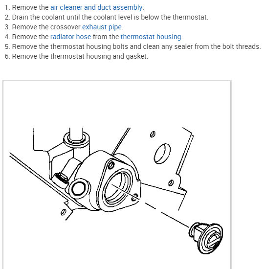

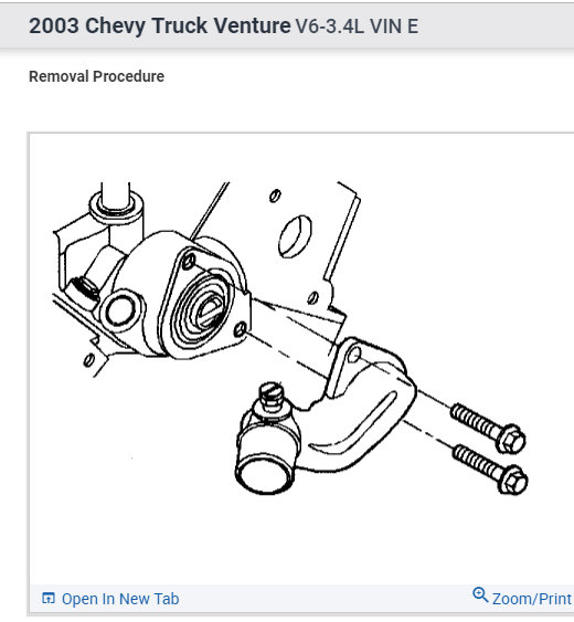

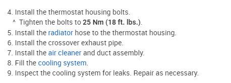

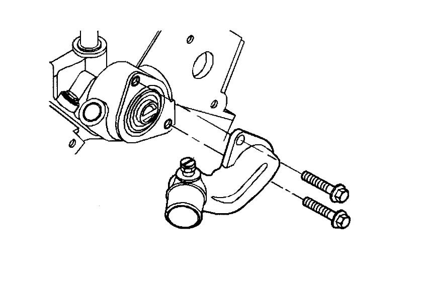

DANNY L
  • 5,648 POSTS
Hello, I'm Danny.
Here is a tutorial showing what is involved in replacing the thermostat:
I've attached below step-by-step instructions.Hope this helps and thanks for using 2CarPros.
Danny-
Aug 21, 2020 at 4:44 AM (Merged)

SERVICE WRITER
  • 9,123 POSTS
IT is under the throttle body on the driver;s side. IT's a PITA. I don't know your skill level and patience. A novice should set aside 3-4 hours. I think book is around 1.3 hours.
Aug 21, 2020 at 4:45 AM (Merged)
