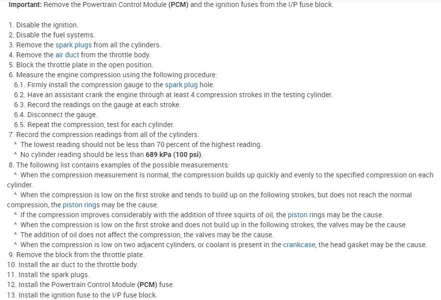

so I have been fighting this problem for a while. car seems to be overheating. changed radiator, water pump, thermostat, thermostat sensor, bled the lines. the gauge still says red. but when I used a light thermometer to test the temperature of the engine and pips it reads 150 to 139 and looks like the radiator is pushing the antifreeze into the overflow reservoir. saw what looked like bubbles coming out of the hose that goes from the radiator to the reservoir.
Jan 10, 2020 at 5:47 AM
Good morning,
The pressure build-up and the bubbles are the clue.
Sounds like you have a failed head gasket from the overheating allowing compression gases into the cooling system.
A leak down test will confirm. You need to remove the spark plugs and insert an air fitting into each cylinder one at a time. Then use shop air to pressure up the cylinder and watch for coolant movement in the radiator. That will confirm if a head gasket has failed.

Okay, no, you cannot put the coolant sensor in too far. As far as the driving, that is an indication of the head gasket. You could try a thermostat but I doubt that is the issue.

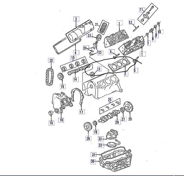

well, it is the gasket.
Jan 12, 2020 at 7:10 AM
Just what I figured.
Make sure you do both gaskets, not just one.
Make sure the heads are checked for cracks and for being warped as well.

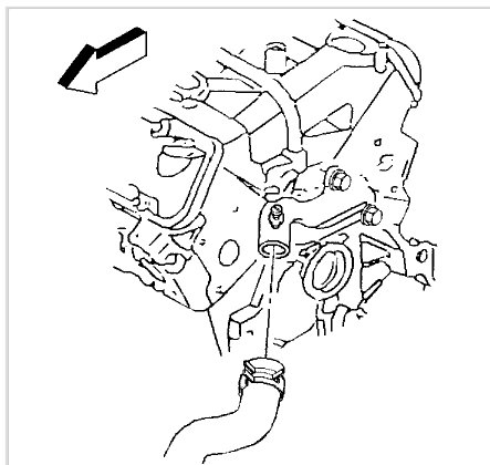

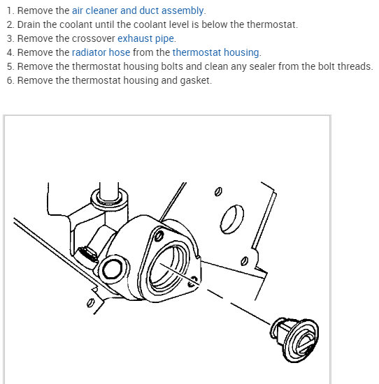

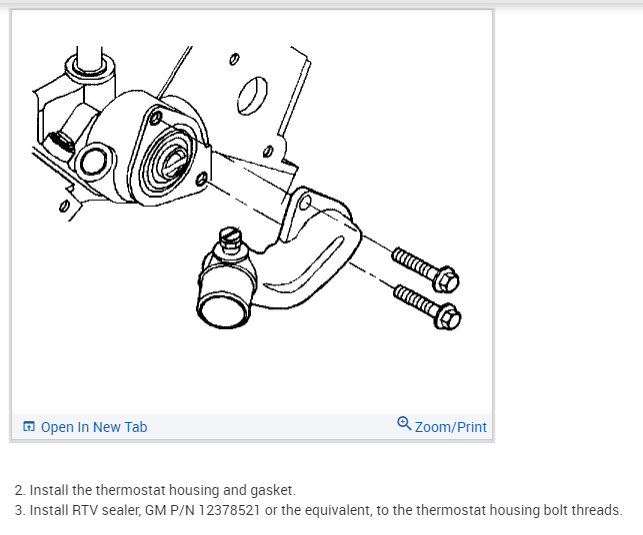

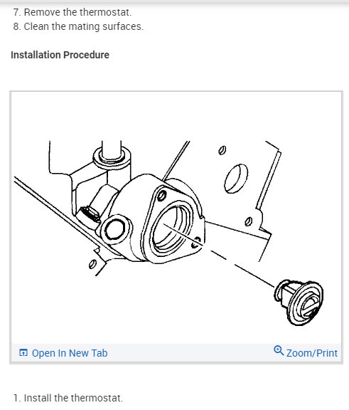

DANNY L
  • 5,648 POSTS
Hello, I'm Danny.
Here is a tutorial showing what is involved in replacing the thermostat:
I've attached below step-by-step instructions.Hope this helps and thanks for using 2CarPros.
Danny-
Aug 21, 2020 at 11:44 AM (Merged)

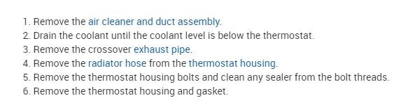

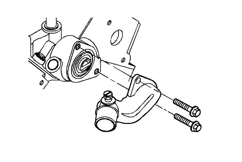

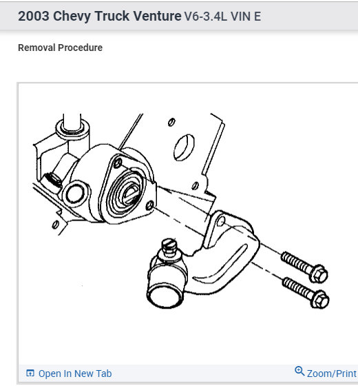

where is it and can I do it myself
Aug 21, 2020 at 11:45 AM (Merged)
SERVICE WRITER
  • 9,123 POSTS
IT is under the throttle body on the driver;s side. IT's a PITA. I don't know your skill level and patience. A novice should set aside 3-4 hours. I think book is around 1.3 hours.
