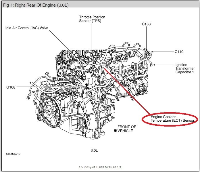

As soon as I turn the key to the on position the temperature gauge for the coolant goes to halfway point and stays no matter the temperature of the engine. I replaced the temperature sensor and still the same. I was wondering if my vehicle has a temperature sender too? If it does could this be my problem?

CJ MEDEVAC
  • 11,004 POSTS
SENDER IS FOR THE GAUGE
YOUR CAR DOES NOT CARE IF YOU HAVE AN ACCURATE GAUGE! (IT IS THERE FOR YOU TO MONITOR FOR AN "OVERHEAT SITUATION") IT ( SENDER AND GAUGE) HAS NO INFLUENCE ON PERFORMANCE
THE SENSOR TELLS MR. COMPUTER THE ENGINE TEMPERATURE SO IT CAN CREATE THE BEST AIR/ FUEL MIXTURE (WHILE ALSO USING INPUT FROM THE OTHER SENSORS ON BOARD)
HERE IS THE "SENSOR" THAT TELLS THE COMPUTER THE TEMPERATURE.
http://shop.advanceautoparts.com/p/carquest-by-bwd-temperature-sensor-wt5067/15970002-P?searchTerm=coolant+temperature+sensor
BELOW I FOUND THE "SENSOR" IN A DIAGRAM FROM "PRODEMAND"
I WAS UNABLE TO FIND A DIAGRAM FOR THE "SENDER" (SORRY!)
THIS HELP ANY?

CJ MEDEVAC
  • 11,004 POSTS
I DID A LITTLE ASKING AROUND
SOUNDS LIKE IT IS BEHIND THE AIR CONDITIONER COMPRESSOR/ FRONT OF BLOCK/ CLOSE TO THE OIL FILTER.
LET ME KNOW IF THEY WERE RIGHT.

RICKY927
  • 11 POSTS
I believe I located it, but the problem is that it looks nothing like the part they sell at Autozone or online, it has a connection for a single wire, all the parts I have seen online have two wires. I unplugged it though thinking that if I did so the temperature should not move at all, but unfortunately still the same thing. I have been told that I could have a bad cluster, and may need replacing. What's your input on that?
