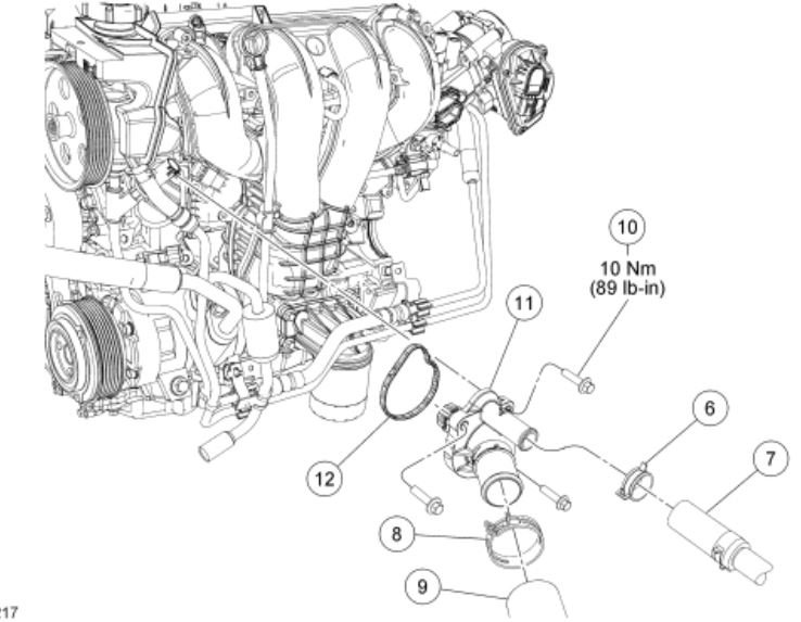

When I turn my heaters on my temperature gauge falls, sometimes down to the 60° marker. This can happen even on longer journeys where the engine has been working harder or on short journeys. It never rises above 90° or normal range. I want to know if this is normal or if it is something I should be concerned about. If the fans are on cold it does not happen. It only happens when using the heaters.

It sounds like you have a faulty thermostat that is preventing the engine from maintaining proper operating temperature. I would recommend replacing the thermostat which on your car it is part of the thermostat housing assembly. I have attached a diagram showing you where it is and how it goes together.
Here are the instructions on replacing it:
Removal and Installation
Note: The thermostat and thermostat housing are serviced as an assembly.

Remove the 3 bolts and reposition the thermostat housing to gain access to the hose clamps.
Remove and discard the gasket.
To install, tighten the bolts to 10 Nm (89 lb-in).
Disconnect the radiator and heater hoses from the thermostat housing.
Note: Lubricate the thermostat housing O-ring with clean engine coolant.
To install, reverse the removal procedure.
