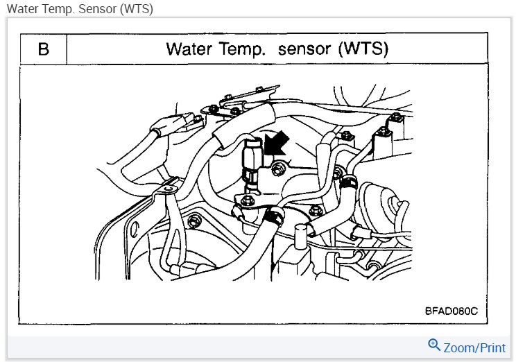

My dash temperature needle goes immediately up to 3/4+, nearly pegged, as soon as the engine is turned on.
Before having the AC compressor replaced it always went all the way up.
My Foxwell OBDII shows ECT (F°) = 203.
What is the normal engine temperature?
What is wrong with the dash indicator?
Any suggestions could help. Do not want to take a long drive not knowing if I am overheating.
Aug 25, 2018 at 9:09 AM
  • 55,433 POSTS

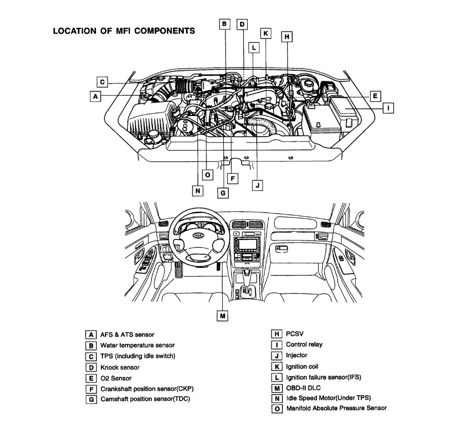

It sounds like the engine coolant temperature sensor is not working right. The engine should start cold and then go up to operating temperature which is about 205-210 Degrees.
Here is a guide that will walk you through the steps and a diagram below to show you the location of the sensor for your car:
https://www.2carpros.com/articles/coolant-temperature-sensor-cts-replacement
