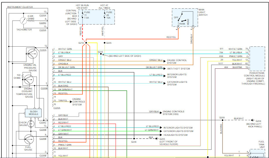

I recently rebuilt my 3.0 v6 and it is running great now. But I’m not getting a reading on my temperature gauge. I’ve replaced both sensors and checked the connections and everything looks good, no corrosion. I’m at a loss here. Thermostat is new as well as the radiator. Any ideas?

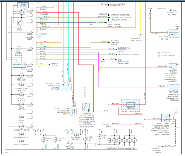

Since you've replaced both sensor then it sound like you might be having trouble with the wiring or gauge in the instrument cluster. I've attached the instrument cluster wiring diagram below. I've cut the picture in half so you can view larger. Here is a tutorial showing how to test wiring:

So it turns out it has a temperature switch for the gauge on the down spout in front of the thermostat housing. There were two temperature sensors instead of the correct temperature sensor and temperature switch.

The temperature sensor is on the back side of the thermostat housing with 2 wires, the temperature switch is in the front of the thermostat housing with only 1 red wire. My problem was a temperature sensors was in both spots in stead of a temperature switch in the correct spot so when I put the correct part in it worked.
