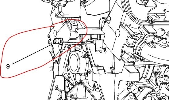

Start car and temperature goes up quickly, but it not always and it seems like it's not even that hot. From my research I kind of narrowed it down to coolant temperature sensor. What do you think?

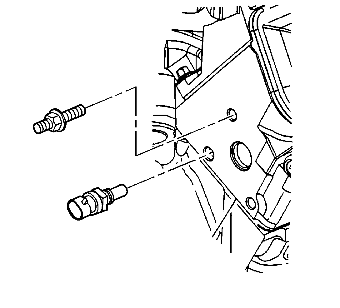

The coolant temperature sensor can cause problems as well as a bad connection to it or shorted wiring. You need to keep in mind, there are two coolant sensors on this vehicle. One is for the gauge in the vehicle and the other is for the computer. The one you need to focus on is on the rear of the engine cylinder head. I attached two pictures to help you locate it.
To replace the sensor, you will need to partially drain the coolant from the engine. Here are a few links you may find helpful. They discuss symptoms of a bad coolant temperature sensor and how in general one is replaced:
