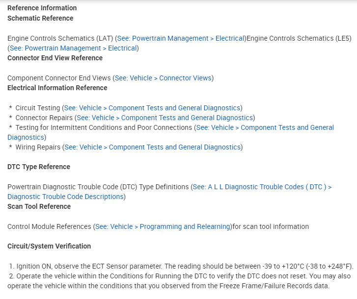

I recently had my water pump replaced and everything seemed fine. now my temperature gauge doesn’t want to read. I replaced the coolant temperature sensor and thermostat and it worked for a day then stopped working again. The code I have is p0117.
Aug 13, 2019 at 4:03 PM
DANNY L
  • 5,648 POSTS
Hello, I'm Danny.

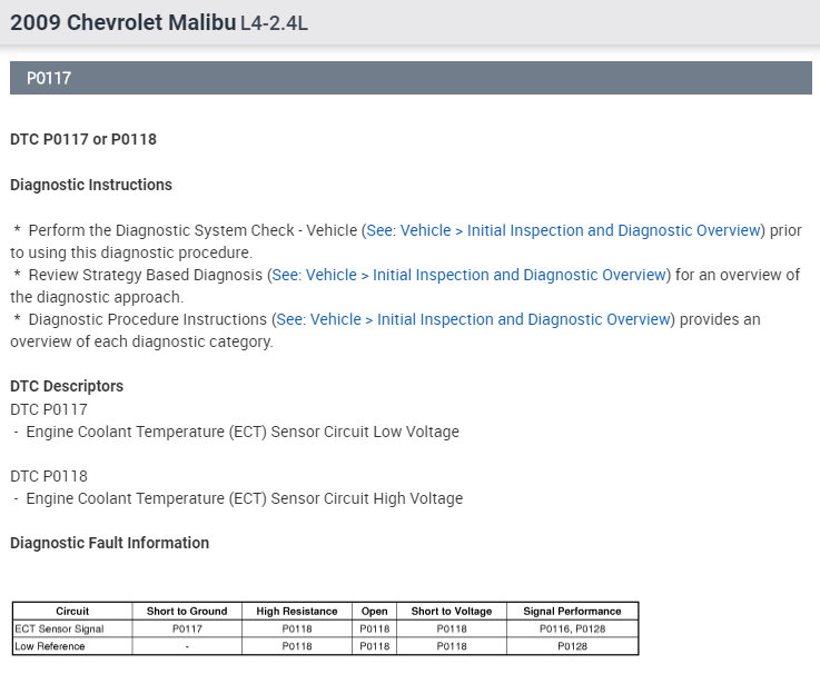

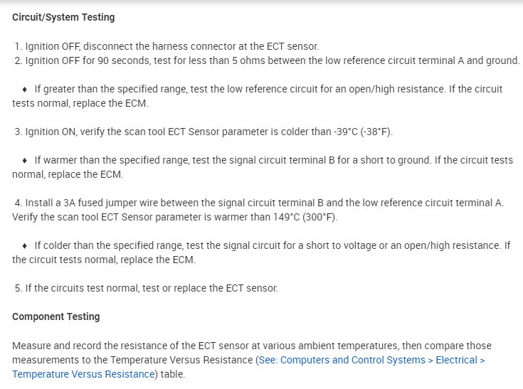

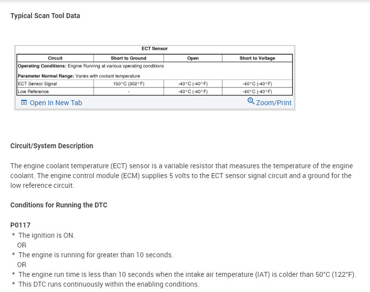

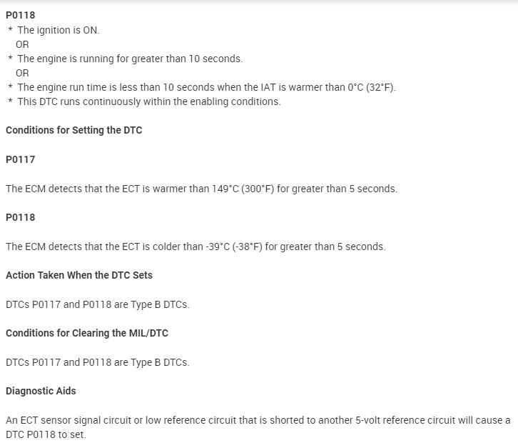

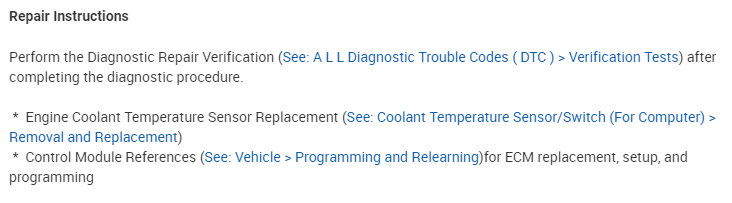

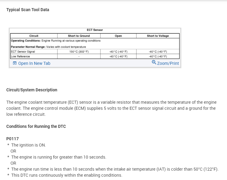

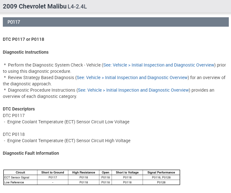

The code is showing a fault in the coolant temperature circuit. Here is a tutorial showing how to test wiring:
I've attached step-by-step instructions below on how to test and fix.Hope this helps and thanks for using 2CarPros.
