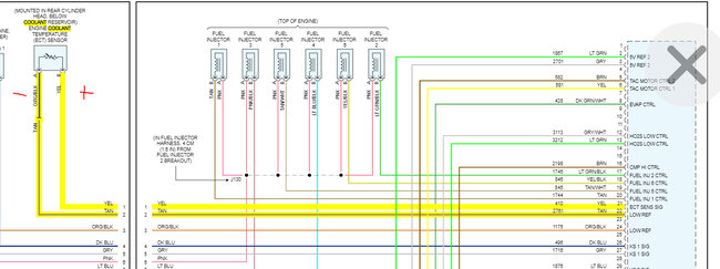

For the past 4 years, the temperature gauge will only work in the warm months that I use my A/C. It will not work in the winter months while I run my heat. Just a few days ago, the temperature gauge quit working. I replaced the CTS thinking that was the problem. My temperature gauge is still not working, and the check engine light is on. Can someone guide me in the right direction of what it could be?

What you should do is scan the can-bus. CAN stands for controller area network. Basically, the different modules are tied together via a few wires. This will retrieve codes regardless of the module storing them.
Here is a link showing how it's done:

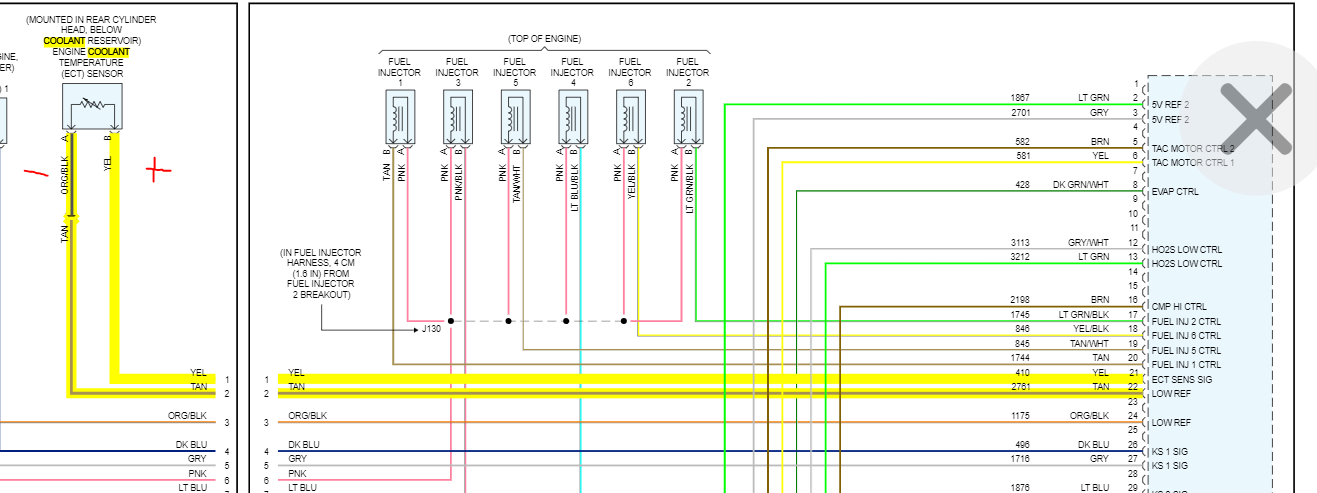

If you look below, I attached a pic from the wiring schematic. Note there are two wires to the sensor you replaced. One is a 5v reference signal and the other is a low reference or ground. If possible, check the yellow wire with a multimeter to see if there is power to it. If there is, check for a ground on the opposite wire. The key will need to be in the run position when you do this.
Let me know the results.
See pic below. Note: Make sure to check the connector and connector pins and wiring for damage.
