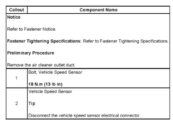

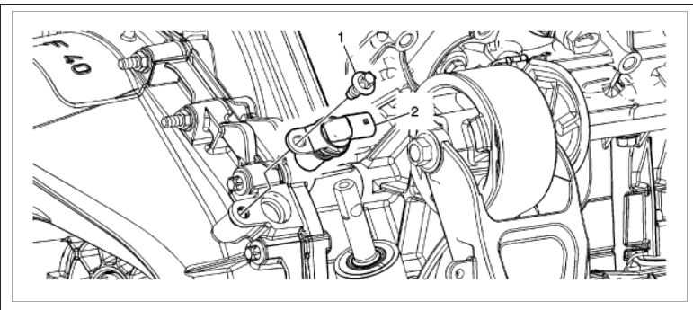

This is an easy one your VSS vehicle speed sensor is not working right I would replace it which should fix the problem.
Here is the location (below)

Yep you got the problem, I replaced the sensor like you said and the speedo works great no check engine light on ya! the sensor cost me $34.00 this site rocks!
