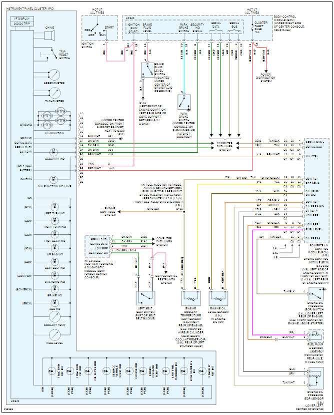

All of my gauges are stuck at zero when I am driving. The panel is not lighting up at all. Inside car light stopped working when the instrument panel stopped working. Radio still works. now the information center is saying low fuel, and service airbag. I know that it has fuel because I filled it up before my panel stopped working. Could it be a blown fuse?

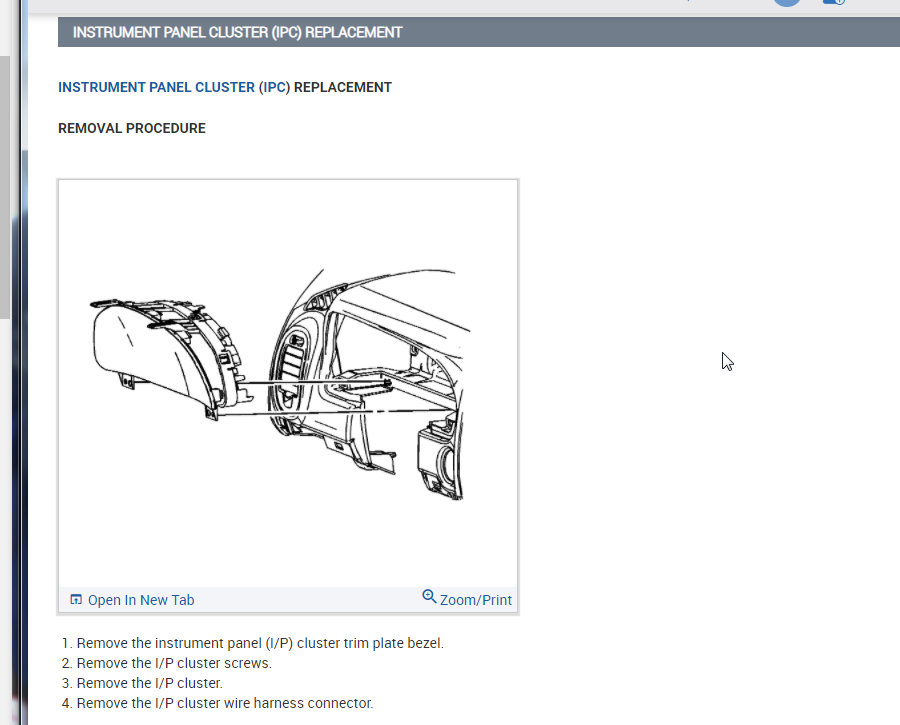

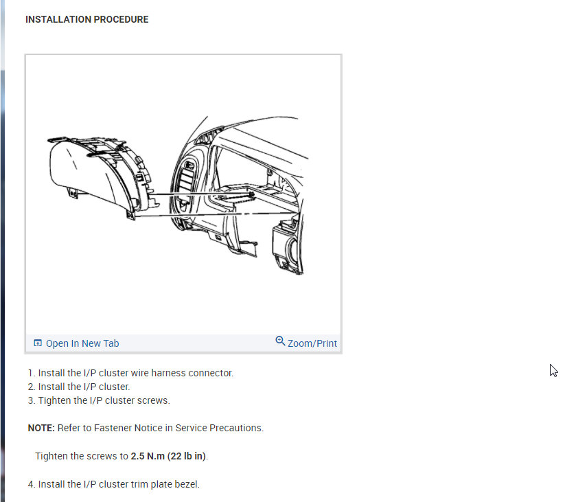

Unfortunately, this is most likely not a fuse issue. It is probably a cluster issue. We need to start with checking for codes and here is a guide on how to do that:
Once we know what codes are there, we will have a better idea as to what the issue is. However, if there are no codes, then we will need to replace the cluster.
Below is the process from the manual on how to do that.
Keep in mind you may have more than one issue so we need to start with codes and go from there. Thanks
