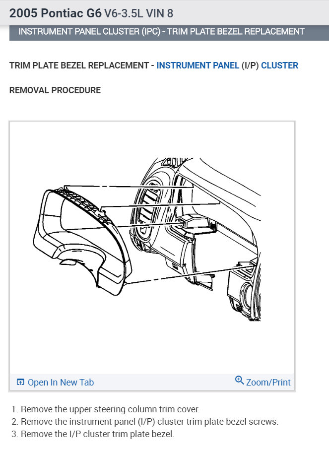

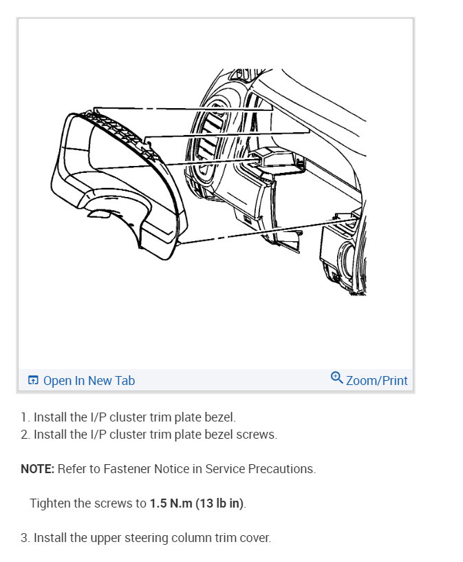

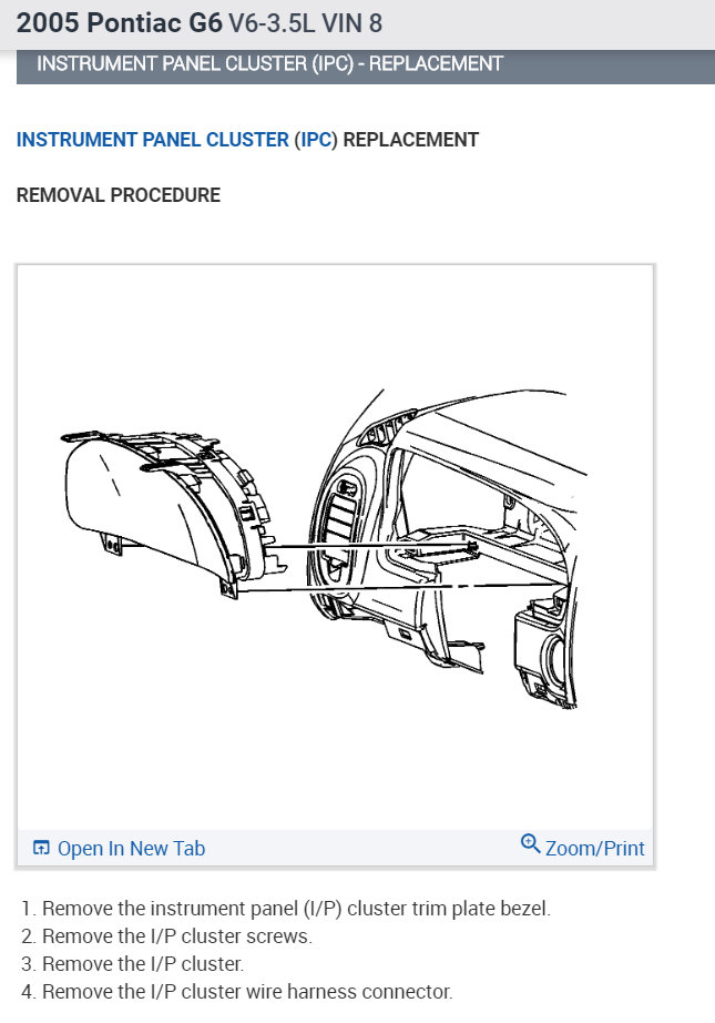

MARK CLEARY
Does anyone know how to put this part back in?
Dec 29, 2019 at 7:45 PM
  • 54,840 POSTS
I found the instructions on how to remove the cluster and bezel. Check out the diagrams (below). Please let us know if you need anything else to get the problem fixed.
