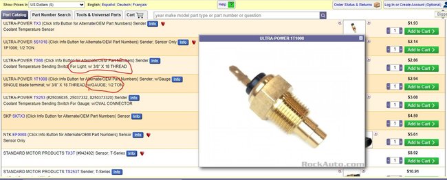

Replaced the temperature sensor and that did not fix problem. temperature gauge still does not read when engine is hot.
Oct 13, 2020 at 11:19 PM
Good morning,

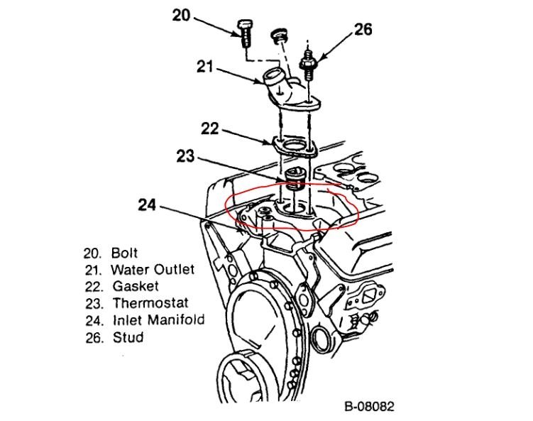

Can you give me the voltage reading at the temperature sensor on the cylinder head between number 1 and 3 cylinder spark plugs?

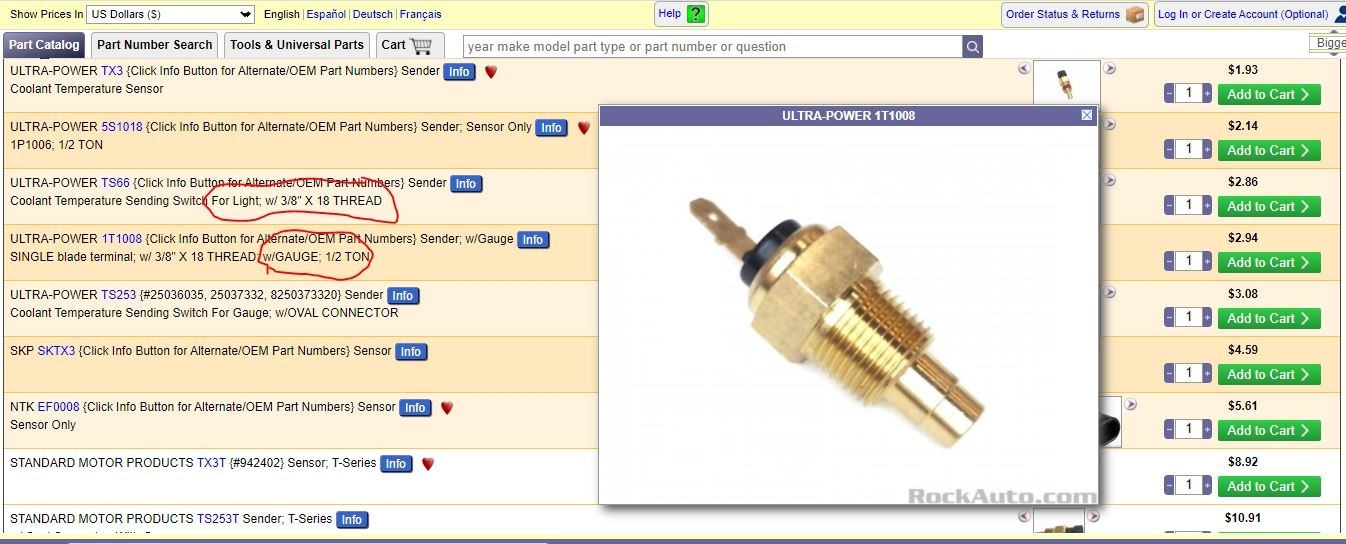

If it is reading okay when it is cold and normal, I am wondering if you either replaced the wrong sensor or you installed one for a light instead of a gauge.
There is a coolant temperature sensor on the intake by the thermostat but that is not the sensor.
https://www.2carpros.com/articles/how-a-coolant-temperature-sensor-works
https://www.2carpros.com/articles/coolant-temperature-sensor-cts-replacement
I attached the part selection as well. The 2 look the same but are different.
