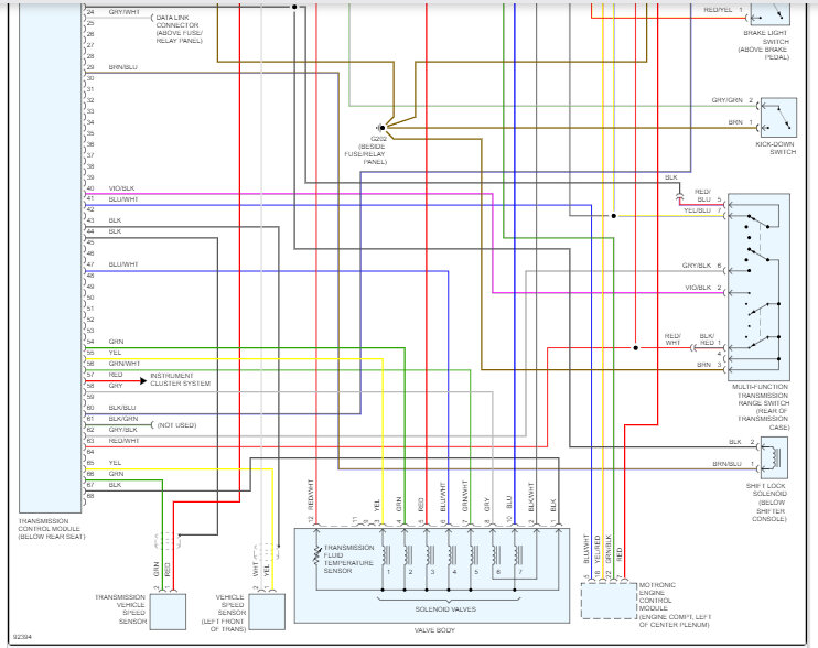

Please I need the complete wire diagram of the transmission control module. Please, thank you.
Jan 7, 2023 at 2:18 AM
  • 110,240 POSTS

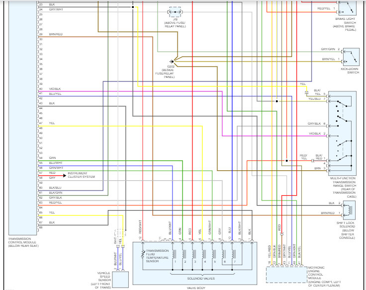

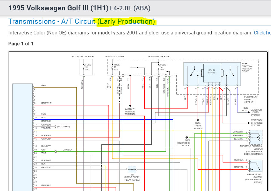

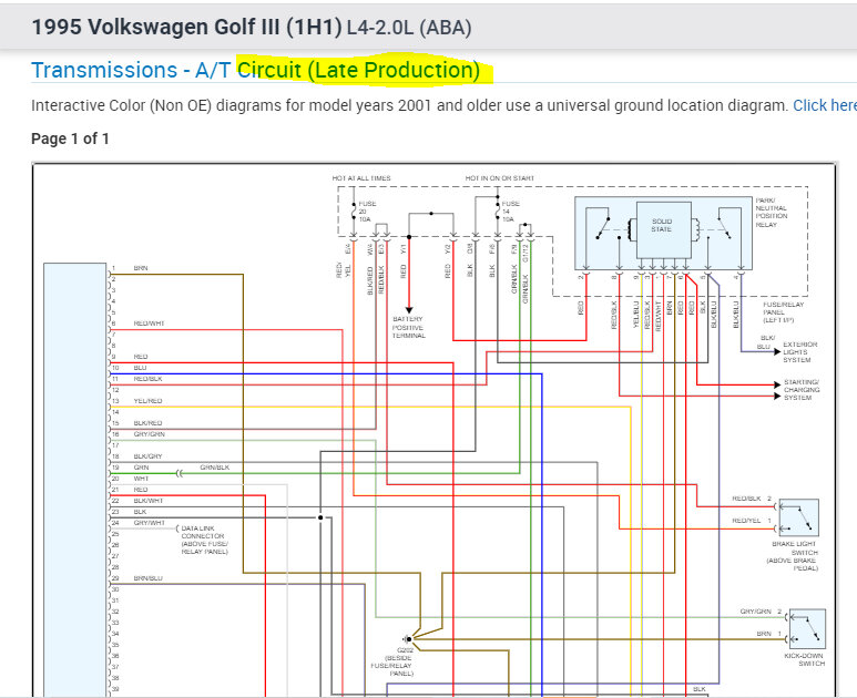

I got the schematic for the transmission, but there is an issue. There are two different schematics for the same vehicle. They are based on early vs late production.
I attached both below for you. The first two pics are for early production and pics 3 and 4 are for late production.
Note: I had to cut each page in half to make it readable for you. I did overlap them.
As far as the production date is concerned, you will need to locate that. Normally, there is a label when you open the door on the door frame or door itself that identifies the production date.
If you have a vehicle built before 1/95, it is an early production vehicle. After that date is considered late production.
I hope this helps. Let me know if you have questions.
