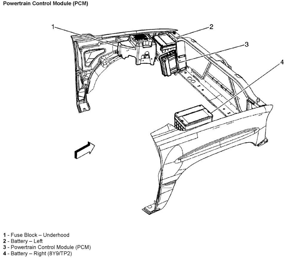

Where is the TCM located?
2006 CHEVROLET AVALANCHE
151,344 MILES • 5.3L • V8 • 4WD • AUTOMATIC
SETHDUPPIN
Cannot locate my transmission control module automatic control shift solenoid.
Jan 20, 2023 at 8:15 PM
STEVE W.
  • 15,344 POSTS

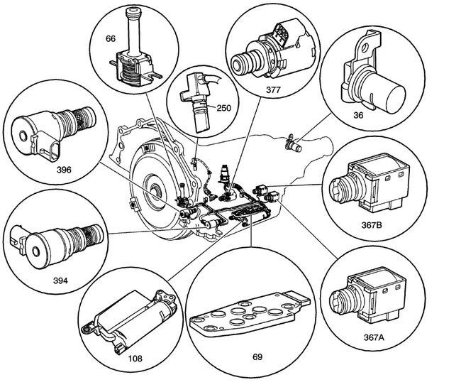

The TCM is a part of the powertrain control module aka engine computer located in the front of the truck under the left battery box. All of the shift control solenoids are inside the transmission, you need to drain the fluid, remove the pan, then the transmission valve body and then you have access to them all. What is the issue you are having; it may be possible to give a better answer if we know the problem.

Installed a remanufactured transmission all bolts and connectors connected wheels spin in air together in 4wd and 2wheel the same. Vehicle will not move in any gear.
Jan 21, 2023 at 6:53 AM
STEVE W.
  • 15,344 POSTS
That sounds like a bad remanufactured transmission then. If you put it in park with the wheels on the ground can you push it around? That would tell you if it's the trans or another item. If the park pawl holds it then your differential and T-case are OK and connected but there is an internal fault with the transmission, likely pump or pressure regulator not the TCM or solenoids.
