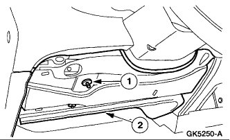

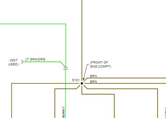

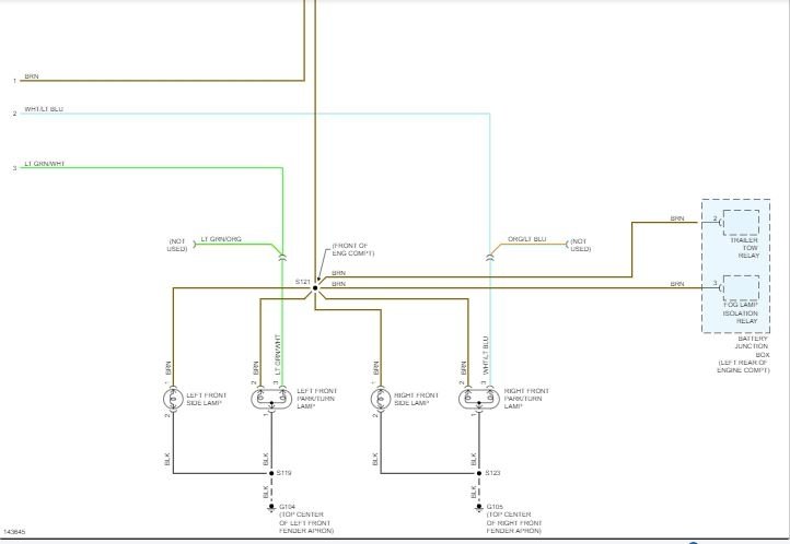

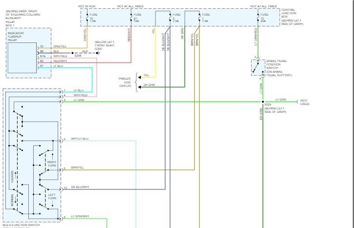

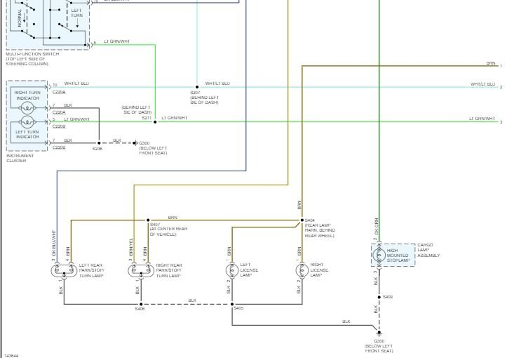

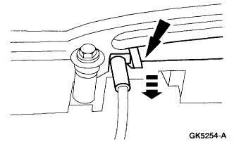

Had a minor crash which broke the right headlight since then the right turn signal quit, the right signal caused a buzzing when turned on, the tail lights quit. Replaced the headlight assembly and bulbs. The turn signals work, the buzz stopped, headlights work. No tail lights and the dash light still does not work. Pulled the fused indicated in the owners manual, all appear good (any hidden fuse locations). Not sure where to start. Planned to next check the voltage at the fuses to look for a bad connection. Any other good ideas where to look.

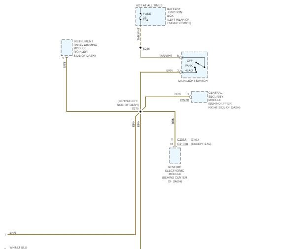

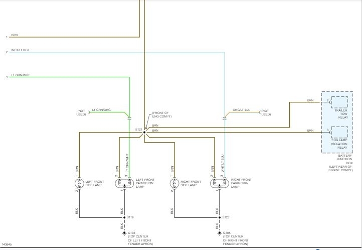

I looked through schematics and found a splice located at the front of the engine compartment that I feel may be the issue. It supplies power from the switch, to the all lights. If it was damaged, it may be the problem. I attached two schematics. Locate splice number (S121). I snipped that splice and added it as picture 3. Also, the schematics include all the fuses and power supplies.
I had to break the schematics into two parts because of size, but I overlapped them so you can see where they go together.
Here are a couple links you may find helpful:

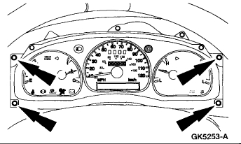

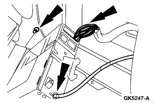

How can I replace the dashboard lights? I can't find a way to get to them.

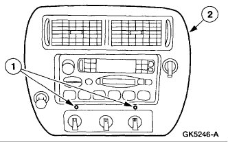

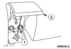

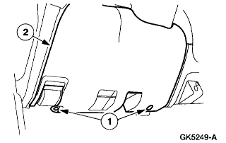

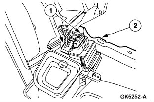

Hello –

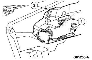

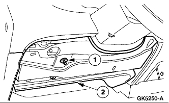

I believe this is what you are looking for…..you will have to remove the dash cluster to remove and replace the bulbs.
ILLUMINATION & INDICATOR BULBS
Removal & Installation
Remove instrument cluster. See INSTRUMENT CLUSTER . Remove instrument panel illumination or indicator bulb by turning socket and bulb counterclockwise. To install, reverse removal procedure.
PRINTED CIRCUIT
1. Remove instrument cluster. See INSTRUMENT CLUSTER . Remove instrument cluster gauge amplifier. See INSTRUMENT CLUSTER GAUGE AMPLIFIER .
2. Remove all instrument panel illumination and indicator bulbs by turning each bulb counterclockwise. Remove gauges. See GAUGES .
3. Remove 19 instrument gauge harness connector clips using long-nose pliers. Squeeze both sides of clip equally so locking ears pass through opening in instrument cluster case. Be careful not to overbend or distort clips. DO NOT reuse instrument gauge clips.
4. Ease instrument cluster printed circuit up and off locating pins and remove from case. To install, reverse removal procedure using NEW instrument gauge clips.

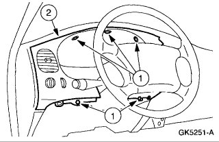

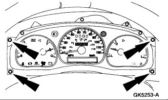

INSTRUMENT CLUSTER
CAUTION: Instrument cluster light bulbs are pressurized and may shatter if improperly handled. Wear eye protection when replacing instrument cluster light bulbs.

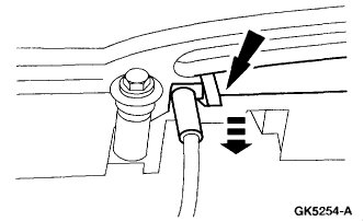

1. Disconnect negative battery cable. Remove 2 screws from center instrument panel finish panel and pull out center instrument panel finish panel. Remove radio. Disconnect electrical harness connectors. Remove hood latch release handle and cable from instrument panel steering column cover.
2. Remove 2 screws and instrument panel steering column cover. Remove 4 screws and instrument panel steering column opening cover reinforcement. Position column gear shift lever aside (if equipped). Remove 3 screws and pull out cluster finish panel. Disconnect electrical harness connectors and remove cluster finish panel.
3. Remove 4 instrument cluster screws. Pull out instrument cluster and remove transmission range indicator (if equipped with automatic transmission). Disconnect electrical harness connectors and remove instrument cluster. To install, reverse removal procedure.

1999 should still have replaceable bulbs. But you still have to pull the cluster out to change them. That means pulling the center trim panel, the radio, the trim under the dash and the trim under the steering wheel. Then you can pull the large trim panel and get to the cluster.
