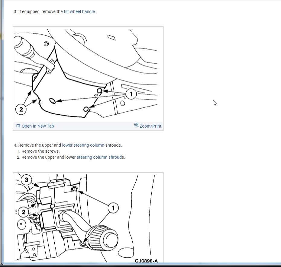

took dash apart to get to dimmer switch. dome lights work of switch but NO dash lights. tested all 4 wire to dimmer and 3 have no voltage and one has 12+. do not know if if is suppose to be like that. i need to figure if its the switch or the wiring.

Sounds like the switch has failed or you have the switch off and the main switch off when you are testing them.

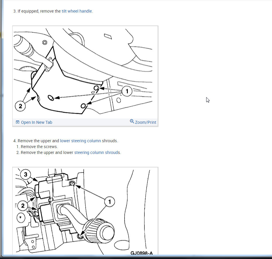

Here is a guide that will help with this testing:

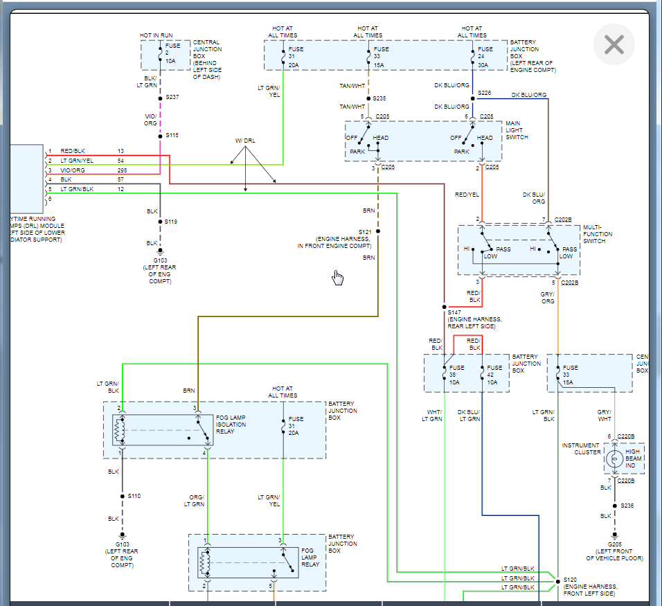

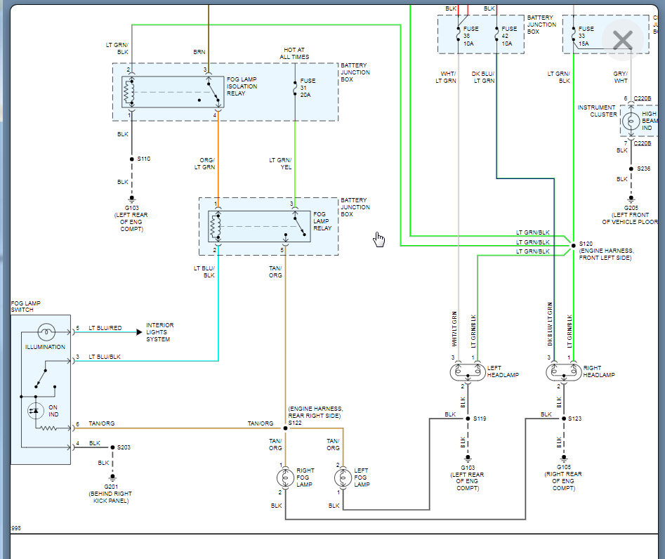

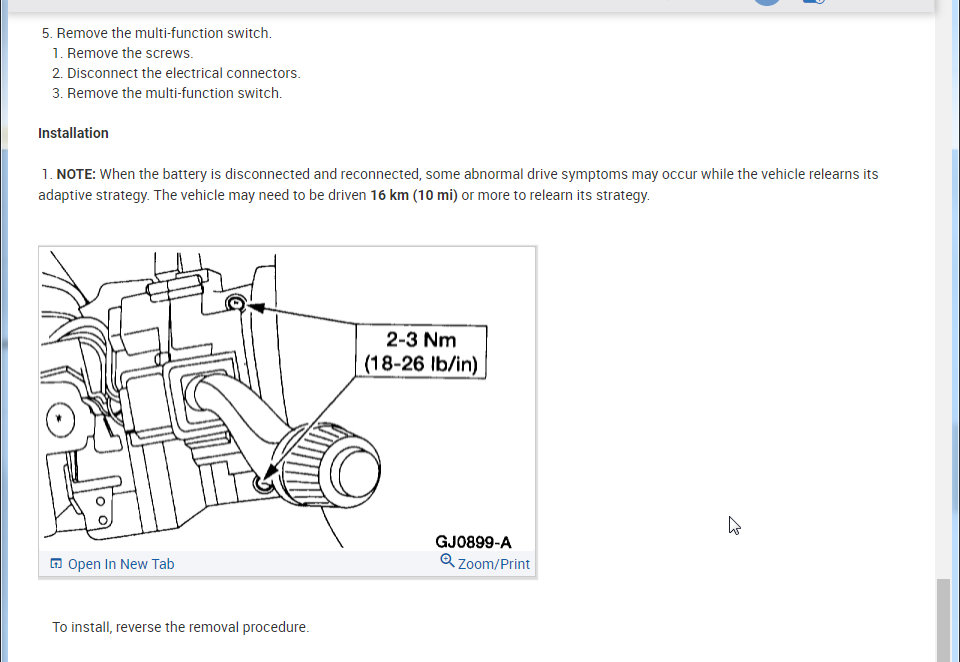

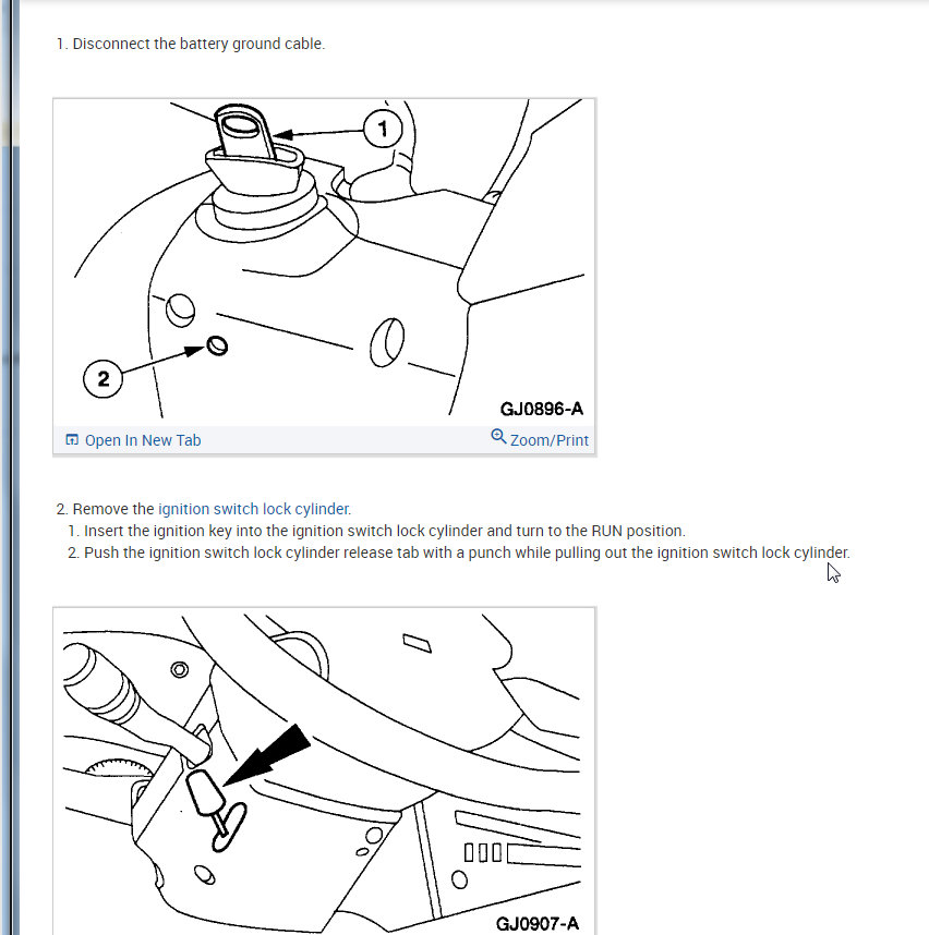

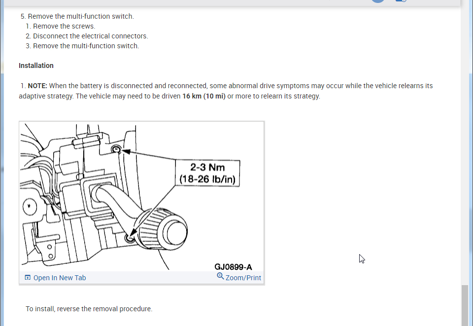

However, below is the wiring diagram and the process from the manual on how to replace the switch.
Please run through this material and let us know if you have other questions. Thanks
