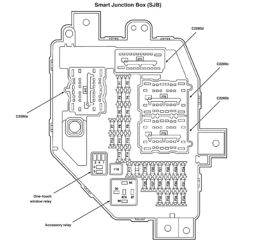

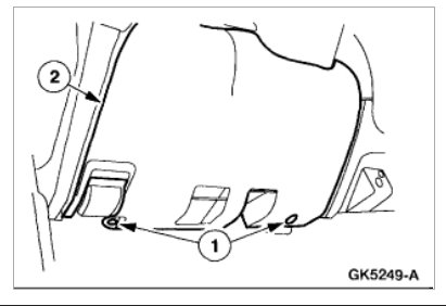

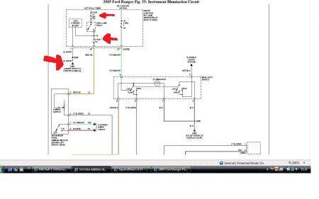

When I start my truck in the morning,I turn on the lights but the parking lights and dash lights wont come on until I either hit the steering wheel or open and slam the door shut or hit the dash and when they do come on then the horn wont work. I was thinking a fuse but they are all good or maybe the ground,but where would I look for the ground if that would be the problem?
Thanks
Al
Feb 18, 2009 at 12:16 PM
DAVE H
  • 13,384 POSTS

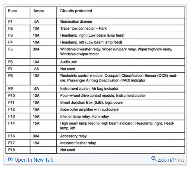

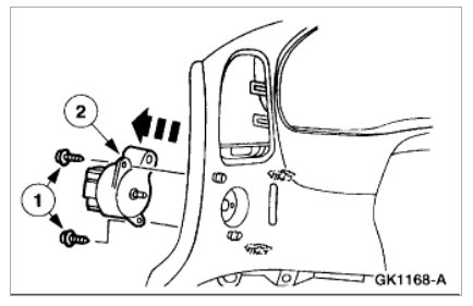

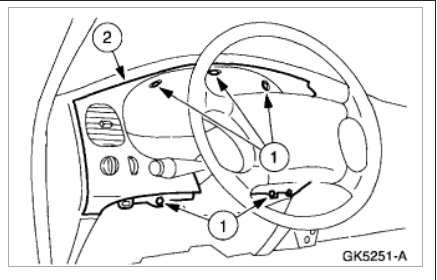

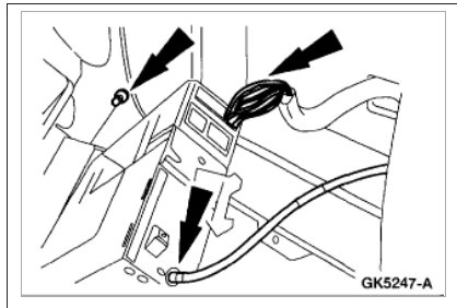

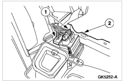

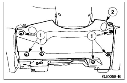

There is a # f7 fuse in the under dash fuse panel that needs to be checked here is a guide to help you and the fuse location with the dash light wiring diagrams so you can see how the system works.
Feb 19, 2009 at 12:29 AM
ALLENKALE
Ok I took off the panel and all I see are fuses and I check the owners manual and it doesnt show a park lamp relay and I looked for it online and cant even find a picture of it to know what to look for?
Al
Feb 19, 2009 at 5:09 AM
DAVE H
  • 13,384 POSTS

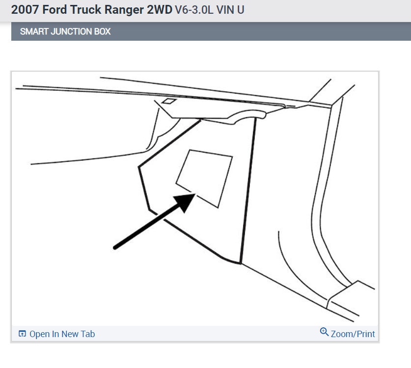

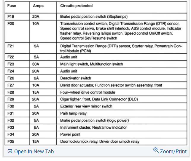

I also cannot find a diagram of this junction box ... while i am trying to locate one please check fuses #1 and # 31 in the same junction box also if you can see it, the ground for thse circuits which is located under front centre of console ?
https://images.2carpros.com/forum/automotive_pictures/266999_ranger_4.jpg

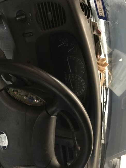

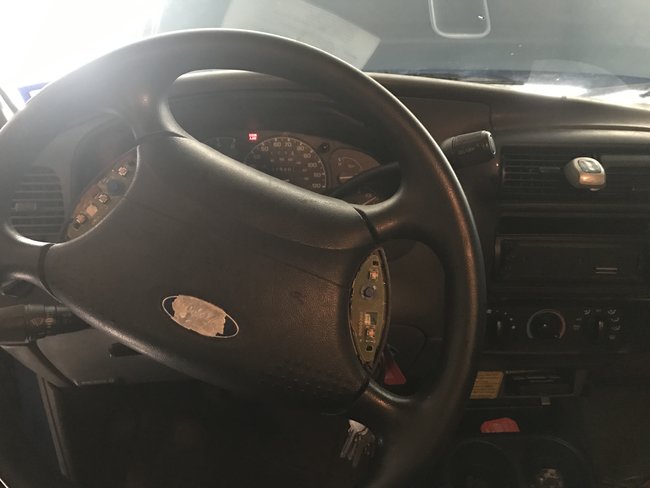

Bought this truck and only a small area of the dash lights work. I replaced the dash lights with LED lights but the exact same area is all that comes on still. Thinking it is somewhere in electrical? Saw posts to check headlight switch, dimmer switch and ground under driver seat. Headlights work, taillights work. Dimmer works to dim the lights that are on and turn on inside light. Will check ground. Is this correct for my problems? Not sure it matters, but the third brake light is on very dim when headlights are turned on. Thanks for your help!
Nov 26, 2020 at 12:48 AM (Merged)
STEVE W.
  • 15,345 POSTS
If you mean that only certain sections are working, like the left side lights up but not the right side it is likely that you need the cluster replaced as it has a failure on the circuit board itself as all of the lights are powered from the same power feed on the board.
The dim third brake light sounds like there is a bad ground that is feeding power into the brake light circuit.
ANGELAVV
  • 6 POSTS
Thank you Steve! I will replace the cluster and check the ground for the third brake light. Will let you know the results!
STEVE W.
  • 15,345 POSTS
You might be able to repair the current cluster if you were to trace the lines on the board from light to light. It only takes a hairline crack in a circuit trace to knock out a section. Use a magnifying glass to search. But it can be very hard to find and repair. That is why replacement may be easier and much faster.
Keep us in the loop either way, please.
ANGELAVV
  • 6 POSTS

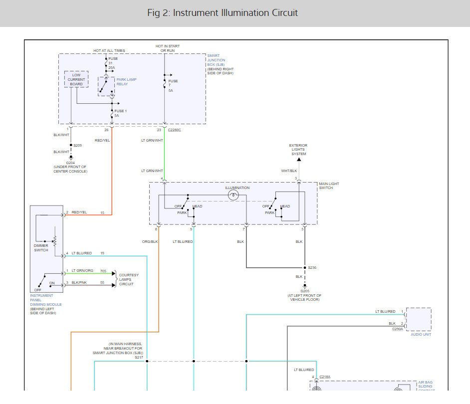

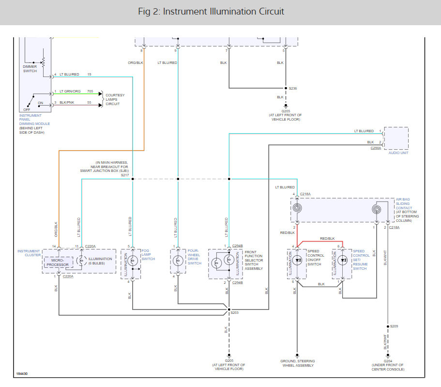

I just got a replacement cluster and plugged it in to my truck and the exact same couple of lights are coming on. So I am thinking this must be in the power supply. Make sense?
STEVE W.
  • 15,345 POSTS

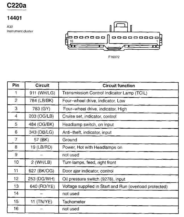

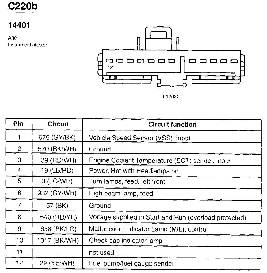

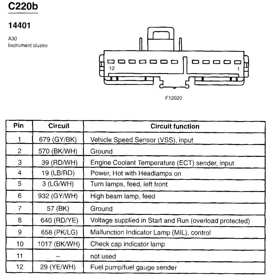

Pulled factory wiring diagrams and it shows there are two feed pins to the board but they feed from the same circuit through a splice. It's possible the splice failed. On the board itself there are two grounds used as well. Does the high beam indicator work? How about the right hand turn indicator? Those are on the same grounds that also come out on two pins but go to a splice.
The power wires are Light Blue with a red trace on pin 4 in connector 220B and pin 8 in connector 220A. A test light connected to a ground should show power with the headlights on on both of those.

Thanks for your research and diagrams Steve! We will check all of that and let you know what we find. Ordered the Chilton manual for this truck also since it appears we might need it in the future!

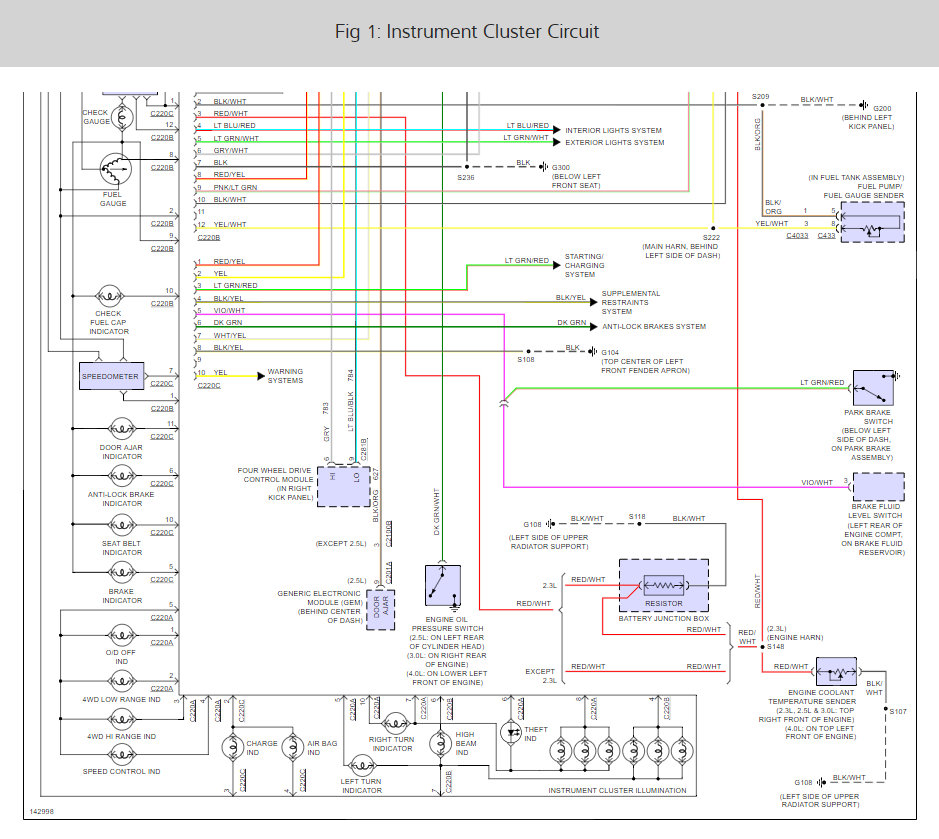

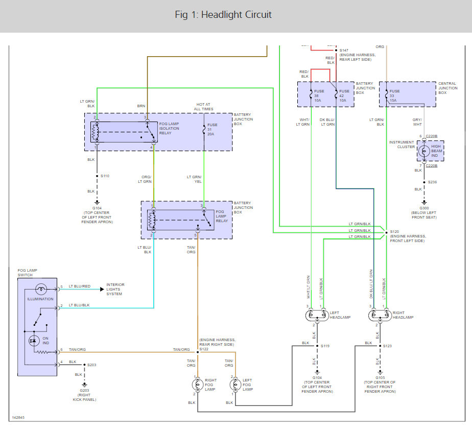

I have a 2001 Ford Ranger Edge with a 3.0L engine. The lights on my instrument panel went out this week along with the lights for my heating and A/C unit. The fog lights and parking lights are also out the headlights, brake and turn signal lights all continue to work. No fuses are blown and I replaced and checked all the lights in my instrument cluster to no avail. Whats wrong with my lights?
Nov 26, 2020 at 12:49 AM (Merged)
RACEFAN966
  • 5,029 POSTS
Ok first I need you to check fuse number 11 it is a 7.5 amp, it is in the central fuse box behind the left (drivers) side of dash. If this fuse is good then I need to know if you have a digital multi meter so we can look at the instrument cluster dimmer and dimming module, this on the top left side of dash. If you have meter I need you to check the brown wire going to it. With the lights on does this wire have voltage? Also the ground for the instrument cluster is below the left front seat make sure it is good and secure. Get back to me and we will take it from there.
RANGER78
  • 14 POSTS
Ive already checked that fuse and it seemed to be fine I'm going to check that brown wire and the ground and I'll get back to you.... thanks
RACEFAN966
  • 5,029 POSTS
Ok great let me know what you find and we will go from there.
RANGER78
  • 14 POSTS
So it turns out that it was the headlight switch. There must have been some sort of short part of the switch had melted. I replaced the switch and everything is working again the only thing is that there is a little green light on the swith that is always on now (while the truck is running). I'm not sure if thats the way it's supposed to be???

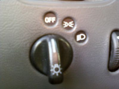

RANGER78
  • 14 POSTS
I'm uploading a pic of my light switch you can see the switch and the dimmer on the right. I've also noticed that if turn the dimmer switch all the way down so that the instrument panel is completly dark the fog lights magically come on I know that is not supposed to happen

RACEFAN966
  • 5,029 POSTS
Ok it may be that the dimmer switch module may be not working right so lets do a test to see what is happening. Check to see if the light green wire with the orange stripe has power to it. Then when you turn on the interior lights with the dimmer switch does it give power to the black wire with the pink stripe? Let me know that goes if this tests good then it on to the Gem module to see what it is doing as this does control all the lighting in some way.

RANGER78
  • 14 POSTS
okay I'll test those wires and I forgot to mention that I noticed that if my truck is off and I turn the lights on then adjust the dimmer switch the switch makes a humming noise. It only does this when the truck is off...

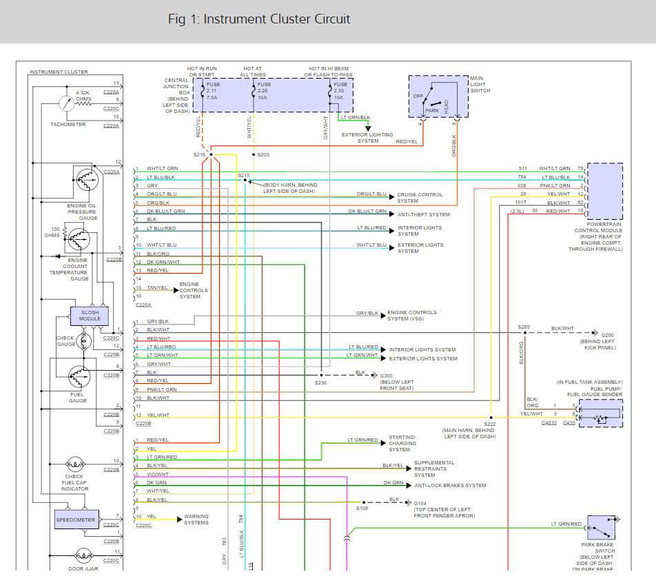

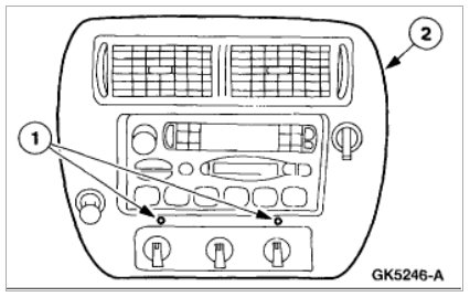

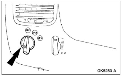

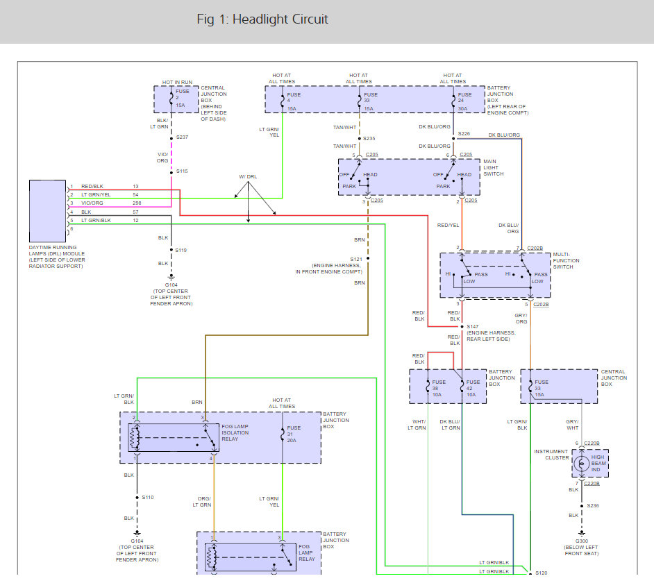

Hello I am having having basically this same issue. 2001 Ford Ranger Edge V6 3.0L. Several months ago the instrument cluster lights were functioning and then would turn off. They would turn back on if you would give the dash a nice slap. Now nothing. I have replaced all 194 bulbs in cluster (which the old ones still looked like the filaments were good). Still nothing. The lights on the ac/heater also do not work as well as the lights on steering wheel for the cruise control. (Cruise control buttons are beat up but the cruise control still functions). I have checked the ground underneath drivers seat and is in good contact. Just checked the voltage from from fuse 11. Fuse is good. Voltage reading when head light switch was turned on was roughly 11.43. Just trying to figure out what should be my next step before throwing parts at it.. Any comments are welcomed! Thanks in advance! -Marcos
  • 55,423 POSTS
Hi Marcos,

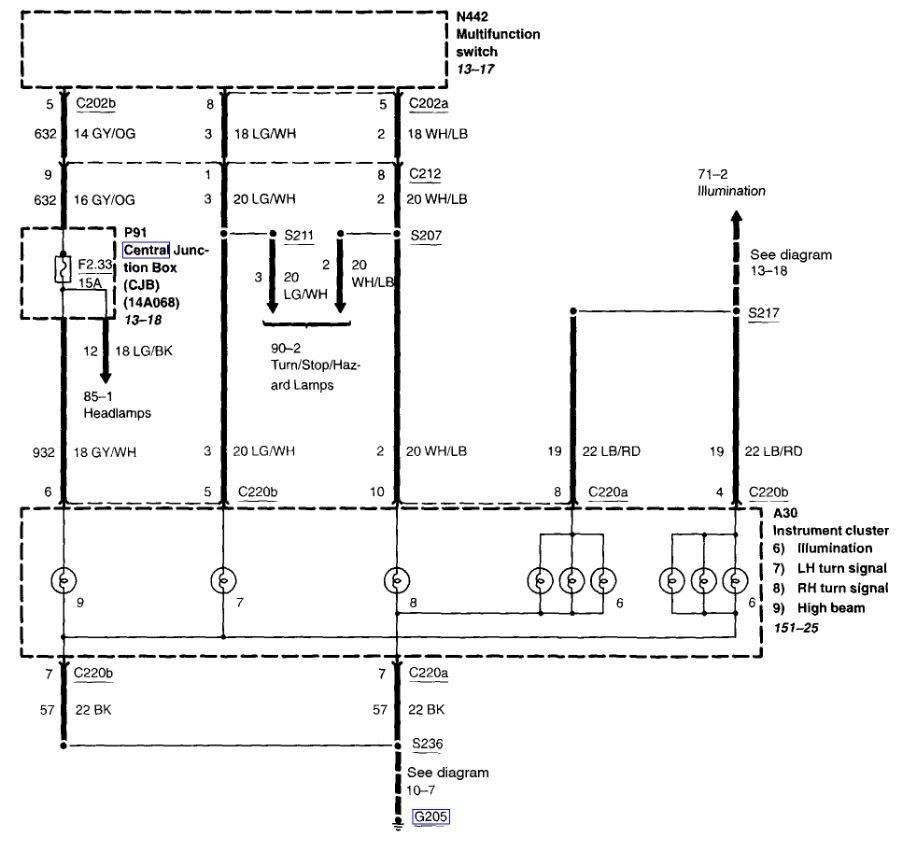

The starter of the thread says it was the headlight switch that was bad in his case. To make sure this is the same problem for your car here is a guide and a wiring diagram.
Just check where you lose power with the headlight switch on
Here are the headlight and instrument cluster wiring diagrams (below)

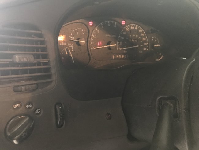

Hey Ken- I finally had a chance to tear into my dash again. I tested everything you were asking the original poster to check. I looked into your diagrams that you sent me refarding the instrument cluster as well. I am by no means anywhere near an expert into electrical systems. I did end up testing with my voltmeter all the wires on my dimmer switch. Everything seemed to work except for the light blue/red going to the dimmer. Can you give me your opinion of what this indicates besides it not working? I see the light blue/red in the wiring diagrams is where it's related to my issue. Can you please tell me where I should go from here?? Thanks so much! Marcos
  • 55,423 POSTS
Just a thought have you checked the bulbs in the cluster to see if there were good? You might have a bunch of bulbs out. The wire that should have power is the Orange and Blue at the cluster #5 with the headlights on.
FROGGY0423
  • 6 POSTS
Yes I actually changed out all 6 194 bulbs in the instrument cluster during the first go round assuming that was the original issue. The orange/blue on the dimmer switch did give me voltage when headlights were turned on on this most previous test. I have been searching for all grounds and so far they have all checked out.. struggling to figure this one out
  • 55,423 POSTS
Can you put power to the orange and blue wire to see if the instrument cluster lights up?
FROGGY0423
  • 6 POSTS
Will give it a go tonite and let you know how it goes..
FROGGY0423
  • 6 POSTS
No such luck on that test. I did however test with my voltmeter the wires on my dimmer switch and did not get any voltage on the light blue/red wire..
  • 55,423 POSTS
Yep it sounds like the switch is bad, it should have power at that wire with the switch on.
TFISCHER1943
  • 6 POSTS
have 2001 ranger checked all things that is talked about the problem now is i only have 6.3 volts on the blue/red wire i am thinking that should have 12 volts on it as i only have some of the dash lights on.is my dimmer switch bad?
  • 55,423 POSTS
Yes that wire should go from 0 to 12 volts which adjusting the dimmer. I would replace the dimmer/headlight switch
