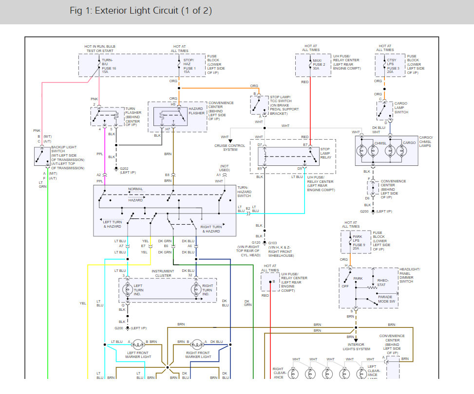

Whenever the head lights are turned on every function of the tail lights shuts off. The brake lights dont work as well as the turn signals. With headlights off the brake lights work but are very faint and when the turn signal is on while pressing the brake the signal goes twice as fast. Any ideas if this is a short or if maybe a wire has come loose somewhere? thanks
Nov 14, 2019 at 3:46 AM (Merged)
  • 75,988 POSTS

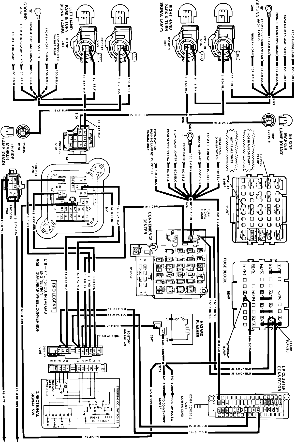

It sounds like the headlight switch is bad but to be sure here is a guide and the tail light wiring diagrams so you can see how the system works and which wires to test for power.
Check out the diagrams (Below). Please let us know what you find. We are interested to see what it is.

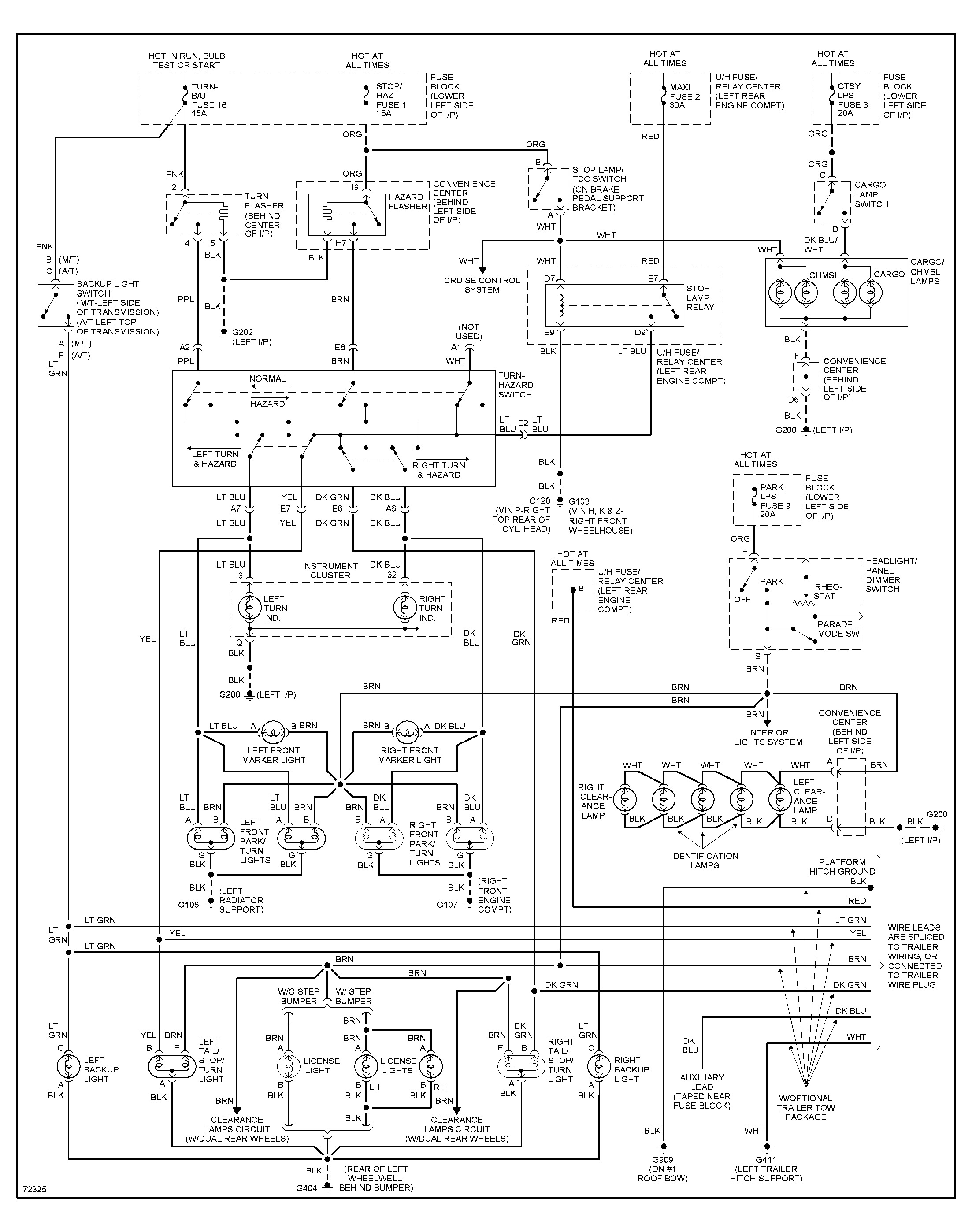

JRFIREFIGHTER533
  • 12 POSTS
For some reason the only lights that are working on my truck are the reverse lights. When its dark and the headlight switch is turned off the back light is lit up but as soon as i turn the switch on the back light goes off and none of the lights come on (headlights, tail lights, driving lights). The dome, cargo, and brake lights do not work either. I have checked the fuses and they are all fine. Any insight to what this may be would be greatly appreciated.

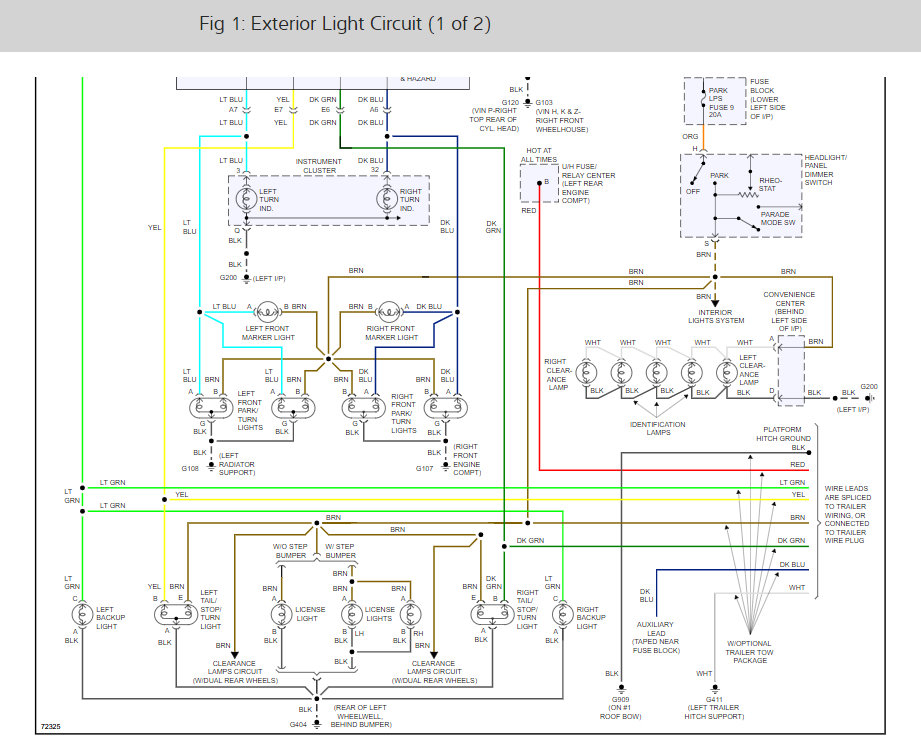

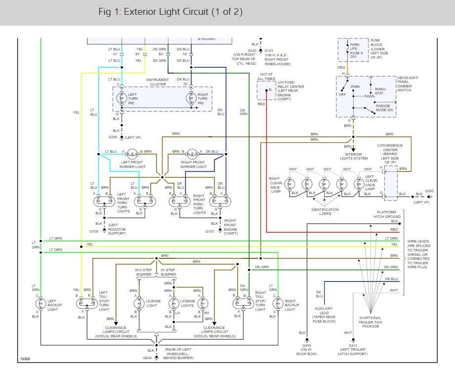

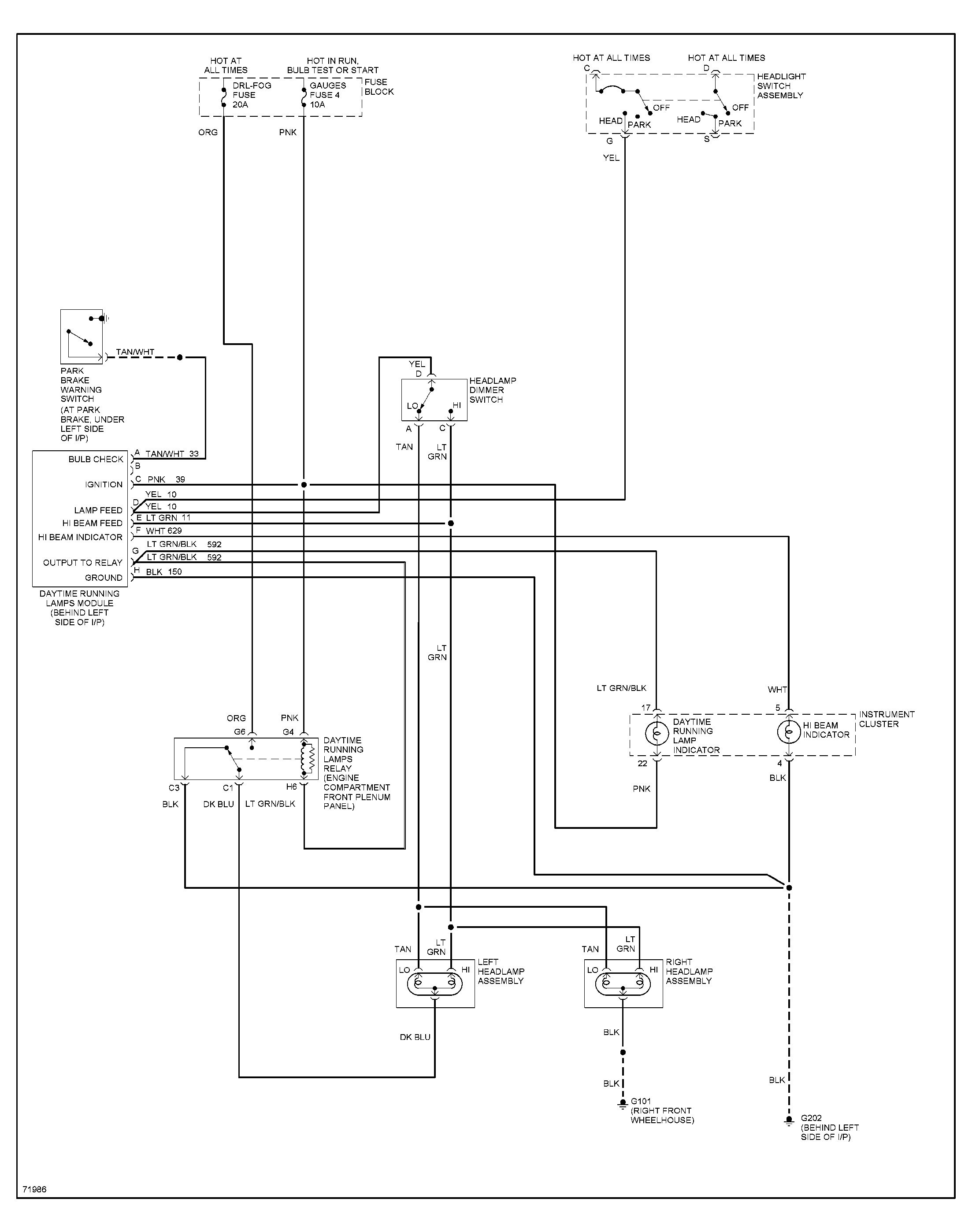

CJ MEDEVAC
  • 11,000 POSTS
......but i may be able to get you a wire diagram from "mitchell i" of the exterior lighting
i need more specific info.....like the "exact" nomenclature of your truck and the engine size......any other surprises like drl (daylight running lights) etc. etc.
sometimes there are hundreds of diagrams for each vehicle, being specific helps me find the correct one
the "mitchell i" diagrams show locations of components (like fuses and fusible links)
a diagram might help you narrow down the problem, they are darn ez to read!
i work until about 1800 hrs e.s.t. tomorrow, so i won't be able to look it up.....unless you respond fast tonight, before i hit the sack!
the medic
JRFIREFIGHTER533
  • 12 POSTS
Sorry for the delayed reply i have been out with family. The truck is a 1995 Chevy Silverado c1500 W/ the 4.3L v6. All lights are stock and the only lights it has are the stock lights that came on the vehicle (High beams, low beams, amber driving lights, corner lights, and tail lights.) A wiring diagram would be great! If you need more specifics about the vehicle please let me know.

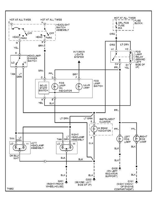

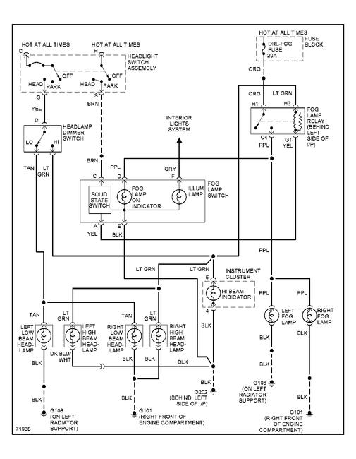

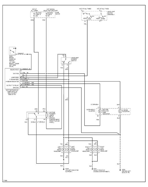

CJ MEDEVAC
  • 11,000 POSTS
all righty then
needed more info....probably woulda took longer than doing this
i got you 6 diagrams..........you will only use 3......the correct ones for your truck
"drl" is daylight running lights
composite is plastic headlights......the ones that get all hazed over in the sun
sealed beam is the "real glass headlights" ....like i grew up on
diagram:
1) exterior lamps---1 of 2 (keeper)
2) exterior lamps---2 of 2 (keeper)
take your pick on these---only one is you:
3) headlights composite w/ drl
4) headlights composite w/o drl
5) headlights sealed beam w/ drl
6) headlights sealed beam w/o drl
lemme know that these aided in your fix!!!
the medic
JRFIREFIGHTER533
  • 12 POSTS
Yes, this helped a great deal. It turned out to be a wire coming off the switch that had been cut. Thanks a lot for the help. Sorry for the long wait my family and i have been on vacation

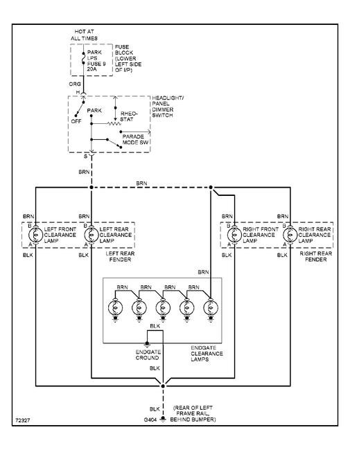

MATTTYW20
  • 113 POSTS
My tail lights dont work parking lights dont work and my dash lights dont work headlights work and my interrior lights work brake lights and signals all work all the fuses looked good but th fuse labeled PANEL LPS is dead and with no power going to it please let me know where to go from here thanks
Nov 14, 2019 at 3:49 AM (Merged)

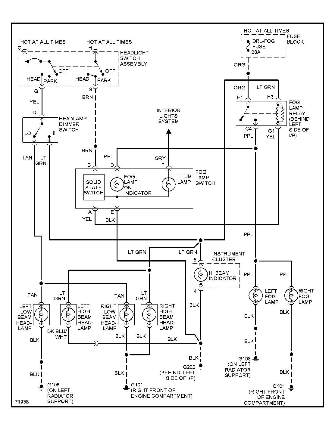

JDL
  • 16,098 POSTS
The voltage to panel lamps fuse comes from fusible link, battery junction block, underhood, passenger side firewall. The fusible link is black, check for voltage on both sides of link, if one side has voltage and the other side doesn't, the link is faulty. If more than one black fusible link, check them both.
MATTTYW20
  • 113 POSTS
I checked that red wire near ECM an There was power there i removed headlight switch an had power on red an orange wire then wen switch is on power to the yellow wire could it be a bad headlight switch

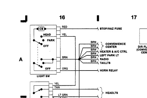

JDL
  • 16,098 POSTS
Is there a brown wire coming off head lamp switch? That wire should carry voltage for tail lamps and other. The headlamp switch has two circuits. One side of headlamp switch is a circuit breaker, only for headlamps. The other side of headlamp switch controls feed for other lighting, including the tail lamps. I believe there is a different voltage source for each side. I'd want to check voltage sources to and from the headlamp switch, before condemning the switch.
MATTTYW20
  • 113 POSTS
An how would I do that I only have a test light i kno that everythin worked thursday night
JDL
  • 16,098 POSTS
Probe the proper wire with test lite. Does the testlite have a sharp pointed end, that is the reason for the point, probe the wire or backprobe the connector. If you make a hole in the wire, cover it up with nail polish or something.
Give me a second and I'll find the wiring for headlamp switch.

panel lamp fuse is powered from the headlight switch when the lights are on.
check all fuses with a test light to verify. the headlight switch may have failed but you need to check for power out of the switch for the rear tail lights
roy
JDL
  • 16,098 POSTS
Here is wiring for headlamp switch.

JDL
  • 16,098 POSTS
No park lamp relay according to my diagrams. Park lamps get voltage from light switch, brown wire is voltage for park lamps.
