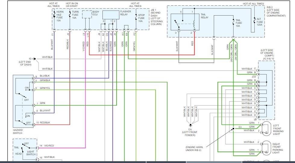

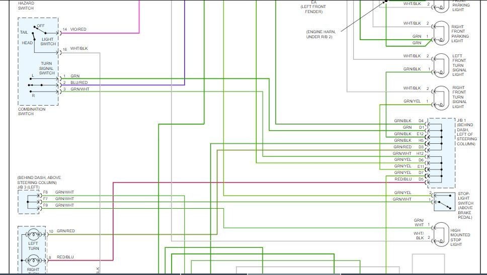

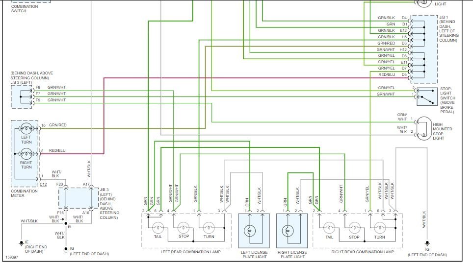

My friend purchased a new utility trailer for use with his truck listed above. The trailer can equipped with lights and appropriate wiring. The truck has no wiring for the trailer lights. I am helping him install the trailer light wiring.
What we need is a wiring diagram for the rear tail lights on this vehicle complete with the color codes and functions. Could you please provide this diagram?
Thanks in advance for your response to this request.
May 2, 2021 at 2:04 PM
Good morning,
I attached the wiring diagram for you below of the rear lights. The reverse lights are on a separate diagram.
Let me know if you have any other questions.
May 2, 2021 at 9:13 PM
BLAZ85
  • 54 POSTS
Thanks Roy! As usual you provided just exactly what i needed. Thanks again for the quick response!
May 3, 2021 at 12:56 PM
You are welcome.
Always glad to help.
May 3, 2021 at 8:10 PM
Suggested Repair
Use the rear tail light wiring diagram for the 2002 Toyota Tacoma, noting that the reverse lights are on a separate diagram. Verify the circuits with a voltmeter before connecting the trailer lighting.
