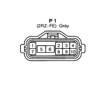

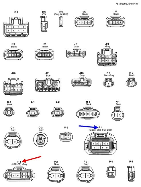

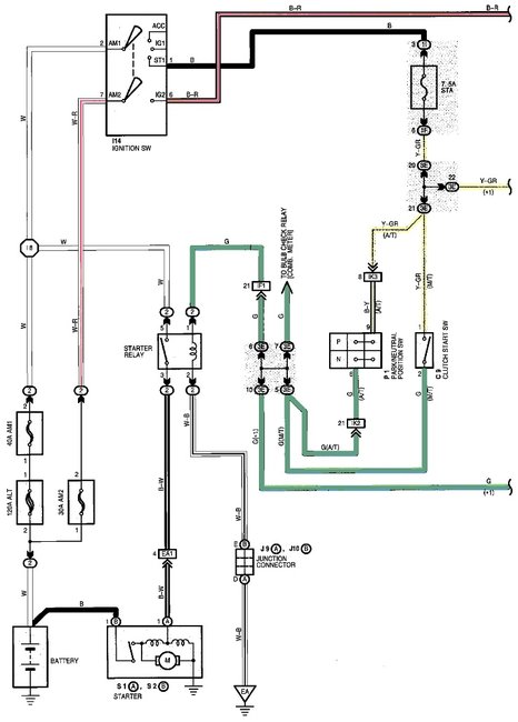

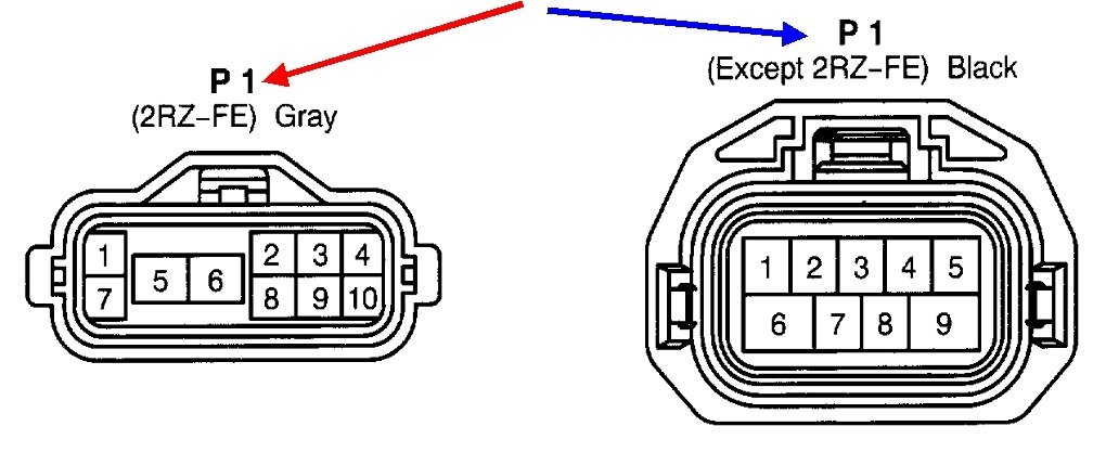

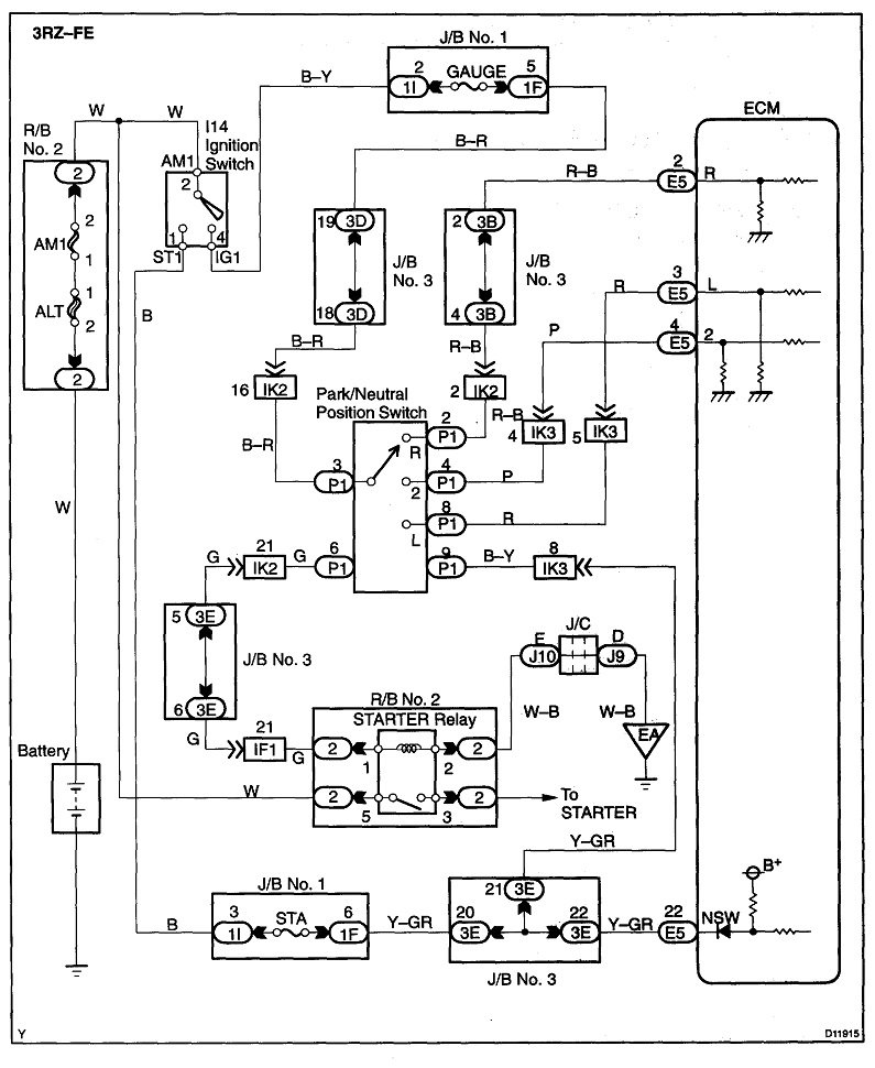

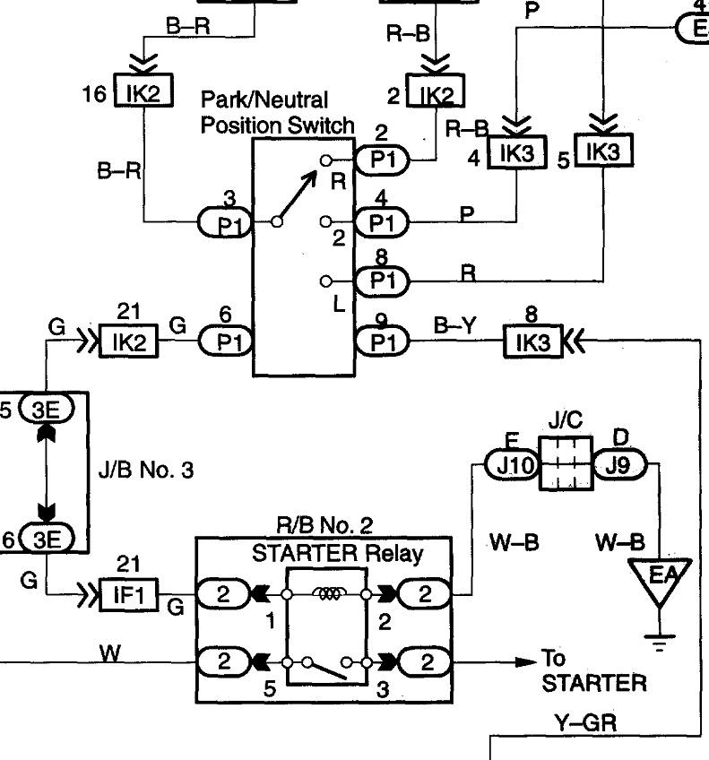

When replacing the transmission on my truck, the NSS connector was still attached and pulled all the wires from the connector. The new connector is all black wires, and I can’t find anything showing which cavity to put each wire.
Mar 7, 2022 at 5:49 AM
CARADIODOC
  • 34,416 POSTS

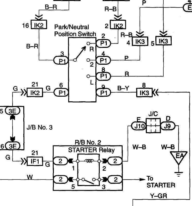

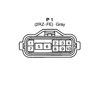

Here's what I found for that switch: Two different connectors are shown for "P1". Use the one with the red arrow or the blue arrow that matches your plug.

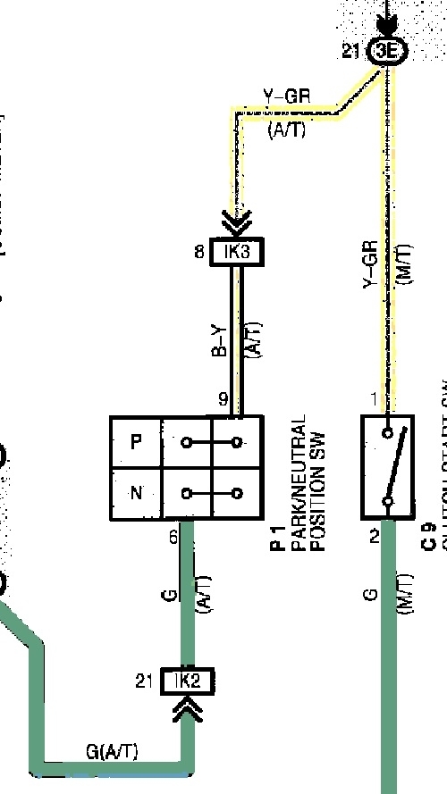

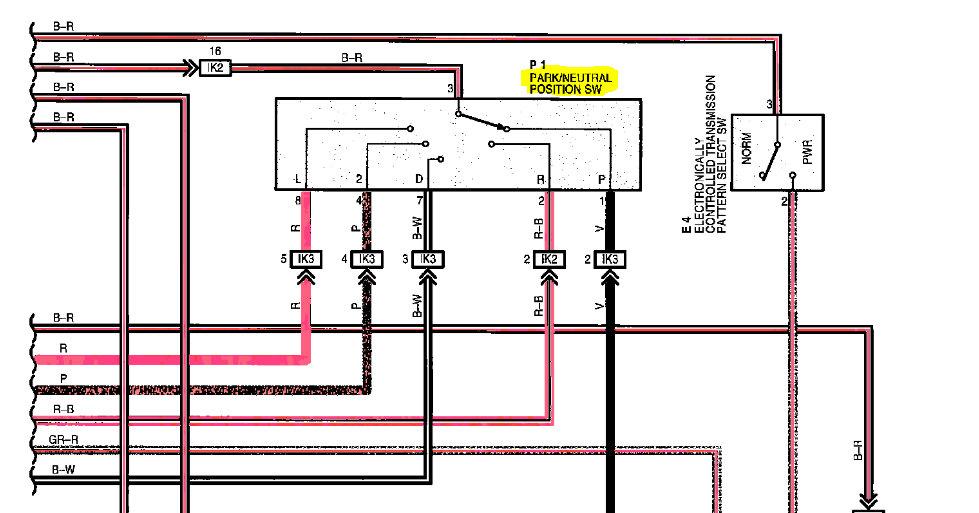

The first diagram is for the starter circuit with the park / neutral part of the switch. The next diagram is just of that switch expanded to make it easier to read. The fourth diagram shows the transmission range sensor part of the switch, and the fifth one is of that switch expanded.
I saw the plugs were hard to see so I expanded them in the last drawing. You can see the wire colors in these diagrams along with the terminal numbers in the connector. Let me know if you need help with those. Sometimes import wire colors don't seem to make sense, especially when you're accustomed to working with domestic diagrams.
Mar 7, 2022 at 6:39 AM
SQM
  • 6,383 POSTS
I have attached the wiring schematics for the neutral safety switch below.
Mar 7, 2022 at 6:42 AM
DAWSONK1
Thanks guys. Between the two answers, I was able to get it wired back up and running. Thanks for the help. It was exactly what I needed.

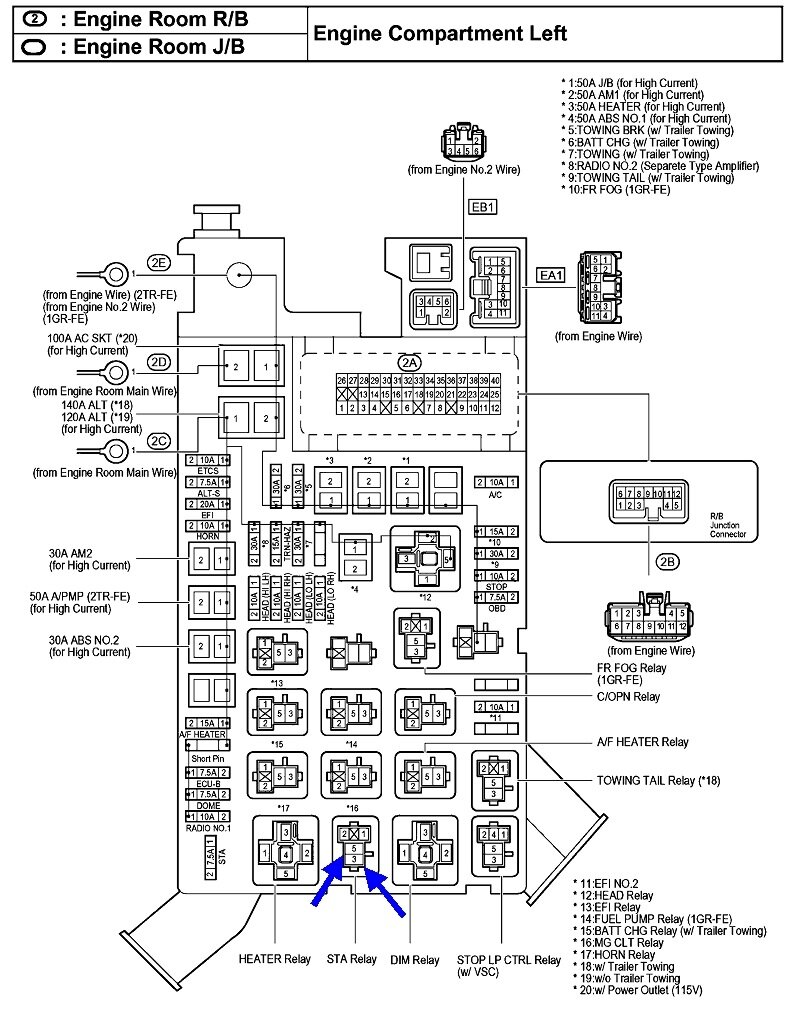

I need help 2006 n.s.s I broke how do I bypass where do I put jumper wire so I can get home thanks
Jan 23, 2024 at 1:53 AM
CARADIODOC
  • 34,416 POSTS
You should start a new question specific to your vehicle. Unlike on other forums where anyone can post confusing replies, here this becomes a private conversation between two or three people. As such, most of the other experts won't get to see your problem or have a chance to reply. You're stuck with just me which might not be the best person to ask.
Rather than bypassing the neutral safety switch, a far easier way to start the engine is to jump the starter relay in the fuse box under the hood. There's two ways to do that. My preference is to remove the relay, pop its cover off, reinstall it that way, then just press the movable contact. Have the ignition switch in "run" so the engine will start and run.
Instead of removing the relay's cover, you can remove the relay, then use a piece of wire or stretched out paper clip to jump the two terminals in the socket where my two blue arrows are pointing. This circuit can draw a good ten amps or more, so a paper clip might get hot if it's left in too long. You also might feel a very light tickle when you remove the paper clip. That's common and normal, but harmless. Use an insulated piece of wire with the ends stripped to avoid the heat and the tickle.
This fuse box layout is for a 2wd 4.0L. Others will be similar.
Jan 23, 2024 at 11:19 AM

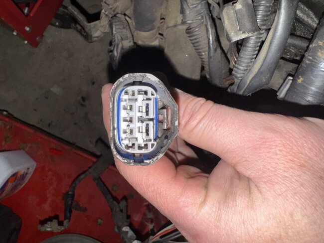

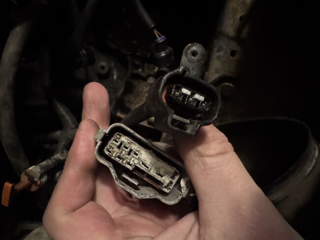

Hello, this has some information I was looking for but hoping for more. Just swapped out the engine in my son’s 98 Corolla with a used engine. The used engine came with a wiring harness, so I didn’t remove the harness from the old engine.
After getting the used engine in, I found out that the old harness has the black connector which fits the NSS. The replacement harness has the grey connector which doesn’t fit. There is also another plug the looks like it connects close to the NSS. The old harness didn’t have this second connector.
First photo is replacement harness. Second is the original.
My question is, how do I make this work?? Do I need something for the additional connector to connect to?
