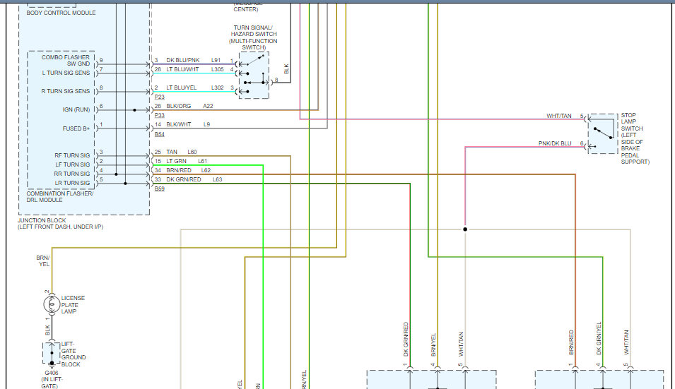

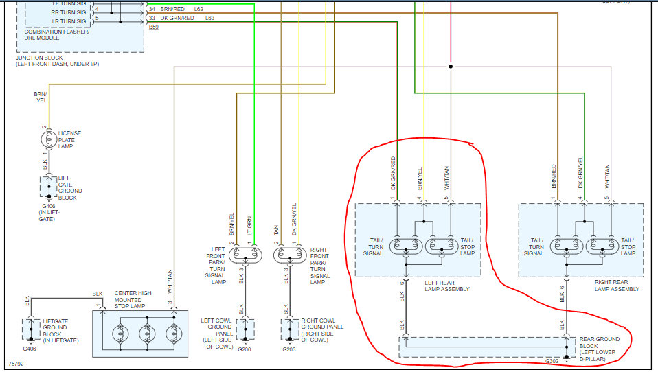

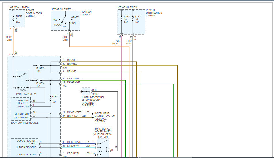

My four tail light bulbs are all supposed to be on when I turn the headlamps on right. well, the top driver side light bulb is the only one that doesn't turn on until I hit the brakes. I checked all the fuses and they are all fine the bulb is fine but for some reason I can't figure if it's just a simple fix or if it's going to require a brand new connection wire link to that light. if someone can help me out that would be very well appreciated.
May 24, 2021 at 2:48 PM
DANNY L
  • 5,648 POSTS
Hello, I'm Danny.
It sounds like you might have an open wire in that circuit considering you say the bulbs and fuses are good. Here is a tutorial showing how to test wiring circuits:
I've attached the wiring diagram below for the rear tail-brake light circuit on your van. I've cut the picture into 3 pieces so you can view larger and circled the circuit in red which you should check. Hope this helps and thanks for using 2CarPros.
