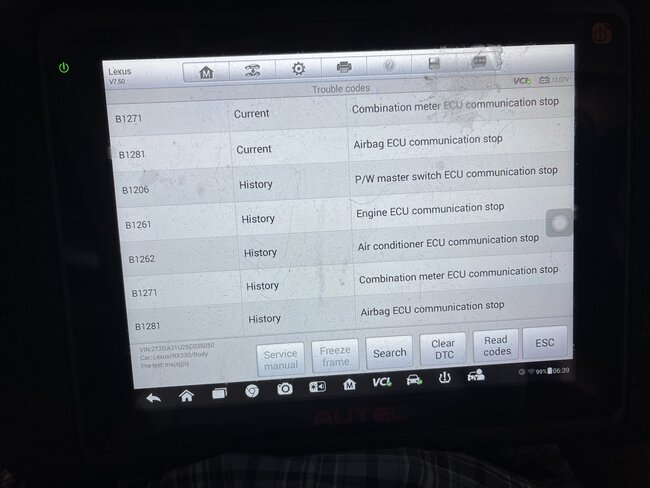

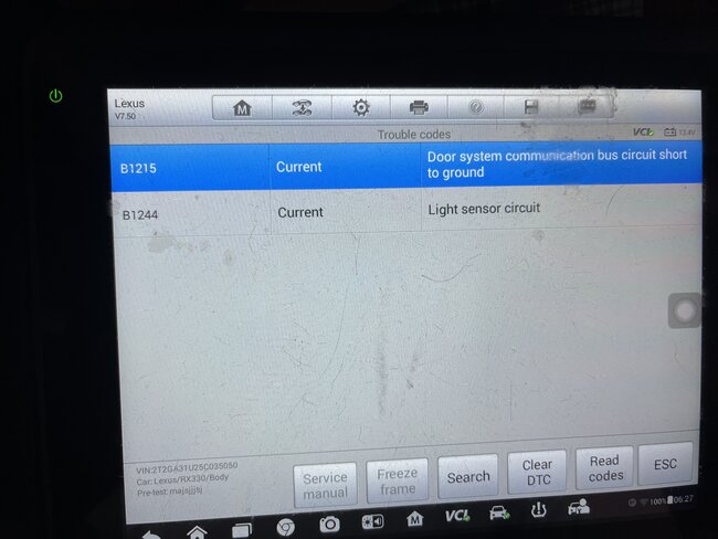

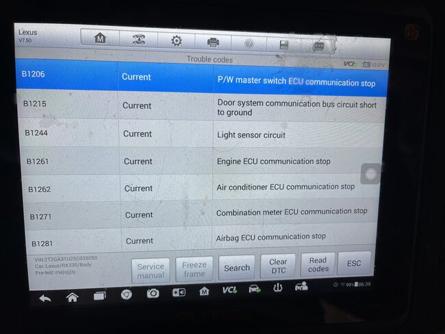

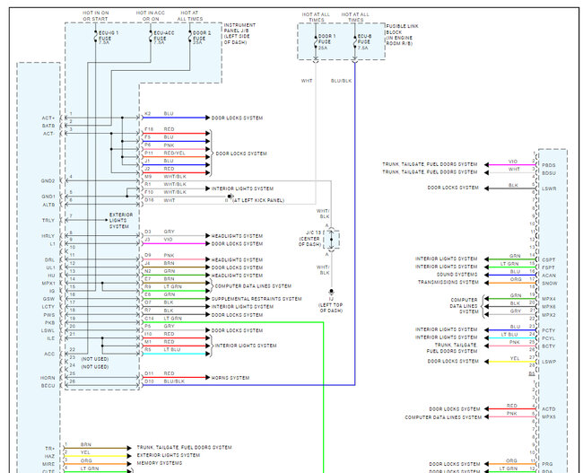

I noticed that the tail gate won't open using the remote, the button under the steering, and even from the button on top of the license plate. I can open it manually from inside by removing the cover and unlatching the lock. Initially the gate would close by power from the button on the gate when its open, I press it and I hear the beeps and it closes fine. I removed the latch to see if anything is broken or any wires are cut, none. Then Tried the button on the gate to close it and now it won't close. Checked fuse 30amp under the hood and it is fine. I noticed also that master window switch the driver side window works but not the other 3, the lock/unlock also does not work. Since the battery was dead, I tried to reinitiate the windows but did not work. But you can still open the windows from each individual switch. I am thinking the master switch maybe bad, and since the lock unlock must be unlocked for the gate to open maybe that is why it is not working at all...am just baffled.
Also, the AC head unit is not responsive, none of the buttons work or light up. This maybe a different issue, but I ordered another head unit for that. When all these codes deleted the last 2 remain, but they all come back again after i start it. Also if you can find for me where the door system communication bus or module is located, I want to disconnect it and see if the rest of the stuff work. The issues all started with the HVAC head unit just blinking whenever I hit the buttons, but nothing worked. Then it died completely, so am thinking one of them is fried and the circuit is shorted somewhere.

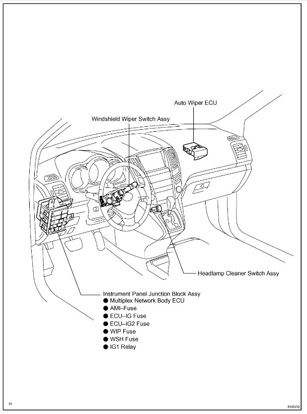

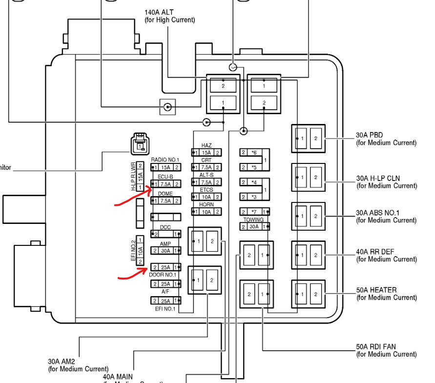

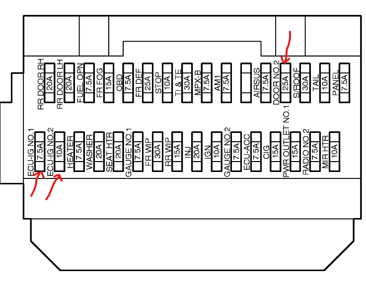

The Body ECU, runs all three of these systems, can you please check the body ECU-B fuse 7.5 amp and the Door1 20 amp fuse in the fuse panel under the hood? Also, check the ECU -ig1, ECU ACC, and Door2 fuses as well, have the key on when testing, here is a guide to help:
Here are the location of the fuses. Check out the images (below). Please let us know what happens.
Aug 19, 2024 at 2:01 AM
BHAMDOC1973
  • 2,007 POSTS
Checked under hood they good, checked under panel of driver side and they good.
Aug 19, 2024 at 3:33 AM
  • 55,399 POSTS
Okay, it sounds like the body ECU has stopped working, I would check the power and grounds to it, and if they are okay send the Body ECU for testing or replacement, you can get a preprogrammed unit by searching Google or Ebay.

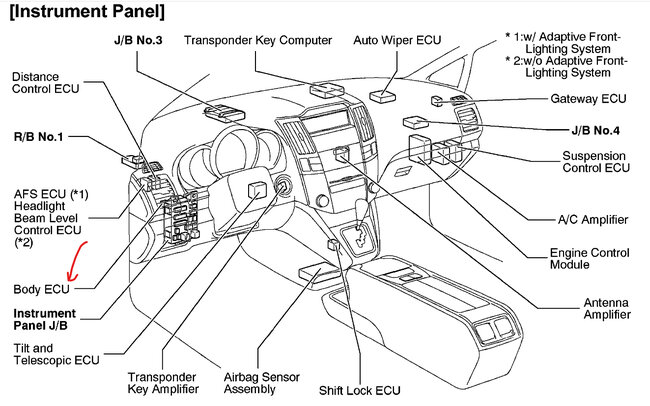

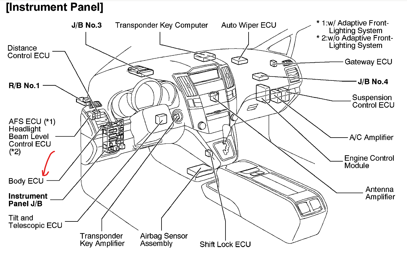

I see. So, the body ECU is basically the fuse box under the panel of driver side? Or is it just in the same location?
Aug 20, 2024 at 6:11 AM
  • 55,399 POSTS
Yep, you are correct, it is basically the fuse panel and body ECU all in one.

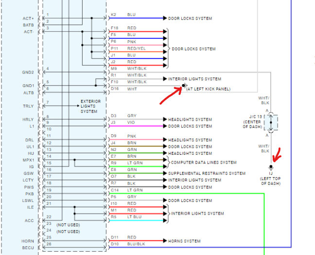

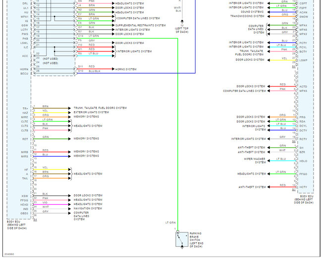

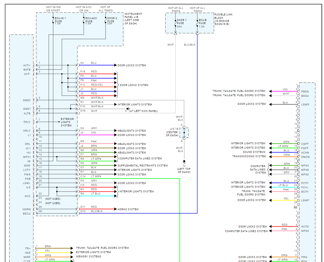

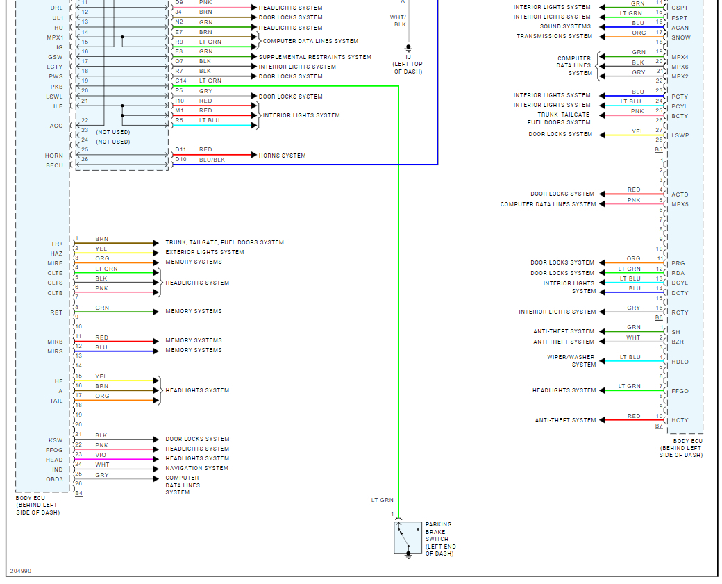

When you said the fuses are good in the post above do you mean the fuses have power? Also, I have marked the ground that needs to be double checked as well.
Aug 29, 2024 at 3:19 AM
BHAMDOC1973
  • 2,007 POSTS

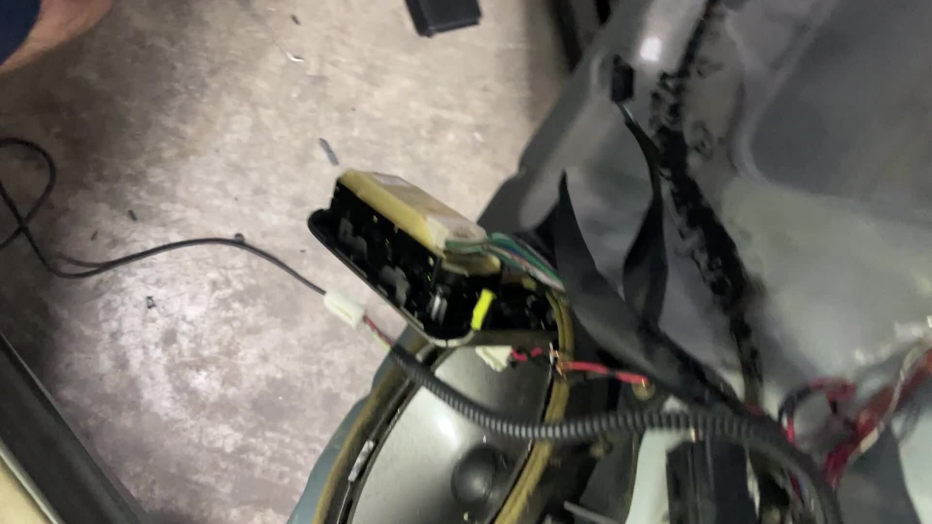

Yes, they have power. I'll recheck fuses again and check grounds. Not sure what that left top of dash means but I'll look.
Aug 29, 2024 at 3:43 AM
BHAMDOC1973
  • 2,007 POSTS

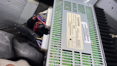

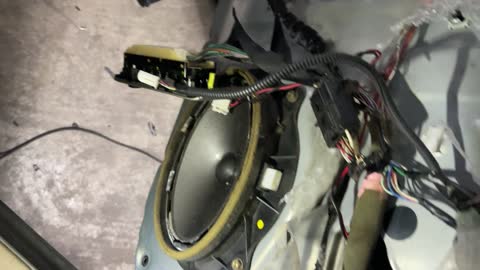

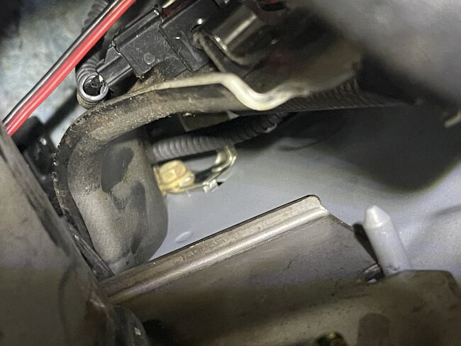

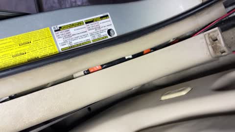

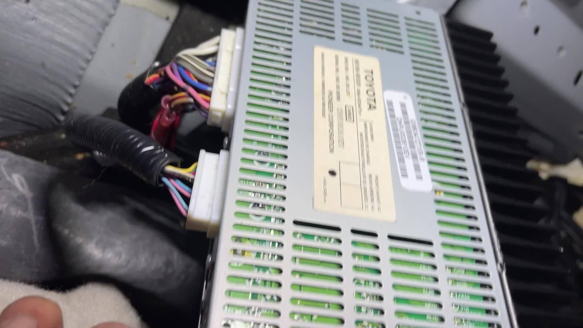

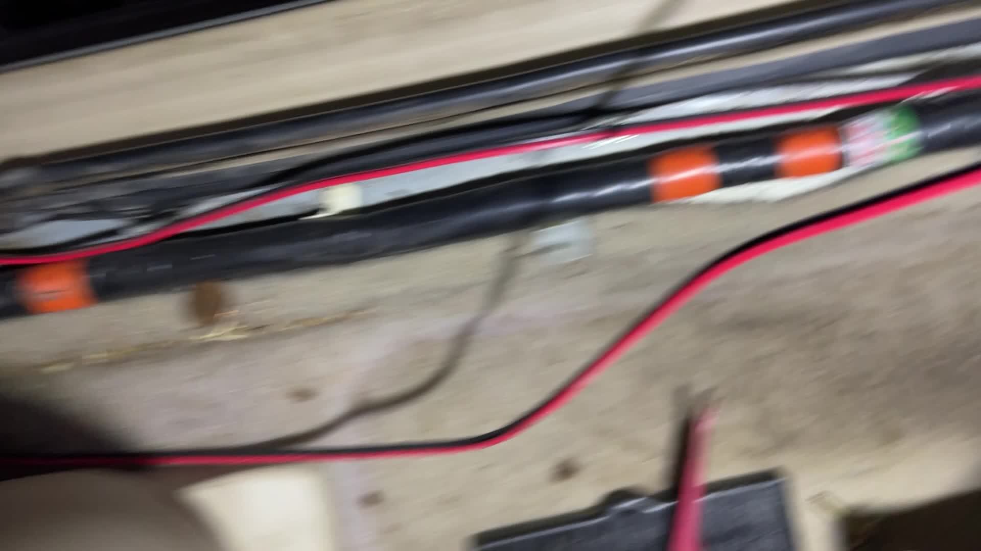

So, this wire goes up then goes into the door wire harness, found it loose/cut so removed panel. Looks like it's going to the speaker.
Aug 29, 2024 at 5:29 AM
BHAMDOC1973
  • 2,007 POSTS
Those 2 grounds are fine too. Rechecked fuses
With probe and with ignition on all under hood and under panel and they all have power. Unplugged the amp, which i guess that is what it is still same issues.
Aug 29, 2024 at 5:44 AM
BHAMDOC1973
  • 2,007 POSTS
Now my question is, do those wires coming to the speakers up front, the driver's door one and the upper dash speaker, do they feed into anything else? I am talking about the original ones that were cut. There is no way that this butcher job has nothing to do with what is going on.
Aug 29, 2024 at 5:57 AM
  • 55,399 POSTS
The body ECU does work with the sounds system, it looks like you are close to finding it being a wiring harness issue. You might want to do a pin to pin test, ot just remove the harness for inspection. It looks like the wiring got hacked by someone.

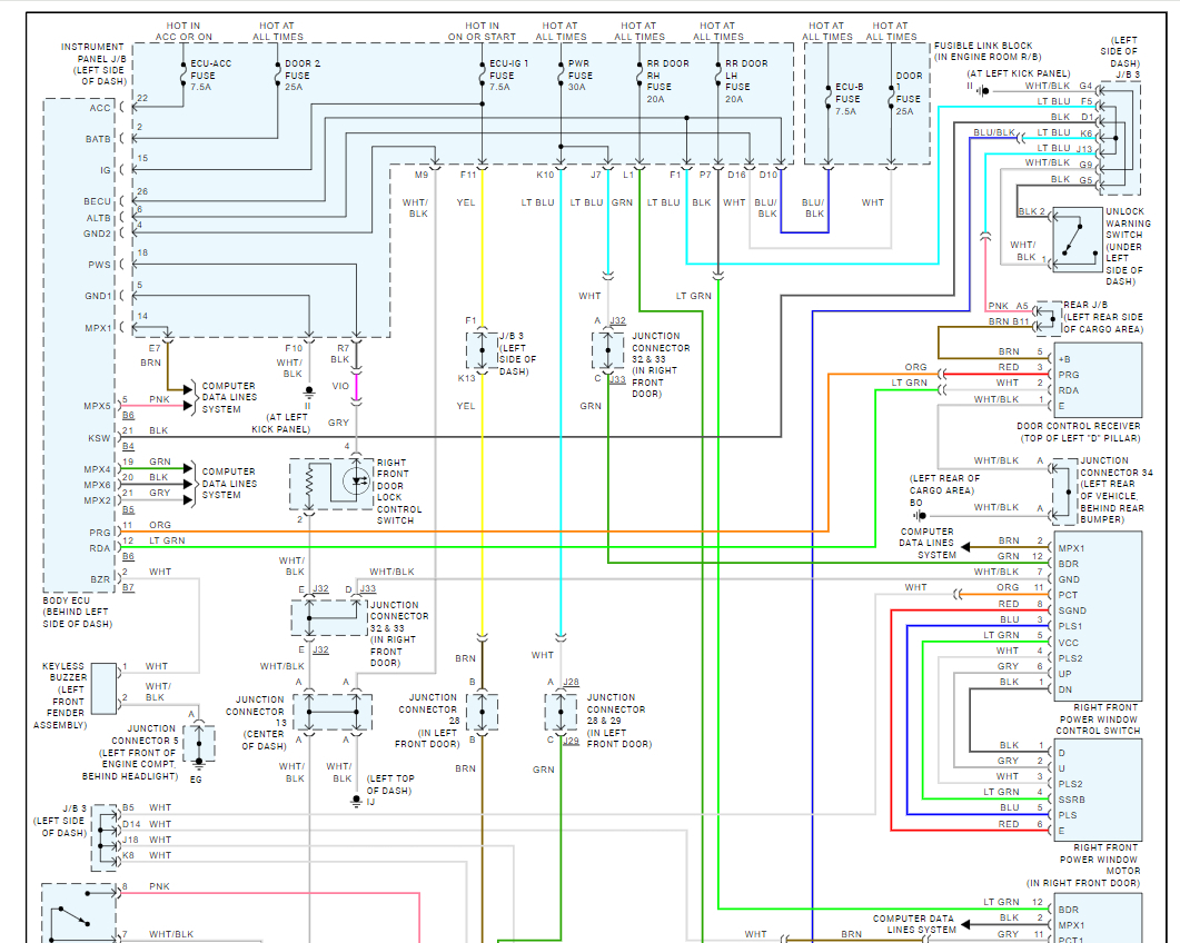

Can you explain a bit more of where to do a pin to pin? As I am baffled right now of where the issue could be. I was thinking that cutting the wires to the speaker in the door wouldn't affect anything as these 2 wires were among the harness in the door and only going to the speaker. But the harness at the amp, the 2 sets of wires coming from the amp were cut from the harness in the back, and that is where I am confused. Aren't those 2 sets coming from the body ecu? And so, what would the cut in the loop affect? Isn't it, for example, coming from the fuse in the body wcu responsible just for sound? And so, should it not affect anything else? Just brainstorming.
Aug 30, 2024 at 2:41 AM

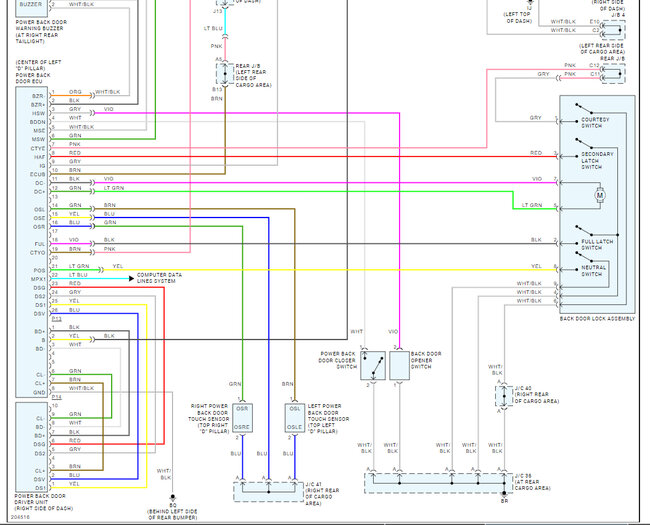

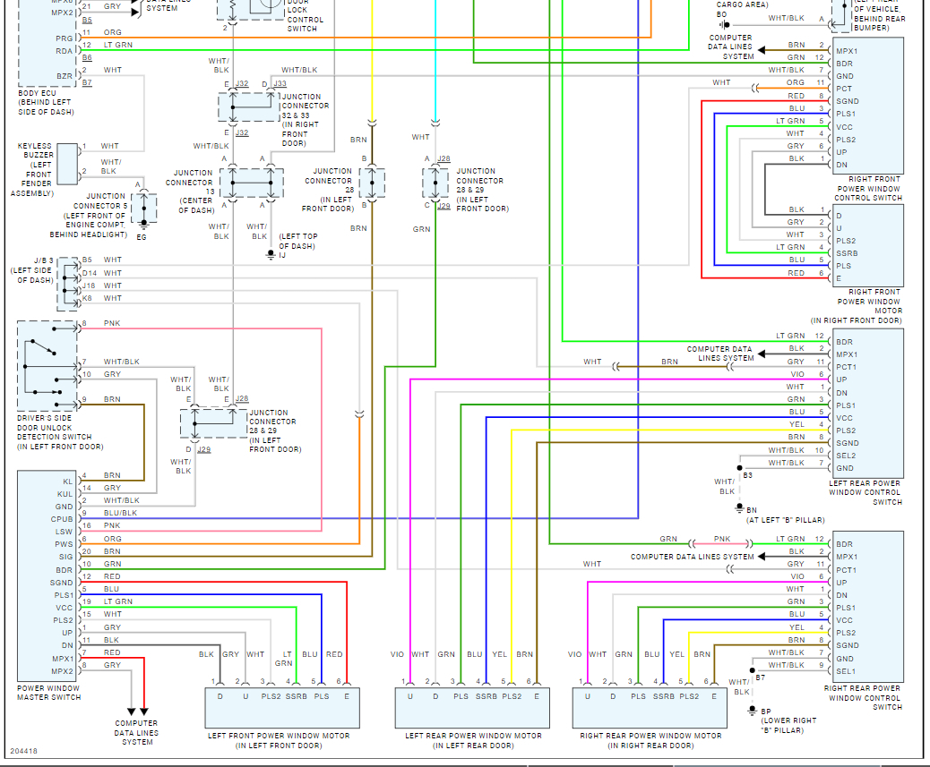

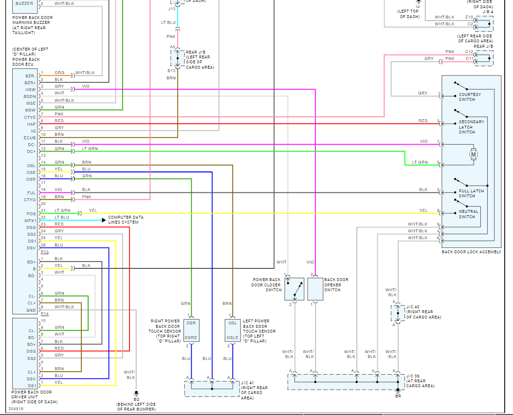

  • 55,399 POSTS

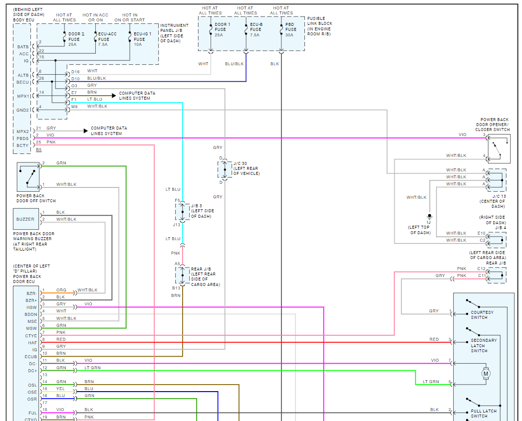

Sure, this guide can help, a pin-to-pin tests each wire in the system for continuity and resistance to ground.
This guide can show you. Here are the hatchback and window wiring diagrams to complete the body ECU circuits. Recheck power inputs and grounds. Check out the images (below). Please let us know what happens.
