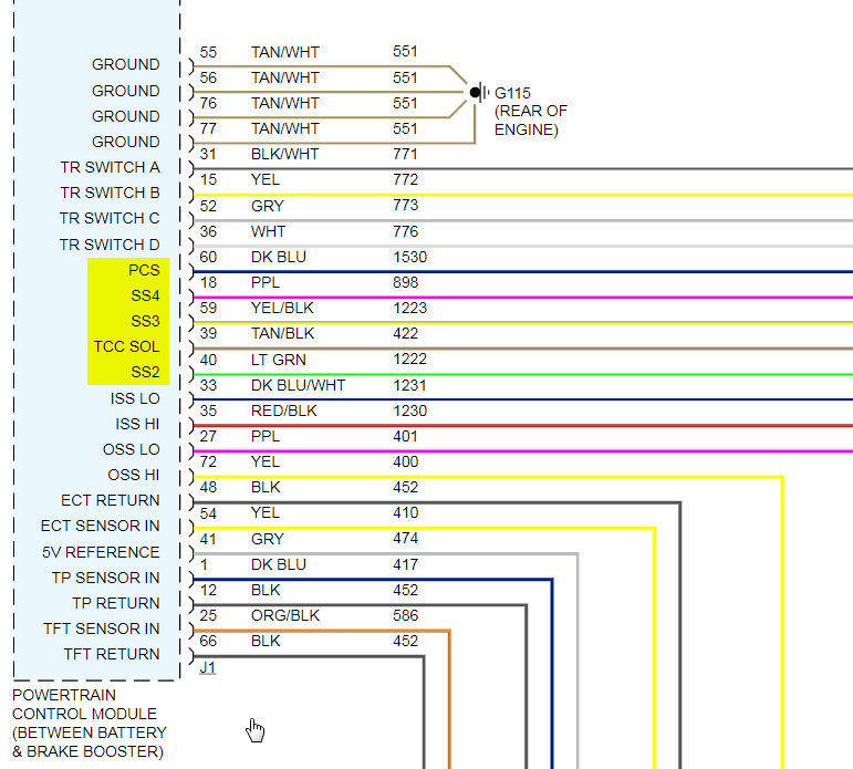

Just wondering could it be a bad ground connection?
Sep 17, 2019 at 7:33 PM
Unlikely. You would more than likely have codes. Plus that would not cause a harsh engagement. It would cause a no shift condition. Lastly, the solenoids are grounded through the PCM as pictured so it is unlikely because there is not a specific ground for just the solenoid.
Sep 17, 2019 at 7:40 PM

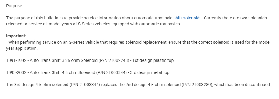

I was wondering also is there a gasket on the solenoid cover?
Sep 25, 2019 at 1:03 PM
RODNEY7867
  • 70 POSTS
On the that transmission.
Sep 25, 2019 at 6:15 PM
I am not finding one. Unfortunately I don't have step by step directions on these service manuals on the shift solenoid. Unfortunately you may have to just see if there is one when you remove the old one. Sorry I don't have more detail for you.
