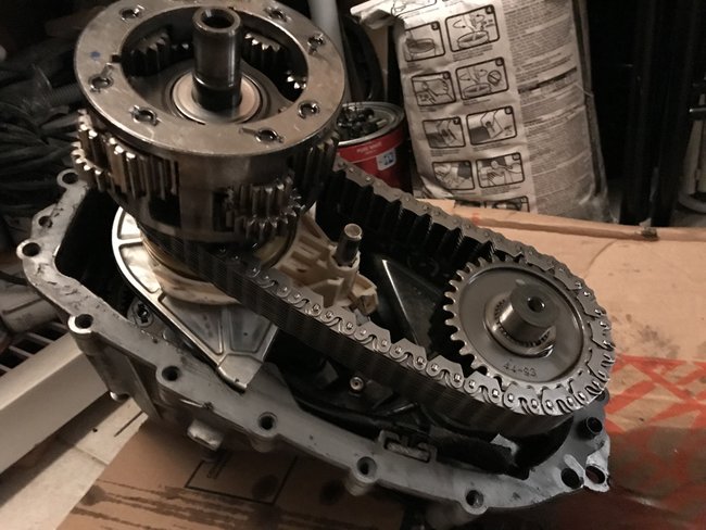

Sounds right can you upload a picture of what you are talking about?

To place the sprocket inside that planetary gears assy you can see in the picture on top of the chain has been very difficult
following the manual you have marks in the four upper gears.

Sorry, I am not sure what you are saying, there is no timing for these gears, can you be more specific, what is the problem?

Okay Ken,
Work is done and it looks okay.
The plastic fork was replaced by aluminum fork.
The H3 drive smooth like months before, while it was parked I replaced my sparks and cleaned up the throttle body.
The thing I noted now is around 30-35 miles the car starts to shake, what can it be?

Yep, the plastic wears out not engaging the transfer case. Did the shake start after the transfer case repair or was it there before? If after I would look to see if the driveshaft is stalled correctly you could have a balance issue. Can you please shoot a quick video with your phone so we can see what's going on? That would be great. You can upload it here with your response.

After the transfer case installed balance? Please, don't scare me, what is the driveshaft? Is it inside the TC or external? I placed everything back as installed before.

No need for videos, and yes, you were absolutely right.
I got both driveshaft checked and noted one of them was a little out of position, so now it's working fine, no more vibrations.
